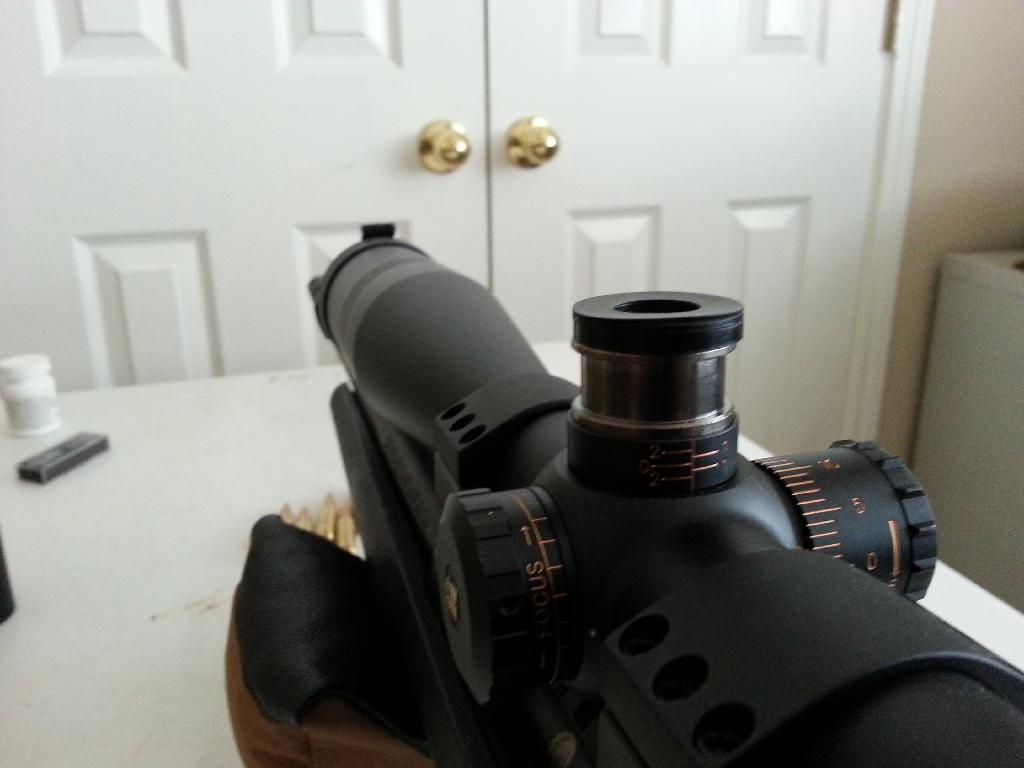

Skullybones was kind enough to send me a set to try out on my Sightron SIII 6-24 Mil-Hash FFP. The set he sent me were designed for the SS so the thickness markings were off since the travel on the SS and the Sightron Mil are different. The 1/4 shims took up about 1/3 of a revolution of the SS. Other than that, the shims worked perfectly and I was able to get the turrets to stop 1 click below zero. Skully said he would adjust the shim thickness for SIII orders, so I would not hesitate to give everyone two thumbs-up for using the shims on Sightron models like mine. Here is a picture of the shims on my scope.
Ok I am having trouble with mine. Is the shim supposed to fit down over the raised circular center of the inside of the turret? I have just over three revs from zero until its bottomed out. I can't even get the turret back on the scope with the 3 rev shim.
If it is supposed to go down over the center portion I can trim it with a dremel tool. I just want to make sure before I go hacking away at the shims.
Scope is a 3-15x42
Here is the inside of the turret with no shim.
Here is the inside of the turret with a shim that will not fit around the center portion.
Thanks

There must have been a change at some point with the ID portion of the turret caps. Clearing the material will not harm the shims at all. Sorry for the inconvenience with this set, and feel free to PM me if you need any assistance. I will add even more clearance to all future sets.
Just to make sure we are on the same page. All of the shims in the set will not fit over this bossed section?

Yes, I just need to get a look at one in person. The HD caps bottom differently and make measuring a little trickier. What is the measured difference of one revolution? Inside cap diameter?
Thank you
I just got around to measuring the 3-9x42 scope. The measured difference of one revolution is right at about 0.020" Inside cap diameter is right around 0.900". I hope I am measuring the correct things correctly. I'd be glad to either make a set to be sure it is correct or test a set from you guys. Hope this helps!

That sounds very close to the 1-6 measurements. I'll send you a set of those to see what it looks like. Shoot me a PM to set up shipping.
Thank you for taking the time to measure the scope.
