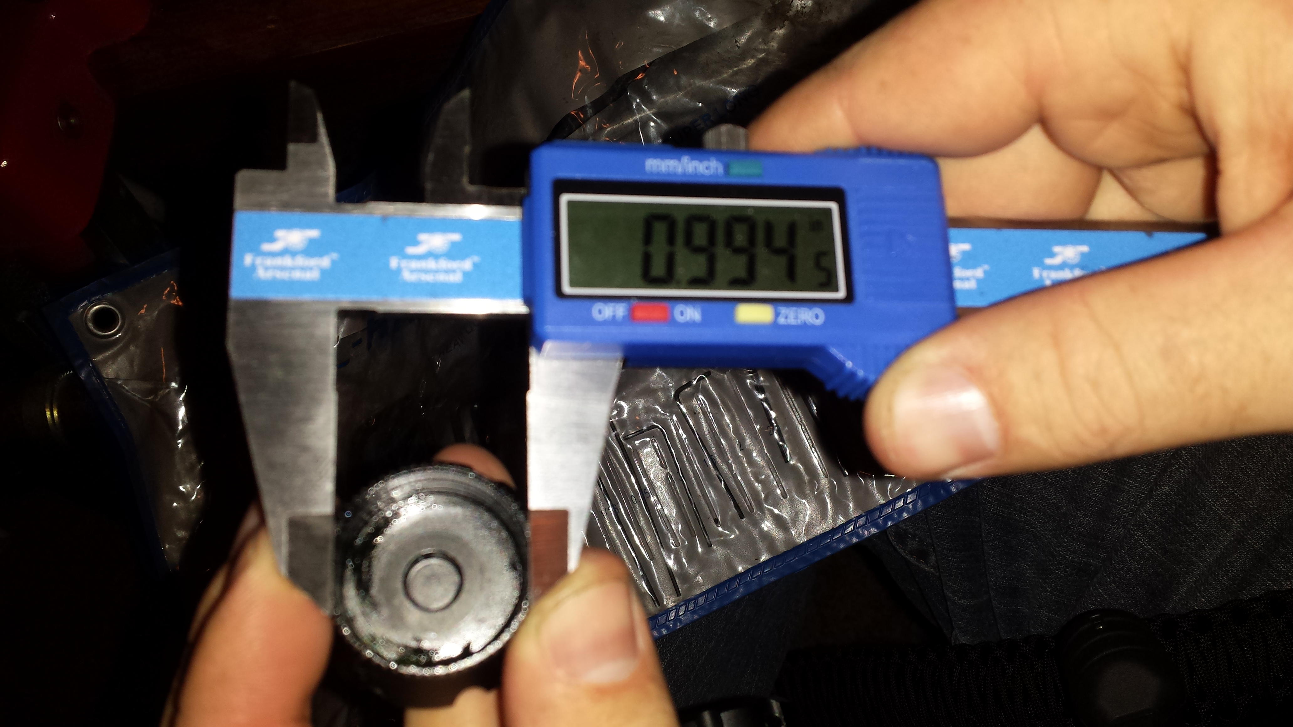

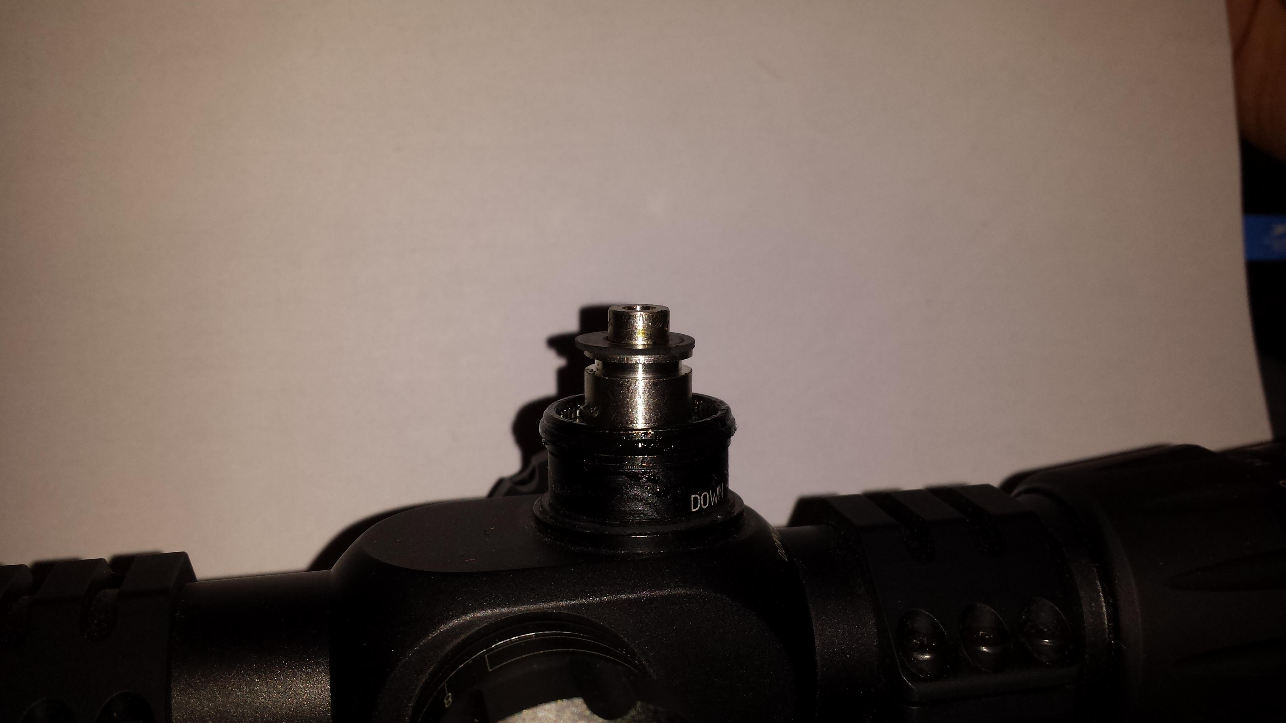

Guys, I have never handled one of these. If you would be willing to measure the inside of the cap and possibly post a couple pictures, I will let you know.
Jared
This is a Falcon Menace 4-14 with MOA turrets.
Here is the cap.
The stem
(looks like I have to make this a two part post due to size of pics being uploaded to forum)
(not sure what happened to my other post, please delete one if this ends up being a double post due to some sorta massive delay or something in my other post showing up)
Top and thinnest part of the stem
Middle notch of the stem
Bottom and thickest part of the stem
