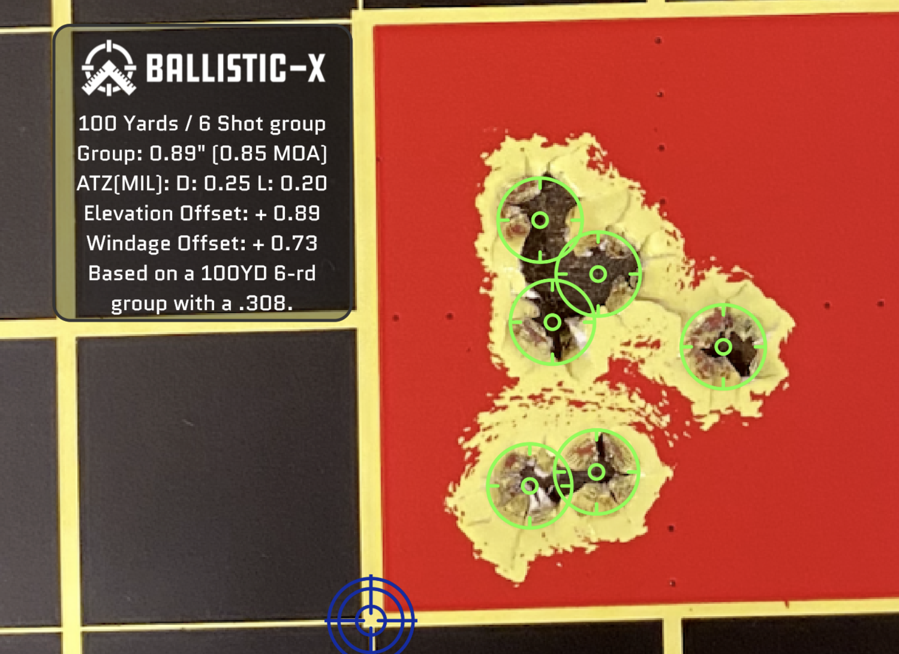

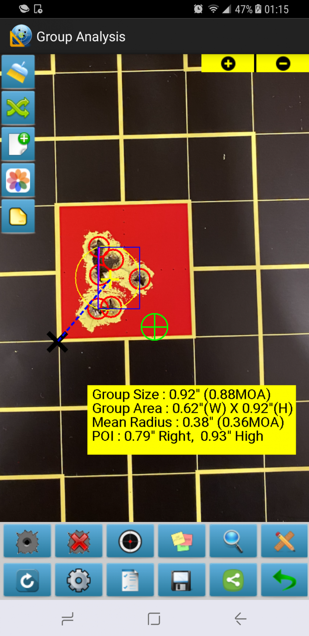

Guys, please help I don't understand my zero data. I shot 9 rounds at 100 yards. All nine I shot with the aim point being the lower left corner of the big red square in the middle. The first 3 were the ones up high and then I used the vortex tool to adjust the black dial in the scope.
Now, the next 6 are in the big red square but I don't know what this means since I was aiming at the lower left corner of the red square which I would think means the center of this group of six is about .8 inches high and .8 inches right. So I assume I should now adjust the scope again by however much that amounts to in mrads? How tight do I need to pull it in before its a good zero?
  1. is there a way of knowing the center of the group? Is there a standard way or a lot of different ways?
  2. knowing these black squares are one inch squares, is there an easy way of converting to mrads?
  3. would you also zero the windage based on what I have here?
  4. when is your zero good enough to move on? What's your personal standard for "good enough"?

There is 3.60” in 1 MRAD at 100 yds. If your scope has turrets w/ 10th clicks then 10 clicks is 1 MRAD. 1/10th is .36” so adjust away.
Me?, I’d take it out to greater distances and see what you have.
Really close where your at...

Too easy man. I’ll hit the main questions first and try to give some advice at the end.
Answers:
1. The fastest and easiest way is to use your reticle, which should be calibrated in Mils based on your concerns. So use the reticle like a ruler. Another option you could try, if you’re unfamiliar/inexperienced with reading the subtensions of your reticle (which should be addressed ASAP), is to download the Ballistic-X app. This app will also help you with finding the center of the group and the exact POA/POI offset.
2. Yes. The tighter your group is and the closer you can get it to your Point of Aim (POA), the better. This will spare you a lot of frustration down the line. Fear not though, because even if you couldn’t mechanically adjust the group any closer than what you have, you can use software to compensate for the shift. BallisticsARC has an app that lets you input the zero offset, which will take into account your actual zero range (are you zeroed at 100yds or 96yds?) and what your offsets are. So let’s say you left it like this and grabbed both apps I mentioned. Ballistic X gives you an elevation offset of .2 mils up and .2 mils right (correction would then be .2 down and .2 left). You get a buddy to use a rangefinder (if you don’t have one) and get the actual distance to the target from your firing position, let’s say 96 yards. You then take that info and go into BallisticsARC and input it under your rifle’s profile. The computer takes care of the rest and will adjust your data fields to compensate for the offset.
NOTE: This is great for fine-tuning zeroes, but you need to focus on building a solid foundation of knowledge and competency before you just accept what’s on paper. Not a slight against you, just too many people say“that’s good enough” just to get frustrated at distance when they arent hitting.
3. Personally I demand a lot of myself and it can sometimes (oftentimes lol) be a hinderance for growth. Don’t be too hard on yourself because you’re shooting for fun, not for work. I personally hate grouping drills but they are a necessary evil. I’d give your group a quick correction of .2 down and .2 left, shoot a confirmation group, and as long as your size is the same, record it, float/slip your turrets, and move on for the day.

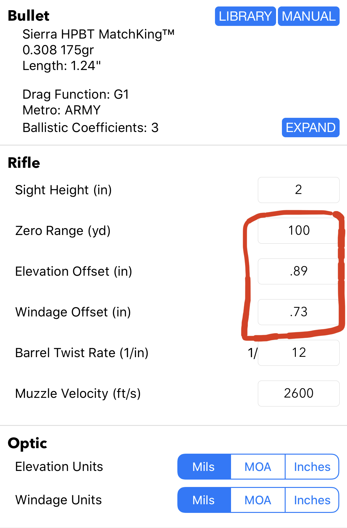

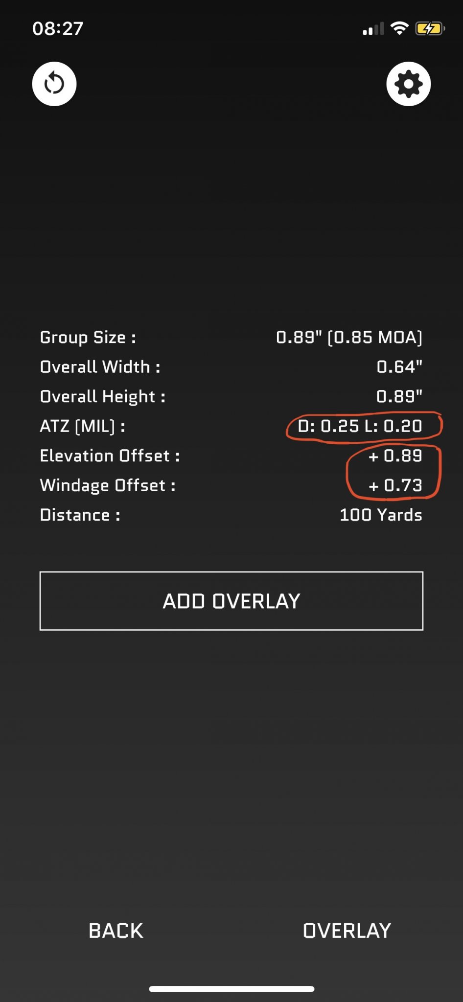

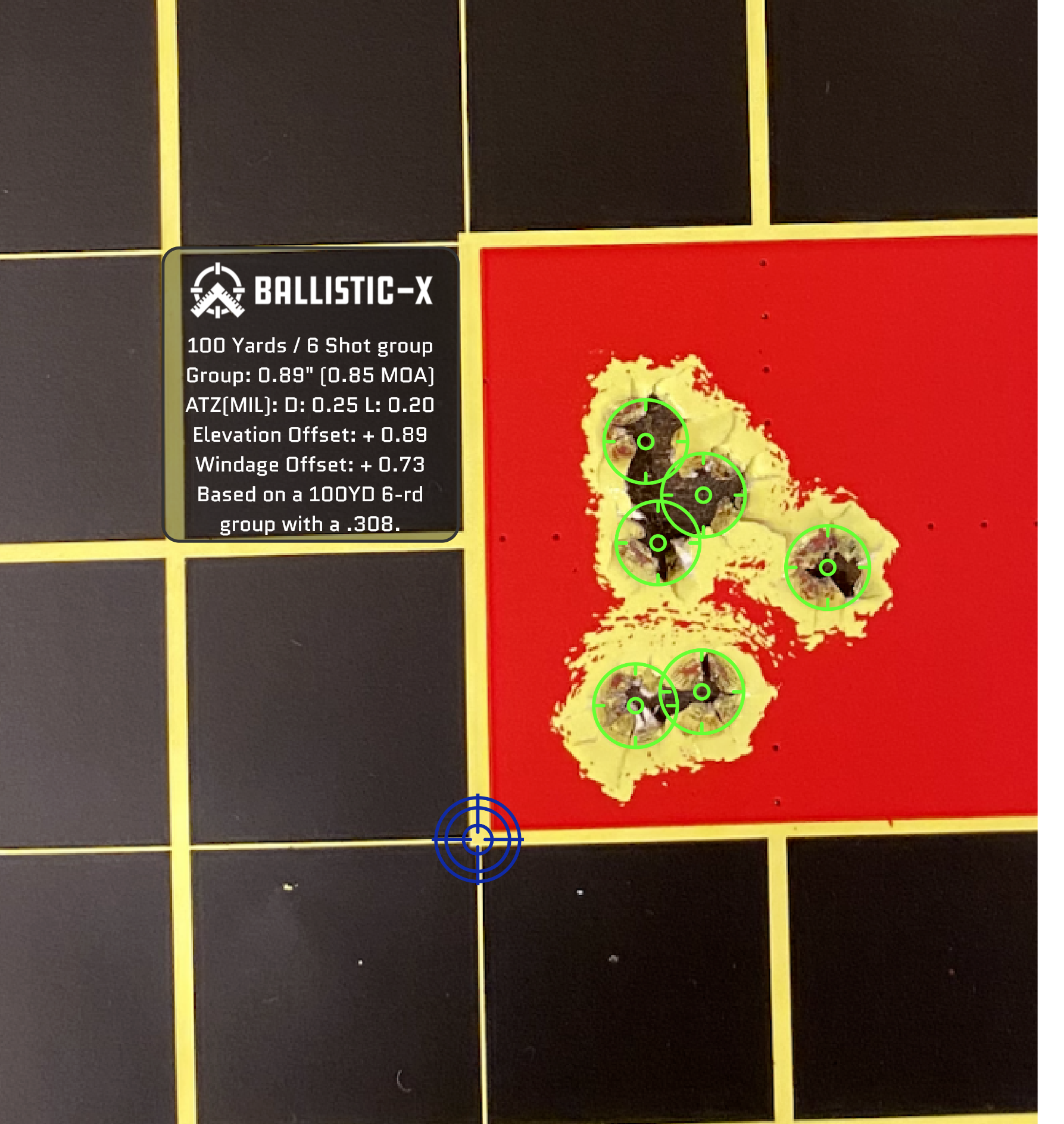

^BallisticX app with the overlay showing you your ATZ (Adjust to Zero), aka what you’d need to dial in order to get yourself dialed into your POA. You obviously can’t dial the .05 difference, so you’d have to choose between .2 or .3 on elevation. Either way, you’ll be fine at this point. You also have your group size, which is .85 MOA, so good enough group size for ensuring a decent zero (so keep it up and it will get tighter). NOTE: All of this is based on 100yds and a .308. If you aren’t running that caliber, or the range was actually 102yds or 95yds, then the numbers will obviously change slightly.
^BallisticARC app
Here’s where you’d put in the information so the computer can calculate your data. Too easy. The app also allows you to true your data as well, but that’s a topic for another thread thats been covered multiple times before...as has this, but I figured I’d try an help.
I hope I was able to give ya some answers that made sense.
View attachment 7249800^BallisticX app with the overlay showing you your ATZ (Adjust to Zero), aka what you’d need to dial in order to get yourself dialed into your POA. You obviously can’t dial the .05 difference, so you’d have to choose between .2 or .3 on elevation. Either way, you’ll be fine at this point. You also have your group size, which is .85 MOA, so good enough group size for ensuring a decent zero (so keep it up and it will get tighter). NOTE: All of this is based on 100yds and a .308. If you aren’t running that caliber, or the range was actually 102yds or 95yds, then the numbers will obviously change slightly.
^BallisticARC app
Amazing info, thank you very much! I need to ponder this and download these apps.

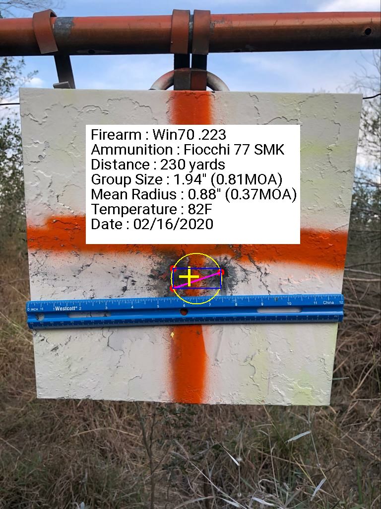

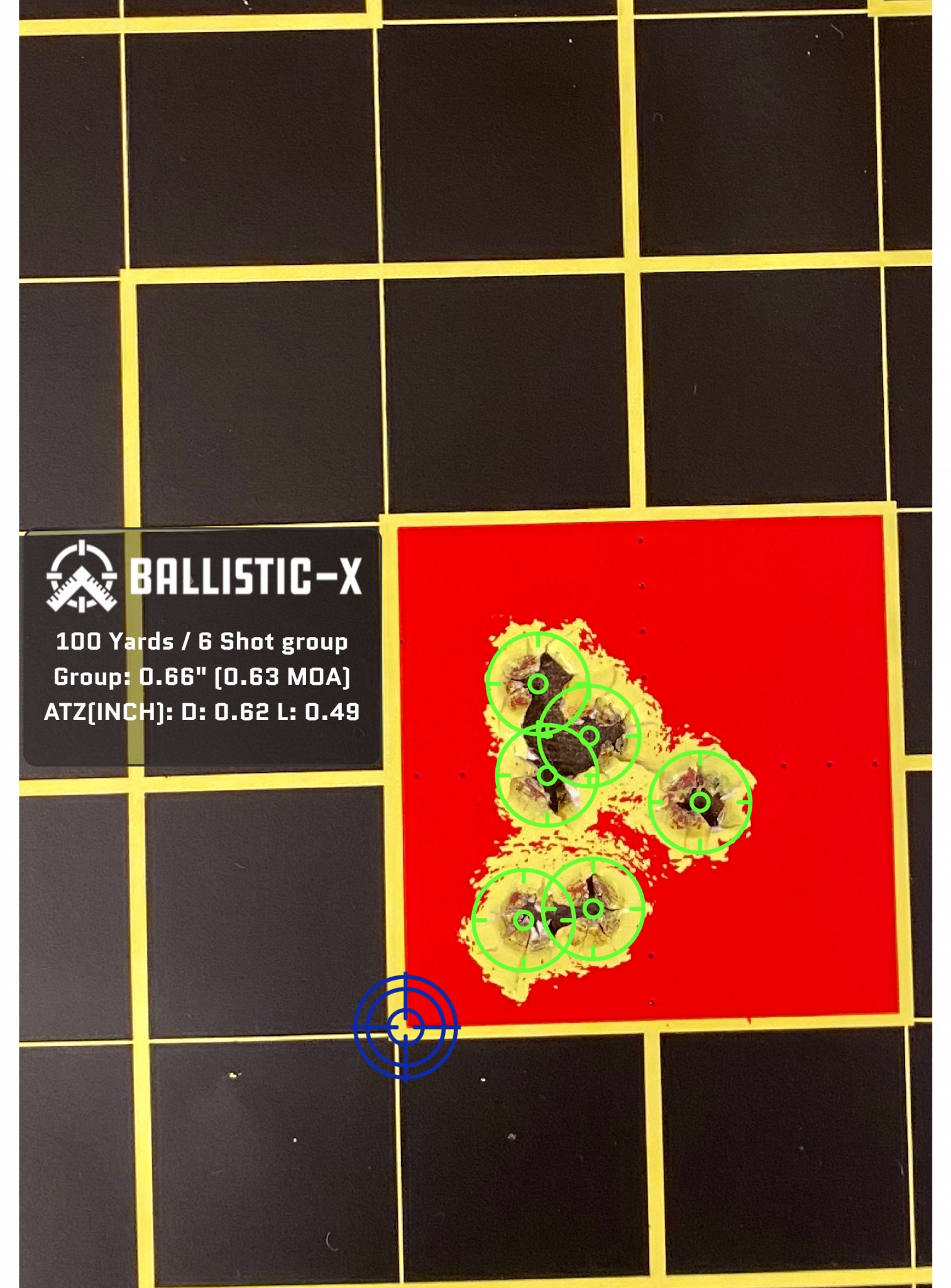

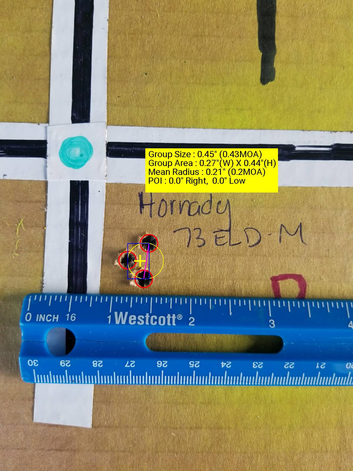

Mine looks the same as yours but the MOA number is slightly different. Must be some tiny differences in how we chose the bullets. Yours is on top, mine below. Cool app, thanks!
Reactions: M8541Reaper
If you’re shooting 308, then your 1” scale is off. The most important part on using the app is making sure you get a solid scale reference. When I did yours, I zoomed in to the left and used the intersection of the thin lines for a fine scale reference and not the thick lines. I’d your scale is off, then the impact ring markers won’t be the same size as your actual impacts, like you see with yours.
If you are using targets that don’t have any sort of scale or aren’t standard 1” or whatever you can either input the exact size in the app or place a ruler or tick marks on the paper before taking a picture.
I always go to shooting dime size dots when I get that close. I shoot one round per dot. After five shots I gather my middle of the group! I adjust from there as I want it to be dead center!
Reactions: Walter Haas
Don’t worry about what the measurements are on paper. No need to convert inches to mils or anything else.
If you were aiming at that bottom corner, put the center of the reticle there (or any other part of the reticle. Whatever is easiest for you).
Measure how high and right you are from you POA. Then adjust those measurements down and left.
You have a ruler in your optic right in front of you. Use it and don’t worry about how many inches, cm, or whatever you use.
This!!!
I did it myself and my results are below...
I'll personally place a ruler so I can have some thing to reference on my app.
This!!!

If I’m shooting paper, my targets are printed to scale and have 1” references. Steel gets a ruler if I’m going to run it through Ballistic-X.
