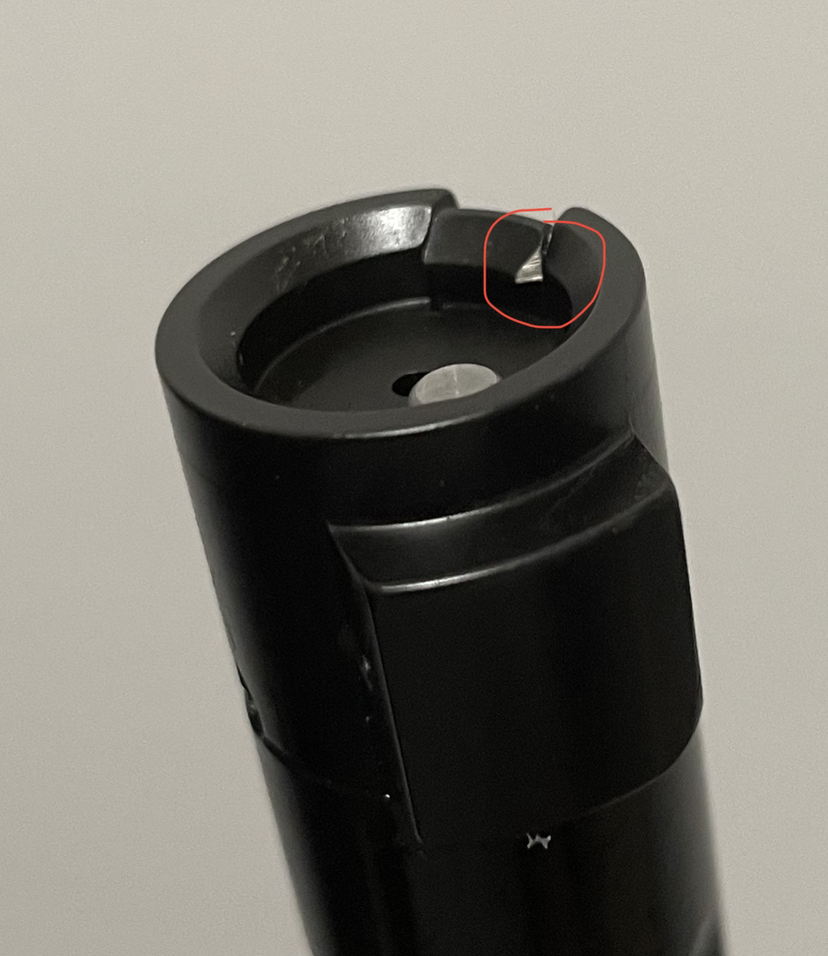

Trying to figure out what you have seen people have to modify on a Lone Peak to get them to work? Mine has worked flawlessly since I bought it.
Was the extractor hanging?
With certain scope mounts and case designs, if you do not make this mod, the brass will not extract from the chamber, it will bounce back in and cause a malfunction. I am not exactly sure how it happens, but I presume it changes the angle that the case gets flung out, helping it clear the port instead of hitting the top of the action/Sphur bar and bouncing back in.
Its a known issue with most the big Lone Peak smiths, they just don't talk about it.
I brought it up to the loan peak guys at a NRL hunter match a year or so ago. They pretended like they didn't know what I was talking about, which is bullshit becuase I know 2 guys who called them and asked them how to fix it. This was the advice they were given.
Lone peak makes a great action, its just something to keep in mind.
Reactions: C Cape
Everything has issues it seems. I know people who carry extra firing pins and bolts around for their impacts due to having problems with bent firing pins.
