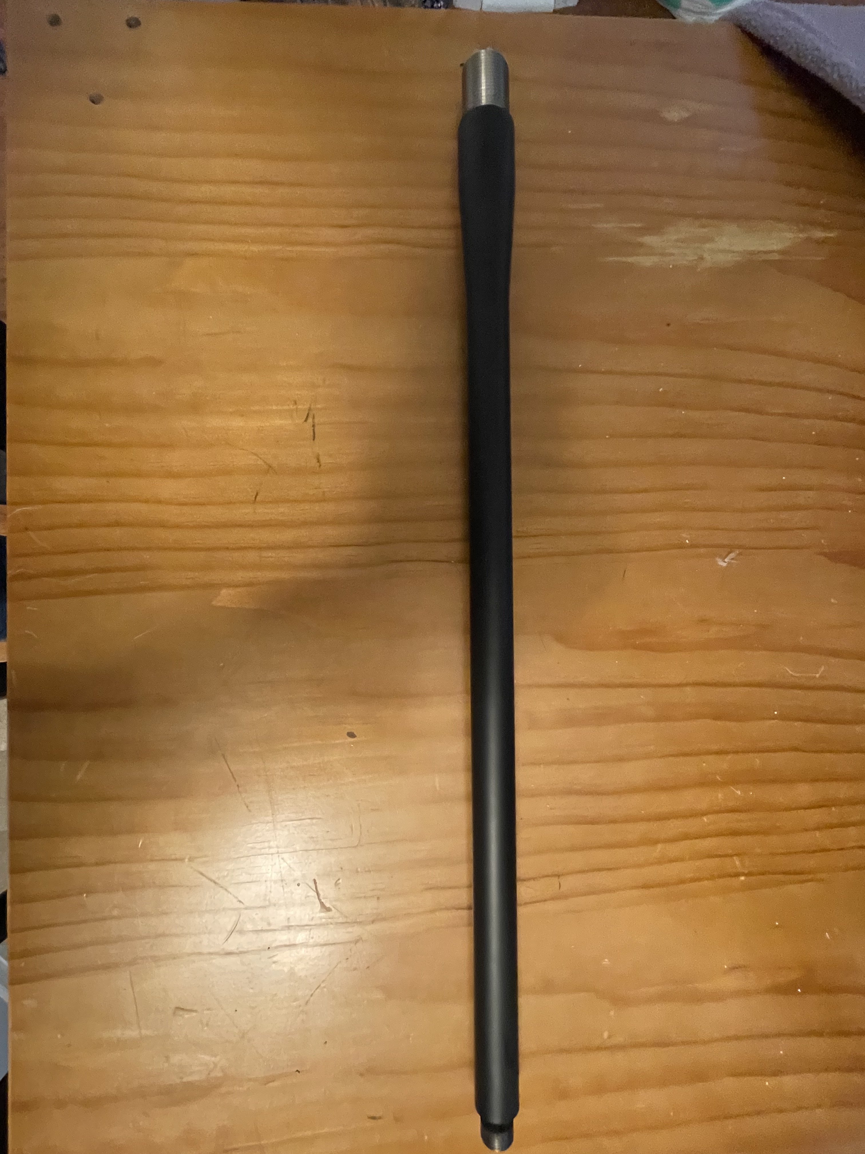

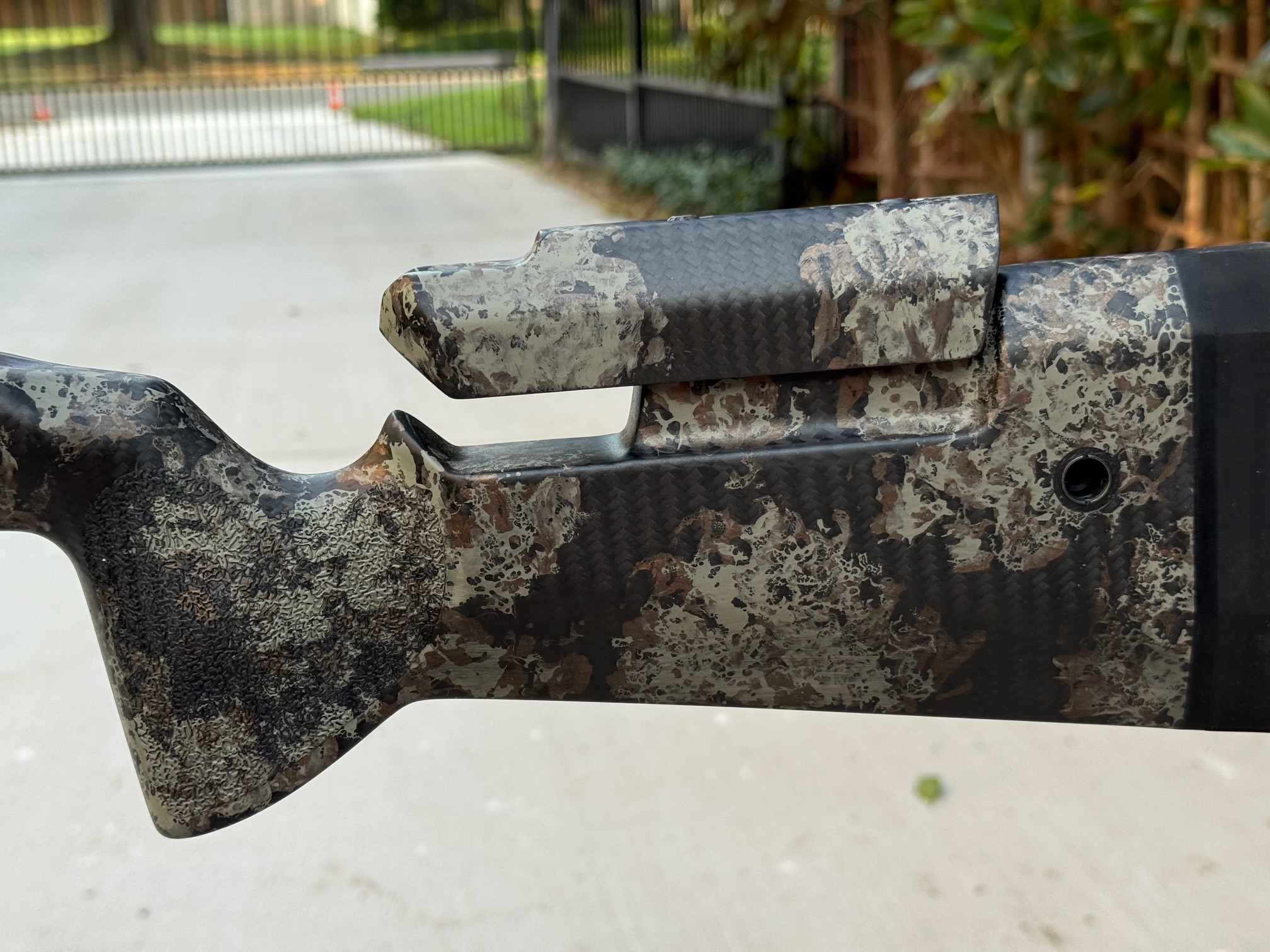

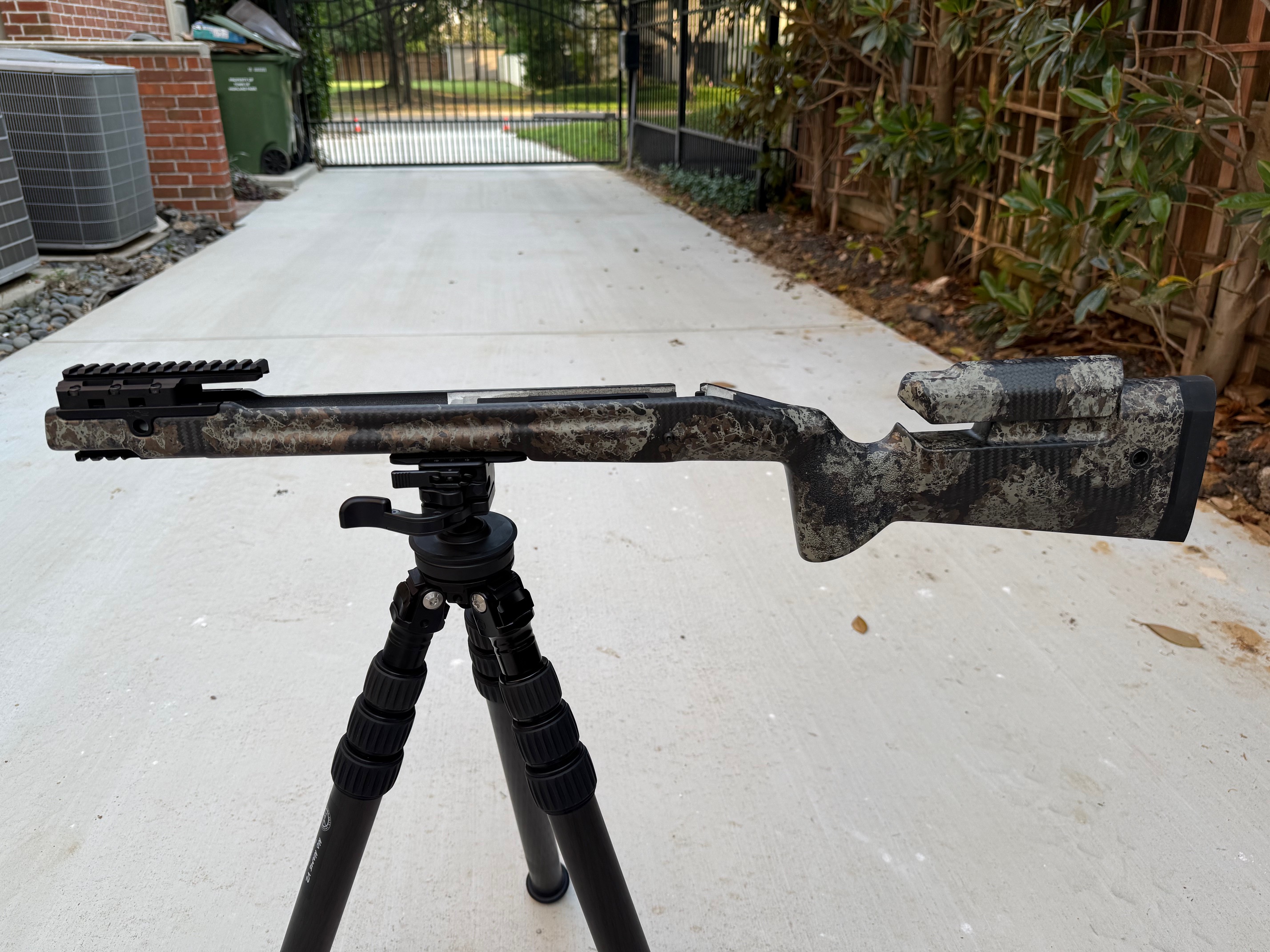

Details are the following:
Kelbly BlackBear Tactical - SA, RH, 308 BF
6bra barrel 26” threaded 5/8”-24, unknown round count, unknown make, and unknown smith - basically just a fireform/place holder barrel
Xlr envy Chassis JV version with Ergo grip. (Needs buttpad) everything else is there.
Trigger hangar is on its way, but included in the price
Askin $1000 + Insurance cost. For anyone one that knows about these actions they are discontinued but are extremely nice and absolute tanks. Can’t buy an action for even this price, let alone the chassis. I have talked with Kelbly and they said they would support the action for its lifetime
It’s a flat bottom steel tactical action that takes AICS mags. Integral lug and integral rail, and one of the smoothest on the market.
Only trades are:
Bighorn origin/TL3 Steel light contour 6.5creed or 6.5prc barrel
Hunting oriented stock - KRG bravo, Manners w/ mini chassis, McMillan
