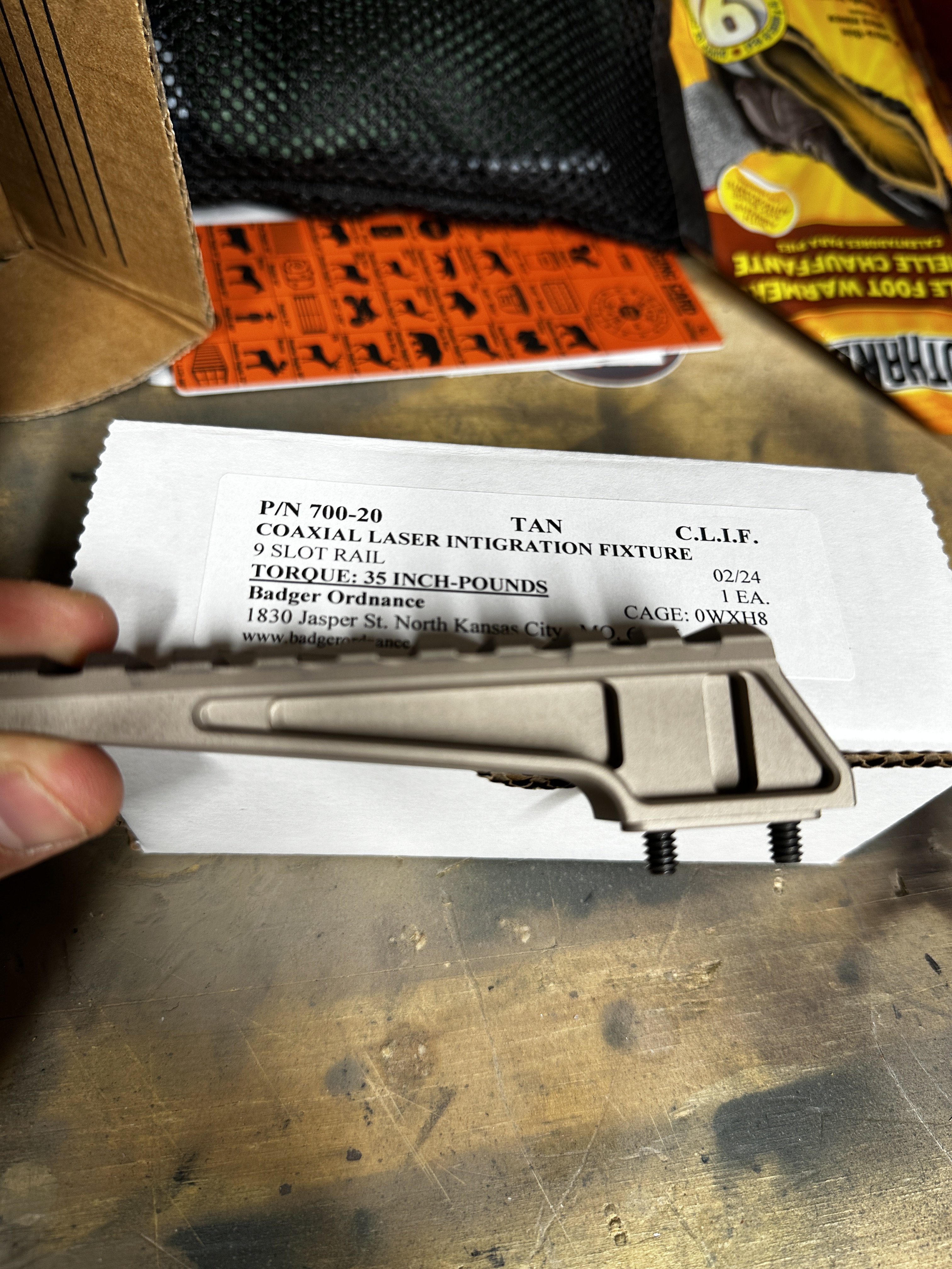

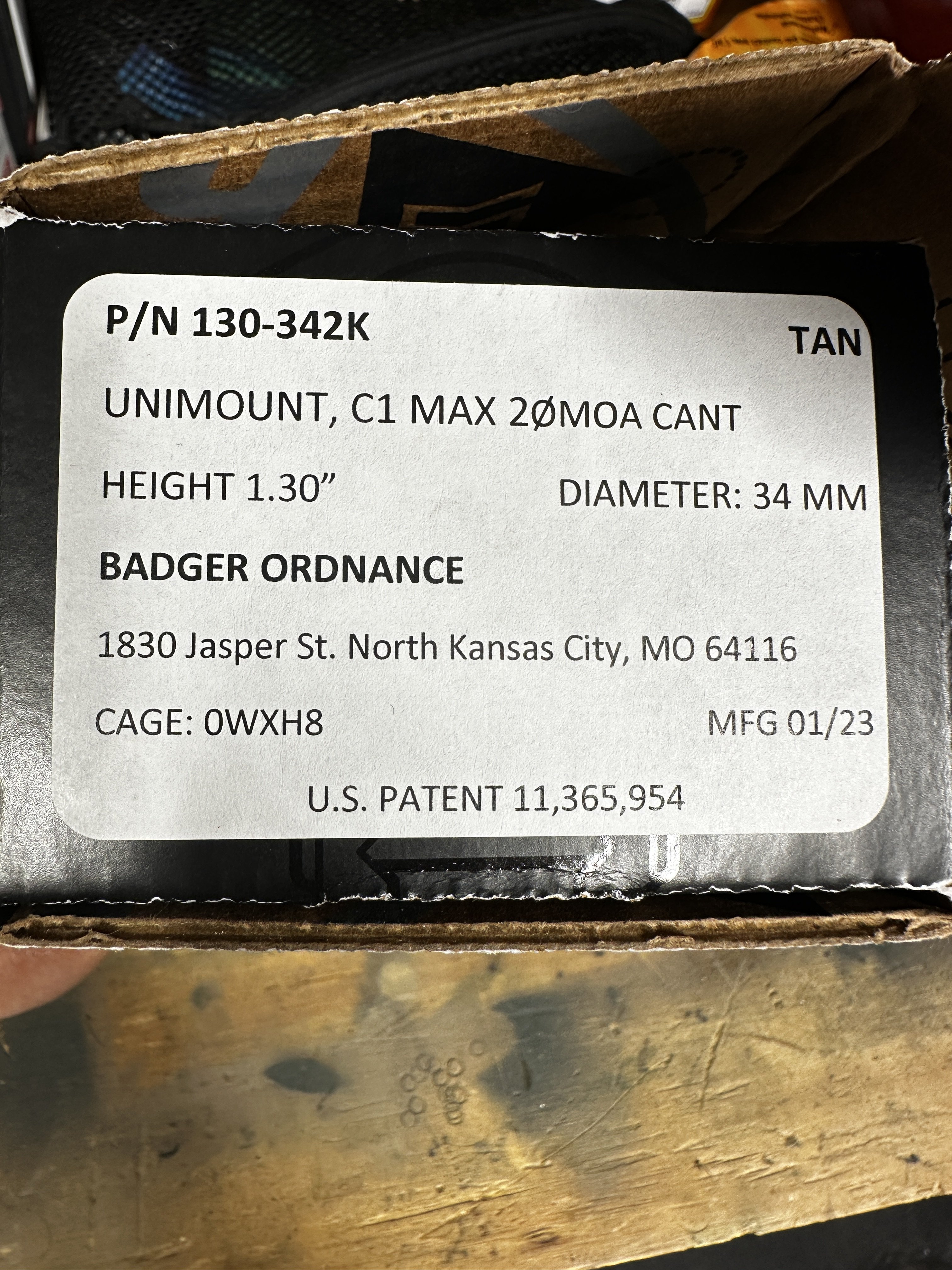

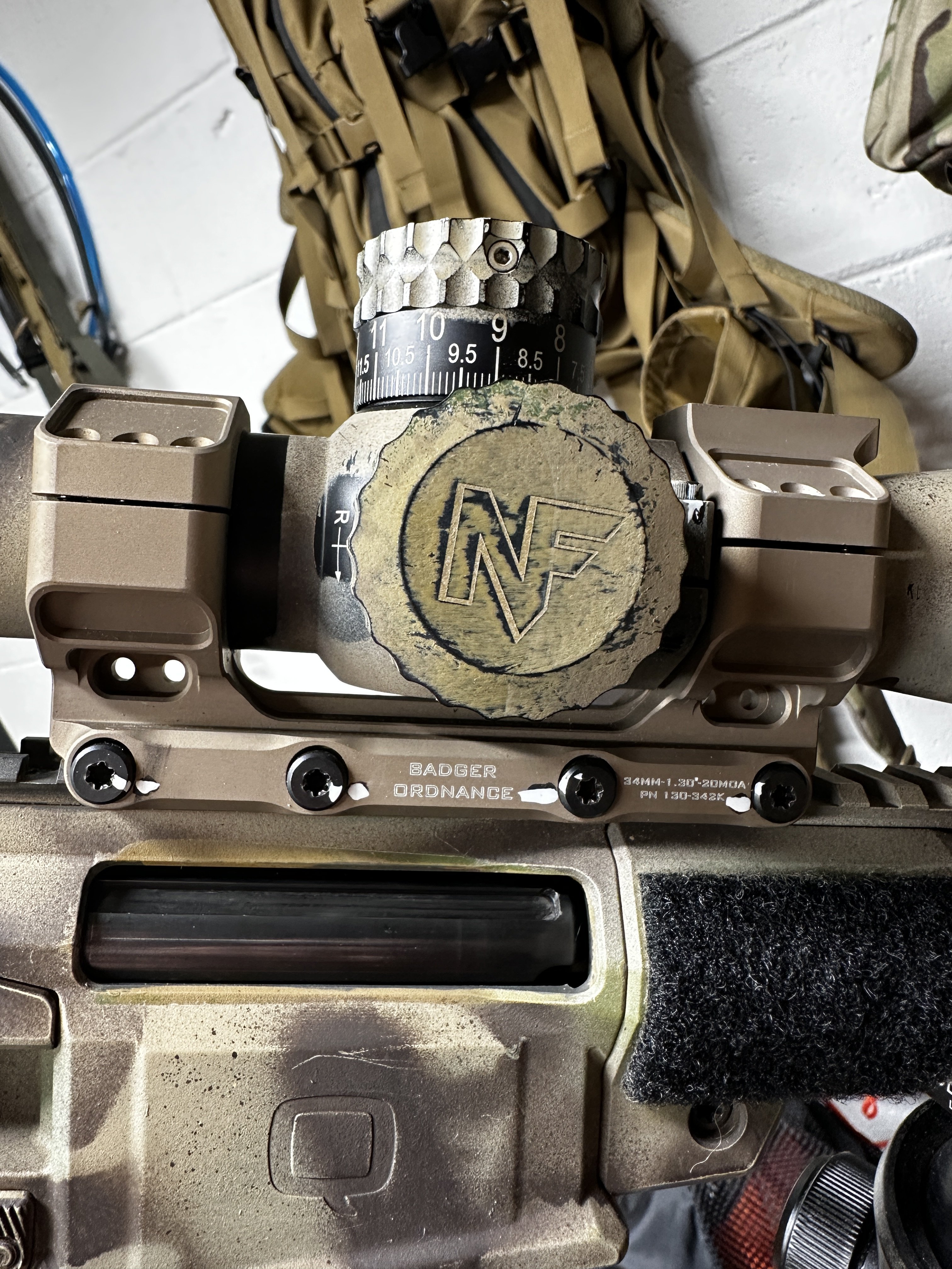

SOLD Badger 34mm c1 max 20moa 1.3" mount + cap/clif
That's a mouthful - full c1 max setup for the low low.
It's been mounted/paint marked. They finally came out with a direct mount for the fix, only reason for selling.
C1 (1.3" in height 20 moa built in) max in tan, clif 9 slot in tan, cap in tan.
Would like to sell together - $400 ppff or Venmo.
