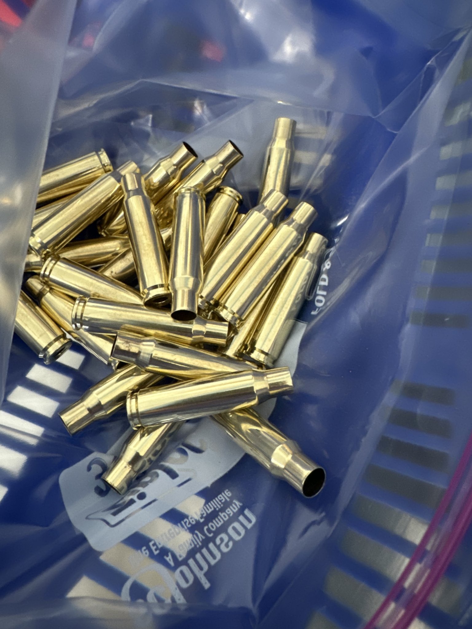

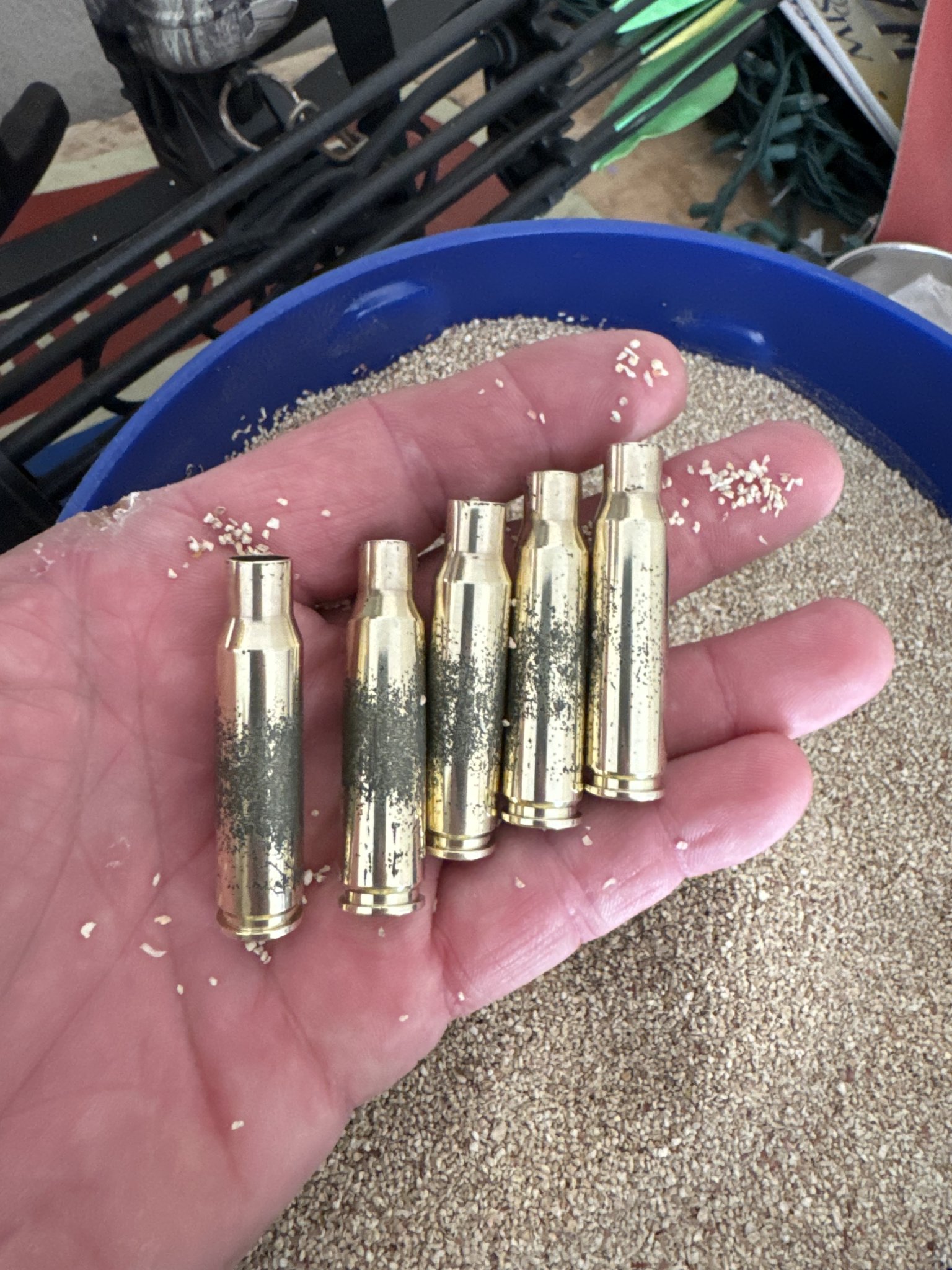

Got a new Frankford tumbler a couple days ago and put fresh corn cob media in and let it sit in the garage with the lid off and fan running for a few hours to get most of the dust out. Then added the Frankford polish as per instructions and let it run for about another hour. Then, when tumbling my first batch of once fired factory brass it came out real clean but had sticky residue on em. It wipes off with a little effort but WTF??! I have never seen this before. Anyone out there know what this may be?
After running for about 16 hours with no better results I threw out all the media and did an untreated 50/50 mic of walnut and corn cob. It is slowly removing the residue. I have used NuFinish and Flitz before but never Frankford polish. Thanks for the comments and suggestions guys. Will report outcome later this eve.
Reactions: pell1203
Also walnut is shit. Stick to corn cob. Those sharp hard little nuggets work better than the “softer” walnut stuff
Walnut media Is harder and more aggressive than corn cob media.
It will clean faster especially very dirty brass but won't give the same high polish in my experience.

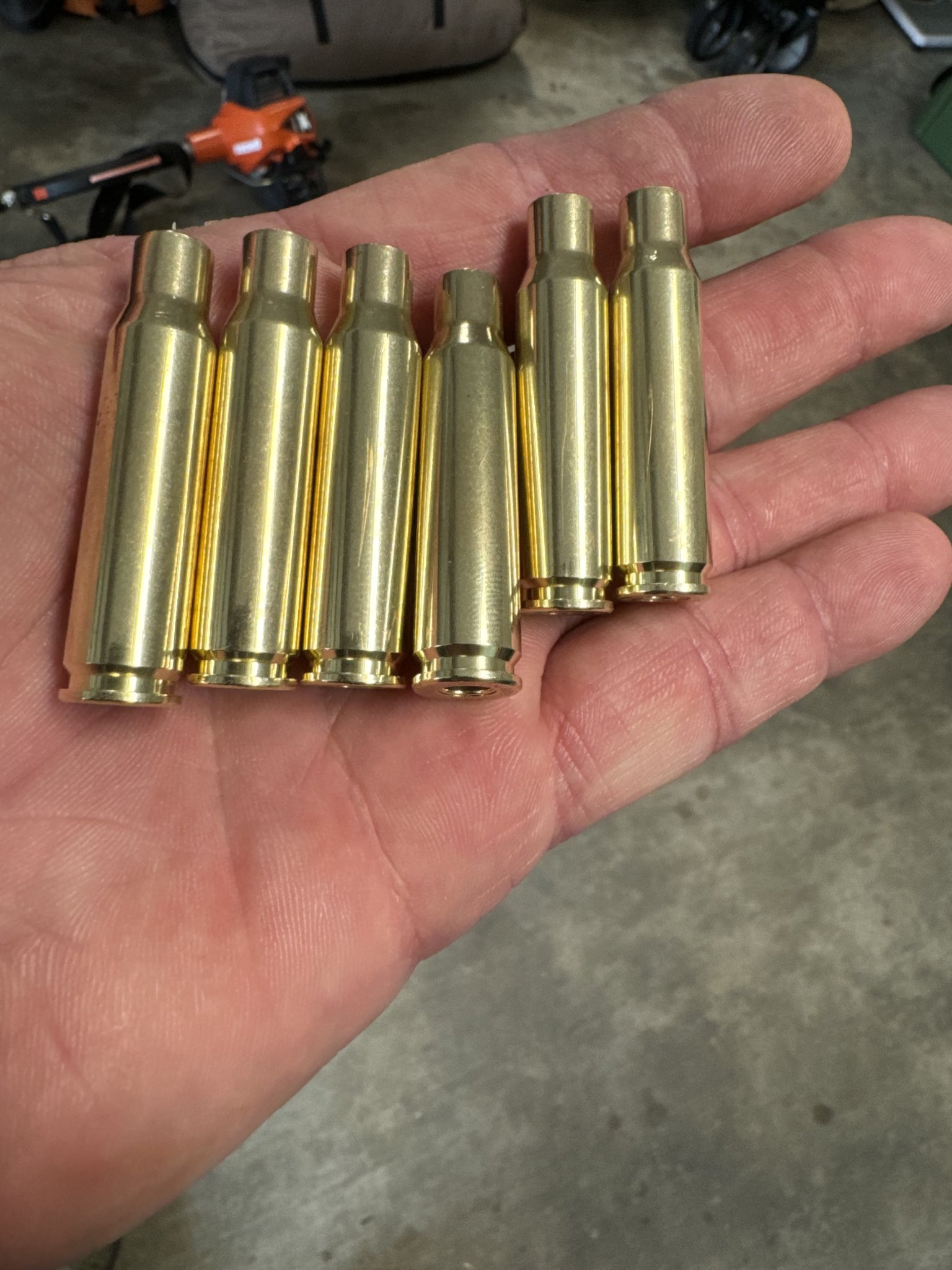

Well been about 3-4 hours in the untreated 50/50 mix and here are the results! Much better and what I am used to seeing. View attachment 8420256View attachment 8420257
Another trick you can use since you mentioned the dust, throw a used dryer sheet in with your brass and media.
It will collect the dust and crud and help keep your media cleaner, then toss it after a cycle.

I have that tumbler and it works great. And the Frankford’s corn cob has minimal dust.
Did you run the tumbler without brass for 5-10 minutes after putting in some polish? I’ve used NuFinish and the Frankford stuff ands never had that result.
I also use the cut up dryer sheet.

What I meant was water is cheaper than replacing corn cob.
I use a harbor freight jumbo tumbler since I'm typically processing 500x+ pieces. I initially add 2-3 caps of flitz to the media(can also use turtle wax, same shit even smells the same) let the tumble run and hour or two for the polish to evenly work it's way through the media. Add your brass and a few used dryer sheets, and in 2-3 hours my brass looks new. To keep the brass polish consistent I usually add a other cap of flitz after running 2-3 cycles of cleaning.
FWIW... I found the design of the "tub" can dramatically speed up the time needed to clean brass.
After my MidwayUSA gave up.. ( after many years of use ) I bought a fancier brand "expecting" it had to be better... it took considerably long time to get the brass clean.
Swapped the tubs, and the new one finally met my expectations. I could easily see the improved "action".
BTW, when you add the "polish" do you let it run for a few minutes.. distributing the polish ? Mine needed some help... I would have to break loose some clumps at the internal ribs, break those up, and run again for a few more minutes.
I run Lucas and have used Hornady in the past in Lizard Litter (from Pet Smart) without any issues in a vibratory tumbler without any issues. I suspect the Lucas would work well in corn cob but haven't tried it.
OP, it sounds like you may have added all the polish in one spot as opposed to spreading it out around the media or the instructions recommend too much.
Sorry fellas, just now seeing this. I did spread the polish around and break up all the "clumps". Let it ran for one hour like I mentioned in the opening post here. I ended up dumping half the CC and filling the rest of the way with Lizard walnut bedding. Didnt take long for the residue to come off and looks like new now.
I ran it for an hour after evenly distributing polish and crumbled the clumps up while it was running.
Got a new Frankford tumbler a couple days ago and put fresh corn cob media in and let it sit in the garage with the lid off and fan running for a few hours to get most of the dust out. Then added the Frankford polish as per instructions and let it run for about another hour. Then, when tumbling my first batch of once fired factory brass it came out real clean but had sticky residue on em. It wipes off with a little effort but WTF??! I have never seen this before. Anyone out there know what this may be? View attachment 8420183
Add a couple of tablespoons of mineral spirits or rubbing alcohol to the media and let it run a minute before adding the brass.

I read this somewhere else. Didn't try it tho. Removing roughly 50% of the CC and filling with Lizard bedding seemed to have resolved the issue for me. Thanks for the input sirs.
