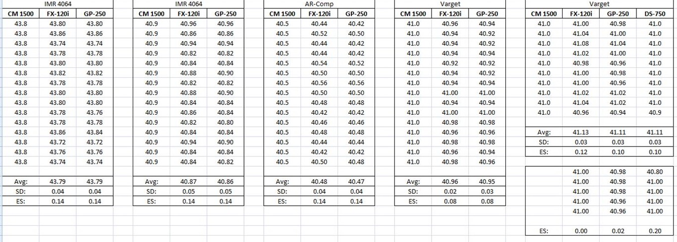

Yes, someone has . . . me ;) :
The difference can be inches at 1000 yds and how much depends on the caliber as well as other factors, including the velocity one is getting.
As one may already know, that the ChargeMaster will be more consistent with some powders than other, much as illustrated above. AR-Comp has regularly been more easy for my to get consistent weights than other powders I've used. And I suppose it's the large extruded powders like IMR 4064 that make it difficult as larger clumps will fall from the tube that ChargeMaster either doesn't register or will show as an overthrow. In the above chart I simply set my ChargeMaster a weight and took whatever I got and weighed it on a GemPro 250 that I've had for a long time that has a resolution to .02 to see what weight I got.
For me, more than accuracy, the goal is consistency. Whatever the amount is, I want it to be the same (or as close to it as I can get) for every cartridge every time I go to shoot.

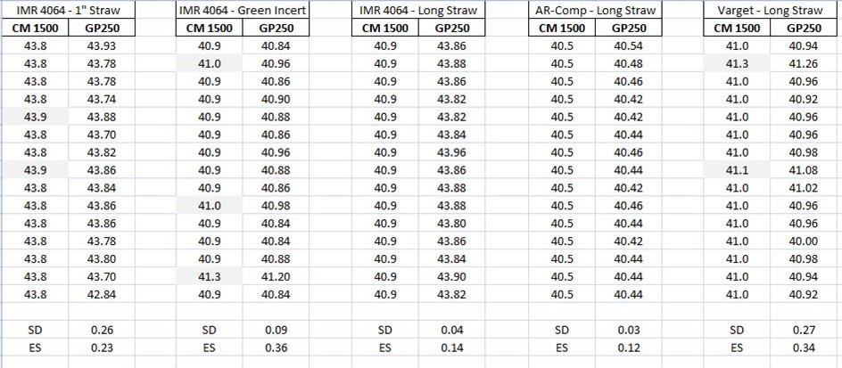

So, just to be clear, my previous post with the weighing data was from a test to see which orifice in the ChargeMaster's tube would produce the better results and used my GemPro-250 to get a fine reading. You can see in the CM-1500 columns that there were some overthrows as I didn't redo any of the throws.

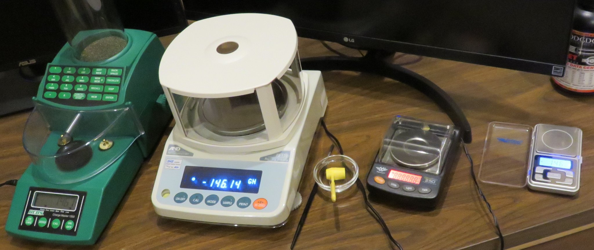

To get some idea of how my particular ChargeMaster unit does and how it compares to my GemPro-250 and how well my GemPro actually does I managed to get hold of an A&D FX-120i to pit them against. And since I'm was doing that, I did a run using my old trusty little Frankford Arsenal DS-750 to see where it stands comparatively.
I'm using a long straw in the ChargeMaster's tube that goes all the way back leaving a small gap for the power to enter the straw (a gap of about 1/16th to 1/8th inch, depending on the kernel size). I've also set my ChargeMaster up for pretty rapid throws, though I get an occasional overthrow, it's not very often and not by much (settings are: 10.00, 3.50, 0.50).
This second run surprised me as my GemPro-250 showed to be as consistent as the FX-120i and almost as accurate. And it shows the CM-1500 to be as accurate as expected. Surprisingly, my little DS-750 was pretty much in line with the CM-1500.
PS: now I've got some cartridges loaded up and the powder charges for each cartridge are recorded and will chrono them to see what kind of difference I get from charge to charge. And with each cartridge's powder weight I've weighed each cartridge's total weight. So, let's see how the numbers work out when I fire them this coming weekend.
