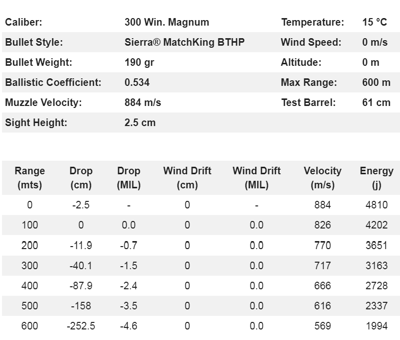

I have the Federal Sierra MK drop chart from the manufacturer to go off but that does not account for differing rifle types I also used their own ballistic calculator and came up with the following chart: I could add in as close to my set up as possible.
Federal Premium Ammuni_ - https___www.federalpremium.com_ballistics_calculator_.png
So, I may have worked this out correct me if I am wrong - at a max distance of 600mts (disregarding the drop in (cm) and only using the drop in (MIL) I have to adjust +4.6. So yes you are correct in that as I have Max 5 MIL in one rotation I should be on target using these adjustments (give or take for environmental and human factors.
The drop chart from Sierra

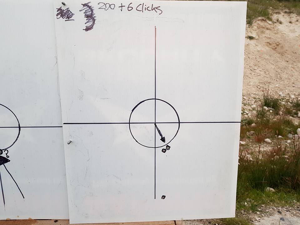

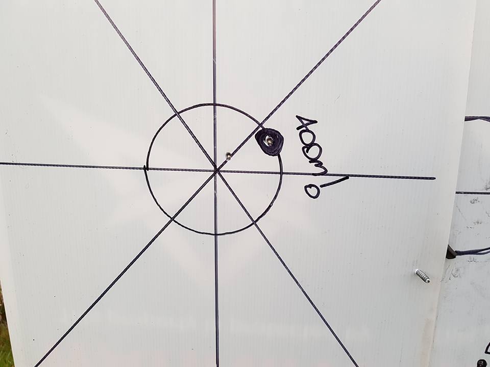

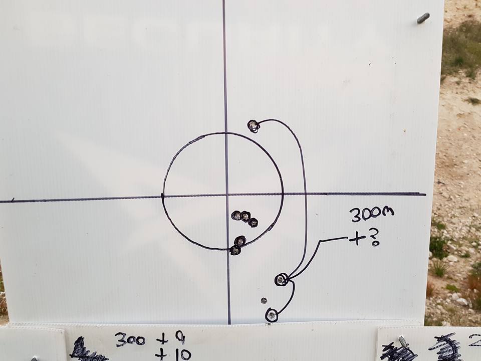

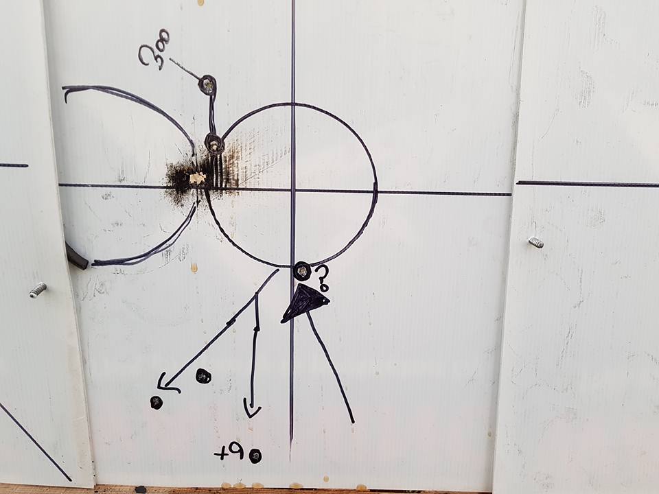

Below Pics are of my shooting, please excuse the crap target backers I forgot my reactive targets. The circle in the middle is 6" round
1st pic is my Zero - taken from 100m the 5 group shot in the middle of the circle. obviously not dead centre but not far off.
2nd pic is 200 M at +6 clicks
3rd pic is 300, the group was all over the place as you can see
4th pic (the hole with no texta mark around it was my last shot at 400M and I think I adjusted +12 or +14.
Range Info - 35.5 m above sea level - temp 20°c and 0 wind.
View attachment 6893550View attachment 6893551View attachment 6893552
