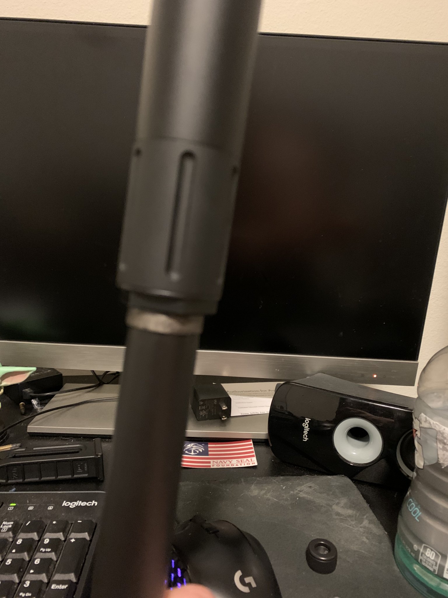

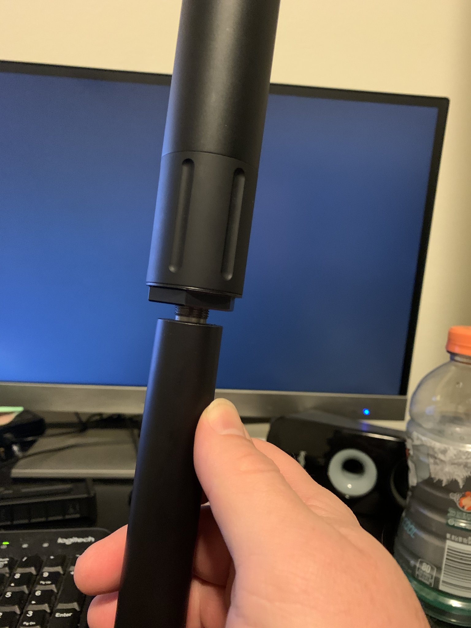

My suppressor on my vudoo wont thread down to the shoulder of my MTU barrel. Known problem, and solution being the thread spacer. I have bought the Delta Threaded Rifle spacer from SilencerCo but with an O.D. of 0.67 it looks weird as im working on building a M40a5(ish) vudoo.
Anyone have a source for a 1" O.D. 1/2x28 thread spacer or possibly professionally make one before i just take a hacksaw to a thread protector and make my own...i already eat crayons dont make me do crafts.

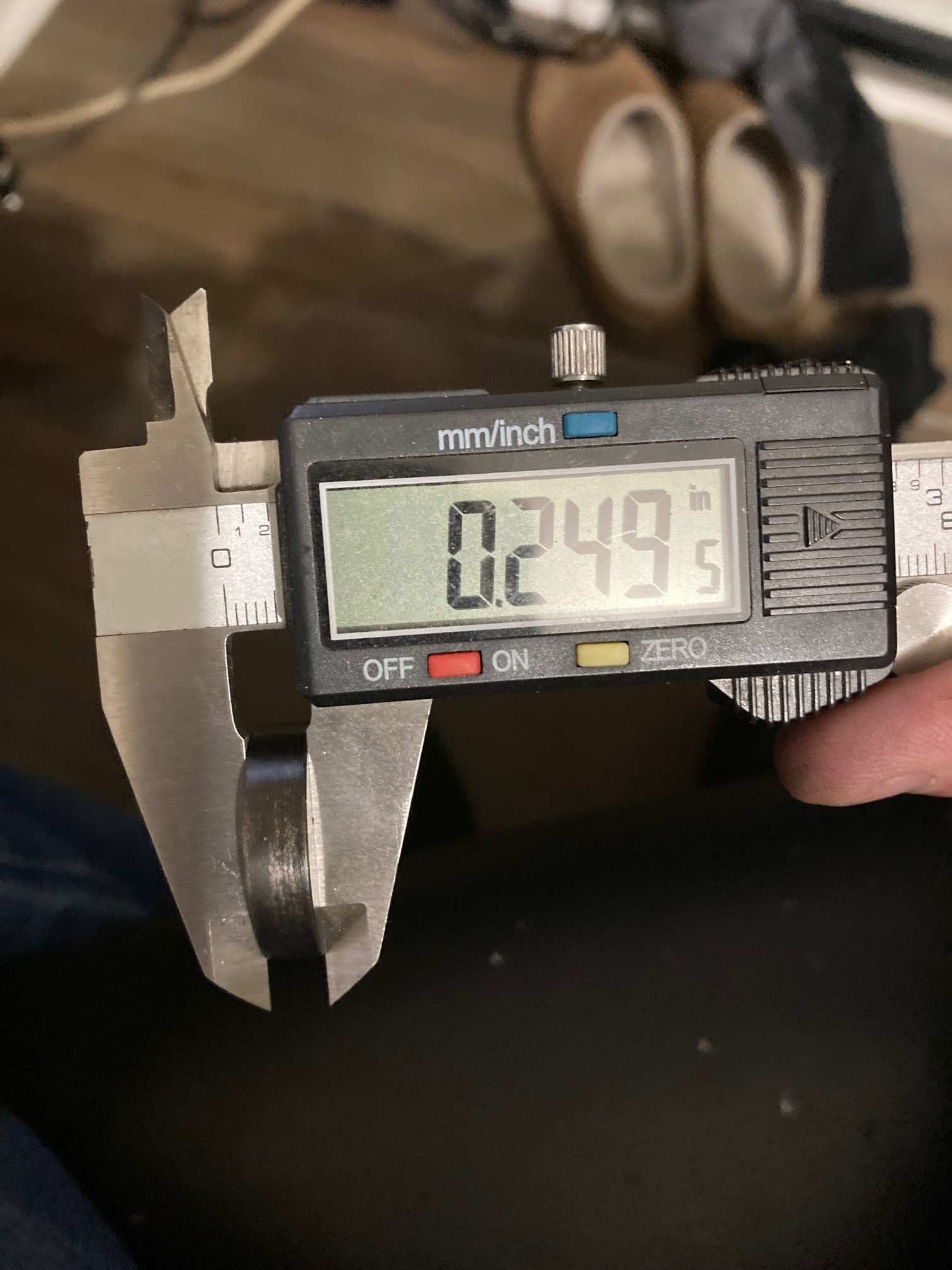

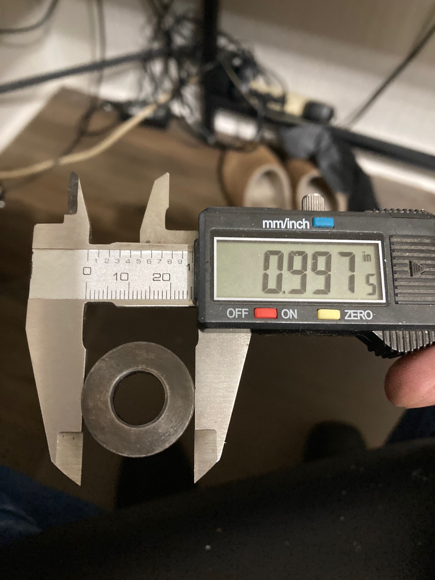

I recently got a mini lathe and I'm having some fun turning metal. I have 316 stainless and aluminum bar stock on hand.
Shoot me an IM with exact dimensions and which material you'd prefer. (no charge)
@Pocket
This look OK?
316 stainless, 1/2x28 threads. OD is .9975" and thickness is .2495". That's about as close as my little Chinese lathe is capable of. I used Caswell Stainless blackener.....not the toughest finish, but you get what you paid for!
I spun it on my B14R and popped a few rounds through one of my F1 cans--no issues on my equipment but I'd recommend using an alignment rod to verify it's concentric before firing. **I'm a pretty good electrician and mechanic but I've never been accused of being a machinist!
If this fits your requirements, I'll put it in the mail tomorrow.
ETA: This was fun--I used a piece of scrap that I had leftover from making a toe shifter for one of my Harleys. 316 is so easy to machine when compared to aluminum--it doesn't stick to the tools or gum up.

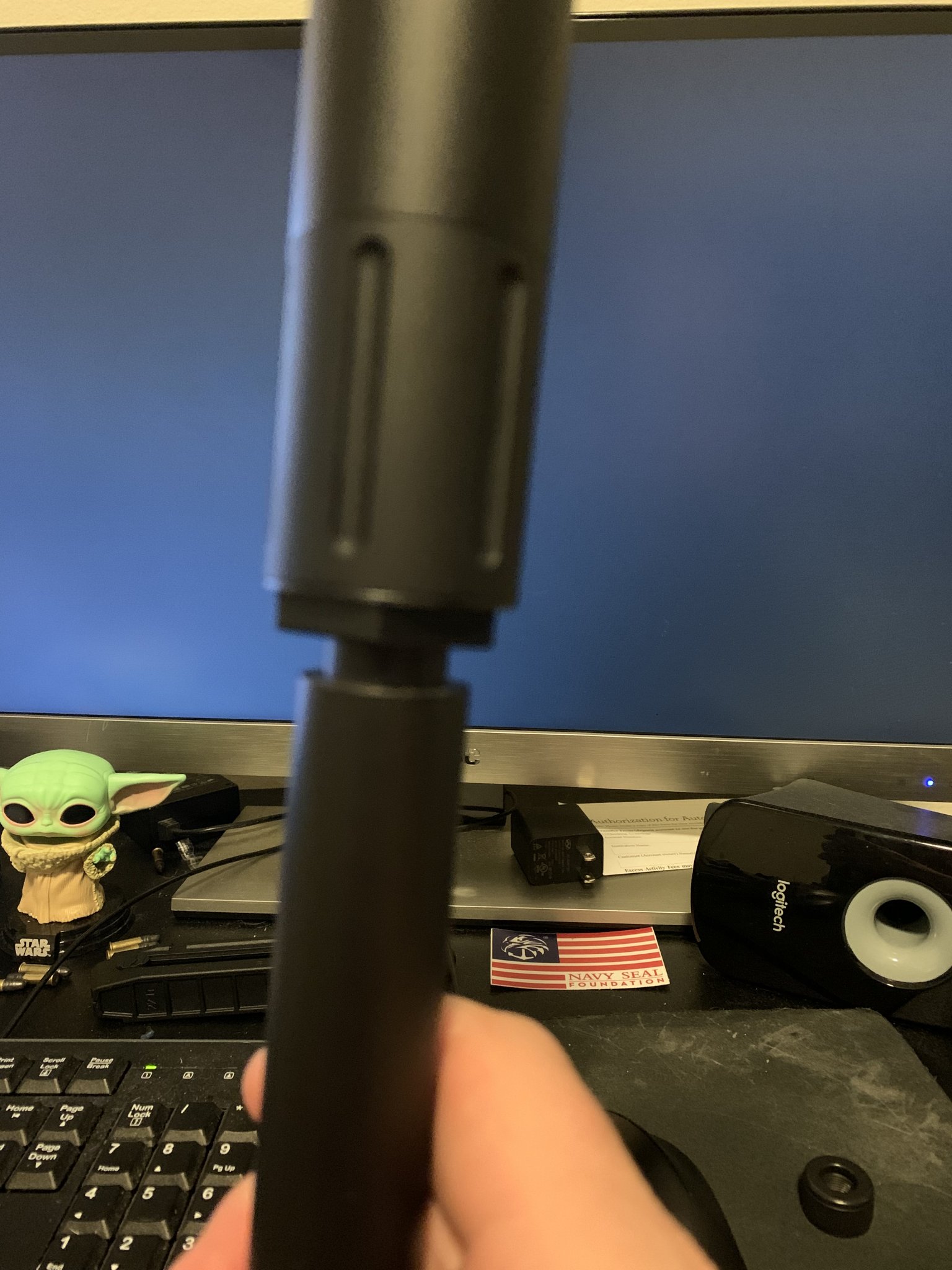

*update*
If pictures work you will see suppressor with no spacer, silencerCo delta thread spacer, and then the 1” OD spacer that was made by our very on @Colt45guy
Lol yeah it was a gap for sure. I dunno if it’s the direct mount for the 9mm suppressor I like to use or the threads are just a bit to long from vudoo. Either way thank you soo much
