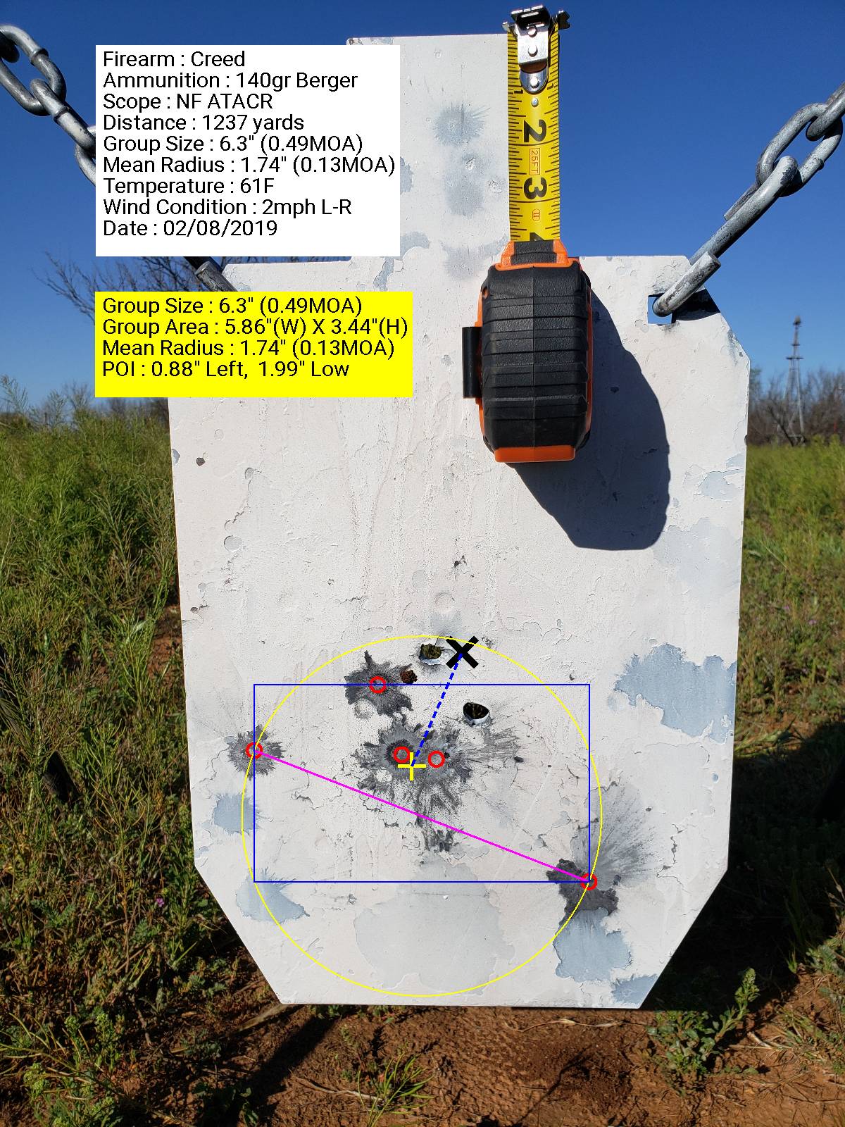

Got it out there today. I stopped at 100yds at daylight to confirm zero. Then went and fired 2 from 600yds, they were dead nuts. Then went to 1237yds which is the distance the Kestrel told me would be ideal for MV calibration. Shot this group about 1/4 minute low. The kestrel said to use 2794fps instead of 2800. Should be ready to rock now.
ETA: just noticed the date is wrong on the pic
