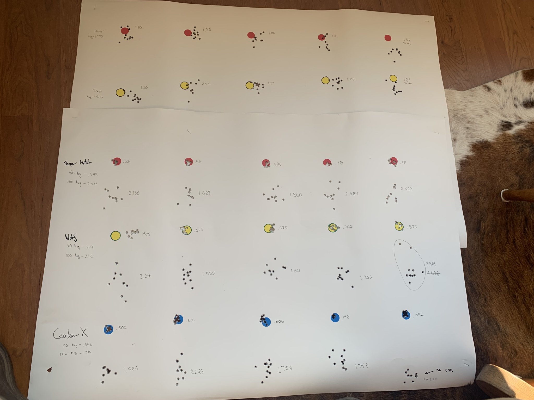

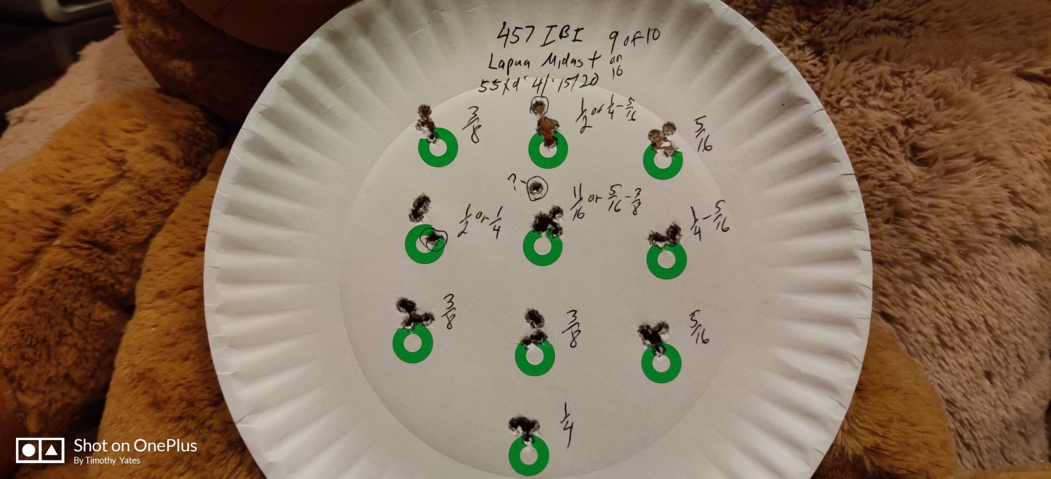

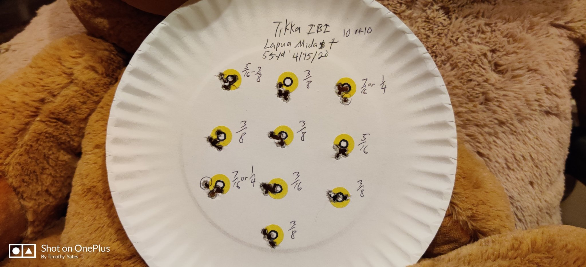

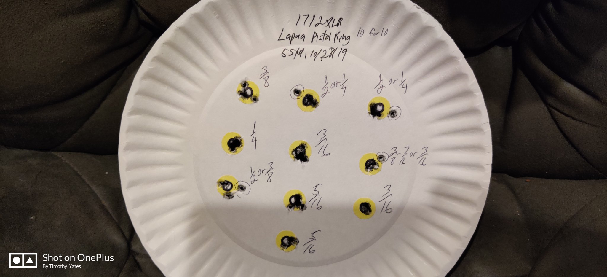

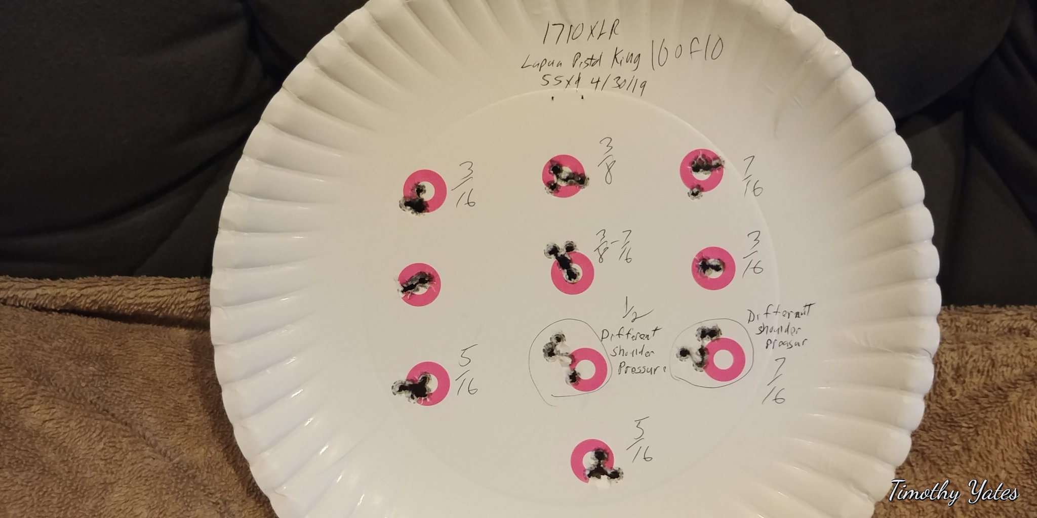

    I’m starting to do more 10 shot groups for load proofing in centerfire ammo once I get a load I like. I started to do it with rimfires too now. I’d like to see what others are getting and how they are comparing to the 5 shot groups.
    Doing a little ammo checking with my Vudoo, less than impressive so far. But, I have other things to change to try and tighten it up

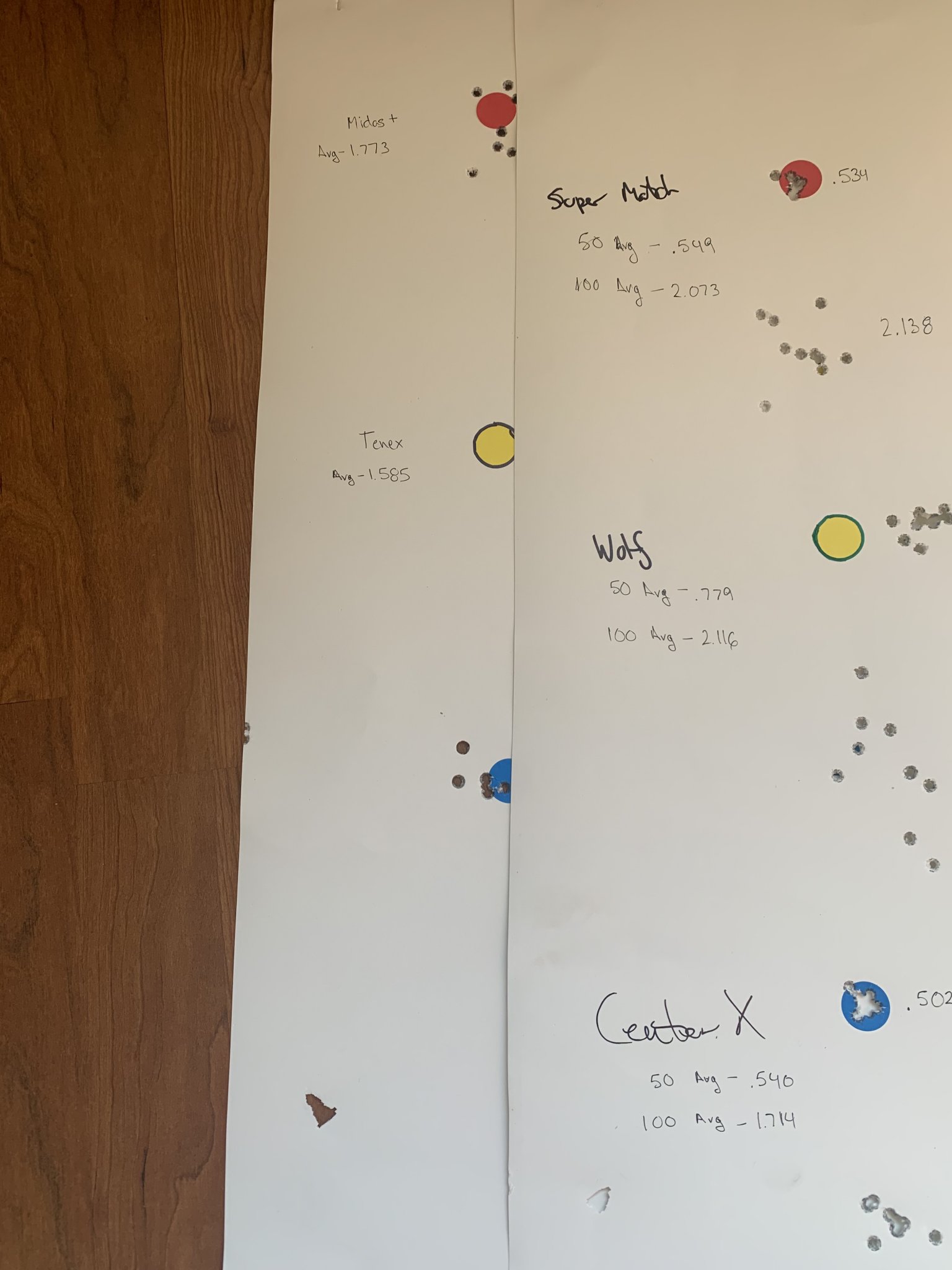

    If you remember, I use the half-third rule to predict results at lesser distances from my 200 yard 50 shot groups.
    Half the distance produces a third of the spread. Look at the 100 yard spread and compare it to the 50 yard spread.
    Interesting, isn't it? ;)
    The larger the sample size, the less likely results will be due to random acts of accuracy.
    The better the quality of the ammunition can be determined.
    As long as you hold a common aimpoint for each group,
    it's very easy to build a composite group from all ten 5 shot groups.
    Another method to produce a measurement of overall spread.
    Same as is used at the Lapua and Eley test facilities.
    I like real numbers and lots of data. I’m not scared to admit I might have a dud barrel too. Shit happens. I’ll wait for a dead calm day, but I have a good idea of what I should have been shooting for groups and this wasn’t it.
    The way you have shot the 50 then the 100 with adjustments in aim point only to keep the groups separated appears to me to be a great idea.... Sure changes my perspective on the (non linear?) size to distance ratio. It is much easier to look at the relationship of the 50 vs 100 group size presented this way. The half - third rule Justin points out looks to be holding up pretty well...... Be interesting to see it done at 50 yard intervals out to 200 - or more - on the same target.

    OP. Those groups just don't seem consistent with Vudoo standards. Maybe it was the conditions. Dont take this personal as I don't know u as a shooter, but did anyone else test ur rifle and get similar results?
    No offense take. I am plenty capable of shooting smaller. I am in a decent standing on the 5x6. I also shot a couple of my very accurate and consistent centerfire rifles verifying I wasn’t having an off day.

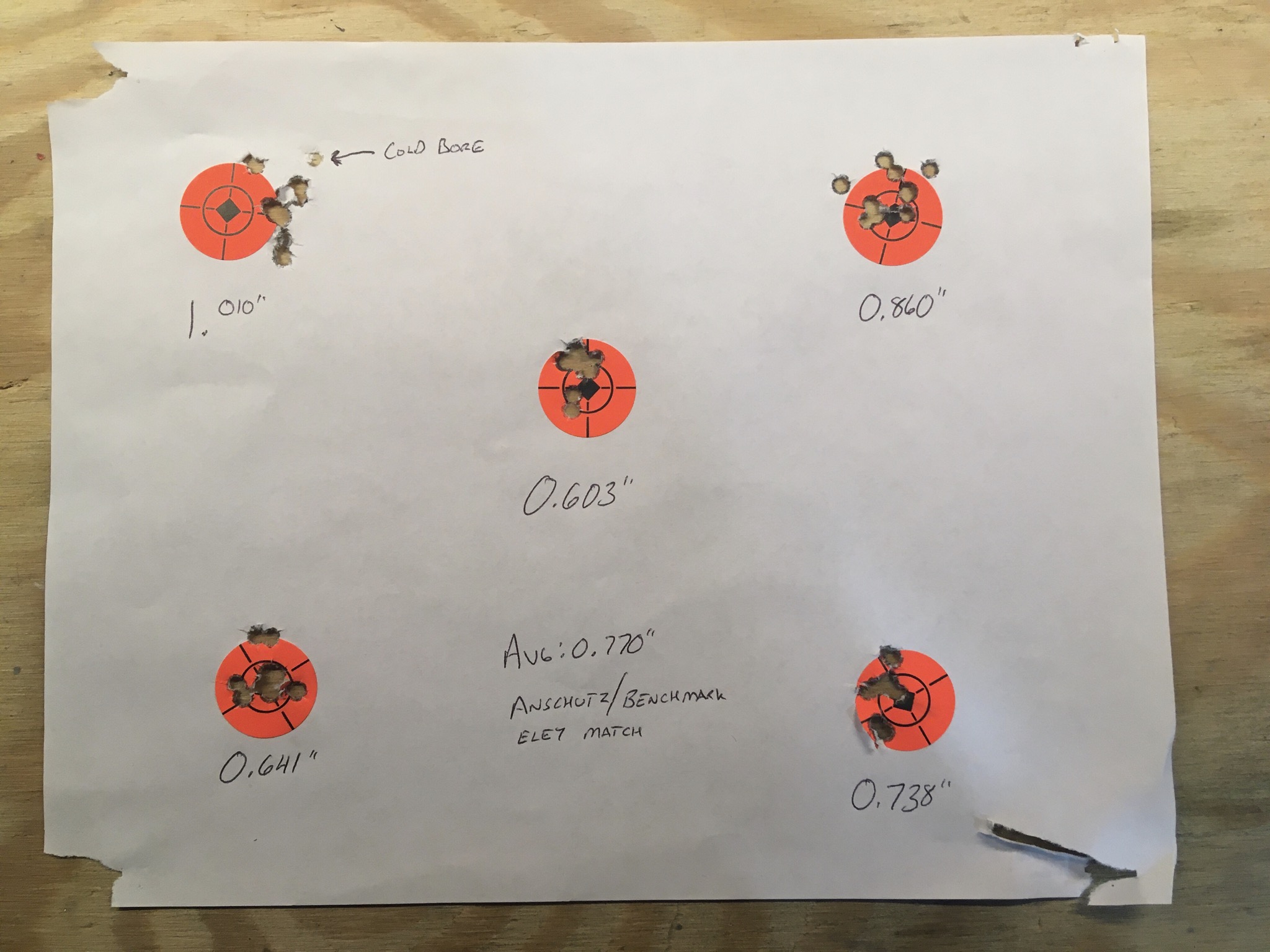

    For cartridge testing I would do 3 shot groups and then collate them and spot my own faults and diagnose wind effects.

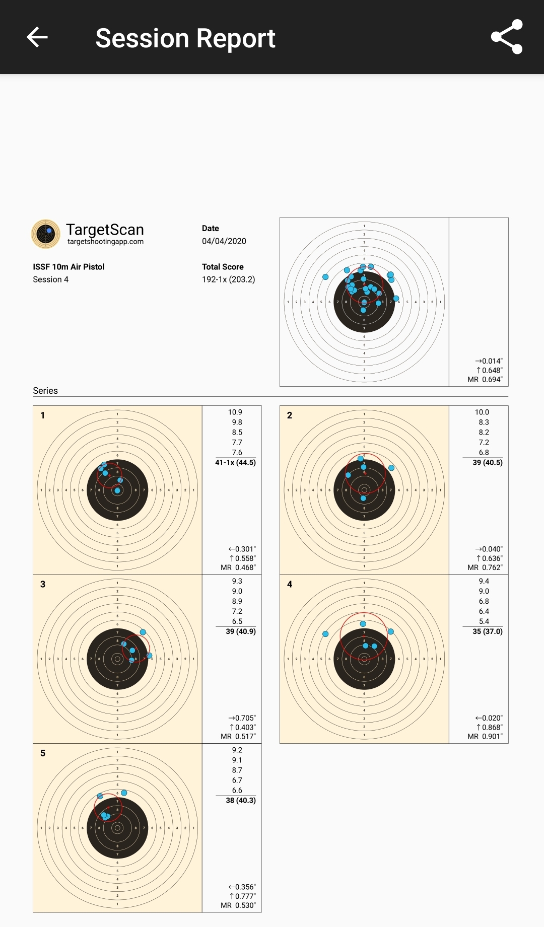

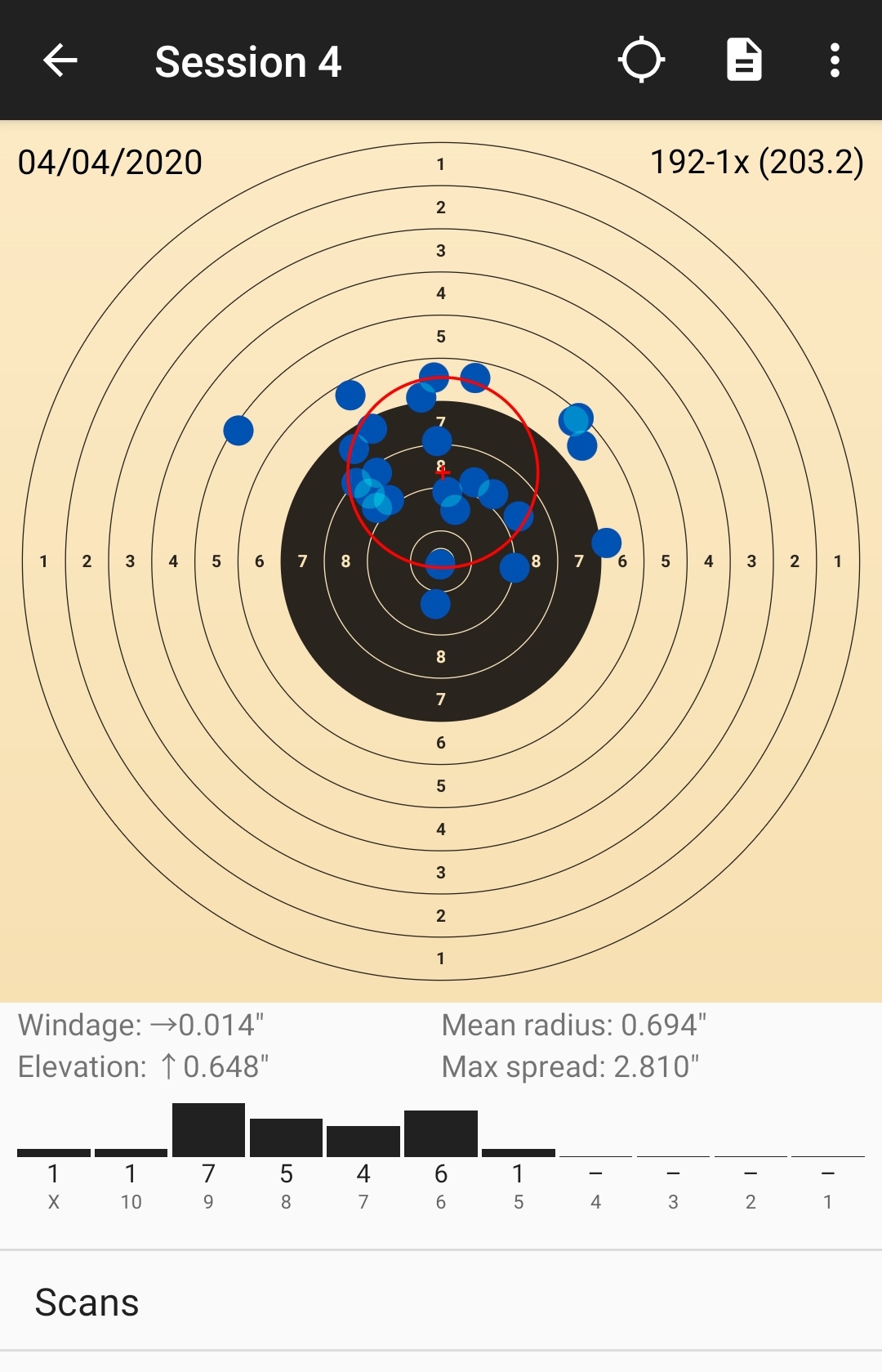

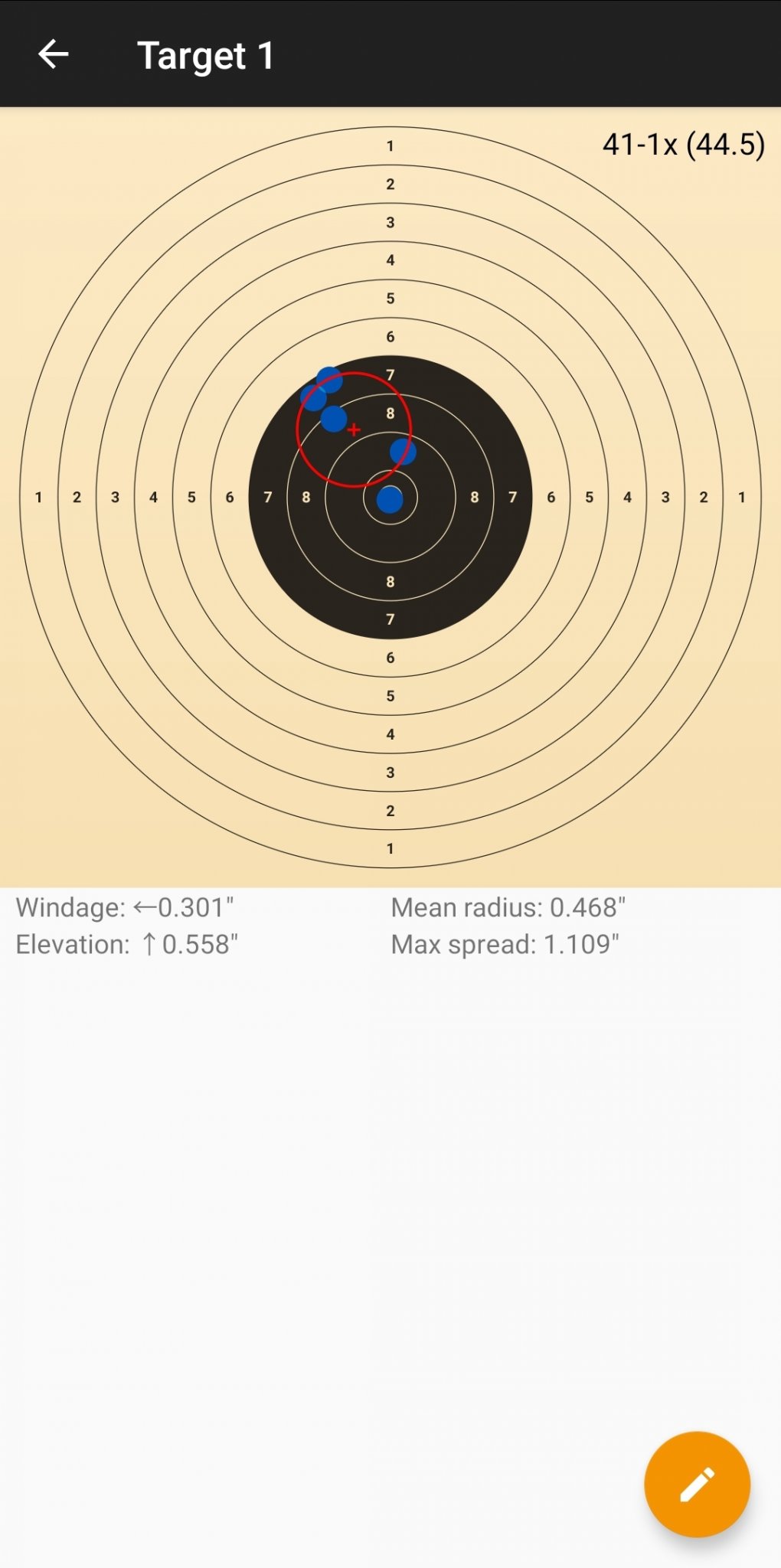

    I use 10m air rifle targets at 50m and air pistol targets at 100m and beyond and then record them into TargetScan app.
    I can easily see separate groups and a collated group from the app.
    I keep my own file for each gun, cartridge and distance, for example "Sako Quad CCI SV 100m"
    This group was shot in 6-7mph from 10. Few times the wind circulated to other direction, see target #4..
    The group sizes are not shown in the collated view but can be seen from the individual scans. I have asked the author to add group size also to collated view for much easier use.
    The overall group size can be seen in the main view.

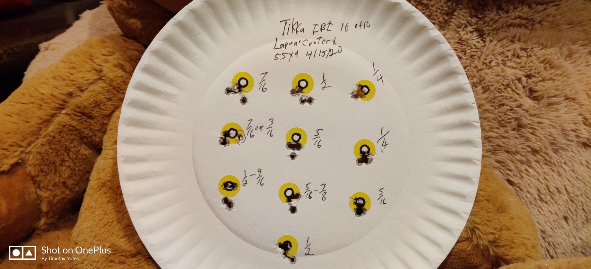

    In centerfire's I shoot multi 3 shot groups at 100yds. Until a I fine a load I like, then 5 shot groups at 100 and 200yds. In rimfire I shoot multi 5 shot groups at 50yds. IMO 10 shot groups a waste ammo. You have twice the chance of effect from wind conditions, and gun handling. I see in your groups, you have vertical in all of your 100yds groups. This could be gun handling, or maybe wind if is come in or out. your 50 yds groups are good, but vertical in some of them. You did not say what type shooting you going to shoot. I find the ammo my guns like, zero at 50 yds, and shoot steel at long range. I'm never going the shoot groups on steel. I'm looking for hits on small steel.

    Dots are 1/2 OD and 1/4" ID. My method is center to center between the two farthest apart holes. Been doing it like that for years...before the internet existed.
    Yeah, I'd be happy to measure with calipers. How do you want me to measure? Center to Center, out side edge and subtract some number between .221 and .224?

    In my opinion in the rimfire we test how bad a lot is, not really how good. We cannot have the best, we take the least worst.
    That said I document my tests into electric scoring system and check stuff like mean and collated groups so I do use more data than just max spread.
    Whatever method you use the most important part is calling out the bad shots when testing lots. Without good calling it is impossible to test lots.
    Like kod recognized bad groups from shoulder pressure. A new shooter would never ever see that as anything but as a strange grouping.

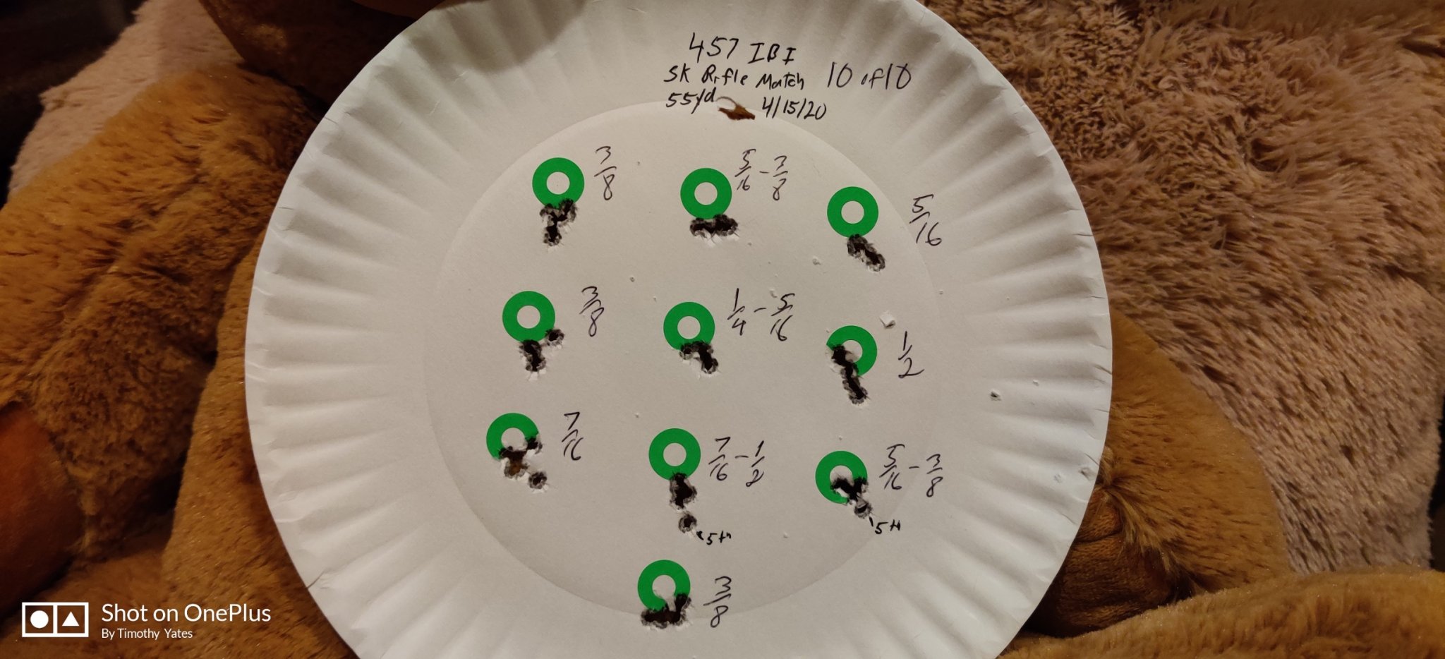

    Here is a thread I started a while back that didn't gain any traction, but I think it's a good example of what I am personally capable of for 10 rounds at 100 yards (50 consecutive shots):
    This is one of my better targets from the above thread. It shows that sub moa is very possible @ 100 yards (honesty I demand it from the rifle and ammo).
    This is a bit better than I had would have expected.
    That has to be wrong.... Their facility must suck large. I see 100 yard groups posted here with regularity of that size.
    Maybe they (Eley) are not being honest about their ammunition's accuracy. If it is true "our" posters/shooters are just better shooters than the machine mount rest that Eley has.....
