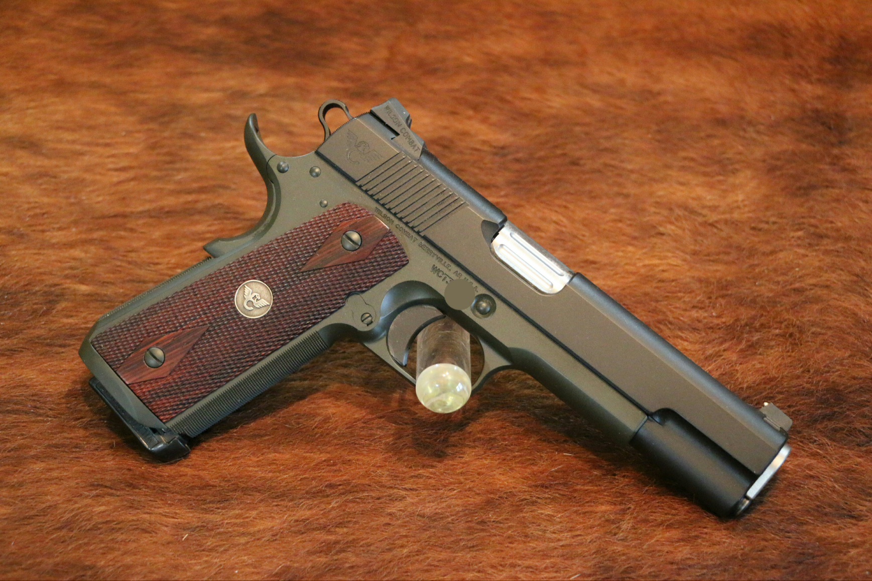

    8.0gr 800X over a 180gr Rainier TMJ is a fantastic target load for my Wilson Combat. Using CCI 350 and Starline brass.
    I use 8.7gr of 800X with a 180gr XTP for hunting...but admittedly haven't shot anything yet. I developed it last year, but ended up tagging out in archery season.

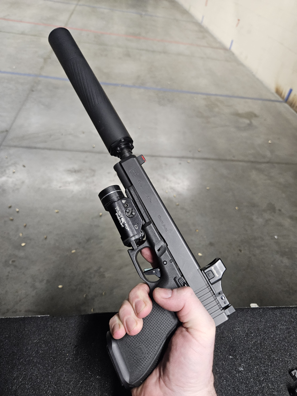

    I built a 2011 as a project and chose a CDR length for a suppressor host. Initially started as a 40 S&W but decided to go 10mm when I saw that the .40 Smith couldn't really handle 220gr bullets and 200gr was already well below subsonic. So my load data is on the weaker side.
    Rim Rock 220gr Hardcast, 1.275 COAL
    6gr Hodgdon Longshot
    Starline brass, 1015fps
    200gr Zero TCFM's, 1.250 COAL
    6.4gr Hodgdon Longshot
    Starline brass
    1020fps, 1" 5rd groups at 25yds
    The groups below were shot of a game changer with a suppressor attached. Need to work on the 200gr XTP

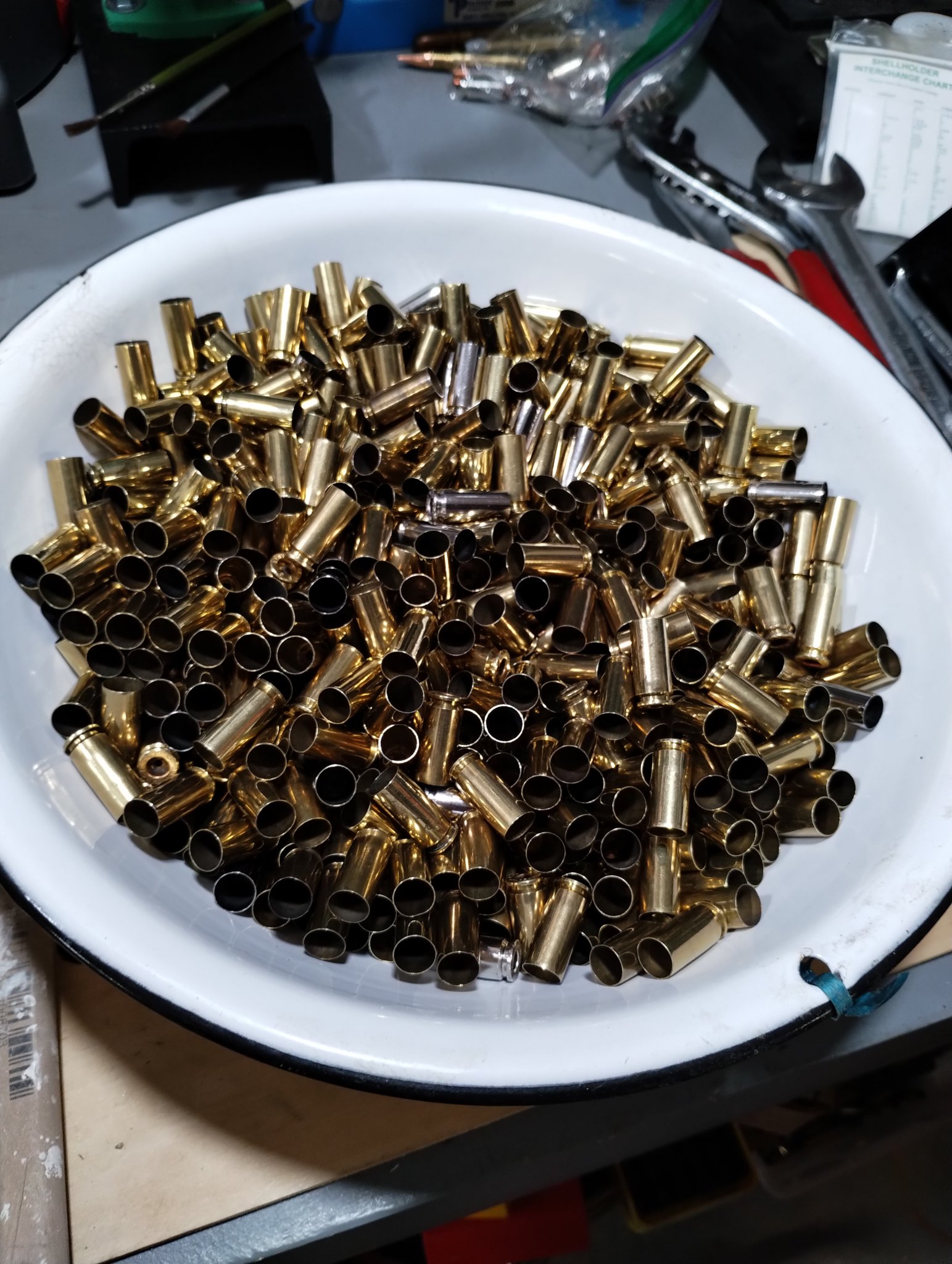

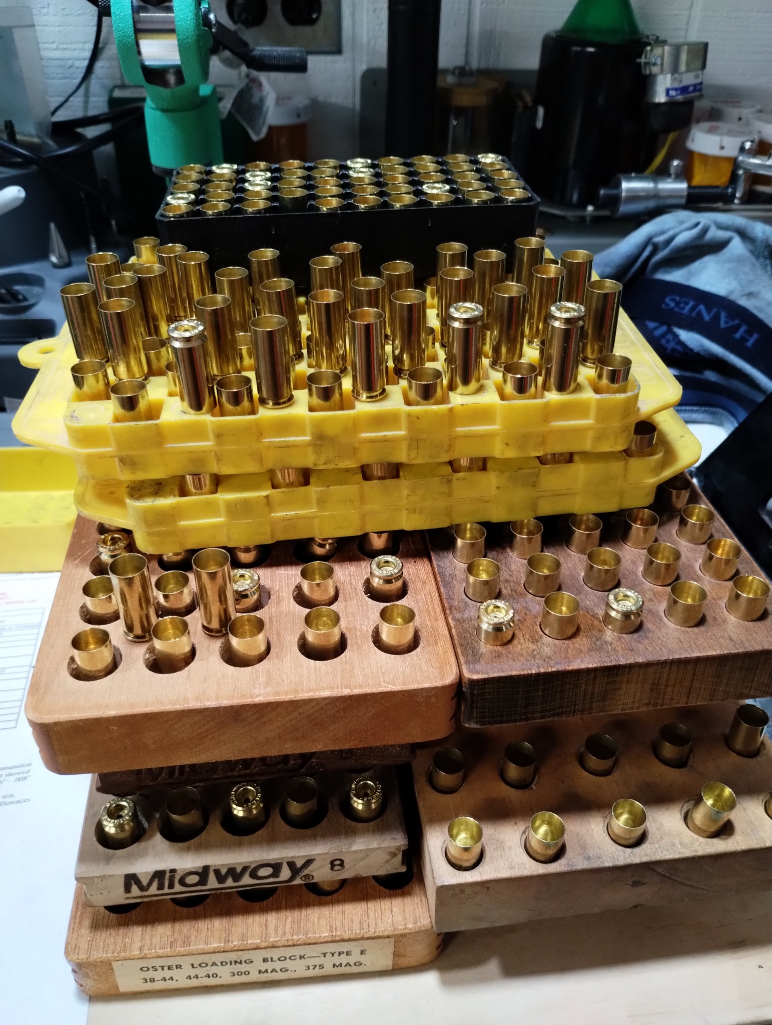

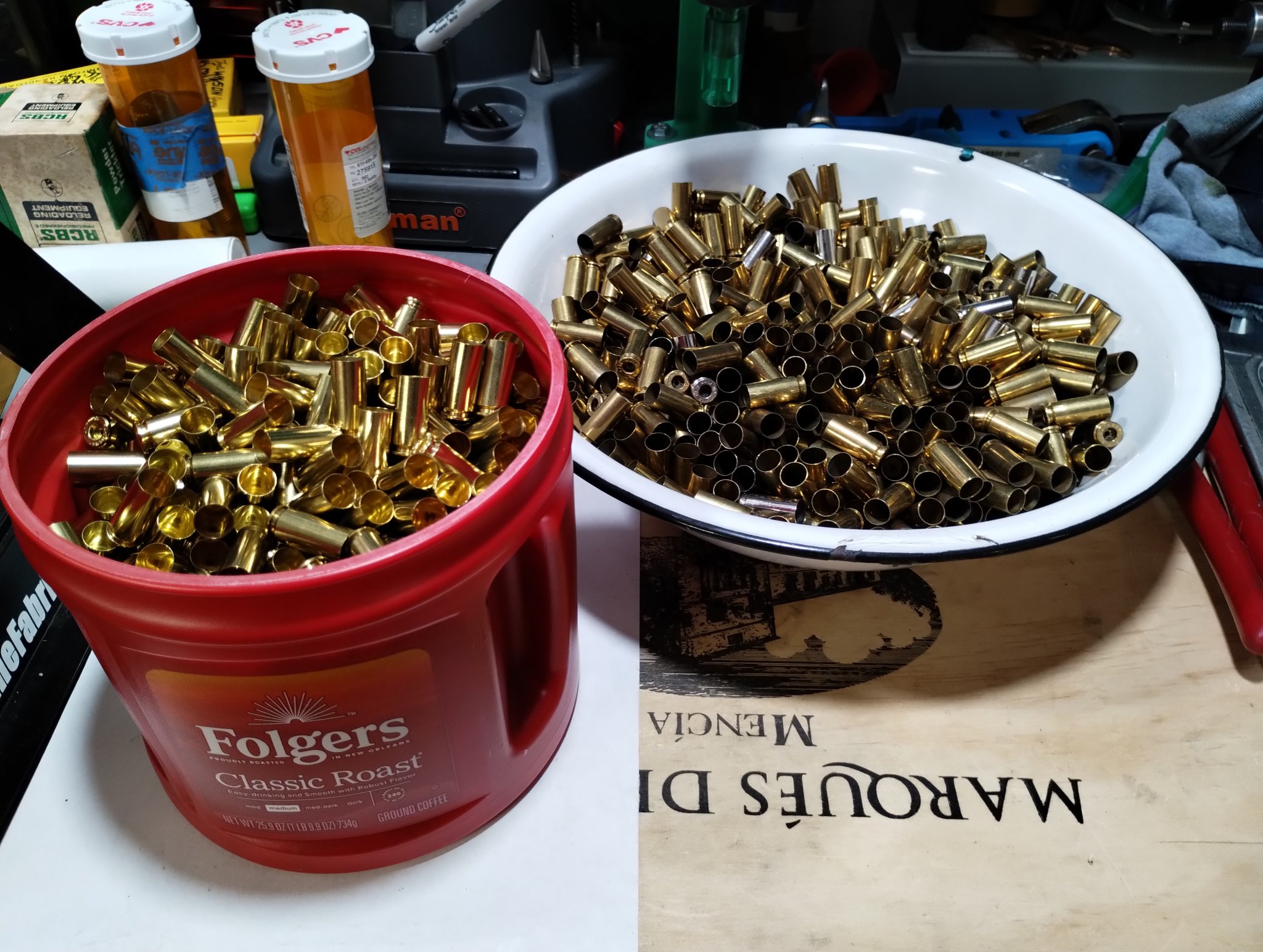

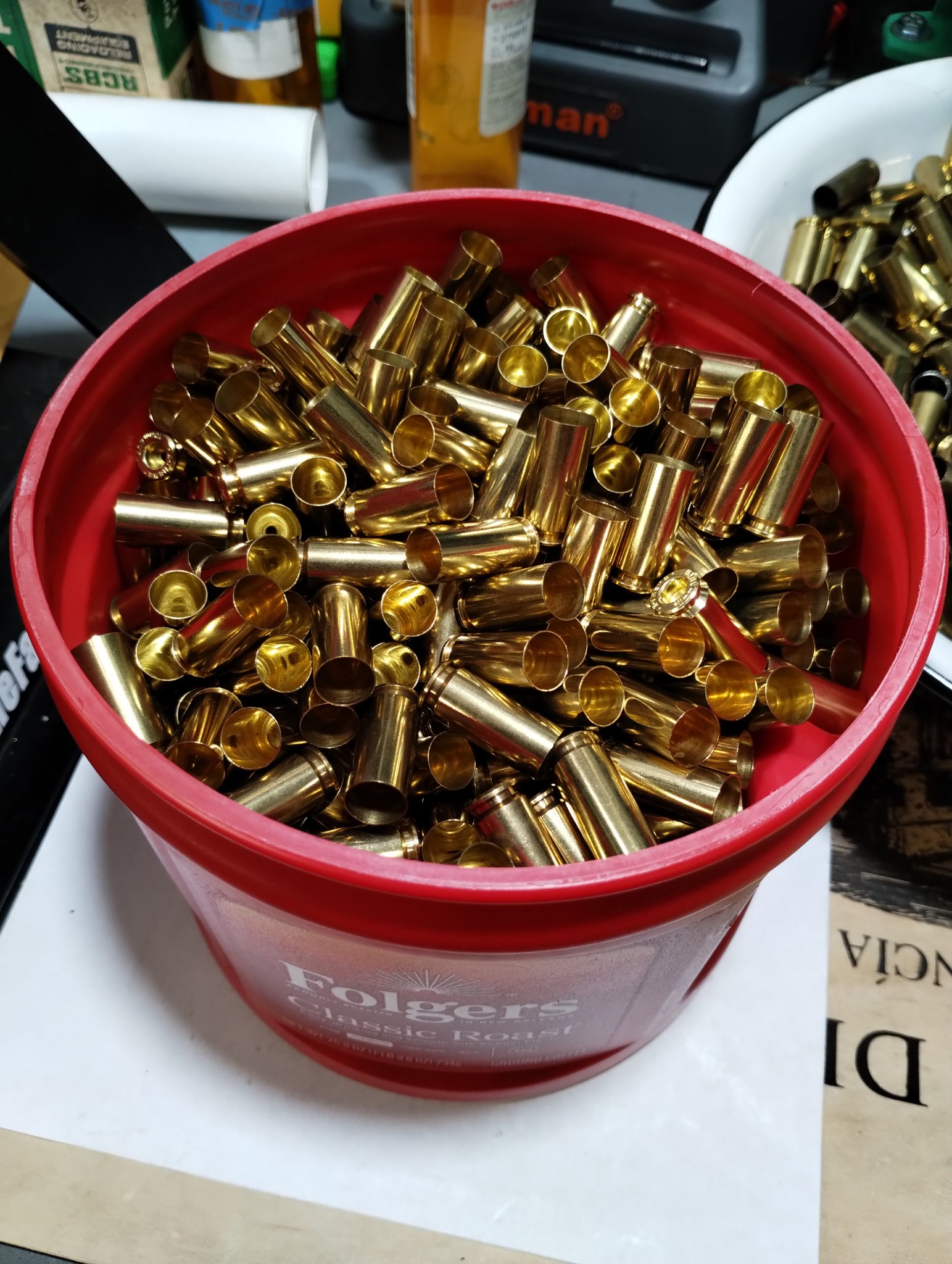

    Trying to finalize my load to take with me before heading to the AWW by float plane for a week. Never know if a black bear will come sniffing around the campsite. Haha
    There is a total of 3k+ of 10mm. Half of the brass is new Starline. I cleaned the used brass and debulged all of the used brass. I resized all of the brass.

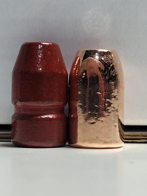

    Reloading for a Glock 40. I like 220gr. bullets. They can be loaded to1200+fps for bear loads, and they also make a great subsonic bullet loaded down to around 1020fps.
    WORD OF WARNING WITH XTREME 220gr. BULLETS: They aren't stable in some barrels! They shoot fine out of the factory barrel, but out of the KKM and Alphawolf barrels I have, I got 1 or 2 out of 10 shots that would be wicked flyers. Like, right off paper bad. Only powder that didn't do this was Lil'gun. These bullets are much shorter than the 220gr. cast bullets, so there is enough room for a decent charge of Lil'gun.
    SNS 220gr. FP vs Xtreme 220gr. RNFP
    I tend to stick to SNS Cast Bullets 220gr. HI-TEK coated bullets. They're good, inexpensive target bullets, but they aren't particularly hard. Straight Shooters Cast Bullets Co. offers a similar bullet with BHN 20 for actual bear loads.

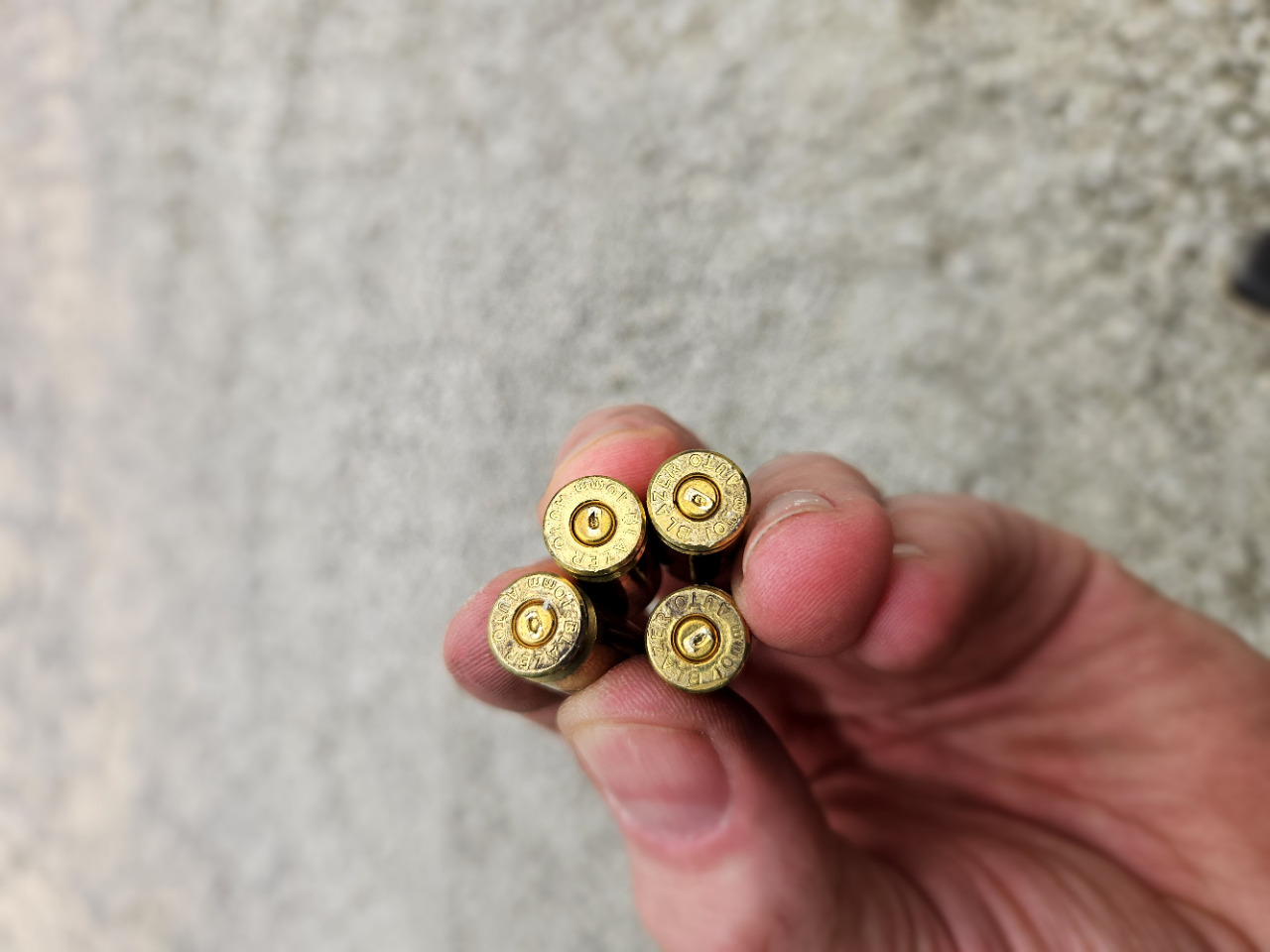

    For comparison: two case from 6.0 Longshot and two cases from 4.7 Tiregroup fired through the Fly 45. Can't tell which is which...
    Sound wise - suppressed ( including the loads above):
    -7.2gr. 3N38 is pretty loud (uncomfortable).
    -6.0gr. Longshot & 5.6 Autocomp are noticeably quieter, but louder than all of my 9mm loads.
    -4.7 Titegroup is definitely quieter than 6.0 Longshot, like 9mm 147gr. loads with slower burning powders.
    -4.3 Titegroup is into 9mm territoty. Not Titegroup 9mm load quiet, but maybe just above a 147gr. bullet with 4.0 Autocomp. Definitely quieter than a 147gr. bullet with 4.5 Longshot.

    My 9mm Lehigh 90gr Xtreme Defense load on left and 10mm Lehigh 140gr Xtreme Penetrator on right...
