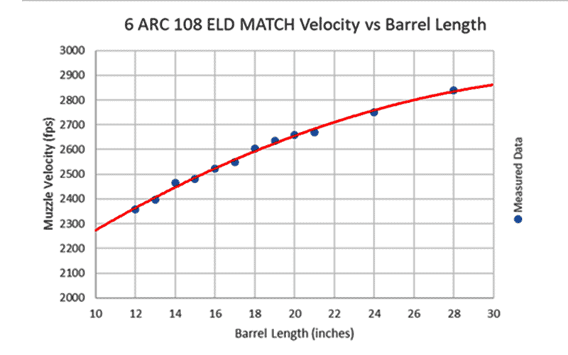

In March of 2022 I chronographed three 12.5" 6.5 Grendel, 6.8 SPC, and 6mmARC uppers with factory loads.
6.5 Grendel - Hornady 123 SST - 2280 FPS
6.8 SPC - Remington 115 MatchKing - 2502 FPS (!!!)
6mmARC - Hornady 108 ELD-M - 2509 FPS
These were all new barrels that will speed up a tad with use.
My own 14.5" 6mmARC with a well seasoned Proof CF barrel produced 2560 FPS with that same lot of Hornady ELD-M.

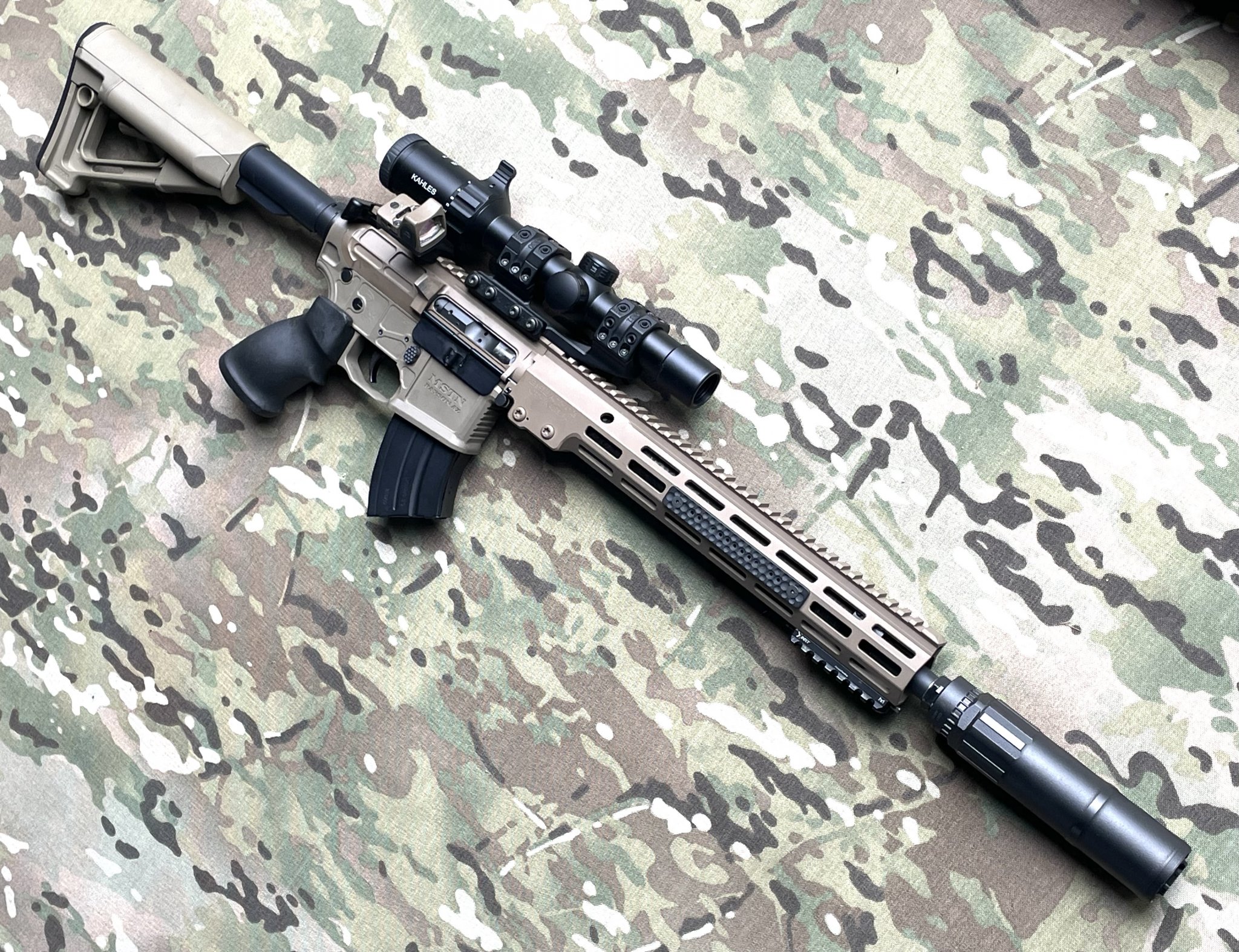

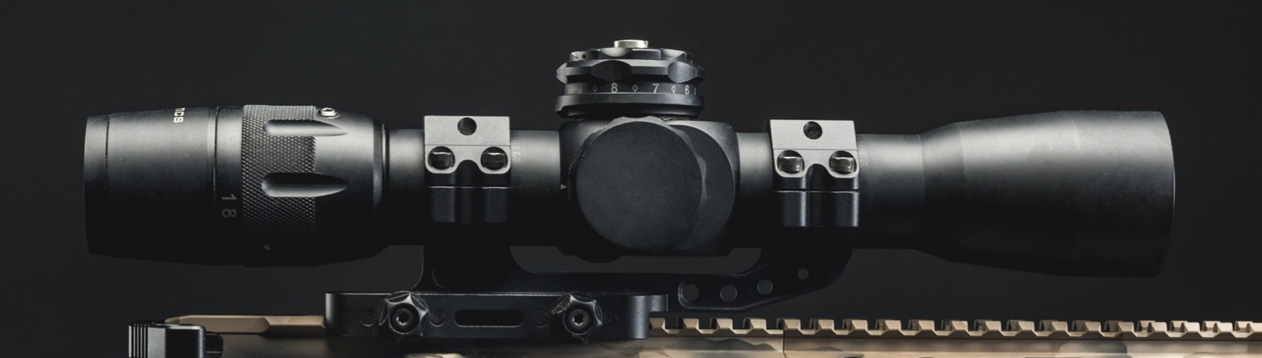

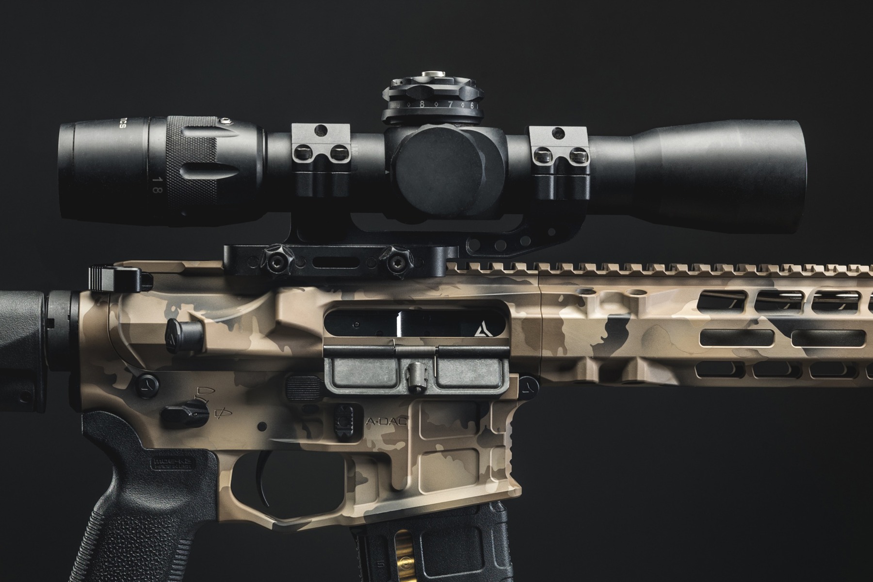

I'm using a Kahles K18i on mine:
It is my #1 do-everything rifle.

I’ve been asking for someone to check my work on this, but really would like a second-look, preferably from someone that’s been shooting LR for 10 years or more and knows their way around ballistics programs and real-world results.
From 18” barrels, Grendel with the 100gr ELD-VT really beats the 6mm ARC 108gr ELD-M, even if we hand-load the 6mm 75fps faster than Hornady’s data up to 24” velocities from Hodgdon’s.
I’m using Hodgdon’s 6.5 Grendel load data for the 100gr Partition (which is harder to drive into the lands) with an average between their CFE223 and LVR data from 24” barrel (2873-2900fps), then run down to 18” velocity of 2750fps through a Grendel internal ballistics engine. I’ve personably loaded the 100gr NBT to 2675fps from a 16” Grendel as well before we had CFE223 or LVR data.
6.5 Grendel 18” barrel, 100gr ELD-VT, 2750fps, .226 G7 Hornady program, 6300ft elevation, 59˚F
600yds 3.7 mils drop 1.1 drift
800yds 6.0 mils drop/ 1.6 drift (592ft-lbs)
1000yds 8.8 mils drop/ 2.1 drift (436ft-lbs)
6mm ARC 24” barrel, 108gr ELD-M, 2650fps hand load, Hornady Doppler Radar Data, 6300ft elev, 59˚F
600yds 4.1 mils / 1.3 drift
800yds 6.8 / 1.9
1000yds 10.2 / 2.6
18” ARC data shows 2575fps max in Hornady’s manual. Seems about right if Hodgdon’s is showing 2650fps from a 24”.
That really kills the ARC in that weight class. ARC is still relevant with the 55-87gr bullets for varmint, but I’m just not seeing the attraction in the 100-110gr class. Let me switch to the 110gr 6mm A-TIP to see if it will do it....
24” 6mm ARC, 110gr 6mm A-TIP, 2650fps Hodgdon’s max data, Hornady Doppler program, same conditions:
600yds 3.9 drop / 1.1 drift
800yds 6.4 drop / 1.6 drift
1000yds 9.5 drop / 2.2 drift 433 ft-lbs

Thats one nice looking setup. Thank you very much for all the information. I have to admit that 14.5 arc proof keeps calling me more and more.

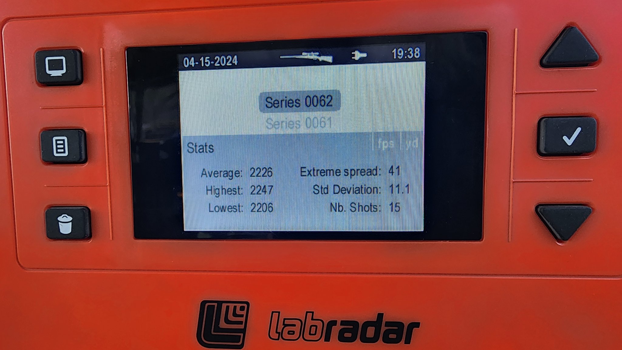

Those velocities should probably be switched. I chronoed the factory ELD-VT at 2630 out of my 18" Grendel and data @Ledzep has posted for the factory 108 ELD-M shows 2750 for a 24" ARC.

What do you get with 123 factory eldm with the 12in ? 2400 FPS ?
Im pretty decided on the Grendel at this point especially out of the 12.5. Now its just a question which barrel will be good. The rainier ultramatch mod2 is an option I guess a custom krieger is an option from precision firearms. Just big price difference.
If you’re on the fence for a 6arc, the Rainier Arms 12” shoots the factory 105/108’s at 2365-2390fps iirc.
