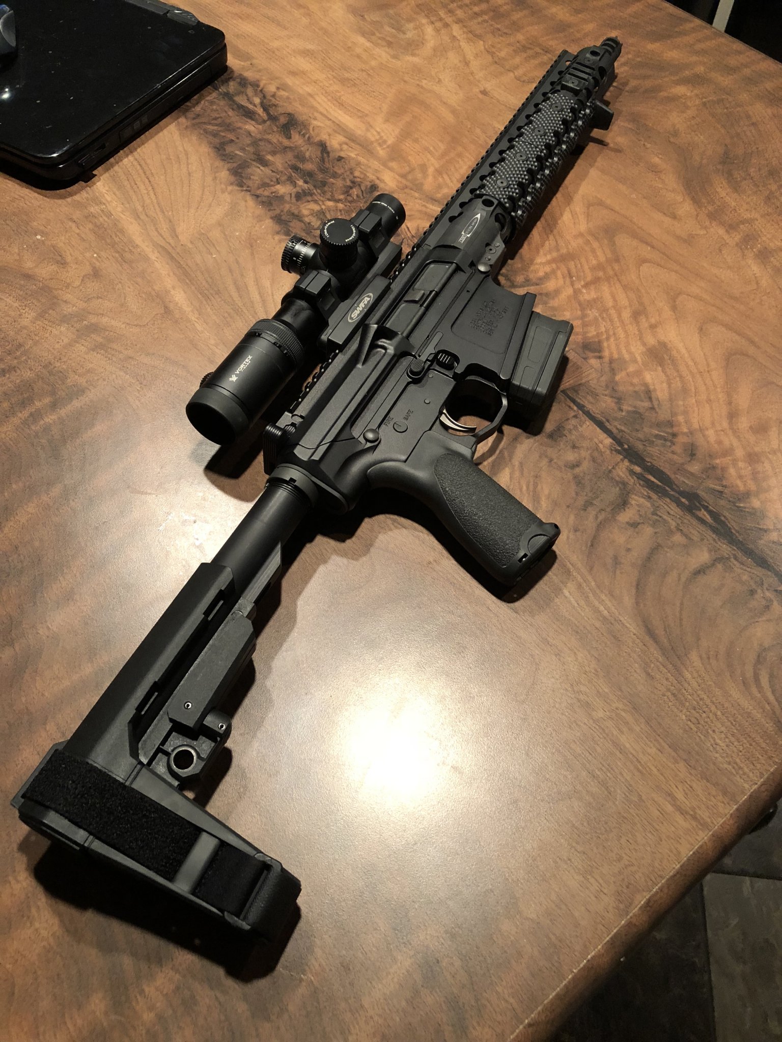

Additionally, a 7.5 inch AR pistol can be a very loud, impressive asshole. Here is my version of such a thing. It never fails to make folks move a few lanes down from me or draw a crowd. With an Echo trigger, it is an absolute riot.
