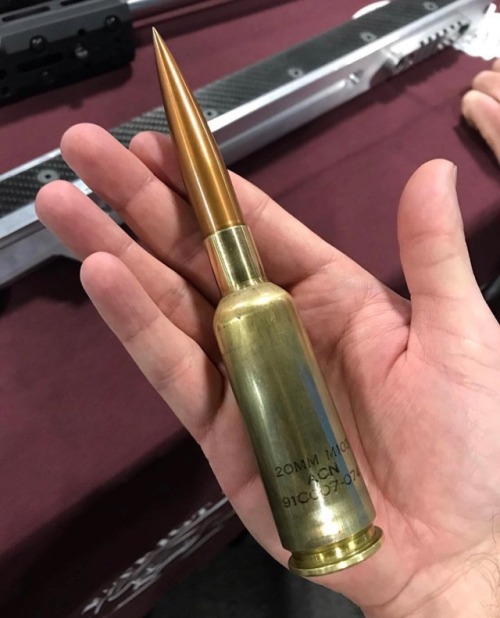

Now to 20mm cases.
I found a lot of different info on this, on too many different sites... and I really don't know what to think about it. various information from 3200 to 4000 fps with (50 cal) 750 grain and 800 grain bullets.... whatever. I'm also really tired of looking for information that can't be properly confirmed. If it takes 100k, 150k or 300million psi to get 4000fps...speculating about it without testing it in the real world makes me just tired.
The only thing I can confirm. Various companies and people have tried to necked down a 20mm case to 15mm, 14mm and 50 cal. But not one of those was a commercial success.

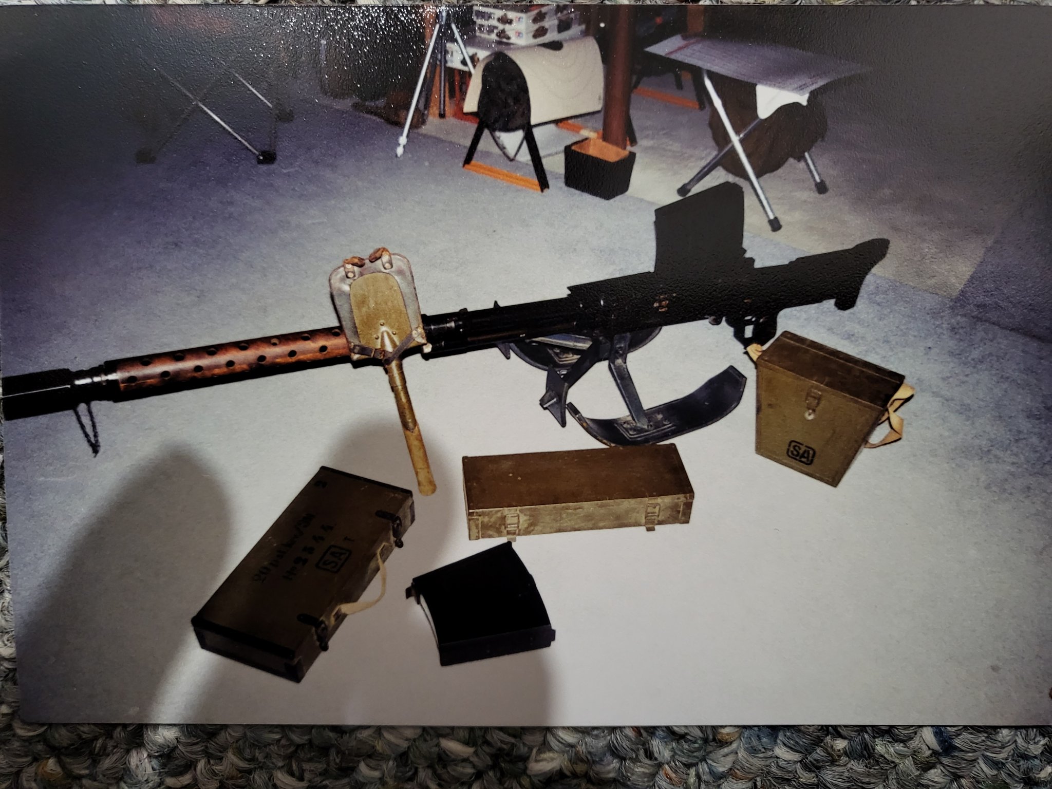

I rebuilt/used a Lahti over 20 years ago. I called my round the 50HVT. It was the 14.5x114mm Russian case and I necked it down to 50cal. I’ll post some pictures tomorrow morning of the rounds and the gun along with some other things.
Horizons Lord was stunned when I showed them pictures of my prototype round I made up to have the chamber reamer and sizing die reamer made. They said they did a search and came up empty on anything like this. I said when I did it the internet thing was in it’s infancy. So I never posted anything about it at all.
I rebarreled a dewat Lahti 20mm anti tank rifle. Made a new barrel that duplicated the Lahti barrel to the T but did it in 50cal. Breech diameter on the Lahti barrel in front of the receiver was 2.050” if I recall correctly. Chambered it up and installed it. Even had the barrel blued. Gunsmiths bluing tanks that blued it for me had to do the barrel half of the length at a time as the tanks where not long enough to put a 52” long barrel into the tank at one time. Turned out pretty nice. The Lahti weighed around 100# empty. Shooting it off the bench was like shooting a 30-06 hunting rifle with all that weight.

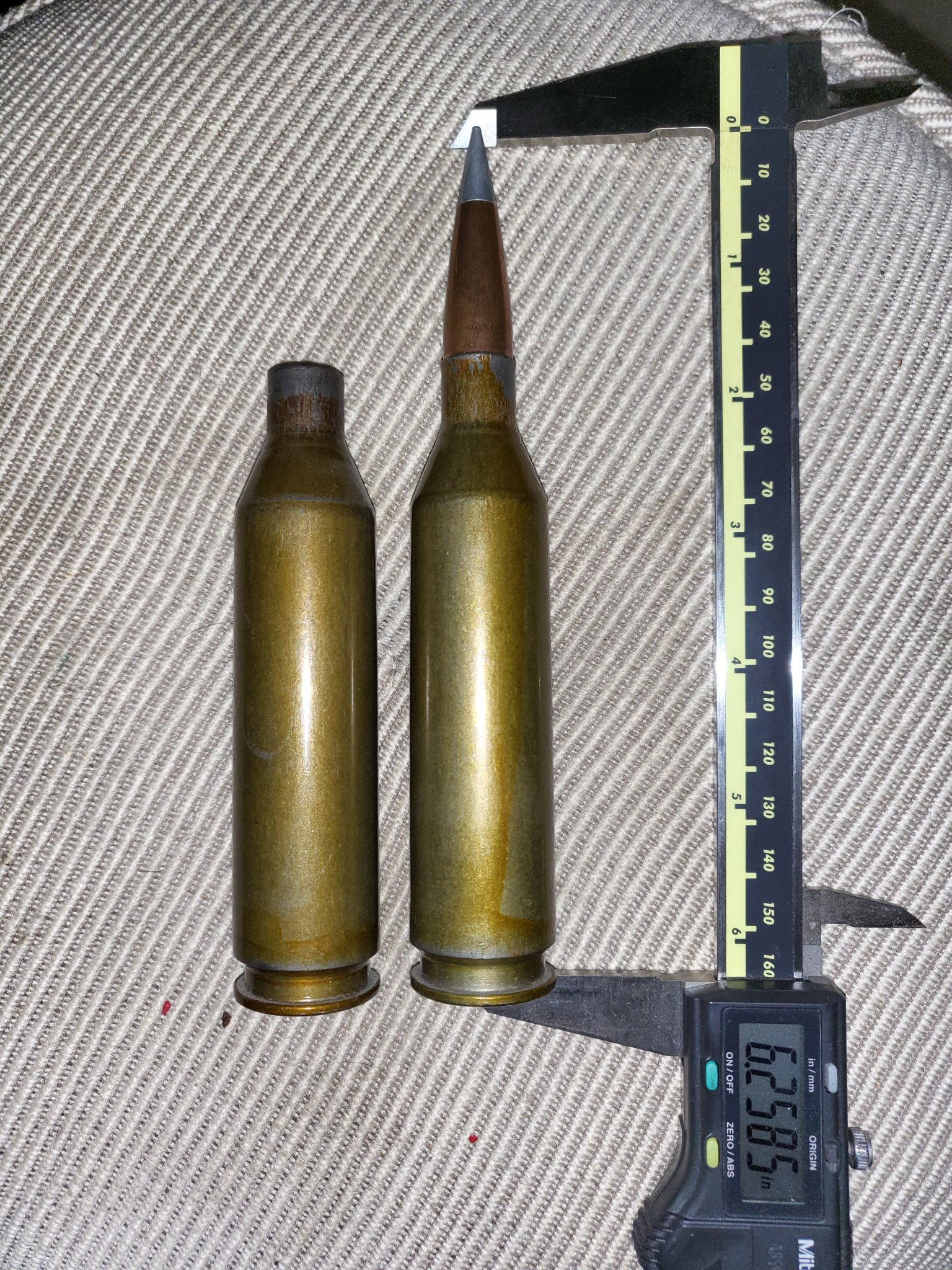

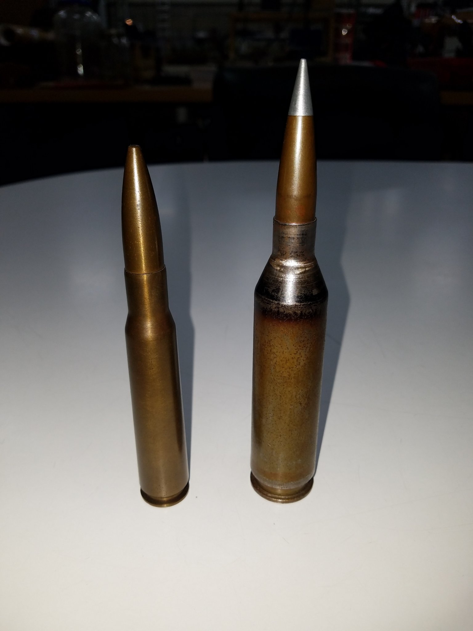

On the left is a standard 50BMG round. On the right is my prototype 12.7x114 round I made a little over 20 years ago. That was my sample round to get my chamber reamer and sizing die reamer made. I called it the 50HVT.
Next picture below is a fired case I have left and a loaded round. I have three loaded rounds left over. Couldn't let all of them go with the gun.

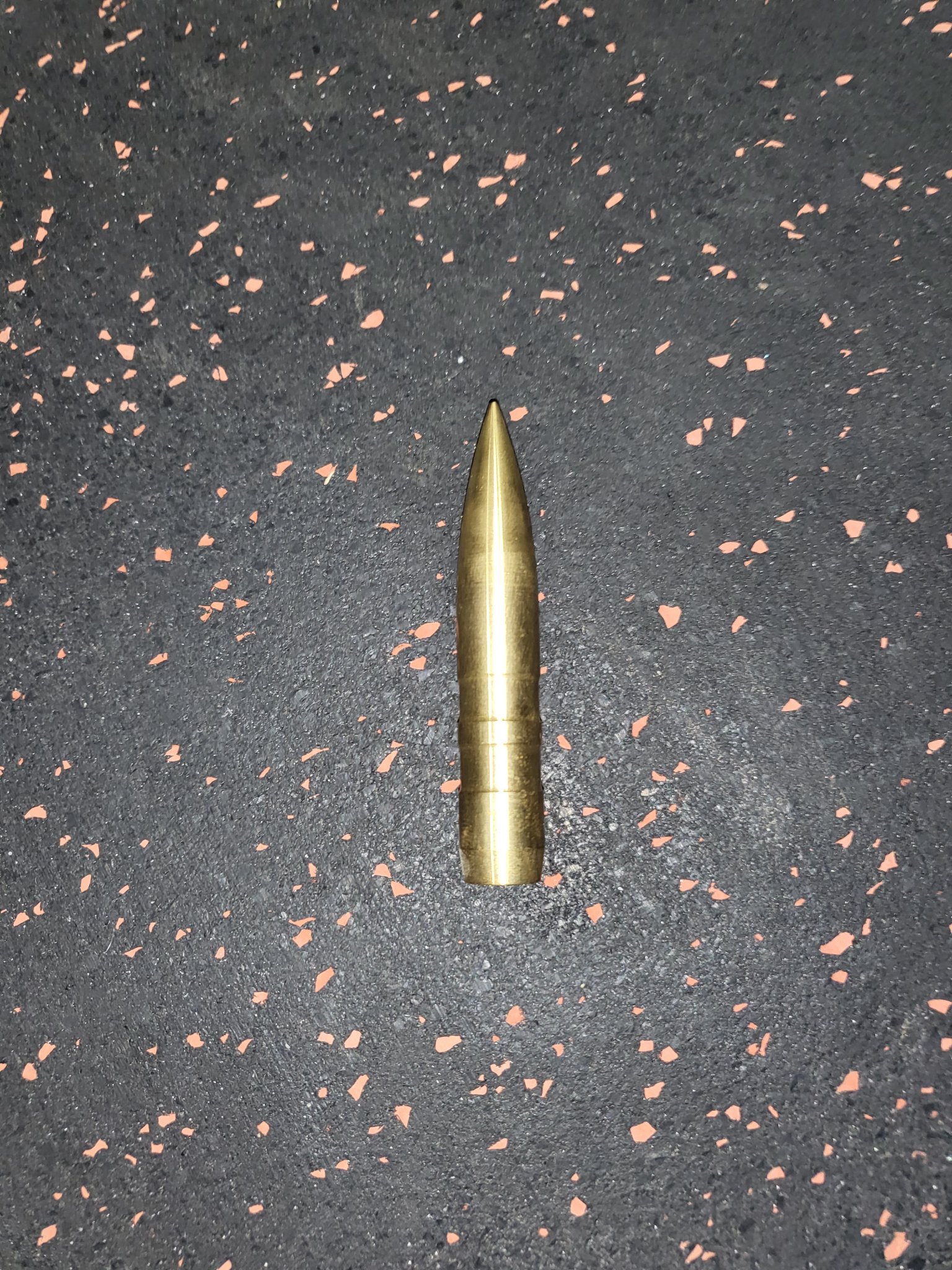

Next pic below was some prototype 1000gr bullets I had done.

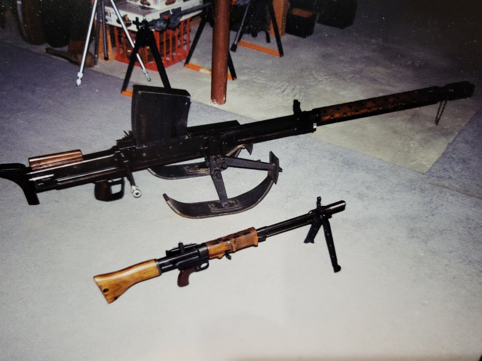

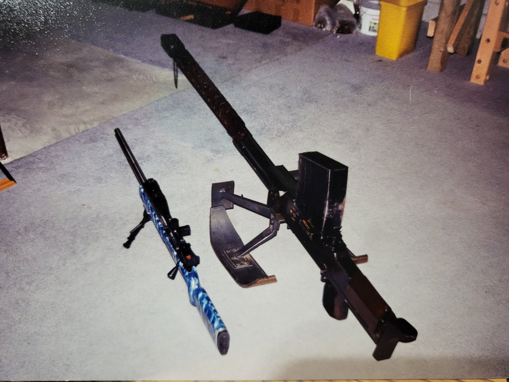

The Lahti I used to rebarrel to the 12.7x114 / 50HVT round. The rifle sitting next to it is a Rem. 700 in 308w with a 24" barrel on it and a McMillan stock for size comparison.
A different view of the Lahti with a dummy gun FG42 again for a size comparison.
Here is the Lahti and I had most of the accessories for it. The gunners kits, spare mag carrier (had 3 mags for the gun), and even an original shovel SA marked. Only one I've ever seen!

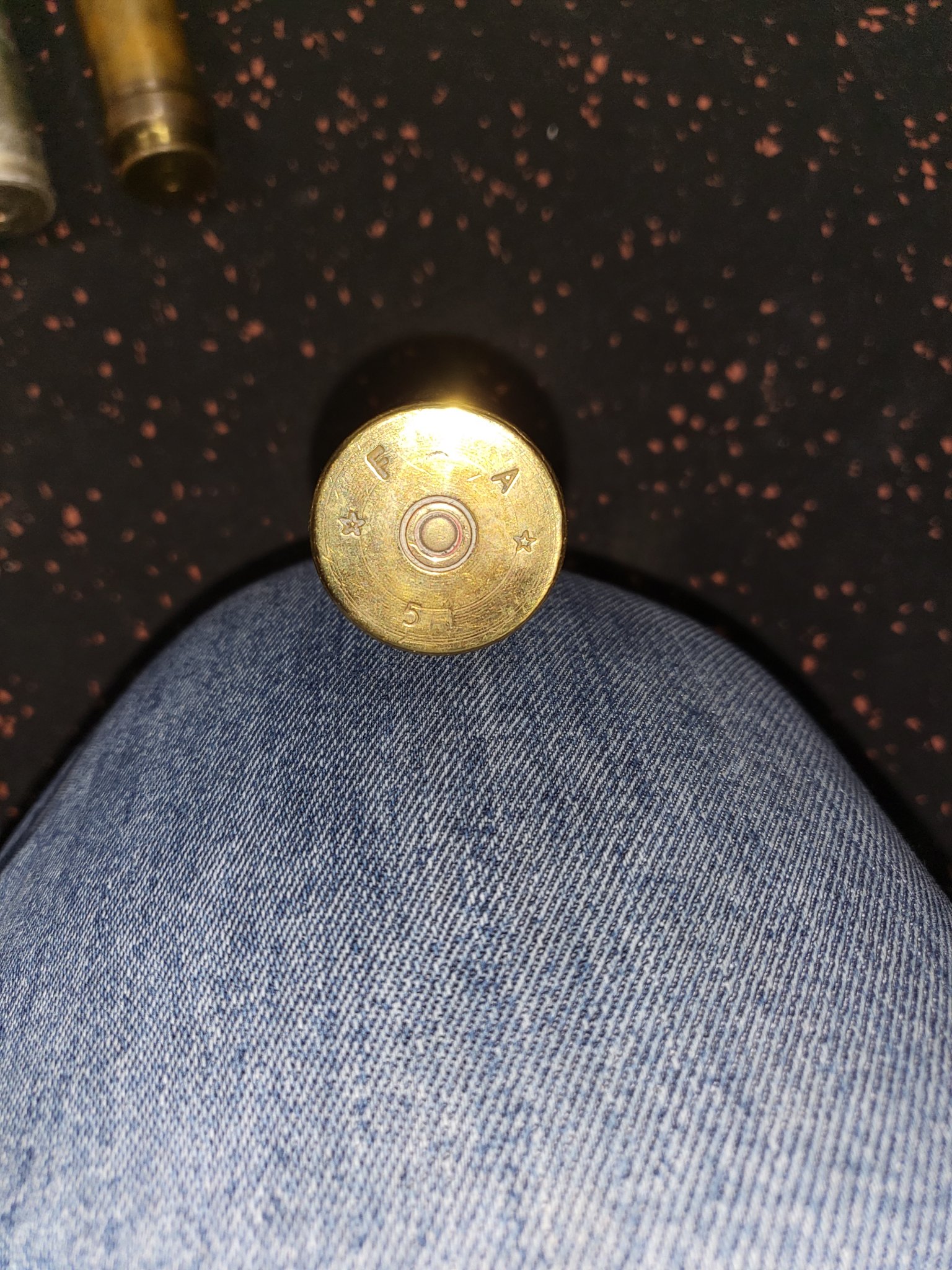

The cartridge face of a 60 US machine gun round. Frankford Arsenal made in 1951. Rim diameter is 1.160". So a .100" bigger than the 14.5 Russian. Body diameter is a little bigger also but same case length.

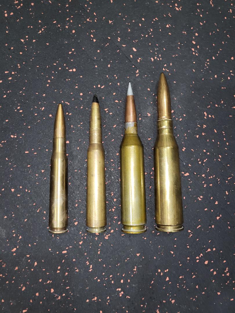

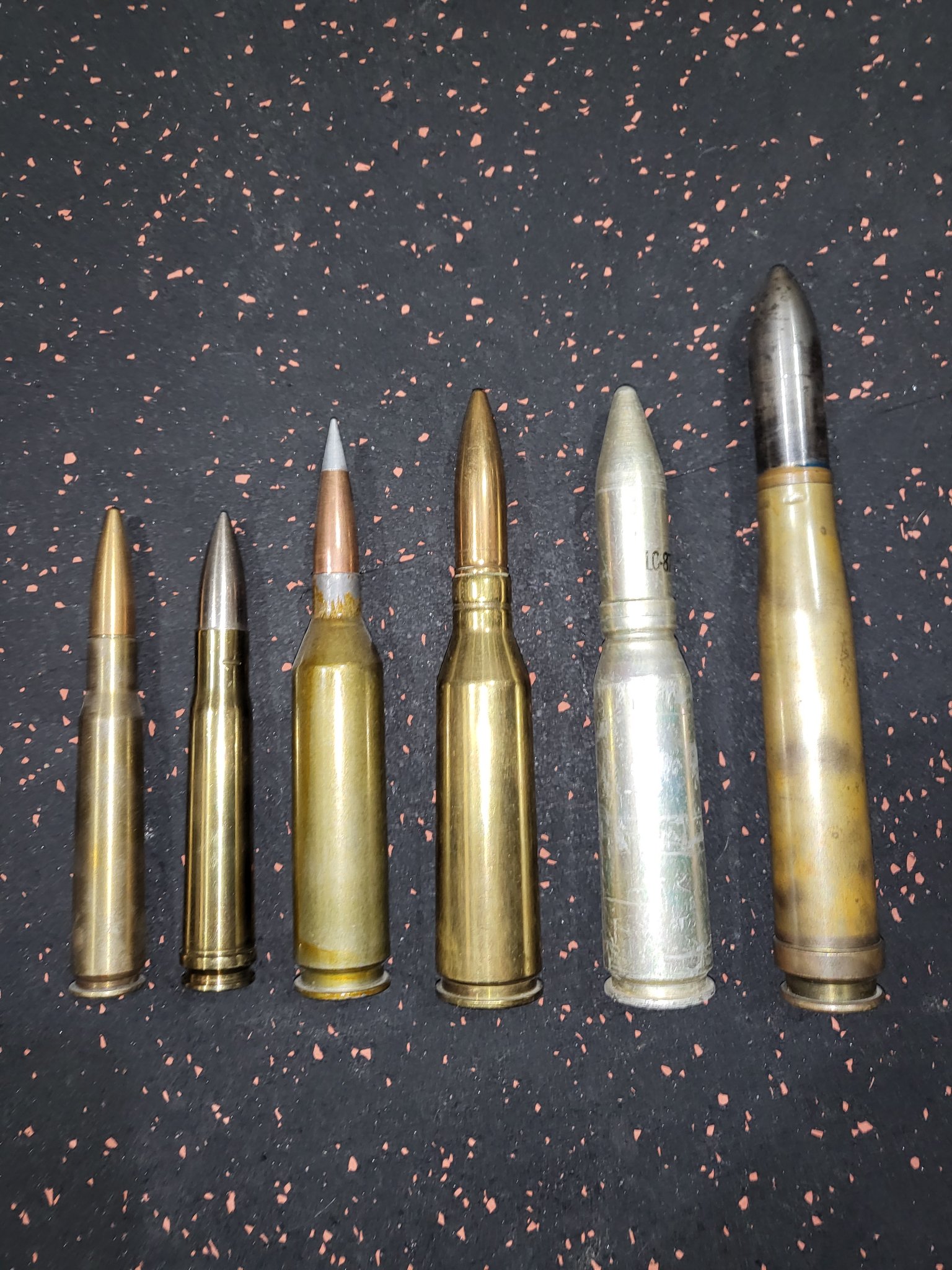

Here is a good comparison of some rounds. Looking left to right....
50BMG, 55 Boyes anti tank round, my 12.7x114/50HVT round, 60 US machine gun, 20mm US and on the far right is a 20x138B Solothurn/Lahti round.

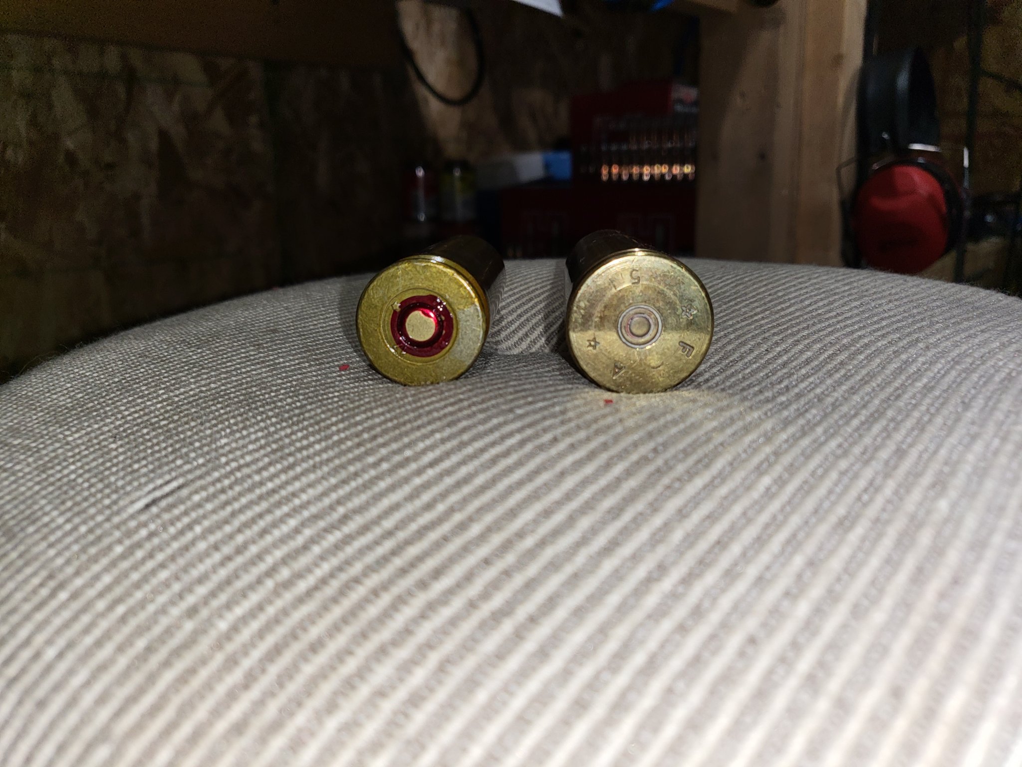

Here is both cases side by side looking from the cartridge face of course. That 14.5 case it's hard to tell from the pic but the primer cup is bigger than the 60 US and it's bigger than a 50BMG. I might still have one of the primer cups laying around believe it or not. When I demilled the one round to make my prototype I did for grins check to see if a 50BMG primer and vice versa swap with the 14.5 and they will not.

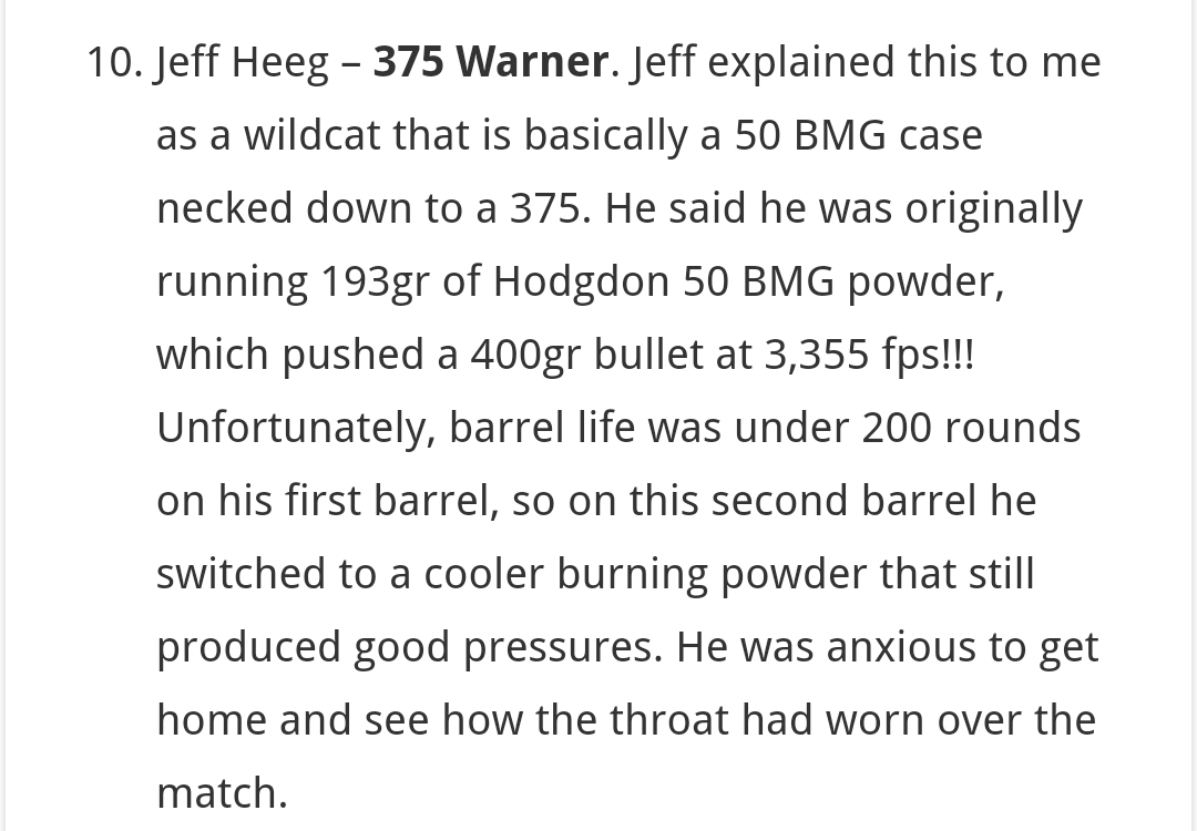

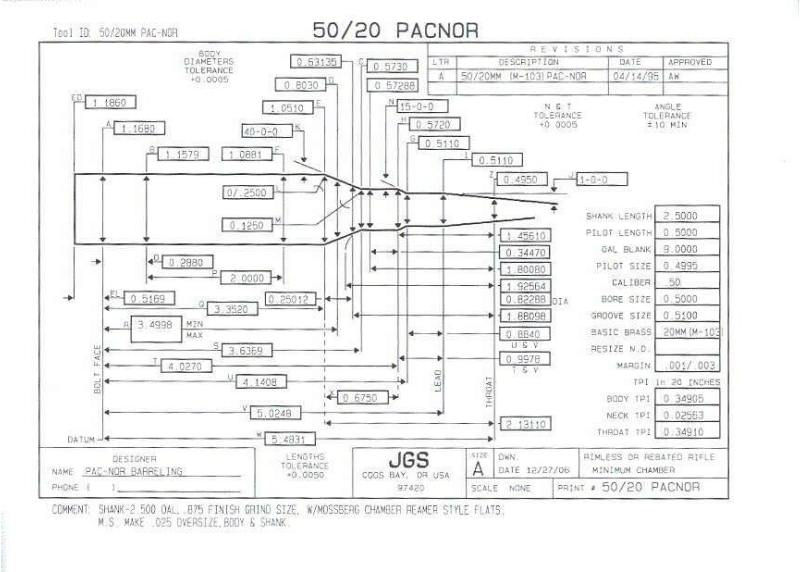

regarding 20mm cases necked to 50 bmg. I found various Information but my knowledge on this is almost nothing. Yes, on pictures it looks cool but i don't know what to think of the different data.
I've read data about over 500 grain powder capacity and muzzle velocity up to 3750 fps. But i'm a bit worry to post it because i can't confirm this data.
The only thing I can really do is show you guys what pictures and data i found.
In the best case, i learn something new or i inspire one of the major players to develop something new.

For a 50cal my gut tells me the 20mm cases are over capacity by a lot.
Below 300gr capacity the 50BMG is fine…the 12.7x108mm round holds a little more. I should’ve put a 12.7x108 round in that picture with all the others. It’s the same bolt face as a standard BMG and holds a little more powder. Pressure is pressure but why take a given round and run it over pressure? That’s just going to be harder on the gun and harder on the brass cases etc….
You want higher velocity you have to go up case size/capacity.
More powder/higher velocity I think the something like the 12.7x114 is going to be what your looking at.

Should've thrown the 12.7x108 Russian round in that one pic. Here it is....
L to R
50BMG (12.7x99mm), 12.7x108mm Russian, 12.7x114 and the 60 US machine gun round.
I'd compare the 50bmg to the 12.7x108 Russian like comparing 308 Winchester to 30-06 Springfield. Dam near ballistic twins. There is pretty much nothing the 30-06 can do that the 308 Win. can do.
The 12.7x114...when I loaded it at 400gr of powder...there is plenty of case capacity left. Maybe I'll take that fired case and fill it up with powder to the bottom of the case neck and see how much it will hold.
I'll say necking down the 60 US round to 50 is like a 20mm case. Way over capacity.

So I took some 20mm powder (the 20n29) and filled the case up to the top of the main body (bottom of the case shoulder) and that charge weighed 560gr of powder. Filling the case up to the bottom of the case neck…that powder charge came to 620gr of powder.
That's a lot of capacity... more than enough. I think it could be a bit to much capacity and I think making some modifications to the 12.7x114 might be an option and getting custom brass.
Let's say for playing with numbers, 560 grain is 100% usable powder capacity. A 400 grain load is just 71.4% case filling.
98% would be much better but think in this specific case you get pressure issues (to much pressure at 98% case fil) but you know it better than me. I belive slower powder would be neened.

I posted a picture about the powder on page one. A note on 20mm bullets. look at the bottom, right corner on the next picture. Custom brass silver tip bullet... i'm not sure.

Please note i don't want to try to shit/badmouth the 375 Warner but at least as i know, the 375 Warner was basically a 50 bmg necked down to. 375.
Yes, barrel life was short but was it a bad or stupid cartridge? I say no. A lot of people have necked down the 50 bmg to .416 .375 and not to forget the 440 vigilance. If i ever transported or carried a rifle over 50 lb and 80 plus inches long? So to be honest, No but I know that developing monster cartridges and feeding monster cartridges is expensive.

I posted a picture about the powder on page one. A note on 20mm bullets. look at the bottom, right corner on the next picture. Custom brass silver tip bullet... i'm not sure.View attachment 7865184

The 375 Warner was the first iteration of our cartridge. The design was taken from the 14.9, with permission from the owner. JH is indeed correct; 3550 was easily done but at the expense of barrel life. At that point, we had no idea barrel like would be that short, specially since we enlisted the help of a company specializing in internal ballistics. So we made the obvious move to increase cross sectional bore density and necked it up to 416. It has about 20gr more capacity than the Barrett and will thake a 550gr projectile to 3100fps on the top end.

take the 20mm vulcan cartridge and put it as a file in a 3D computer program. Now you can digitally make any changes you want. Shoulder angle, wall thickness, base diameter, rim diameter and so on... make it more or less capacity, make it more or less over bore. It's just like I said you can change anything you want. when all changes are done, save the file. Now contact RCC brass and tell them to make custom brass. ( send him the 3D file/Data)
it doesn't matter whether I'm talking about the 12.7x114 or 20/50 or the 14.9.
