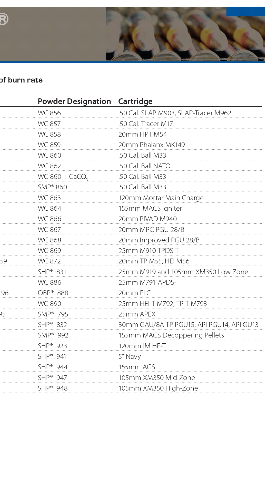

First of all, I would like to know if anyone really has experience or knowledge on very slow powders. I'm not talking about v20n29.
WC872 is very similar to 20N29 speed wise. We tested it in the 375WTC. It was too slow for that one. Most of what you have on that list is not available for retail sale here in the US unless you find a dealer selling pull down stuff.
@ Dan Warner
yes, most of the listed powders are not available to the public, unfortunately. I do believe a few guys would consider to larger wildcats, at least if the right powder would be available.

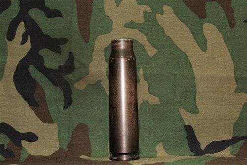

30mm brass should not really be the main problem. Why not just consider making your own brass. Making brass the same way as World War 2 i don't really like. You (Warner tool company) are making high quality copper bullets on a CNC lathe. I know very well how precise CNC machines are. The right machine should be able to do anything you want, even brass.
While its certainly possible, its a matter of cost, demand and economy of scale. We're so busy barely keeping up with current workload, new products such as this would require significant demand. And it would still require post cut process; forming shoulder and neck, and annealing. I'm sure we already have the necessary equipment to handle it, but there really isn't anyone beating on our door looking for it. If the knocking starts, the minimum commitment would not be small.
I think anything that has to do with 30mm cartridges is too soon.
Step by step. I have not yet seen a 20mm wildcat that is fully developed and available to public but i think it will come.

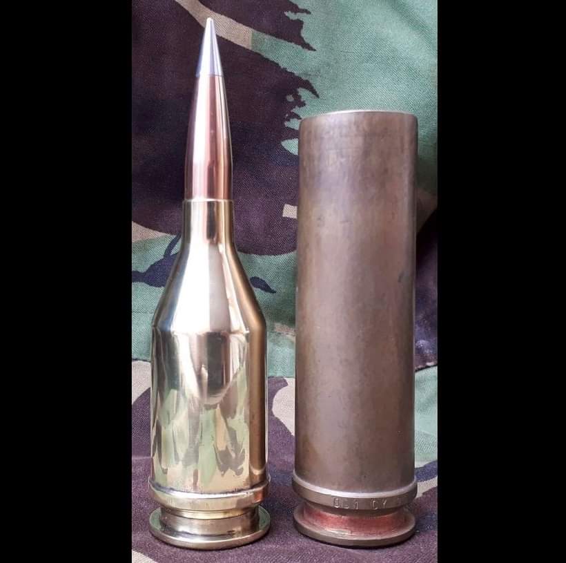

30mm wild cat is way over my head. Would be interesting to shorten the case and neck it down to 20 or so. If you could get a hold of some very slow take down powder. Maybe 60” barrel
Necking down cartridge like the 30x173mm is a bit of ultimate madness.
I 'm not interested in tanks and howitzers BUT i like the idea of putting cannon calibers in a bolt action rifle. But I think there are (unfortunately) limits. Cartridges actually needs more pressure to perform better. I know it is a mixture of pressure, volume and duration. The 30x173 Nato cartridge fires 5601 grain heavy bullets at 3510 fps. Powder charge 2314 grain propellant. Chamber pressure is just between 50,000 and 56,000 psi depending on ammunition. This performance at low pressure sounds pretty well. Do I think a 30mm wild cat is possible? I don't know but I wish yes. But what it would take is simple. The smartest and biggest companies would have to work together. Then maybe the magic would happen.
@jasent
Agreed, unfortunately... 30x173mm is an overkill. A 23x115 cartridge necked down to 18mm sounds may more realistic. I have even seen brass cases. Not the old steel crap. Please note. When I say may/might be realistic, i mean a completely new case design, a new system and much more. Not much would be left of the original case design. Second note, I know very well it is easy for me to say build cartridge XY, neck it down to XY mm but the really knowledgeable guys have to deal with math, physics, internal and external ballistics to develop such a wild cat.
