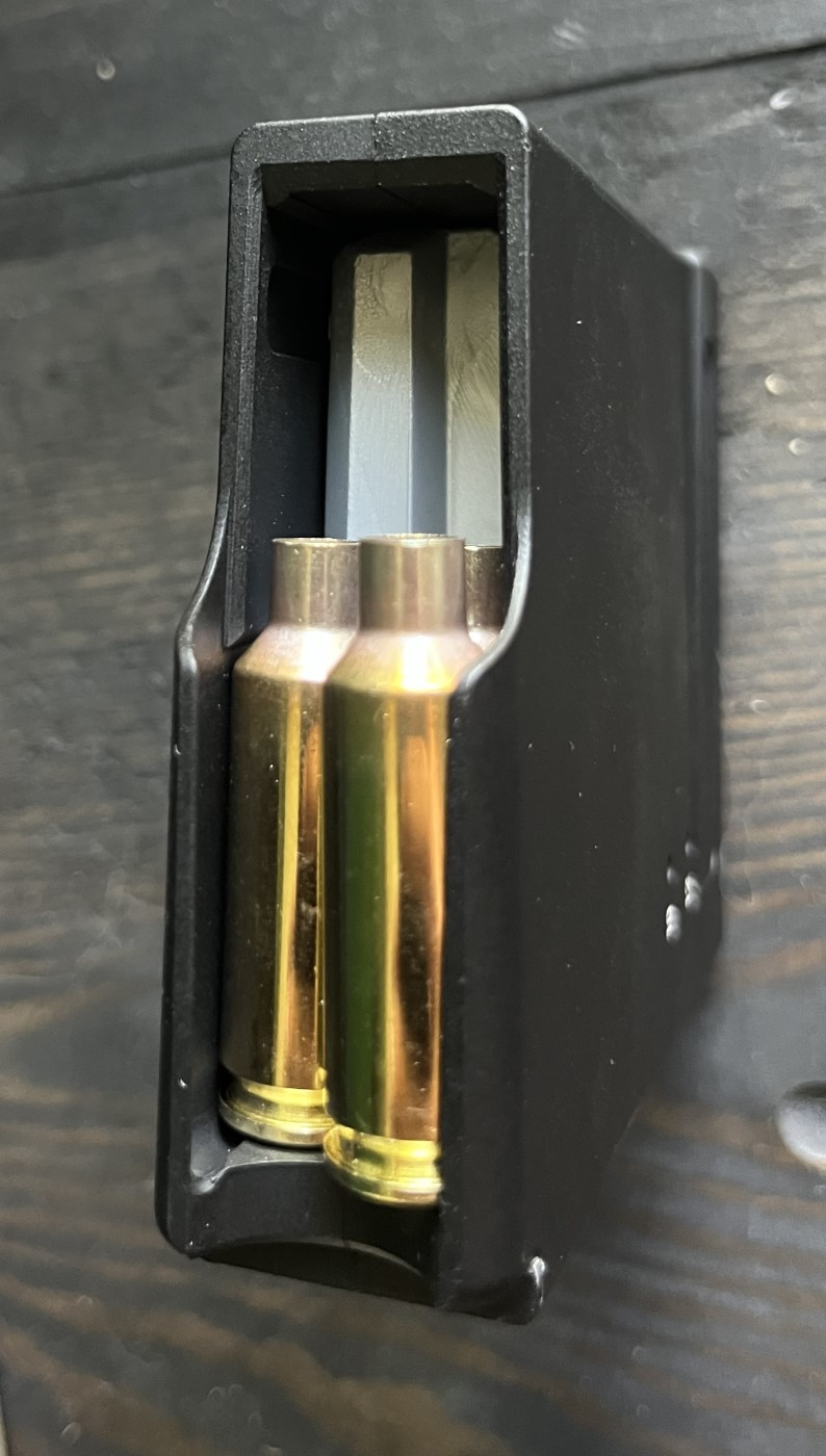

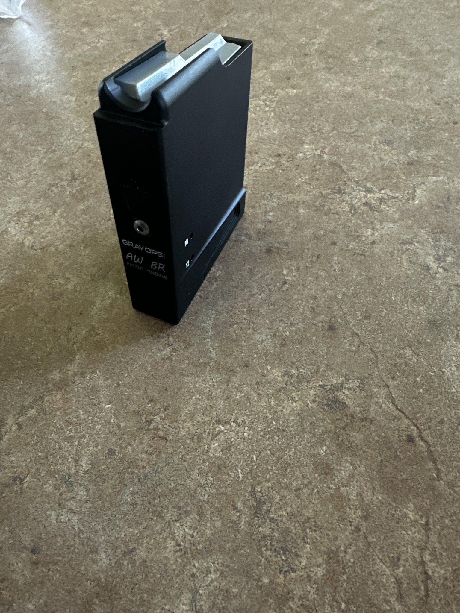

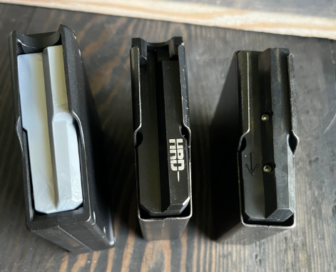

Did anyone here end up with one from the first run?
If so, is the spacer removable? It says "built in" which makes me think it's milled as part of the walls, but haven't seen a good top shot to confirm.
Thanks
Just the one right now.
Super easy to adjust the mag latch. There's an accompanying QR code in the box that directs you to Dave's video on how to adjust the latch. That's about all the tuning you'll be able to do. No bending of feed lips. I guess you could manipulate the spring geometry...
The spacer is not removeable. There is a ridge/stepdown inside the mag just forward of the feed lips/shoulder. Fit and finish is tops, but there's going to be no adjusting feed lips without a file or a 7 axis...
