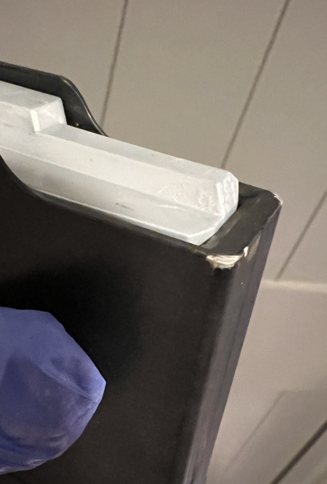

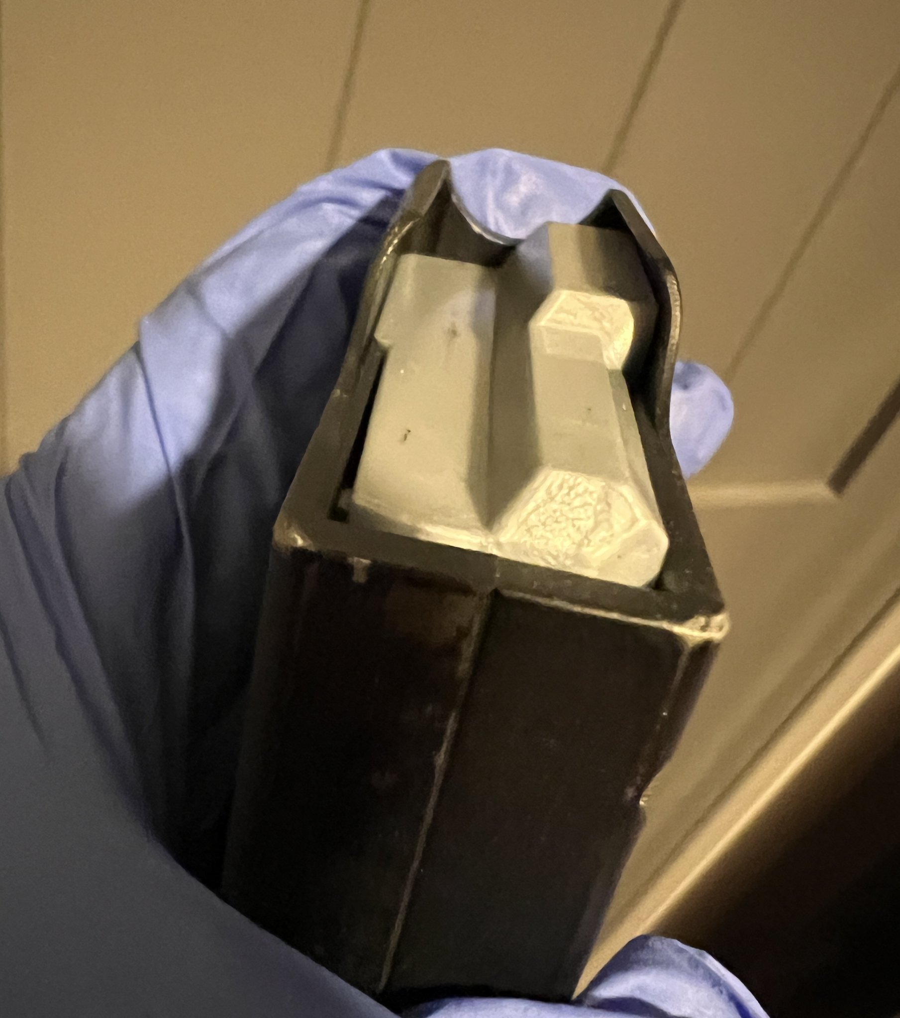

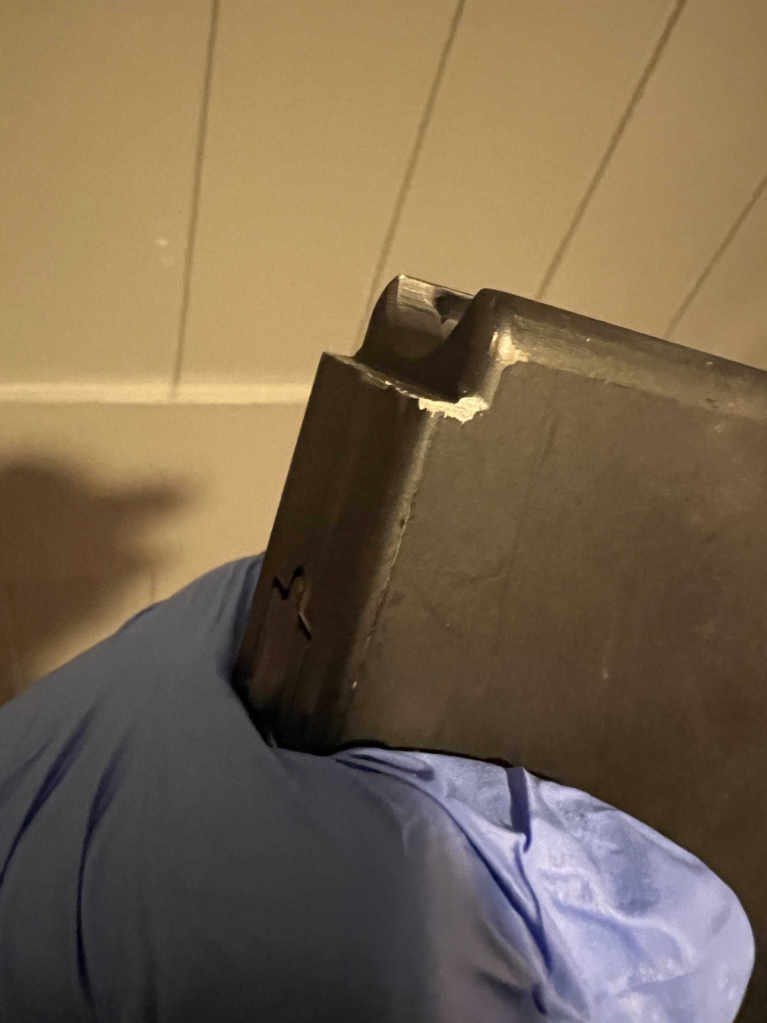

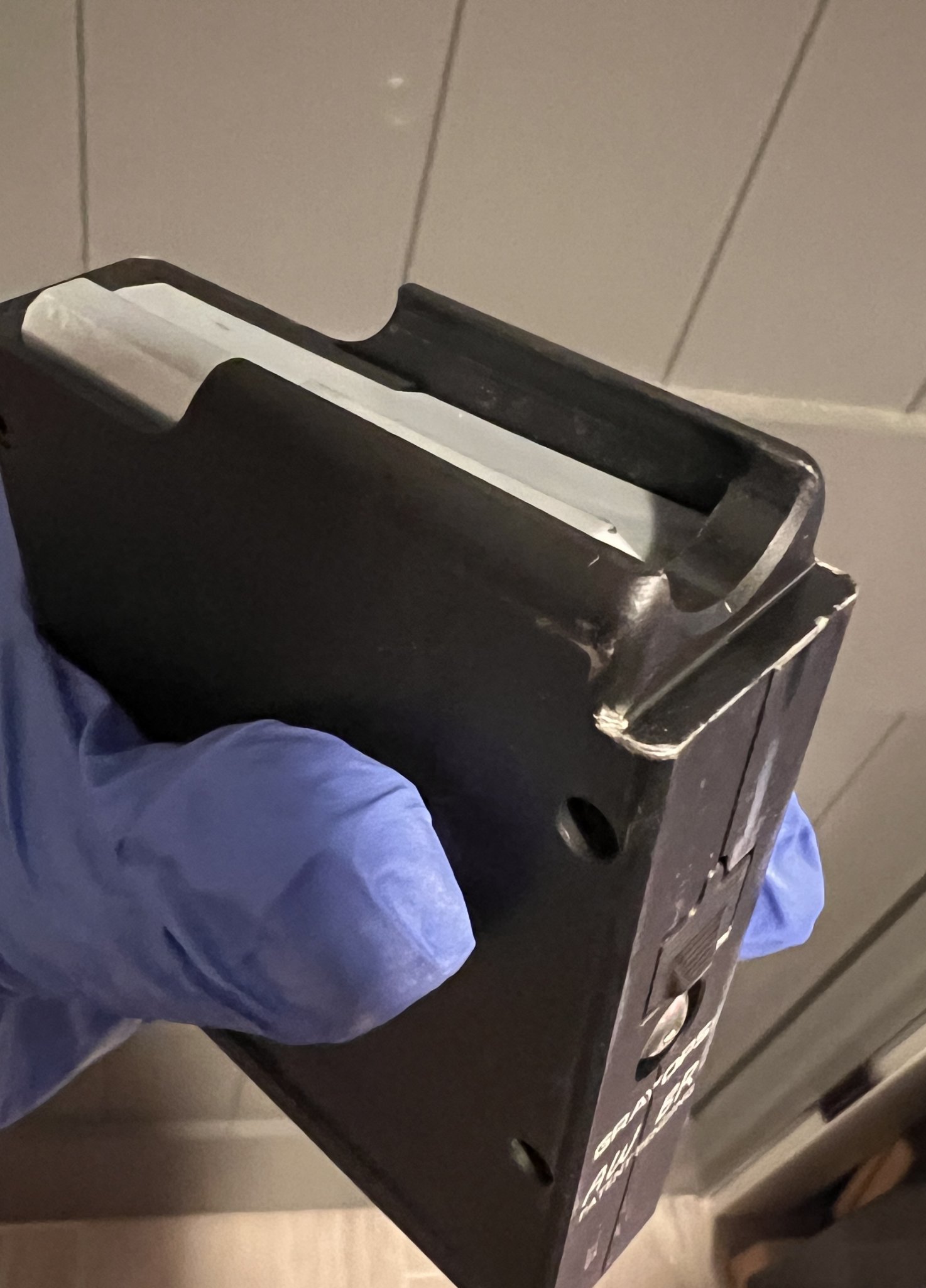

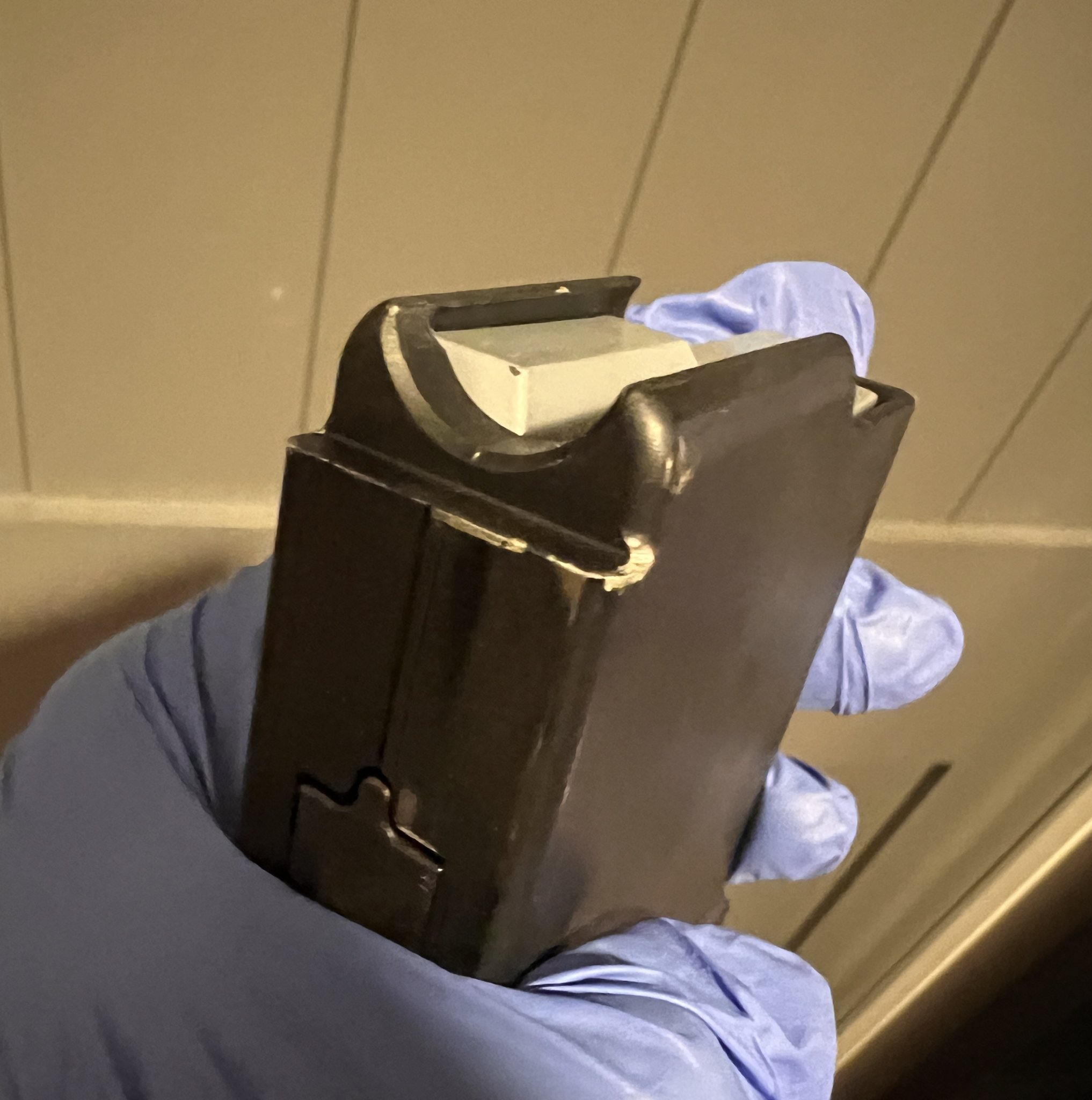

You guys get any sort of burrs/wear on the mags? I haven’t even shot mine yet, just cycled some rounds through the AIAT and inserted/released the mag maybe 30 times.
Not the best pics, but…
It’s not the finish wearing that concerns me a little. It’s the burrs that have been created.
View attachment 8423284View attachment 8423285View attachment 8423286View attachment 8423287View attachment 8423288
I got some slight insertion wear but it’s nbd. They’re mags.
Take a file to any burrs.
Reactions: carbonbased
Yeah, I was going to file it but left it until talk to the company to make sure it’s no biggie. My much, much more used AW mags have barely any wear, but obv aluminum is soft.
Just wanted to see other people’s experiences.
