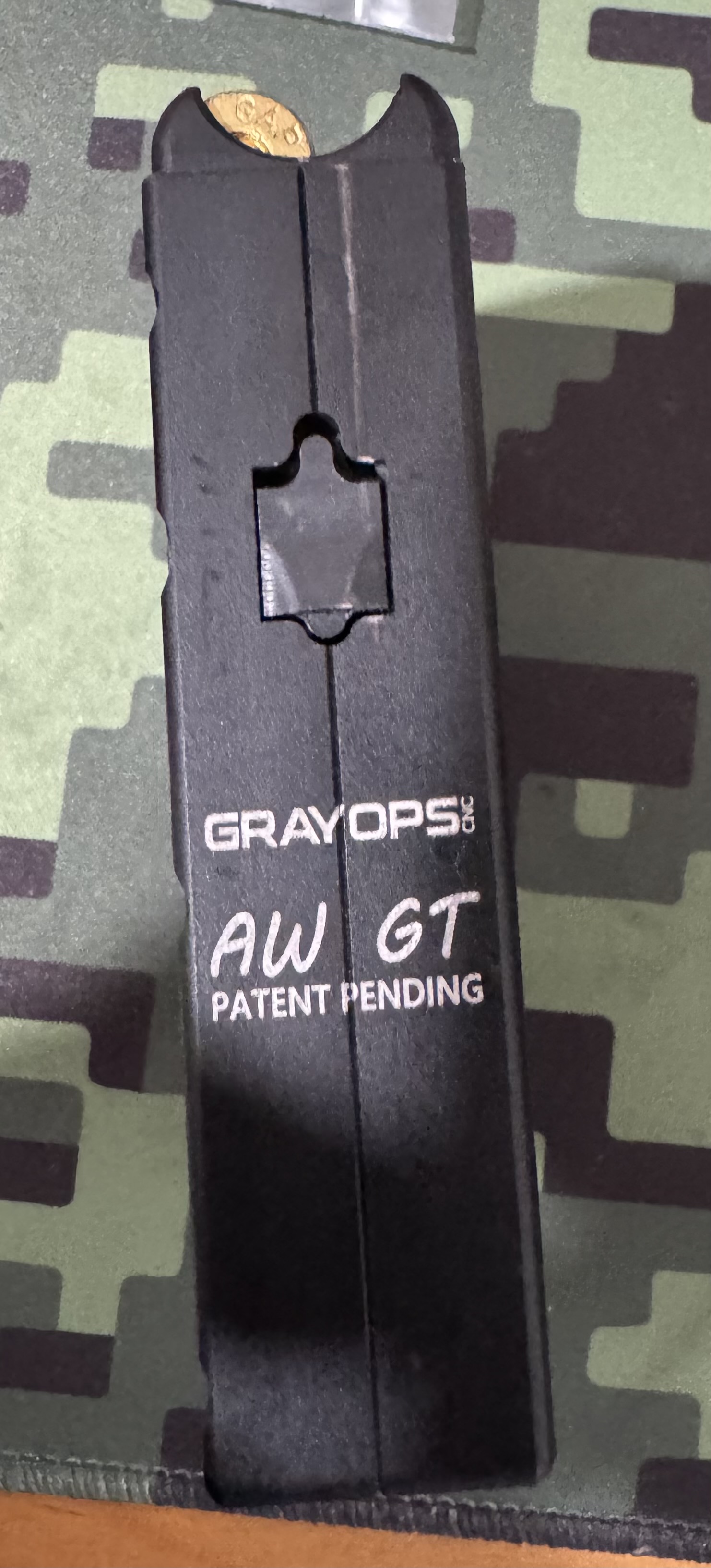

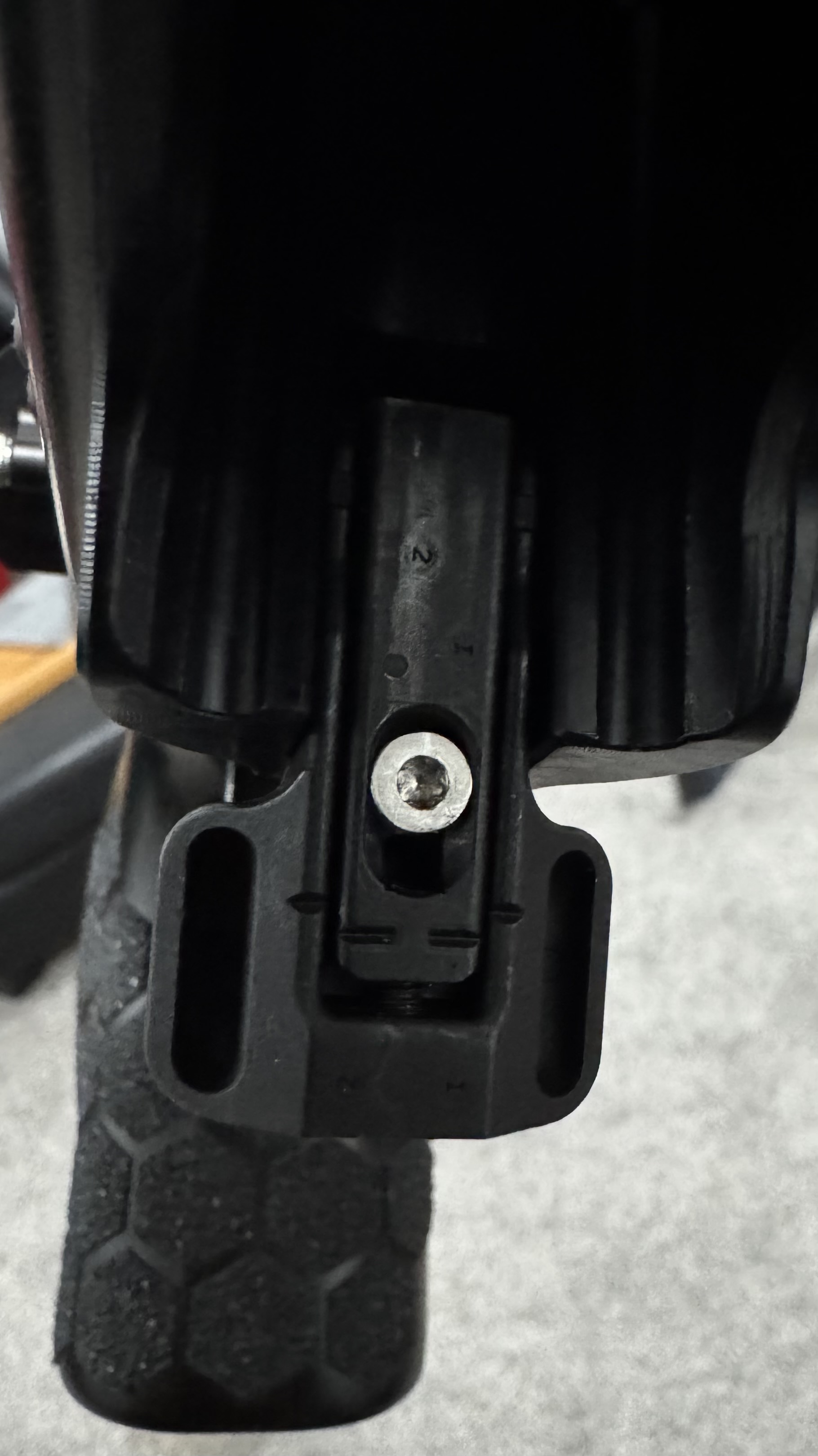

Just as a note, I bought some of the 6GT version of these Gray Ops AW magazines and even at the top adjusted setting for the mag catch they run exceedingly tight in my Manners TCS mini chassis (BAT Hammerhead Action) where it takes considerable force to be able to drop the magazine.
I'm going to take some material off of the mag catches on the magazines (since I swap regular AICS actions into this stock from time to time I don't want to adjust the mag latch on the stock) to get a tiny bit more clearance and they should run fun but FYI.
This is a mini chassis issue. Standard M5 dbm (OTM, Hawkins, MDT, etc) doesn't have this issue with chassis, Foundations, etc.

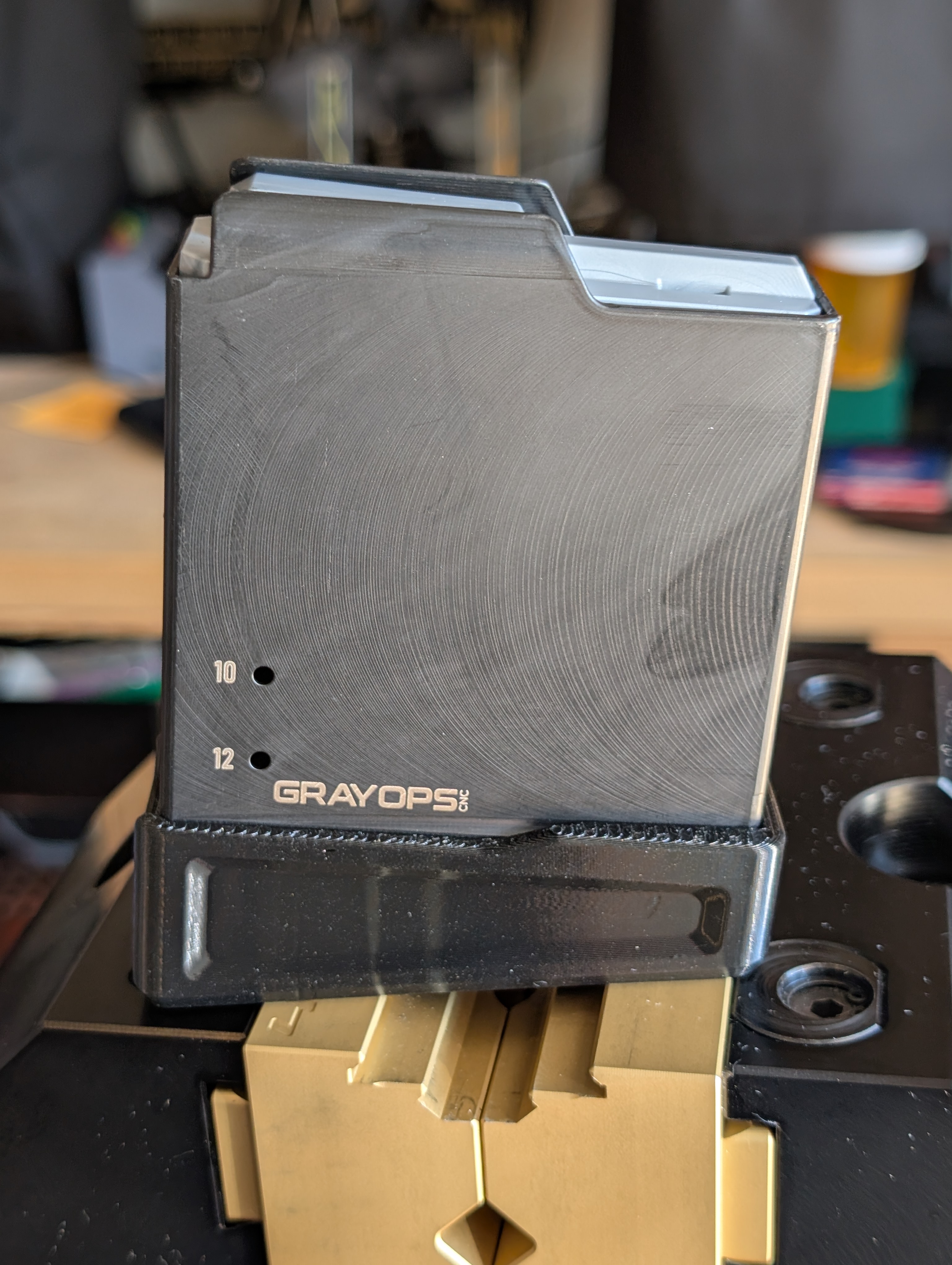

In case it helps others, for my Impact 737r with MDT bottom metal in a Foundation. These are where you need to set or at least start the fitting process. Mine feed like butter with these settings.
Mag
Bottom Metal height indicator
