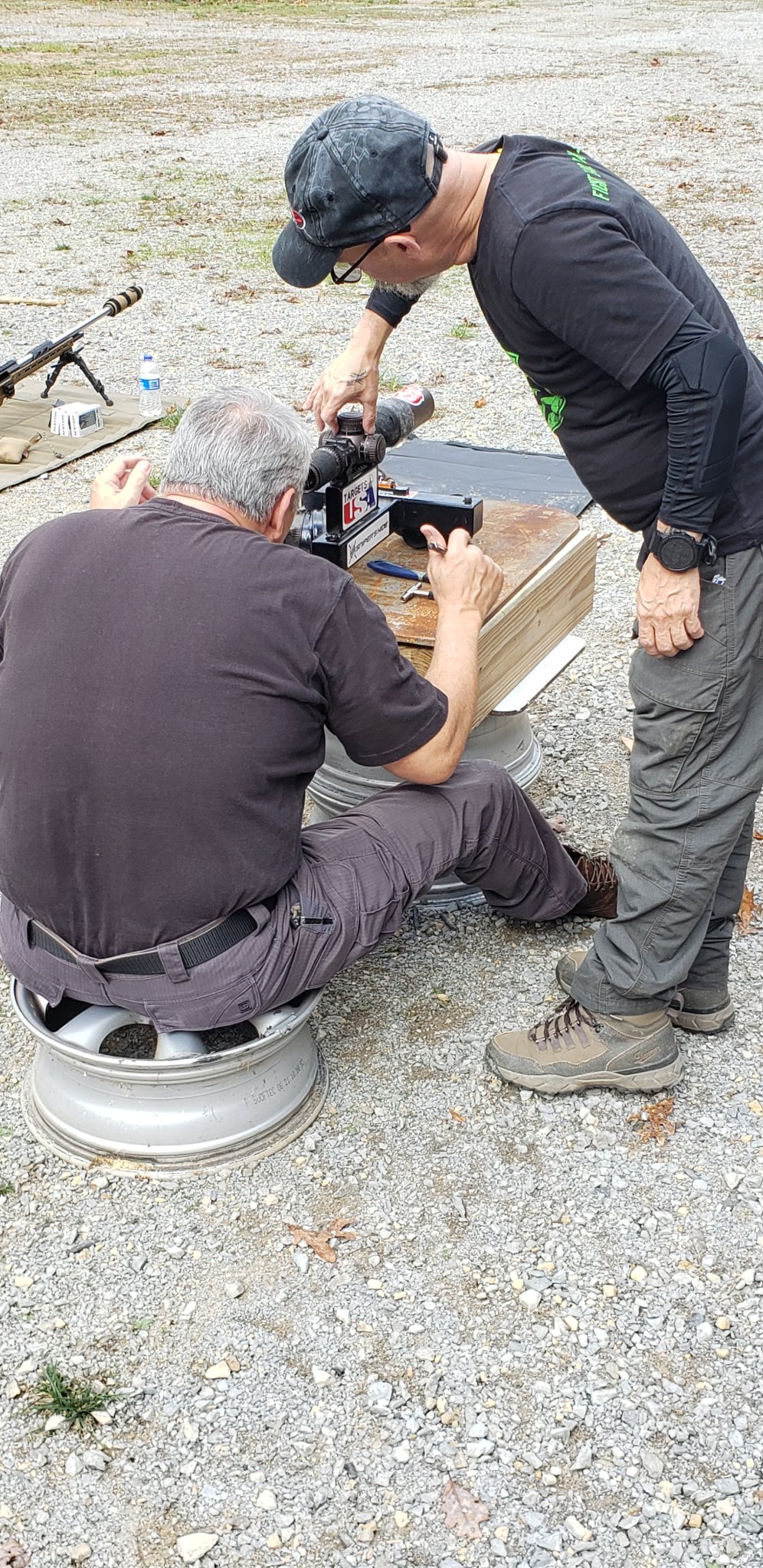

Marc and Frank testing mine (idk if I've already posted this pic in this thread).
Marc and Frank, thank you for taking your personal time to compile this information and share it with the rest of us! This is great information that will help a lot of us and we are appreciative! Also Happy Birthday!

I took the Frank and Marc clinic this past Sep (which was awesome) incl everyone pulling their scope and Marc doing a tracking test w the fixture.
Range to target, diopter and parallax settings were def addressed even to the point of knocking parallax off at one point and seeing what that looks like then setting it back.
To my view, it was all done very correctly and precisely.
I also believe we had 100% pass rate incl my Mk 5 5-25. Lol
A year previous I borrowed a friend’s fixture and tested the two scopes I have now and both passed. This provided real confidence and eliminated another variable as a the source the outcome.
I have no idea what manf raised a ruckus and I’m not asking. But I do think this is a very valuable and valid test to do on your scope.

This year's clinic at MCSA was a great experience. Frank tested 2 of my scopes and I'm beyond grateful. I would love to get a scope tracker and the scale from @Jackmaster...I cannot find where to download it, but I'm still looking. Everyone should have their scoped checked.
Ah, what scope tracker and scale?
The tall target I’m guessing @Jack Master
@Palehorse68
Well, here is the Snipers Hide scope tracking target
I have bought them…still have a bunch here somewhere. I did not see what Frank brought this year but this is def what we used the past two years.
As for the fixture….Targets USA but it is pretty dang $$.

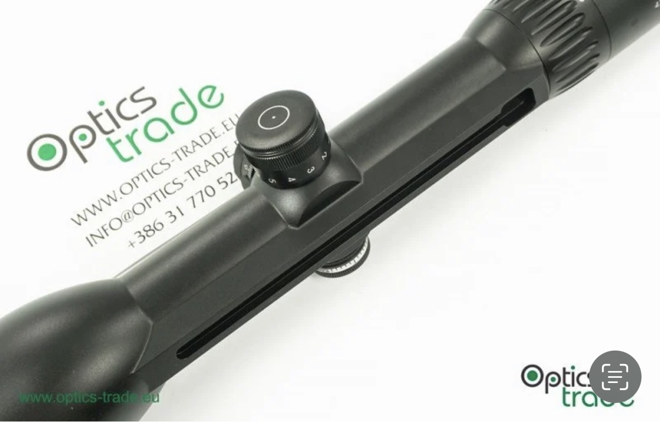

Coming from cameras to scopes I've always wondered about this so let me know what I'm missing in asking this question.
I have an 8x10 metal view camera, which you transport anywhere folded up.
Before you shoot w/it, you unfold it, and mercifully you can get the front/rear standards lined up vertically and parallel via a series of indents (notches popping into recesses).
Since half the battle with scopes is setting them up right from the start, wouldn't it eliminate frustration and the wasting of time/ammo to add a system of indents/notches to the scope/tube, and matching recesses to whatever is holding the scope in place (assuming the machining is 1st rate).
Again, let me know what I'm missing.
If I understand you correctly, you would like to see some sort of crenellations that match up with the same in the rings?
If so, then no….IMO that’s not a good idea. While we set out rings in “crenellations” on the PIC rail, we can then tune that with small adjustments to the scope’s position in the rings. Get the scope and rings where they are close then you can fine tune by sliding the scope fore/back in the rings.
An indent is usually a small notch on one part where you slide it/swivel it till it seats in a recess on another part.
Thinking about what you just said about sliding to fine tune the position of the scope, a small notch on the scope which could seat along a "groove" at the bottom of the rings would seem to me to address forward and backward keeping the reticle oriented in the same position.
In fact wouldn't that help the ability to fine tune/slide forward-backward-repositioning the scope-taking it on and off w/o worrying about even slightly changing the position/orientation of the reticle.
Reactions: Baron23
In fact wouldn't that help the ability to fine tune/slide forward-backward w/o worrying about even slightly changing the position of the reticle.
Not everybody wants their reticle parallel to the vertical axis of the gun. Some like a bit of cant so reticle is level with the gun in the shoulder pocket…particularly if shooting off hand.
Leveling a scope is really not a big task to my mind so doing something like you suggest seems to be a solution looking for a problem. But others certainly may view it differently.
