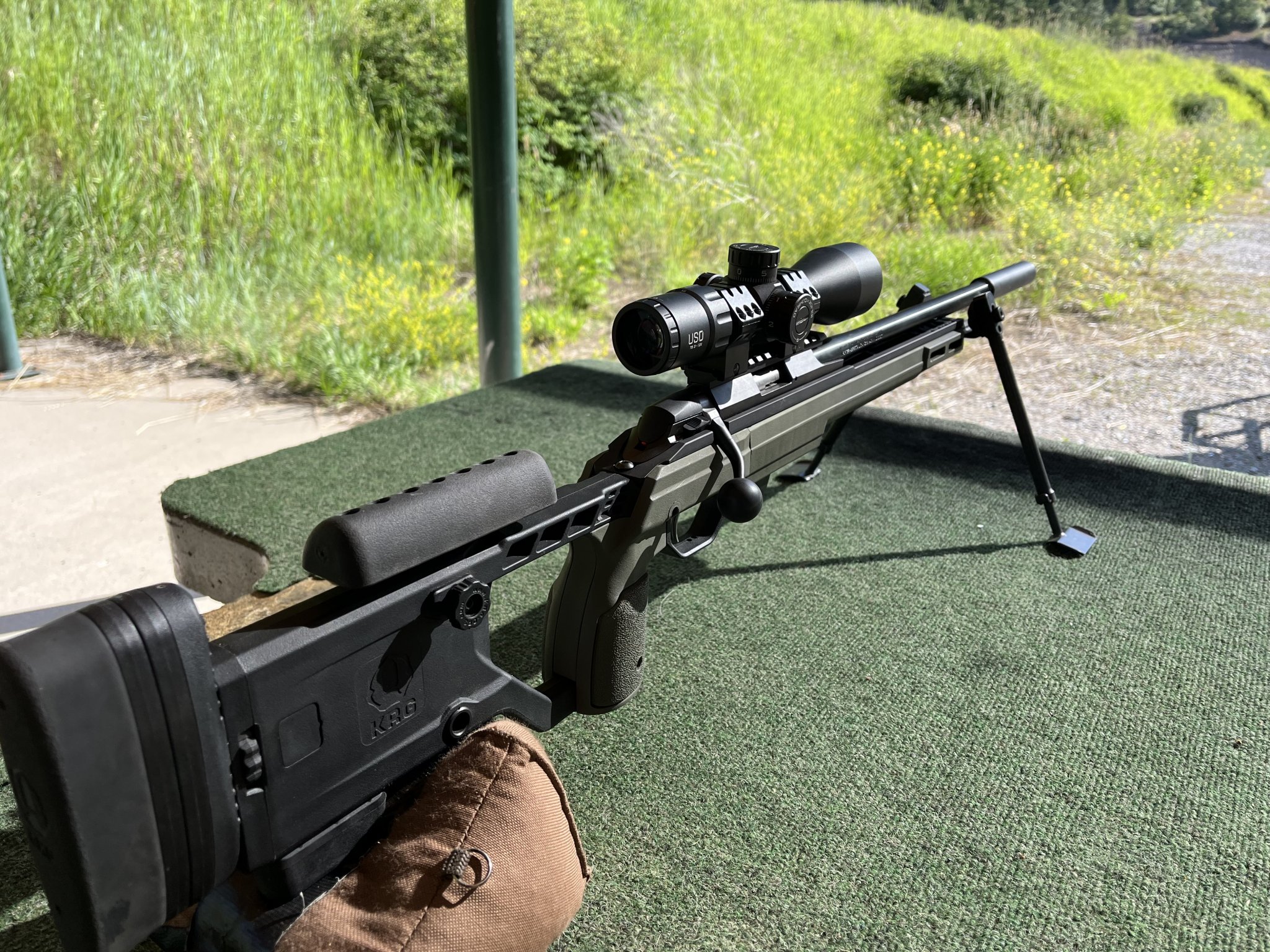

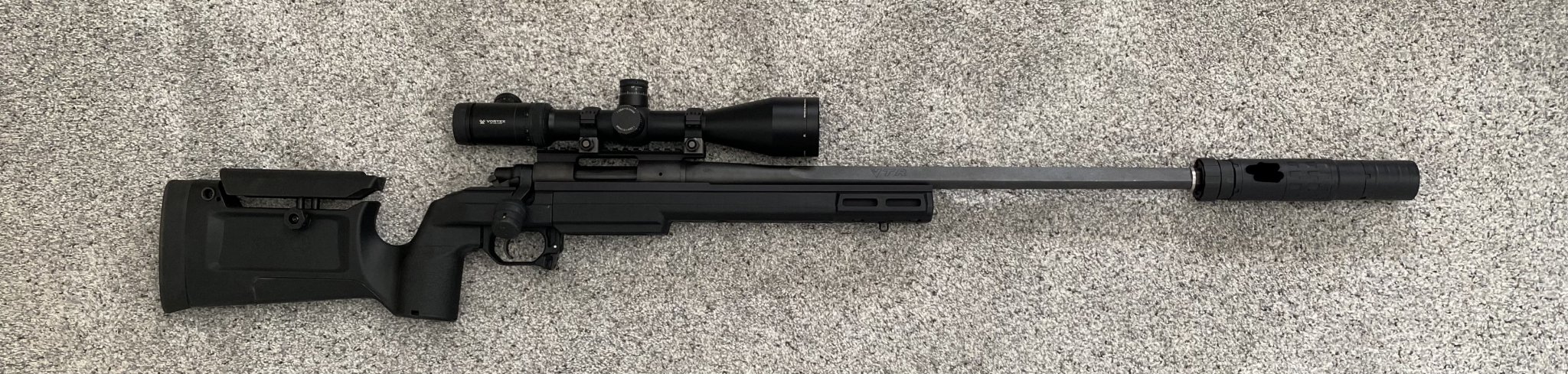

I love shorty builds. In NH distances usually run from 600 yards to 1100 if you are lucky. But 600-800 is the norm.

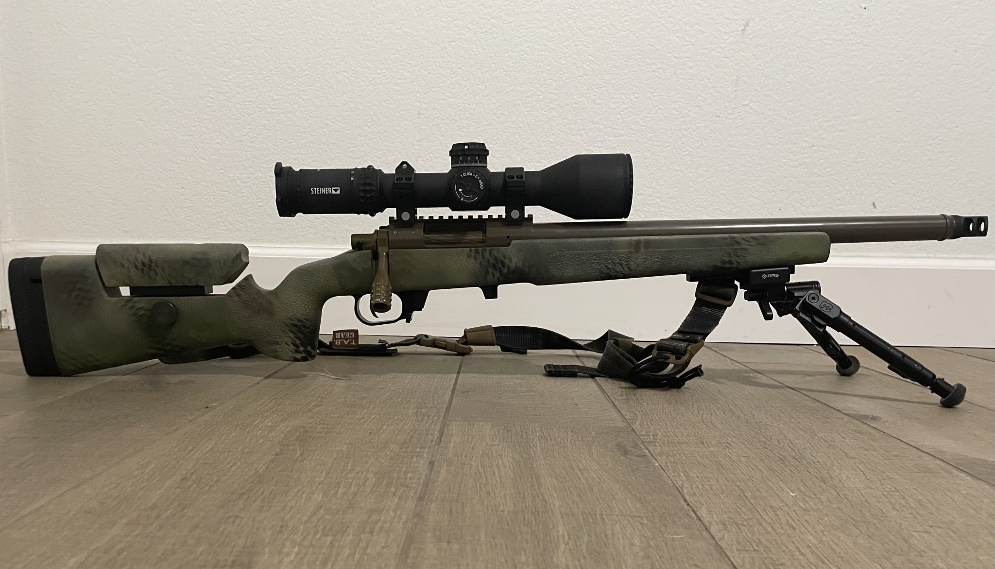

The 3 builds I have had are:
R700 6.5CM
-16" XCalibur Remage barrel
-Magpul Pro700 folder for easy transport
-140gr ELDs at 2600fps with H4350, shot 1/2 MOA all day suppressed
-Handy and fun for NVD use (wish I had a better pic)
Surgeon 308Win
-18" Bartlein chamber by Bugholes
-Had a McMillan A5 but dropped into a Pro700 for similar reasons
-175gr Noslers at 2574fps with Varget, shot 1/4 MOA if I did my part
-Fun with subsonics at about 1MOA
Stiller Tac30
-18" Mullerworks barrel done by Bugholes
-Manners EH2 but only because the TF3A is having an EFR added into it
-Shoots 1/2MOA or better, closer to 1/3 MOA if I am on my game
-80gr ELDM at 2803fps with Varget, may switch to StaBall Match for some more juice
Dropped the 223AI into the new TF3A that just came back with an EFR.
Really enjoying the balance and feel of the medium palma barrel.

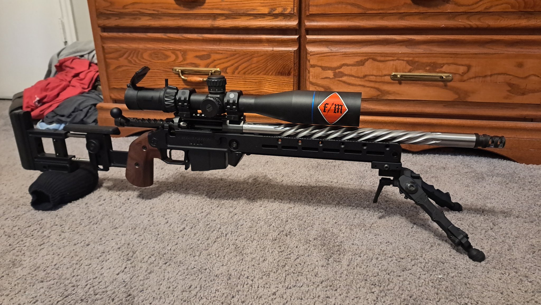

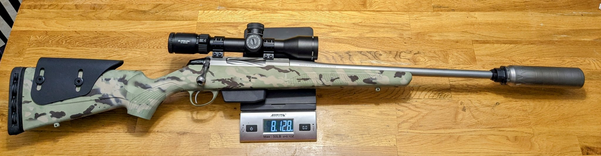

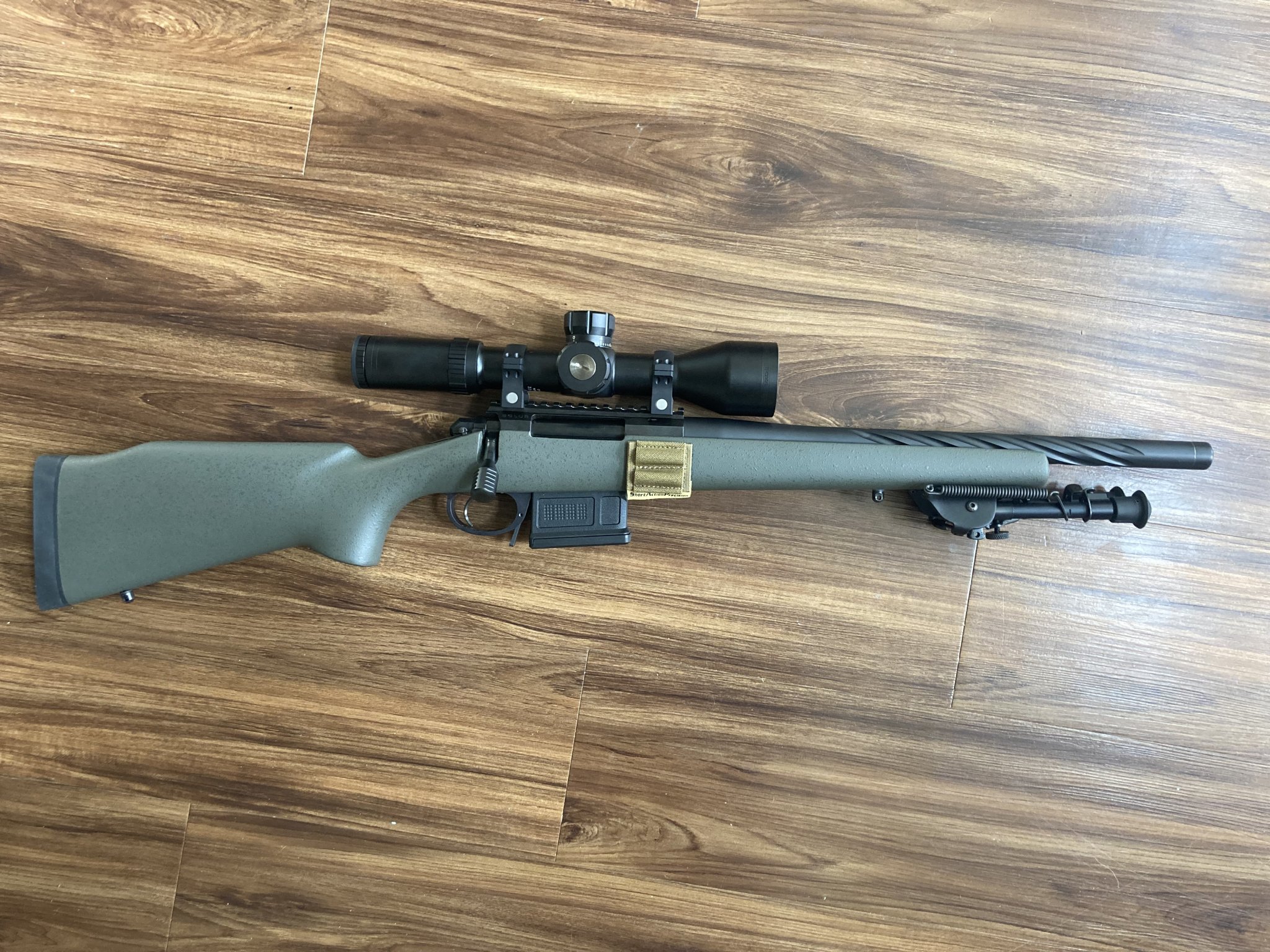

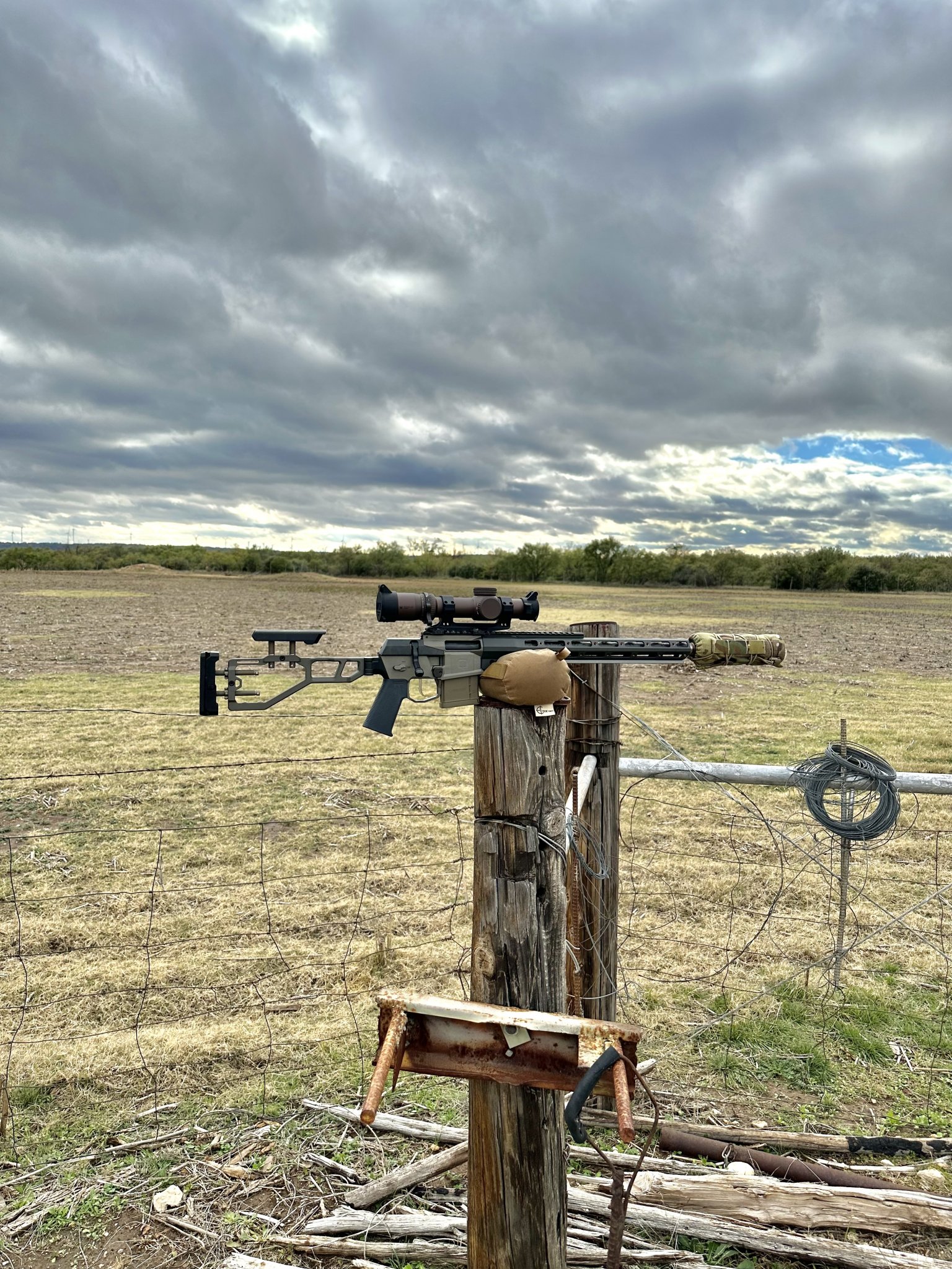

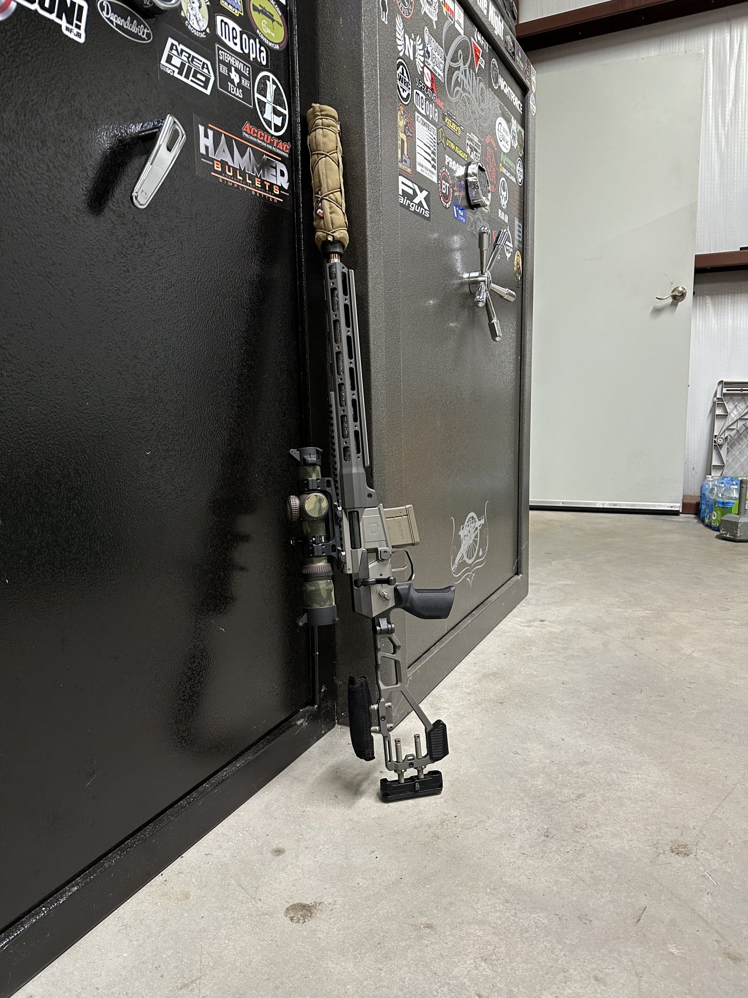

Ok, got my scope, and a cheek rest added, comes out to ~8 3/4 lbs missing only a sling and 5 rounds, I think that's light enough for a 300 WSM. The 6.5 PRC Mag holds 4 down, and the balance point with can is right in front of the mag. I have 20 rds of 200gr ELDx and 20 rds of 168gr E-Tip, both over RL16 to try this weekend.
My primo Rust-Oleum paint job has already chipped in one spot, I probably need to go back and redo it with better prep (didn't sand or use a separate primer), or maybe try a better paint like Aluma-hyde.
Update us after you take it out. I’m interested to see how the short barrel preforms with the wsm

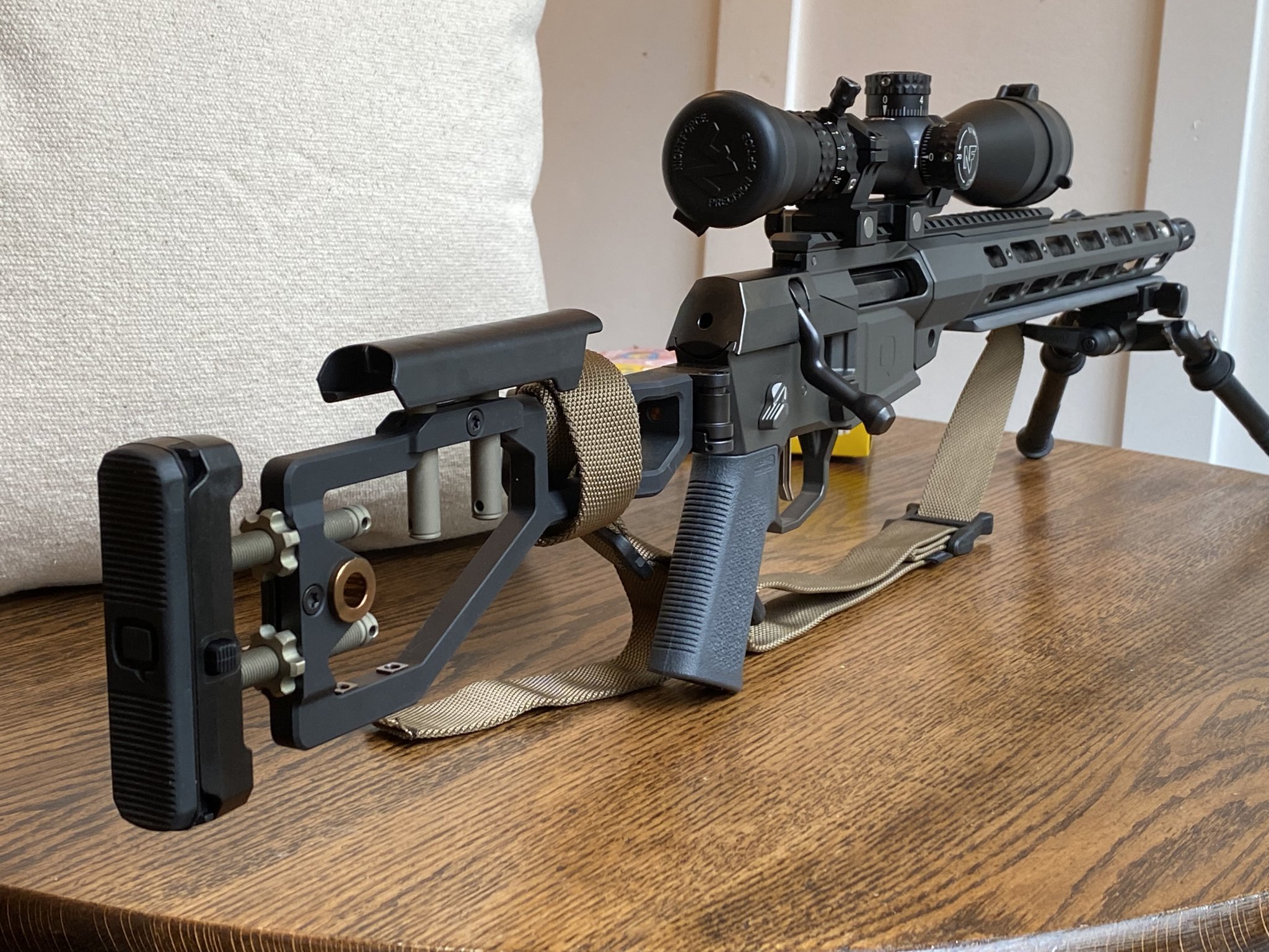

I have the exact same set up, but no barrel yet. Standard bolt face and I'm looking at running a 16" 308.
I would love to find a Cadex folding chassis.
I wish that had the ability to run a top rail for clip ons. Slick looking chassis for sure.
I took it out the last few weekends to Chrono some spreads for velocity and shoot some groups, here's the velocities I saw.
Reloder 16
200 gr ELDx, 30 off
04/28
60.5gr - 2,576 fps
61gr - 2,595 fps
61.5gr - 2,594 fps
62gr - 2,637 fps
05/06:
62.5gr - 2,585 fps
63gr - 2,622 fps
63.5gr - 2,674 fps
168gr E-Tip , 60 off
04/28:
63.5gr - 2,750 fps
64gr - 2,774 fps
64.5gr - 2,812 fps
65gr - 2,800 fps
05/06:
65.5gr - 2,827 fps
66gr - 2,850 fps
66.5gr - 2,861 fps
Staball 6.5
200 gr ELDx, 30 off
05/06:
63.5gr - 2,652 fps
64gr - 2,643 fps
64.5gr - 2,665 fps
65gr - 2,710 fps
65.5gr - 2,767 fps
05/06:
67.5gr - 2,873 fps
68gr - 2,947 fps
68.5gr - 2,936 fps
69gr - 2,997 fps
69.5gr - 3,026 fps
165gr TGK, 30 off
68gr - 2,914 fps
68.5gr - 3,011 fps
69gr - 3,004 fps
69.5gr - 3,023 fps
70gr - 3,023 fps
There's some data points anyway, I'm going to focus on Staball next time, although most of the RL16 groups were moa-ish, and some below (I'm pretty happy given the scope I'm using). I think Staball is going to be a better burn speed for velocity, and I've had good luck with it in Creedmoors, .30-06 and .280ai.
One bummer is that my scope (Athlon Helos BTR2 2-12x42 FFP) took a dump a few shots into the second trip. At every shot the parallax would change and when the scope came back on target from recoil, everything was blurry.... I was actually able to shoot groups fine, but had to adjust the parallax after every shot (wasn't going to waste the drive up). That's what I get for using cheapy ChiCom scopes I guess, Athalon refused to RMA even though it was basically brand new, so I sent it in to the warranty department today, we'll see what they do. Either way I'll probably need to get a different scope for this particular rifle because the windage turret blocks reliable ejection from the Tikka.

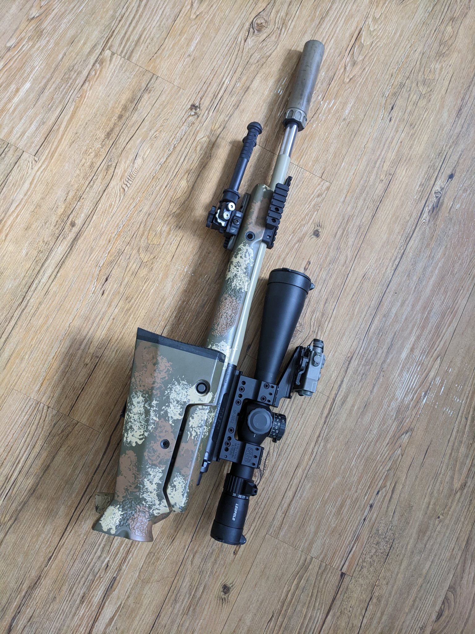

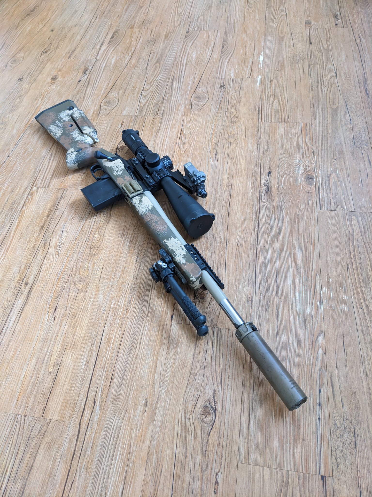

Here are a few of my shorties.
-Christensen 12.5” 6.5 turned SBR
-Q Mini Fix turned 16” .223
-Built 16” 22creed

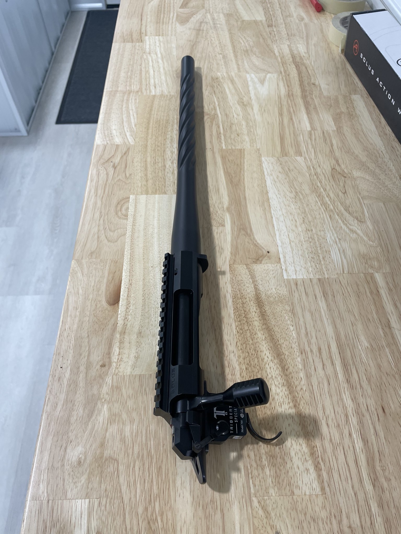

New 300Blk in the family....
Accurate Ordinance Action (Stiller)
Wilson #4 1:8 16" spun up by @FisherT&C (rattle canned after)
KMW Sentinel Stock w. Badger DBM & EFR
Timney 517 trigger
NF NX8 1-8
Eratac Mount (selling to it put an ADM for better eye relief)
Sig 7.62Ti can
Currently has 40MOA of cant, but will be 50MOA when the new mount arrives.
Did some initial shots with 8.0gr of V110 and Hoosier 220 powder coated bullets. Velocity was 1068fps with an SD of 7 using Starline brass and Ginex primers. Seemed to shoot close to 1MOA at 100 yards.
Shot the attached 5 shot group at 100yds using the plated 220gr reloads with CFEBlack I mass load for my SBR.
Gun didn't seem to like the lighter Noslers 175 Custom Comps with the V110. Shot OK, but SD was in the high teens and low twenties.

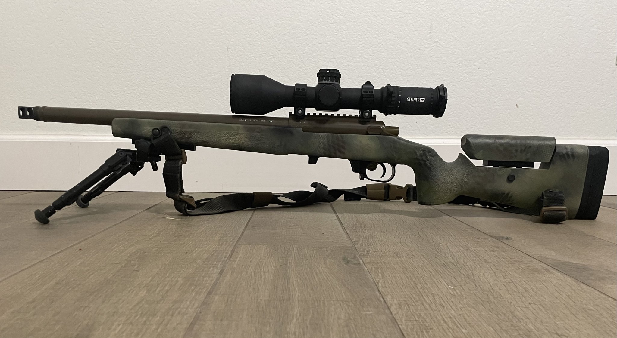

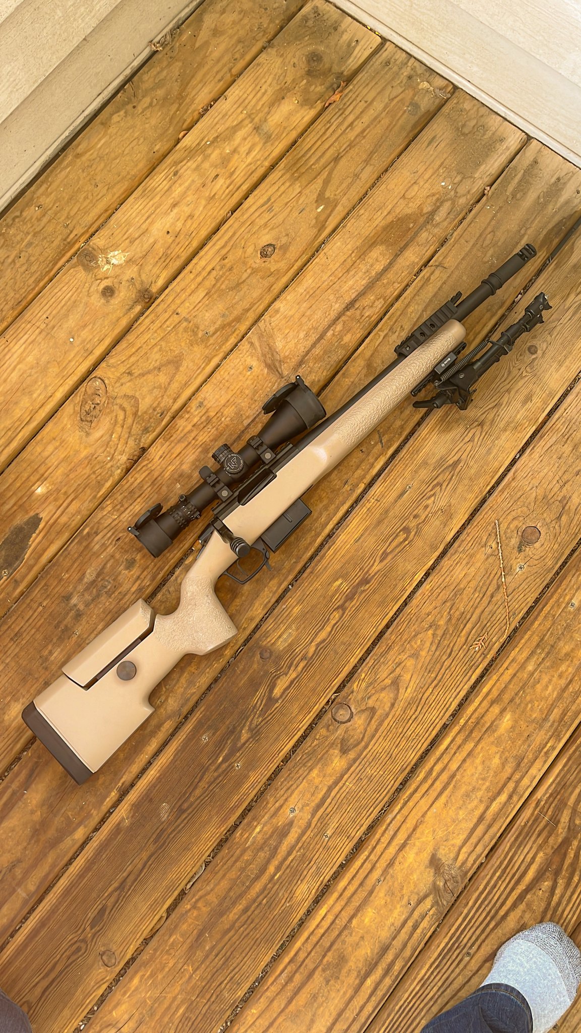

Have always loved shorties. Used to have a Remington 700 16” 308. Like an idiot, I traded it away for a revolver I didn’t like but thought I had to have. Been longing for a replacement of some kind for awhile. In strolls a Savage 110 Elite Precision in 308 that I got for cheap cheap cheap. Been shooting it for a few months and it shoots awesome. So I’ve been hesitant. But damn it this thread keeps pulling me back. So today, I dropped it off at the gunsmith. When it’s all said and done, the barrel should be about 16.5”. That’ll put it just beyond the end of the chassis. I can’t wait to get it back and see how she does. Thanks to everyone in this thread for the nudge I needed to finally get it done. Here is a quickie rendering of what it will look like, roughly, when done.
before
hopefully after - rough ms paint I know
and the 700 shorty I use to have that I miss

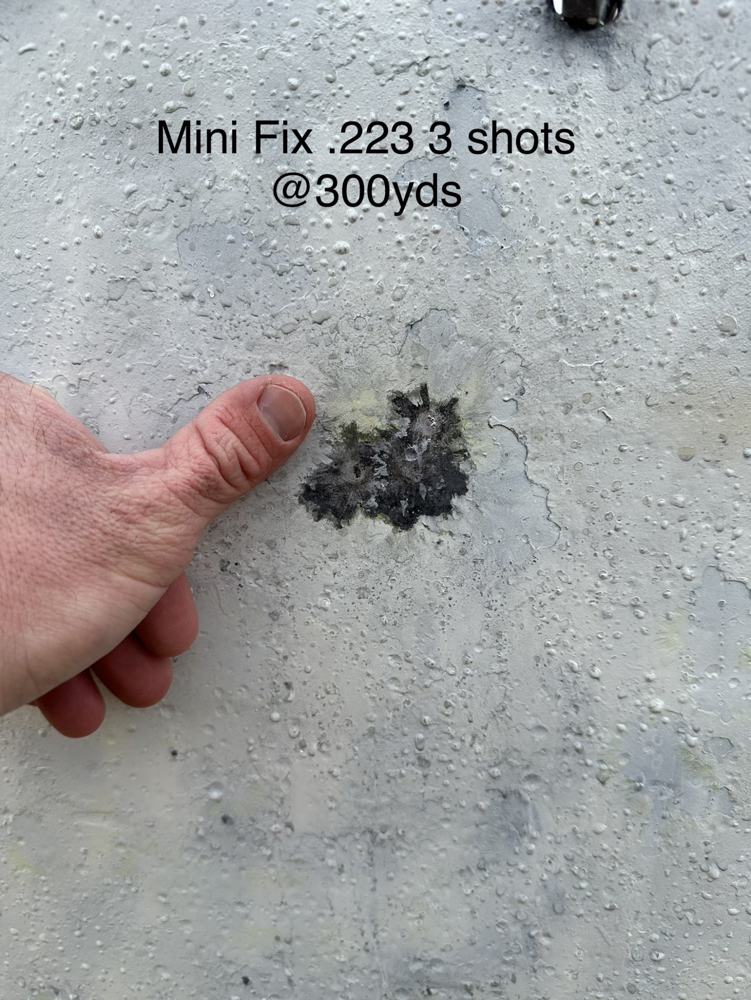

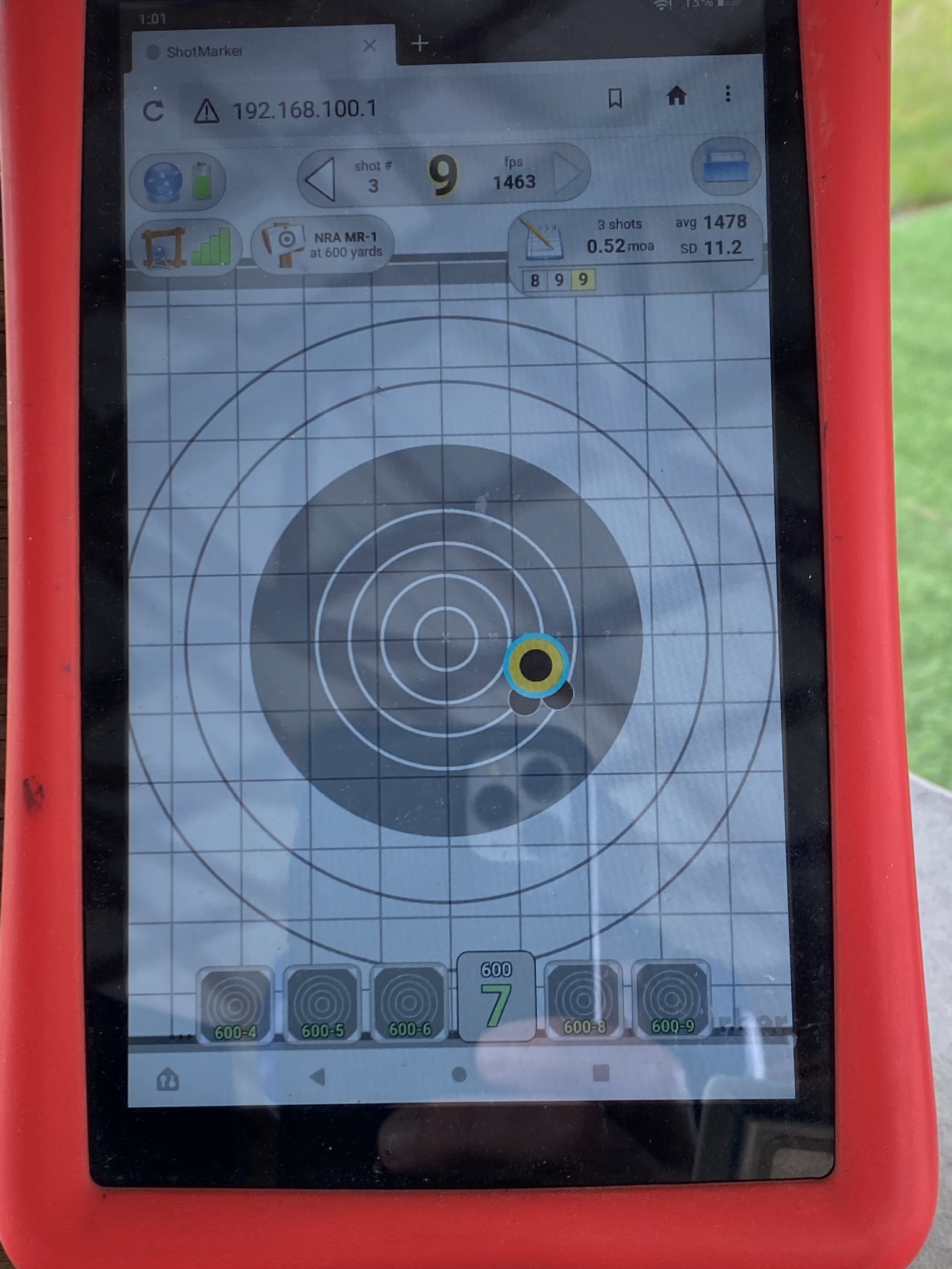

My Proof Carbon Barreled 223 Mini Fix has also been incredibly accurate! It shoots 77 TMKs, 77 SMKs, and the 53 VMAX within 1/2 moa of each other, as far as point of impact, with same zero.
300 yards
600 yards

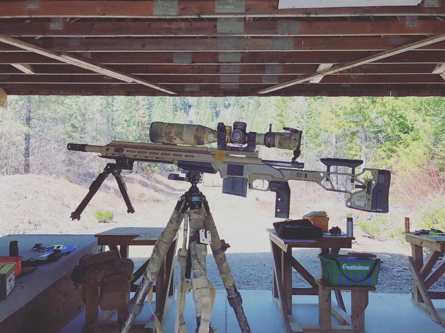

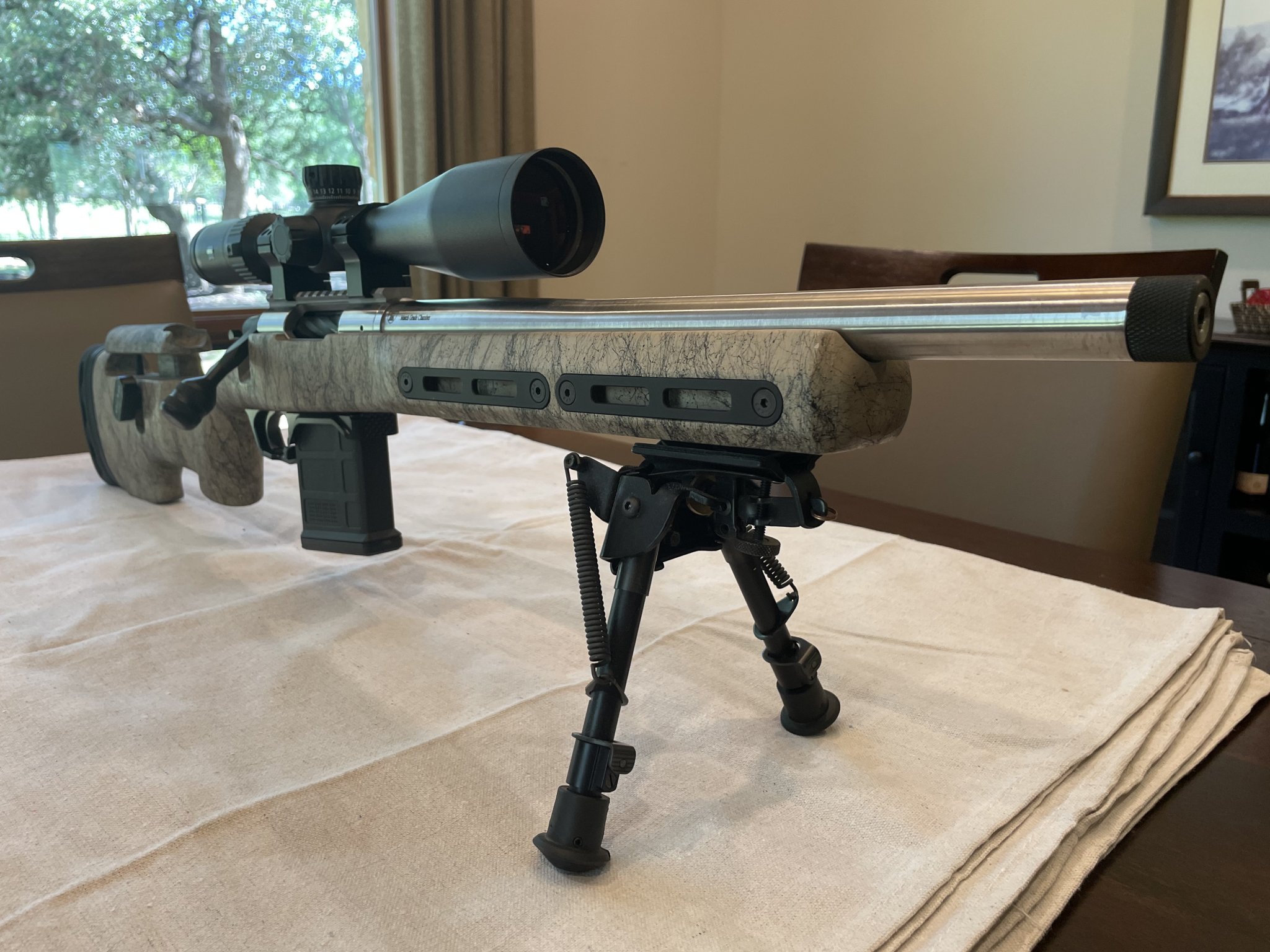

A 16.5" barrel will clear than handguard on a ACC chassis?
When I measured with my smith, it looks like between 16.5 and 17 will clear enough to get my suppressor adapter on there. Should be done in about a week or so and I’ll post finished pics.

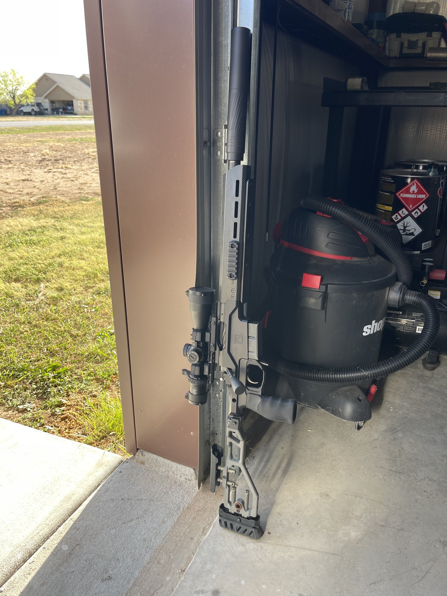

I'd double check to be sure, it'll be pretty close. I'm getting an ACC Premier chopped down a bit to go with this setup:

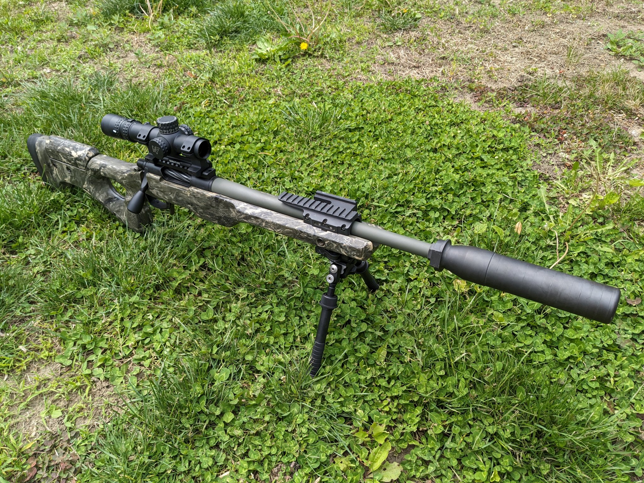

Rem 700 with 18" Hawkhill heavy palma 6.5 Creed barrel done up by Insite Arms. My go to load (140gr ELDM with 42.0gr H4350 in Hornady case at 2.200" BTO) is moving 2670fps and sub 1/2moa so I'm a happy camper. Makes for great performance out of a nice compact package. Not light (17lbs 14oz as shown with lightweight double-pull Ckyepod and Gen 2 Razor but with a full set of dampeners in the stock) but very manageable and a real joy to shoot!
Well, you were correct to question this. It turned out that right at 18” was the best compromise to get it close without being too close to the hand guard. Got it back today, and I love it. Can’t wait to see if anything has changed, besides velocity, with the loads it used to be fond of.

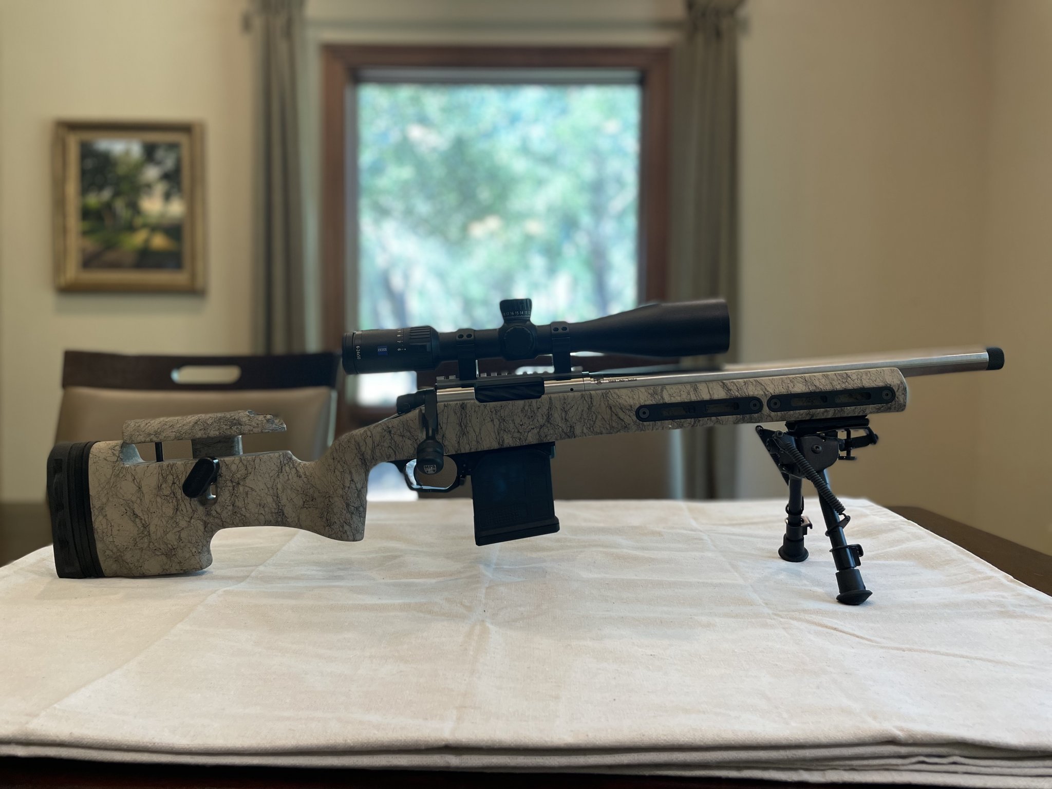

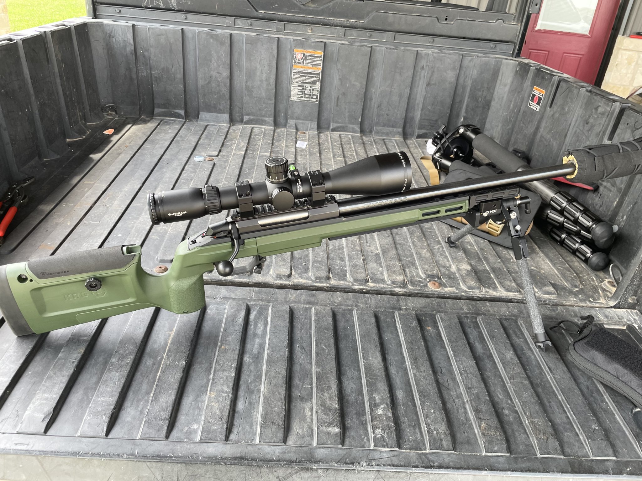

Sold the ^^^ McMillan A3, but I thought it turned out nicely. Now going to build a Proof CF 16.5 308 shorty on a Zermatt TL3. Just trying to decide on which stock. Trying to decide between Manners EH1, LRH or Pro Hunter. Shorty bolts are addictive!
