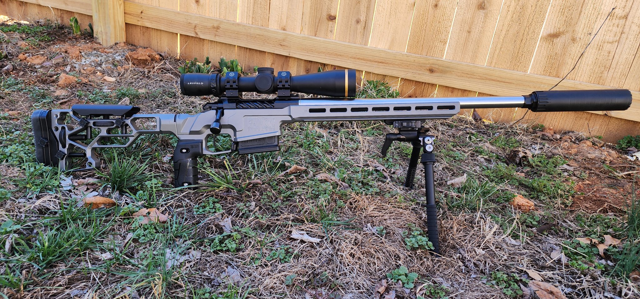

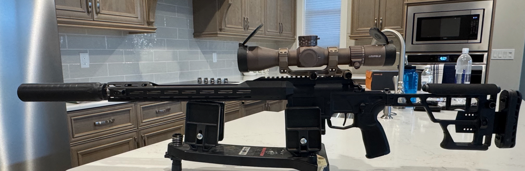

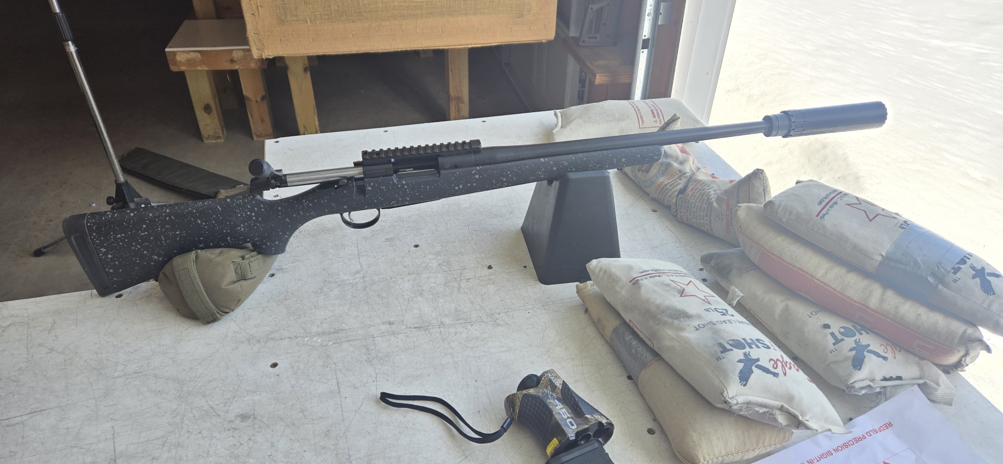

I put this one together a couple months back. 16.5” 6 Creed on an Impact NBK and Manners Night Stalker
What bullet weights and what velocities are you getting out of that 16.5 in barrel? I’m working on a 6cm in a night stalker stock with a pure precision SKLTN action and probably a preferred barrels carbon fiber barrel but im not sure what length I want to go with. I want to go as short as possible with decent velocities. Going to coyote hunt with it.

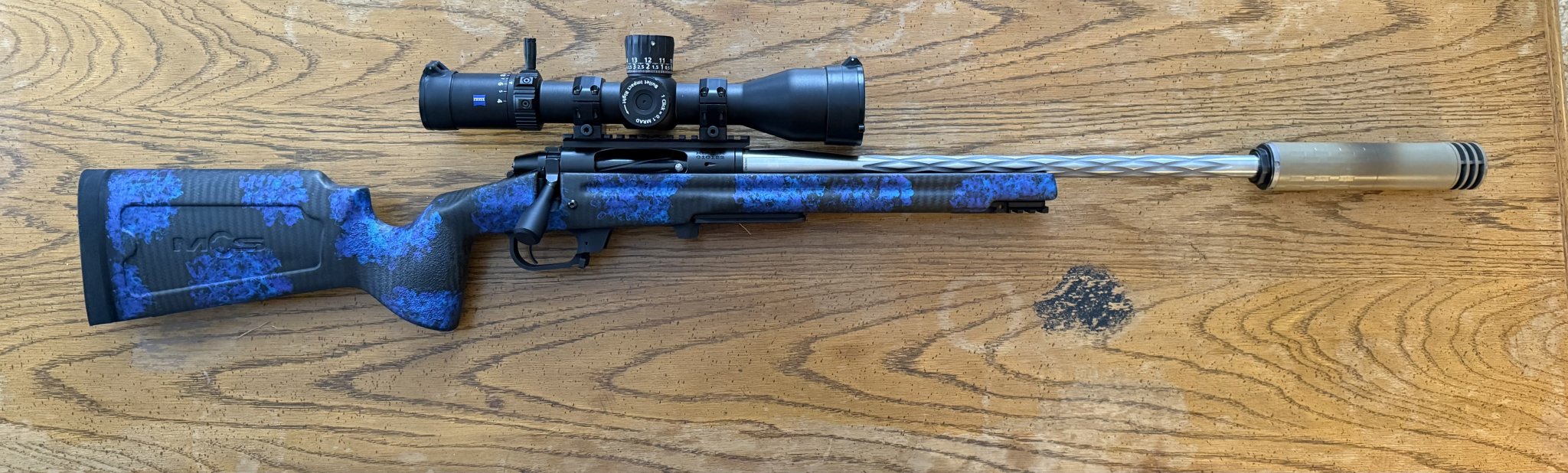

Bighorn Origin
Patriot Valley 18" 6.5 creedmoor .75 taperless with diamond flutes
Manners pro hunter in black and blue
Zeiss LRP S3 4-25 in Zeiss precision rings
Omega 300
Bighorn Origin
Omega 300
I really like this 750 taperless contour. Handful of guys over on Rokslide are using them in short barrel configs. 18in fluted weighs sub 38oz. Which is pretty damn light for a steel 18in barrel. Same as carbon for less than half the price.

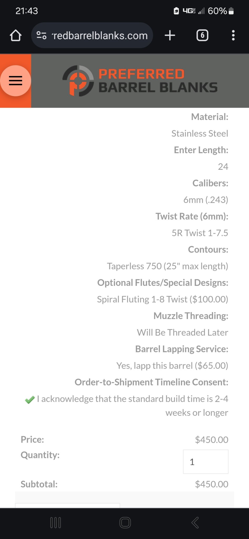

A blank with fluting from preferred is $410, if you wanted the extra lapping its $450-465. Just added one to my cart. Let your smith thread the muzzle if they're charging that much! When I priced one last week I added not options and it was 410$. That's why I thought it was half the price of carbon.
Add in the 400-550 for chamber, tenon thread, muzzle thread and it’s similar. Mine was 999 + a rush fee that I added. It would have been the same as an 18” proof carbon blank at 699 (expert voice) + smith work.

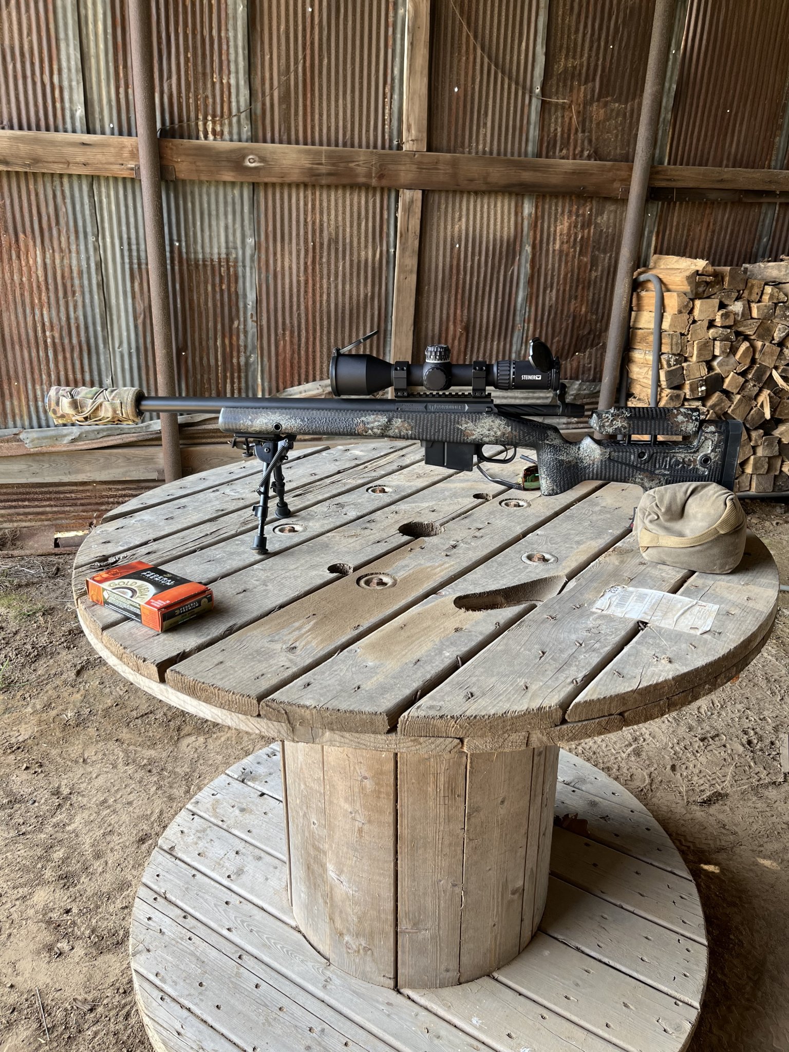

I was able to get out and shoot today, 15-20 degrees in NW Montana. Below are some speeds of factory ammo out of the 18" taken with a Garmin Xero
AmmoSDESAVG
Hornady match 140 edlm15.44512501.6
Hornady match 120 eldm11.10282751.2
Berger 144 LR hybrid target31.88832553.0
AmmoSDESAVG
Damn, those are some shit numbers for berger. Have they gone to shit now or what? I remember members here used to always put berger on a pedestal for its great factory ammo.
I was disappointed too. The first group was also about 3”, the second closed down to .9”. But they were the first 10-15 shots through the rifle so I may have been getting used to it.
I have 2.5 more boxes of the 144 so I’ll see how those play out. I also just ordered some 135 classic Hunter and 140 elite Hunter to try - then I’ll also have a good start at lapua brass while breaking in the rifle.

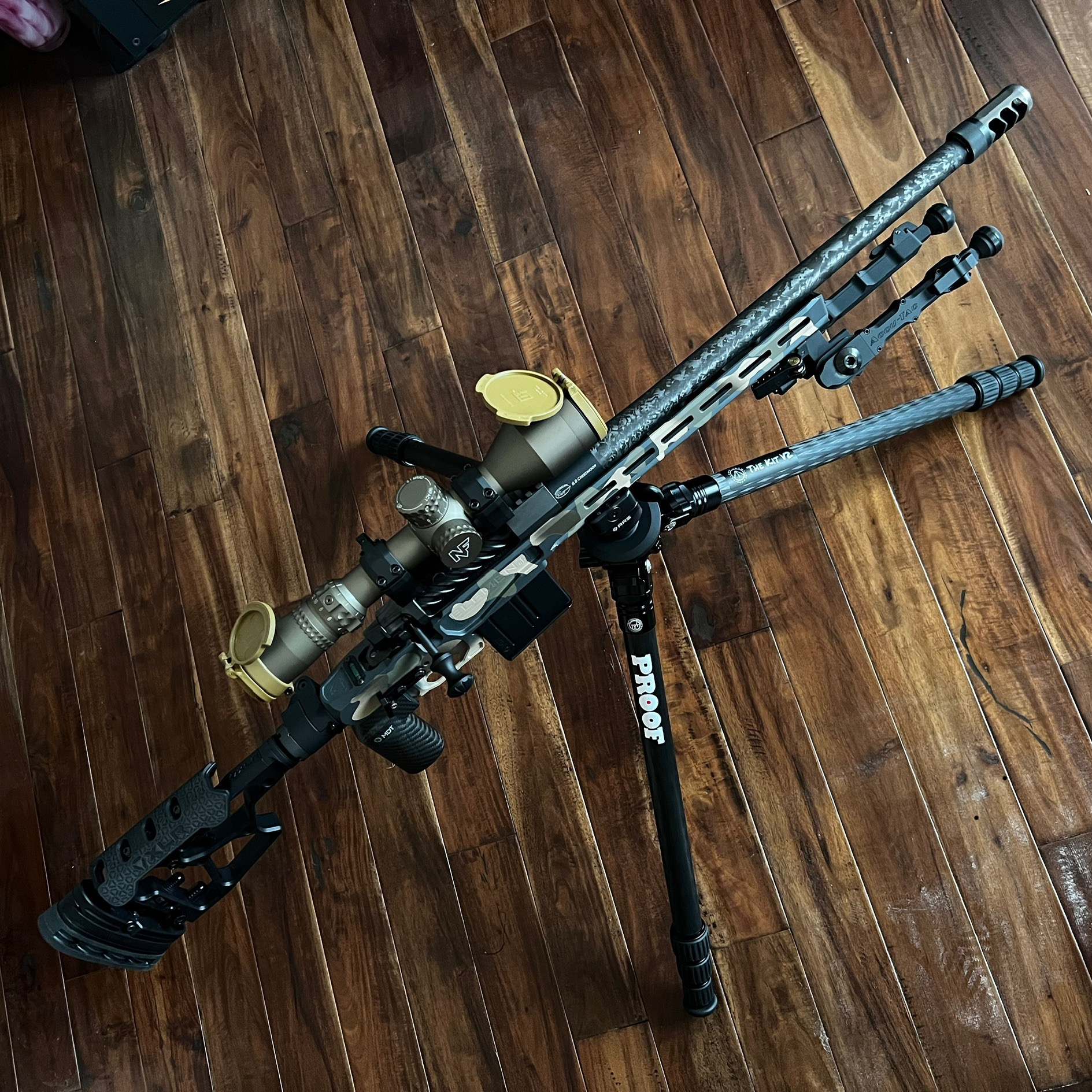

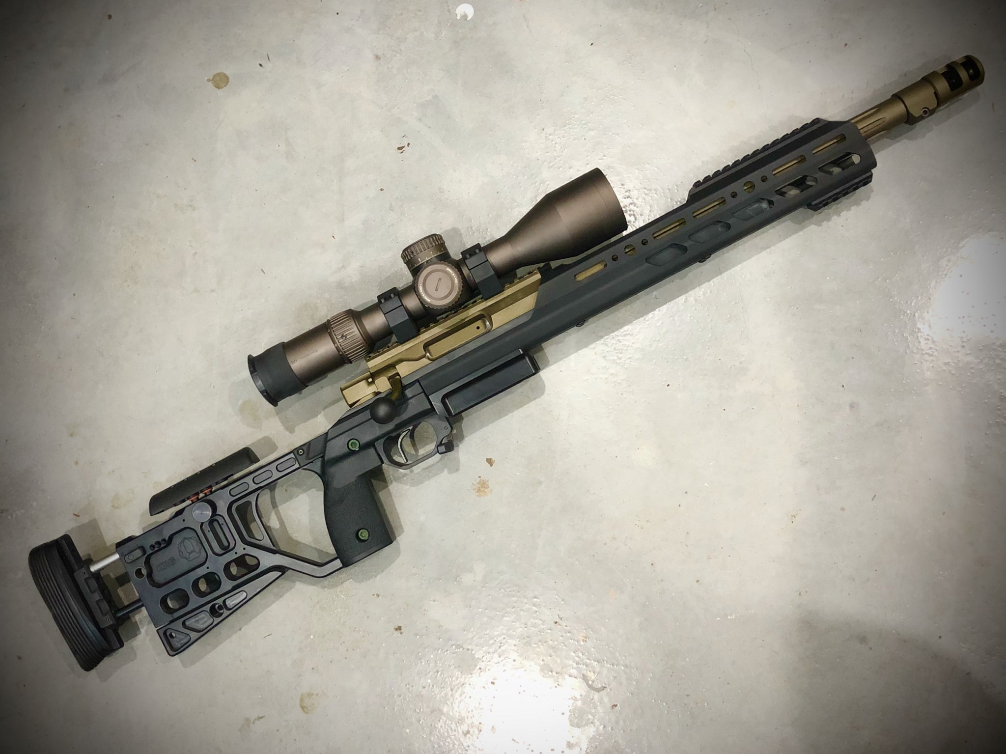

Can't remember if I've posted this here yet (it's what happens when you get old...) This is my favorite crossover rifle for hunting and long range steel.
  • Defiance Machine anTi X SA-Med 20 MOA .0710 fp Receiver – Nitride | Trigger Tech Special 2-Stage Trigger
  • Proof Carbon Fiber Sendero 18” 6.5 PRC 1:8 SS barrel | TBAC 30CB Brake with TBAC Ultra 5
  • Manners LRH SA Stock with mini-chassis and Arca Rail – Black Forest Camo, Hawkins Precision M5 BM
  • 6.5 lbs without scope and a pleasure to shoot!
Why I love short barreled short mags (keep in mind this is from an 18" barrel!):
  • Factory Norma Match 6.5 PRC 143gr HPBT MV: 2733fps
  • Reload ADG brass 6.5 PRC with 55.3 gr RL 26 behind Berger 156gr EOL - MV: 2774fps
Factory ammo matches 6.5 Creedmoor speeds but from a 26" barrel while reloads smoke 6.5 Creed out of 26" barrel...

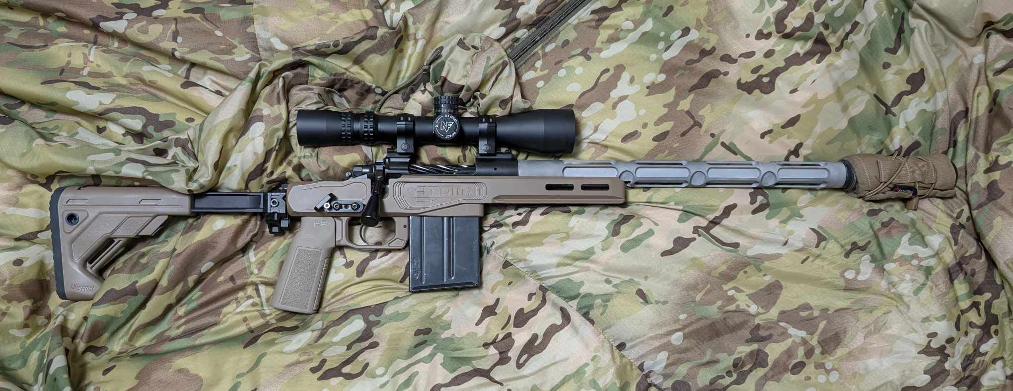

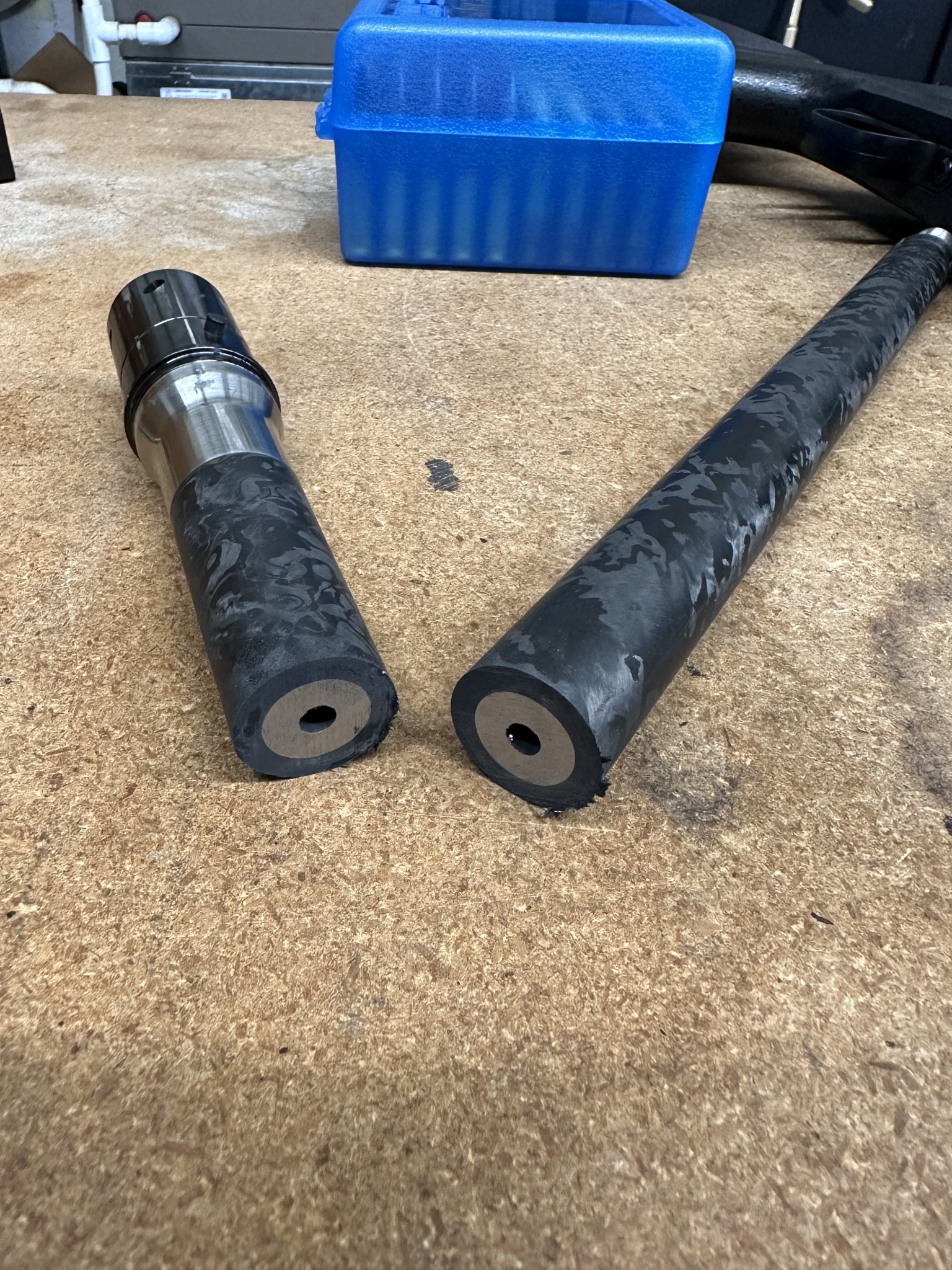

Cut the front 16" off of last year's match barrel to get into fresh rifling then whittled a bit on the Bridgeport. It rings every time it gets bumped... lol we'll see if it shoots worth a damn. Should be a good beater coyote truck gun.
ETA:
Mack Bros Element
XLR Atom + Sig folder
HS Precision 6mm ARC 16"
Warne Maxima
NF NXS 2.5-10x42
Ultra 5
