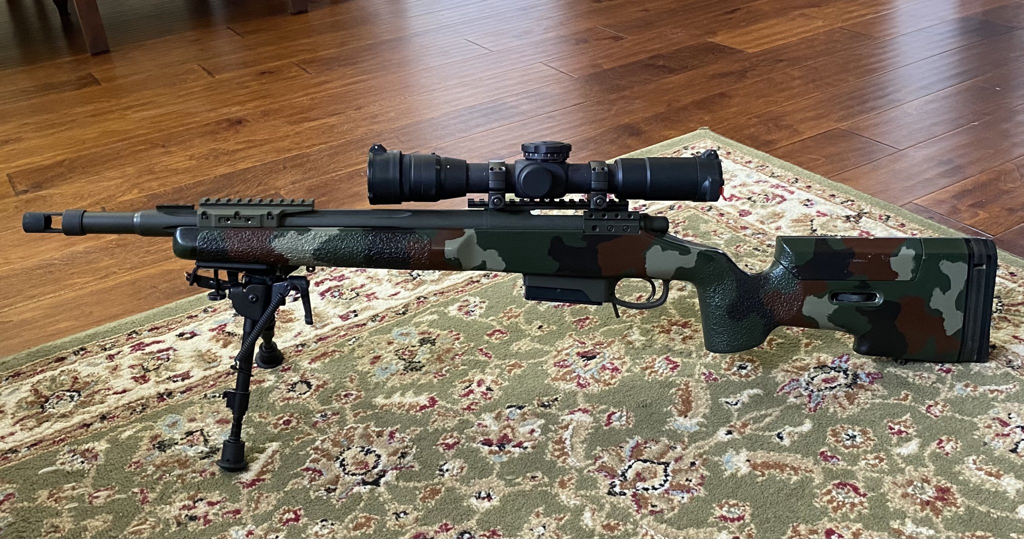

    Quick question for those shooting 155’s I am currently shooting 175’s out of this little guy with good results. I am shooting suppressed. I have my subsonic loads already and am good there. Just wondering if plinking at the range I should be loading 155’s instead? My range is out to 1250y. I have other .308’s I shoot at distance but we all like to have a more challenging time. Anyway, From any experienced .308 Short barreled bolt gun guys is the 155 going to gain me anything? If you don’t know the real answer please don’t guess as I am looking for real world experience. Thanks folks!!!

    I don’t know if I qualify as “experienced” but first off, that rifle is hot. I’ve shot with 175 SMKs and 155 Scenars from an 18.5. I never spent time trying to shoot to 1000 but in the 600yd range I felt the 155s did a bit better from that particular barrel. Had a frustrating day once with 175SMKs on a mildly windy day and really didn’t look back after running the Scenars. It also didn’t shoot 175FGMM worth a shit.
