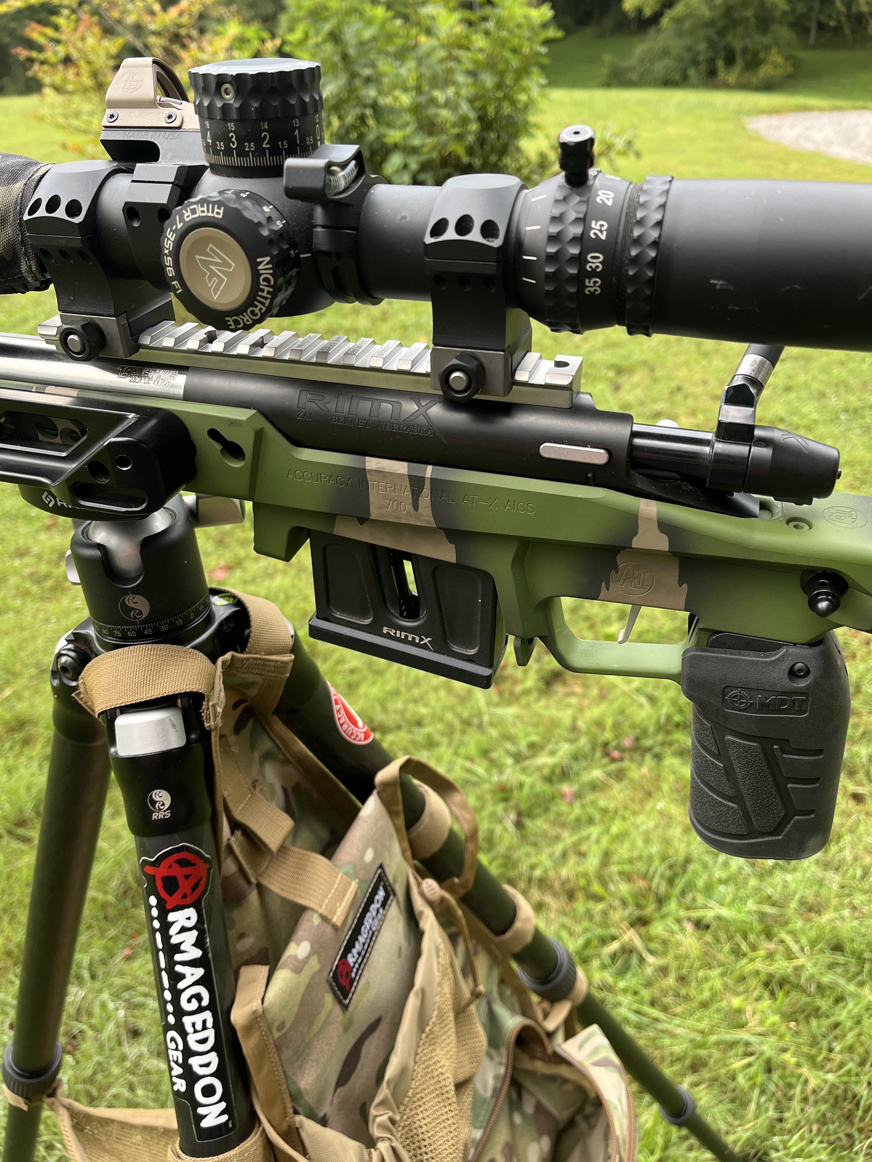

Have not had issues with my Rim-X mags. Can not speak on the Vudoo, have seen them rim lock. If the mags are of good quality, it will be a benefit IMHO. Small mags are harder change on the clock from what I have noticed.
Anschutz North America should have the skinny on that rifle
Nothing wrong with Anschutz magazines, and I run (RimX & Anschutz) both in identical chassis.
