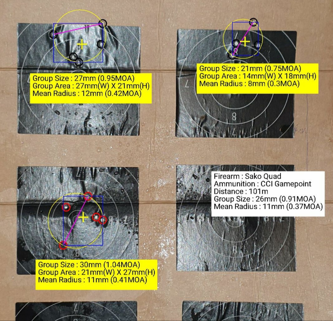

Below is a link to my current project, 50 shots at 200 yards,
There's my results, all 22lr, 22wmr, 17 hmr, 17 wsm.
Am I drawing the wrong conclusions from the data?
Feel free to critique the results.
I have no problem having someone point out my mistakes.
Only way I can learn.

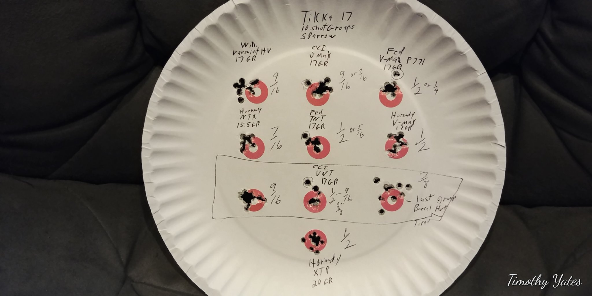

Just like Kissofdeath posted, my Tikka T1x also likes most ammo. When I bought I tried several brands and weight bullets. Ive found that the Hornady 17gr vmax are the most reliable at feeding and group size. The 20gr were also good shooters but would occasionally not feed 100%
