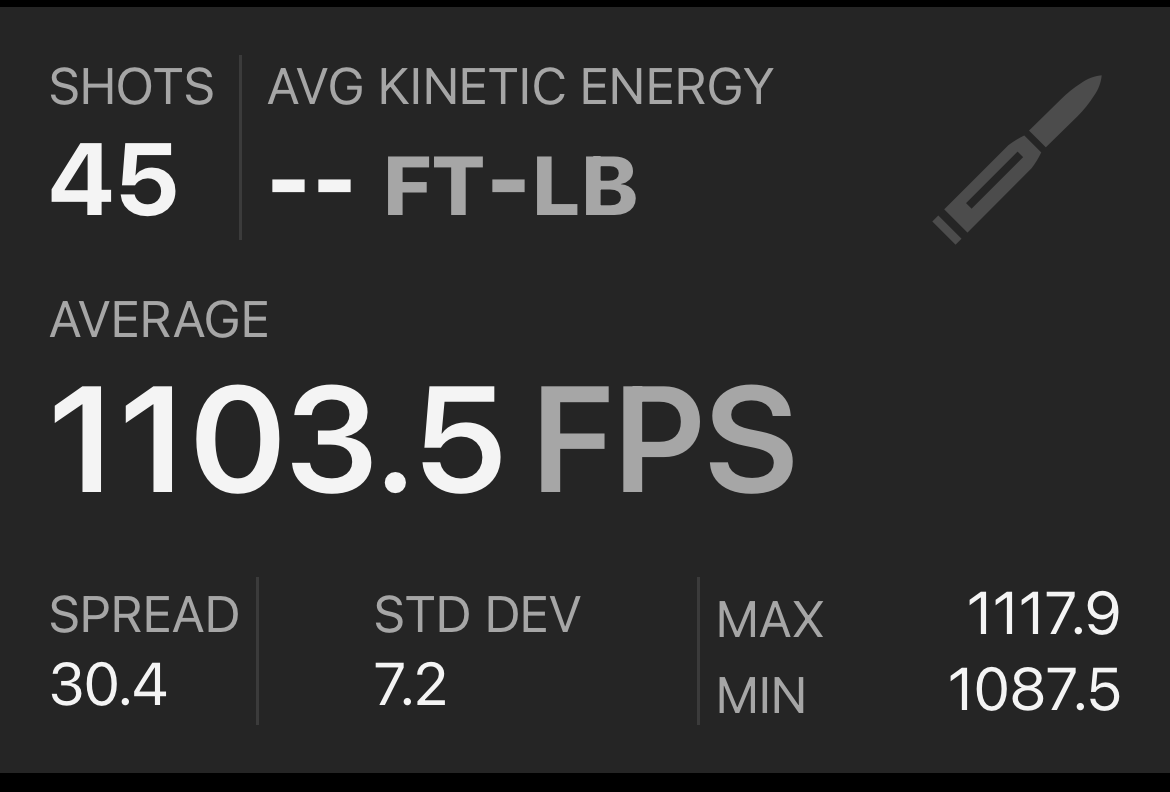

Had to sight in a new scope today. Still waiting on new ammo to arrive. Ran 100rds of CX. used 10rds to sight in and 10 used for tall target testing.
Best 10 shot grouping @ 100yds = .85" vertical, .30" wind
Best 20 shot grouping @ 100yds = .94" vertical, .74" wind
I did observe a cold bore shift at the 50yd which made me second guess my windage zero.
The shot groups seem to tighten up as the bore gets warmer.... I will try to source a thermal cam to record this next trip.
79 shots recorded with the XERO (1 got ejected due to cold range) the results for CX are as follows:
Min 1077.3 FPS
AVG 1091.9 FPS
Max 1110.3 FPS
ES 33.0 FPS
SD 6.2 FPS
Im curious how barrel temp impact MV and would it be worth it to set up a DAQ and thermo couple the exterior of the barrel at (X) interval.
Want to lower that ES for sure. I have not recored such a long string before. at most 30rds but typically 10 - 20.

33fps is about as good as you are going to get.
Over 10-20 shots you can get better but over 50+ an ES of 30-40fps isn't bad at all.
Yes sir, you are right on.

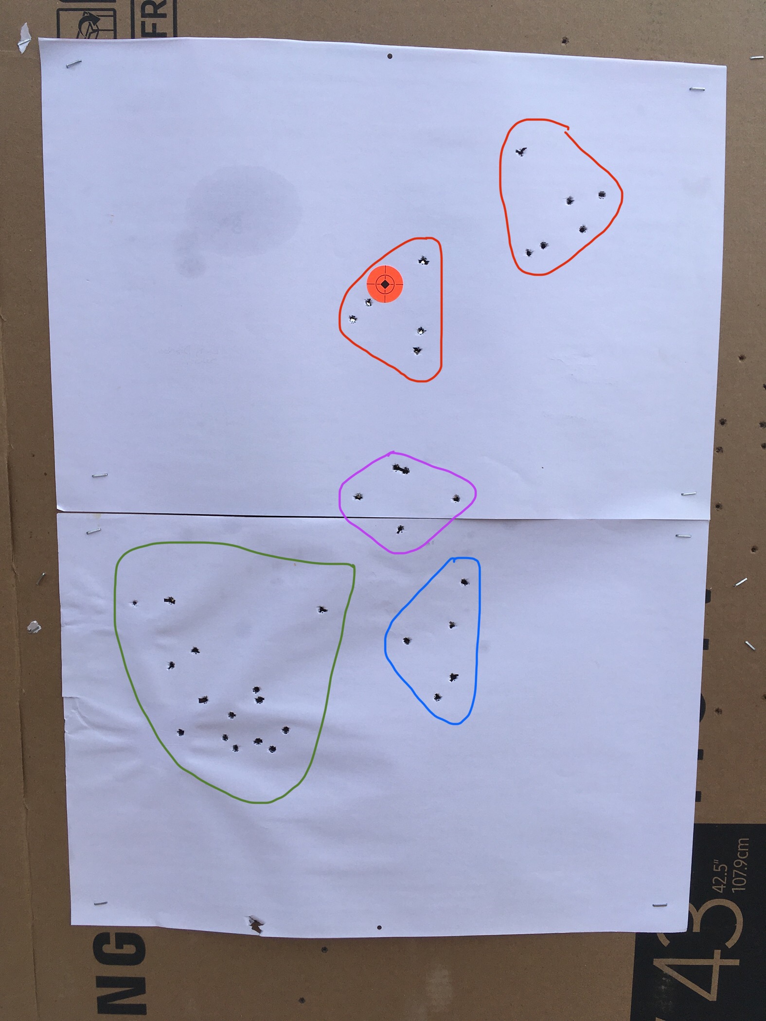

Had the opportunity to shoot half a box of Lapua long range today... ABSOLUTE HAMMER!!!!!!!
200yds 10 round group was sub MOA did not keep the target but the grouping was under 2".
300yds things kinda opend up and I was slightly over 5".
Pretty damn surprised! At the time I built this rifle long range and super long range Lapua ammo was not a thing. Midas and XACT did not shoot as well as CX did. Stopped shooting for a little over 4 years ago.
Waiting on the Eley to come in but I have regained some confidence in this barrel.
SK long range match was shot but I stopped after 10 rounds. Had a 40fps ES in that string. My buddy had roughly the same ES out of his CZ457 but he was crushing the 200yd mark with it. He pushed out to 300 and was able to print with it on an 18x24” target.

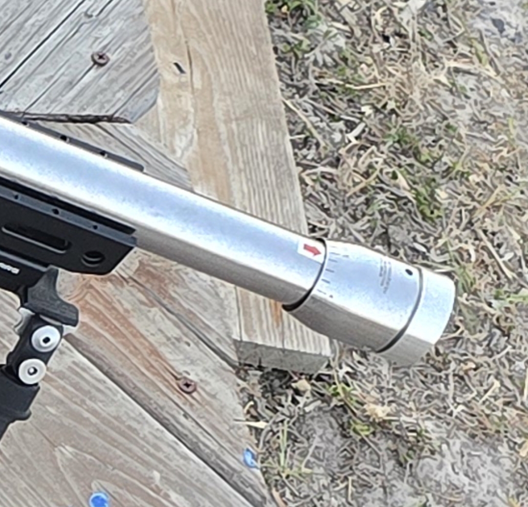

I like tuner because they work. I shoot long range steel. I don't waste my time or ammo shooting 5, 10, 20, or what ever the group count is today. I only shoot groups when tuning. I set up 12" plates for sighters and shoot 4", 3 ", 2" and 1" at 200yds. I shoot Long Gong at 300yds 8", 6" and 4". I also shoot clays at 200yds and 300yds, I hit the clays then shoot the pieces. The OP has not said what type of shooting he does. If the end game is steel, then shoot steel.
The ES of your ammo is what it is. You can't change it. You have to shoot and know what is going to do down range. ES is not going the be your problem, The wing is going the be your problem. The OP said he shot SK Long Range, but stopped after 10 rounds due to ES of 40, but did not shoot it down range. I know ES will give you the vertical spread. I have taken 4" vertical spread at 200 yds down to 1" with a tuner. I done it many, many times.
I know a lot of guys don't like tuners, and troll them ever chance they get. but you can shoot with a tuner or shoot against them in a match.

Tuner is cheap enough to give it a whirl. Worst case Im out a couple hundo, best case I can stop chasing and burning ammo. I was on track to turn my own barrel with a 14 to 14.5 gain twist chambered with a 52D reamer. Lapua LR gave me confidence that this 20" ace barrel can print at distance so a new barrel has been put on hold until I can validate that there is an ammo type that works well consistenly. I could have turned my own tuner but I have no refrence for guidance.

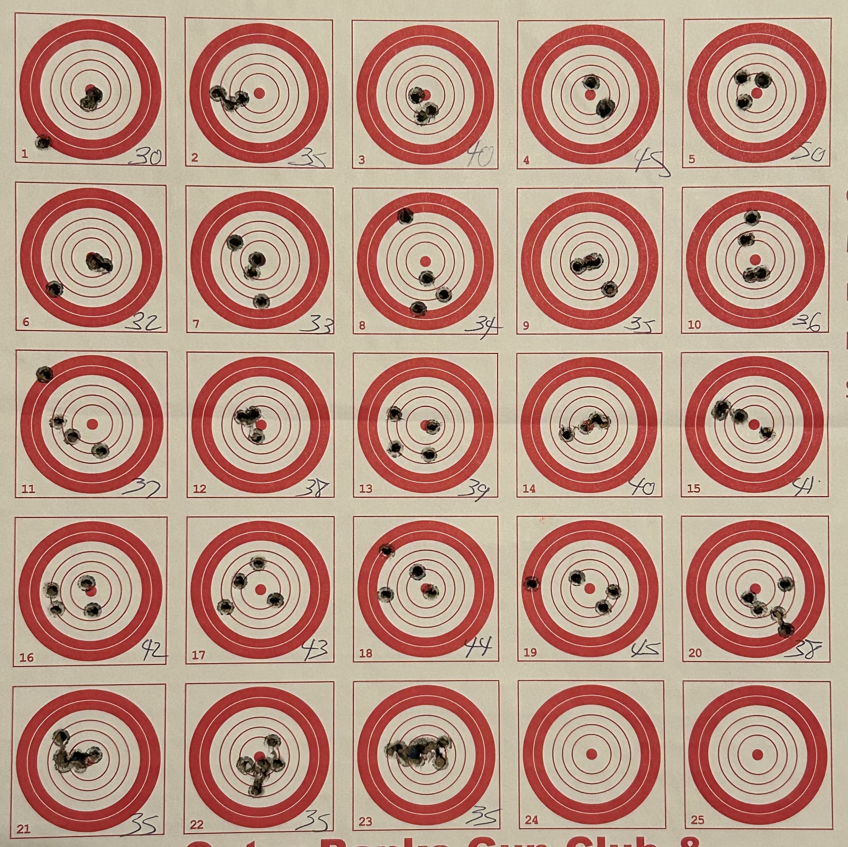

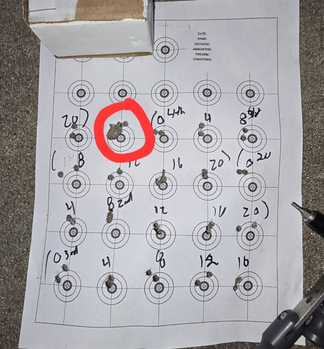

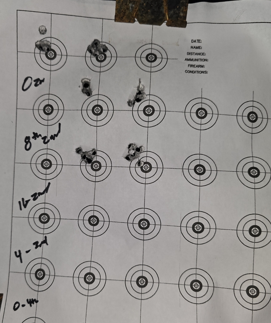

I did a large test awhile back. Shot 6 five shot groups at each setting. Did a total of 2 revs plus no tuner. Used an app to find the X,Y of each shot and input them in excel for a 30rd agg group. Each setting/group was also randomly fired. Calculated the mean radius for each setting. Also ran a P test against each setting. Even picked the “best” and “worst” setting and reshot the test on different day. Concluded they don’t work….. this was on a DI vudoo with a MW barrel using center X. I followed Reloading all day’s protocol, which if I remember right is similar to what applied ballistics did.

I understand but there is literally no way to prove they work to anyone else. I have struggled with them off and on for years. Back a few, Anschutz USA was clearing out some 54-18 actions do the Custom shop started creating 54-18 benchrest repeaters (yeah an oxymoron). I have their #1 rifle and I told Steve B that I didn’t need one. I was seeing some vertical so I bought a Harrels and put it on. Cleaned it up. Some ammo was more affected and as I buy cases, I live with the results. The thing is you can’t prove that you either didn’t lie about the good or that you didn’t fudge the bad. It is something a person has to be interested in and try’s for themselves.
I think most people would agree there is discussion and testing to be done around tuners for reducing group size.
You did not say how far you were shoot, and the size of your groups. And how you concluded they don't work. By only going 2 revs, you left out a lot area for tuning. You did not go far enough. A Harrell tuner has 500 settings 25/ rev, total of 20 revs. A EC V2 tuner has 200 setting 50/rev. total of 4 revs. The Harrells are made to start all the way into the shooter and go out. I have seen the best tune all the way out to 500. The EC V2 starts flush with muzzle and go into the shooter. I have found the best tunes 3 to 4 revs in. with 2 of my guns. My Tikka T1x is 10 off full into the shooter almost 4 revs in.

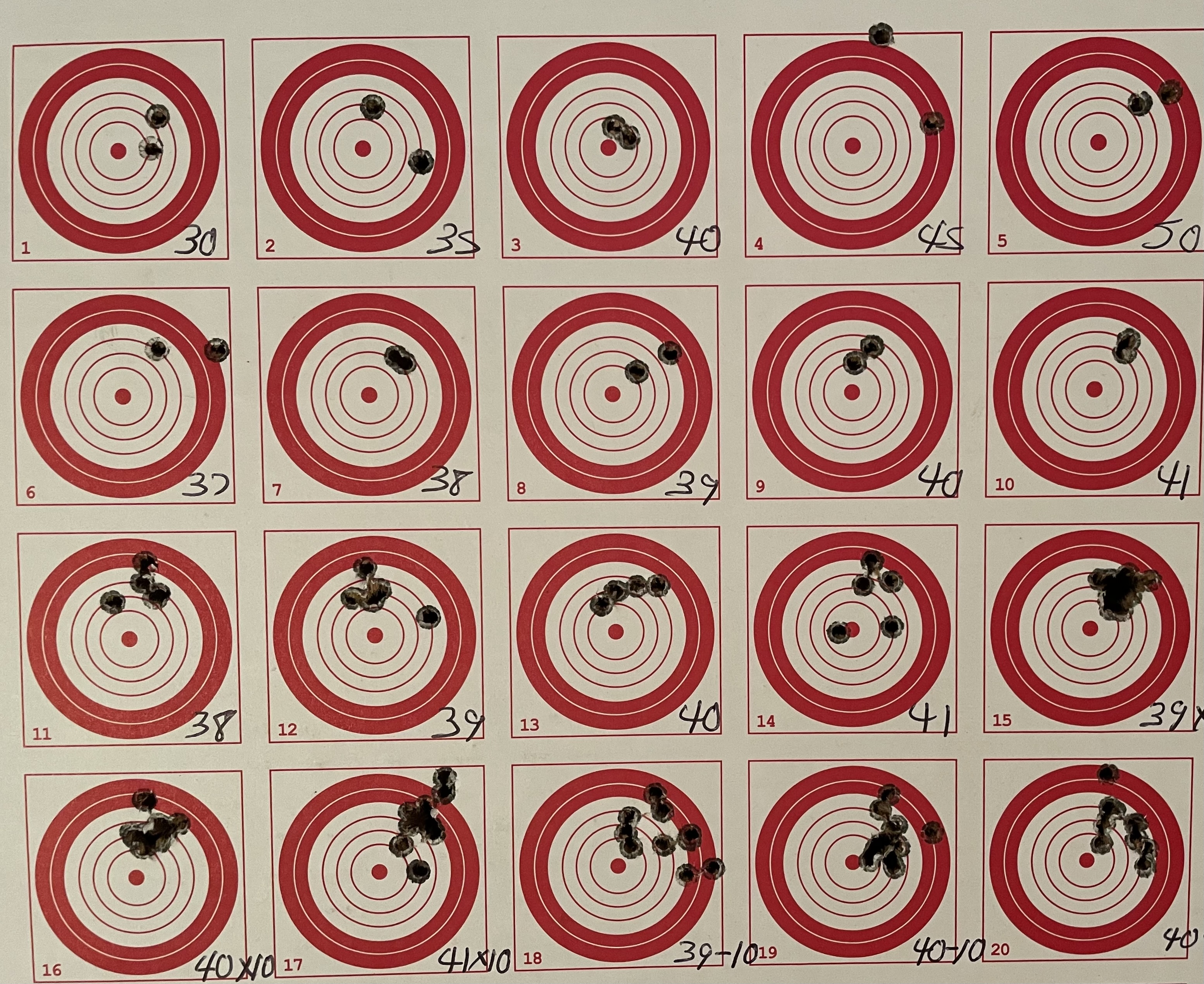

I start tuning a 50yds with 3 shot groups ( any more is a waste of ammo for now ) With the EC V2 tuner a turn 5 marks and repeat all the way in ( with Harrell I go one full rev ( 25 clicks ) You will see the group open and close, you are looking for the best vertical. you may see many in a row that are good. Then you can go back to the best of the best and shoot as many rounds as you like. I shoot long range, I take the best of the best to 200yds ( you need a good wind day ). This is where you can take a 4" vertical and fine tune 1 to 2 marks at a time each way for 10 marks and get a 1" group. You can call BS, but I have done it many times. That is the only test I can tell you. You can fine tune and take a group with vertical a turn it onto a round group.
Ya it is BS. BS of same sample sizes…… which leads people to conclude something which isn’t true.
I used an ECV1 tuner. I think I actually went 2 revs plus a couple settings. I only had 500rds of this particular lot so I was limited to that. Plus I had to save some rounds to retest the best and worst. However I think it’s completely reasonable. I shot at 52 yds on a nearly dead calm day. 100yd you start to see more wind playing a role so I avoided that on the initial test. I shot a couple 15rd groups at 100 with the best and worst setting on my second session. I’d have to find my excel file to remember the agg group size but the average 5 shot group size across all settings was .31”.
At any rate they marketed to show “nodes” that are repeatable and that was not the case in my test or any others that I’ve seen. And someone like you using 3 shot groups to determine an initial setting is quite hilarious given the well fact of high variance in 3 shot group sizes….
What was the difference in the tuner groups and non tuner. If your aggs were 0.31" the tuner must be working, You will not see much vertical at 52 yds and 100yds any way. How much vertical were in your 100yd groups? you can fine tune at 100yds.
As far as the 3 shot groups, it is to find your starting points they work for me. I said you go back and shoot as many rounds as you need to find the best setting, to go to 200yds. My goal is to get to 200yds and fine tune. I don't need to shoot 500 rounds to get there.
Do you shoot long range? If you only shoot 50yds and 100yds I don't know if you need a tuner. Long range is where the tuners work best. Me and some friends started a long range knockdown steel match with targets from 150yds to 400yds. When we pushed past 280yds the wheels fall off, started seeing a lot of vertical. The tuners turned that around.
If anyone is going to shoot past 200yds you are going to need all the help you can get. Ammo is the key to long range shooting. IMO a tuner is next on the list. It also takes a lot of rounds down range. Give yourself time the learn the shoot long range. Get some steel and shoot the hell out of it. And keep pushing the range out. The hits will come.

My aggs have nothing to do with the tuner…. In fact no tuner at all was one of the better “settings.” The hundred yard groups had .9-1.0” vertical if I recall correctly. If the tuner worked I would see a better mean radius and I would be able to repeat it. If a tuner works at 200 it works at 50 and 100…… I shoot out to 600yd sometimes at 36” plates with pretty good success.
If you follow the steps you will see a difference. As far as repeatability, well you know 22s are condition dependent. What works @ 70° may fall apart at 90°. I have not played with the settings at different temps as of yet.
Have had see good results. It's like anything else, you get out of it what you put in it.
Everything shot at 50 yards.
Red circle is 10 rds nothing but barrel. Took the tightest groups and worked the settings.
These are 5 rd groups. Ran out of daylight, stop it there. Never went back to try to fine tune it more than what it is. Work 60+ hours a week and shooting matches when possible doesn't leave me as much testing time as I would like. Most of any free time I get, is watching my little guy play ball.

How to pick a tuner setting:
Dude, those target photos show your tuner isn't doing anything, all of your settings look exactly the same.
If you were to overlay all of your different groups from the top target into one big composite group, you still get one big group in the same location and size as your bare barrel 10 round group.
Edge to edge of your "tightest" 5 round groups are no better than the edge to edge of your worst 2 round groups.
It's a total coin flip where any of those shots at any tuner setting will land within your overall composite aggregate group size.
Reactions: Csafisher
Makes me wonder how you would interpret this target fired at 50y:
I wouldn't, partly because it lacks any sort of context...
However, all of your individual targets when viewed as one big composite show a consistent POI and overall expected random variation in extreme dispersion.
These were torque tests of my barreled action in a chassis. I had initially assembled the rifle at 45 in/lbs, sighted in and fired a match the following day, results were, eh, less than expected. I read up on tuner testing methods and decided to apply some of that methodology to torque/tuning with the action screws. This produced repeatable results and when I ran the ammo out a couple of years later, and switched to a different brand, I figured everything would be different, but it wasn’t. Don’t have the targets, but after the 50y tests I moved to 100 and was equally impressed with the results, so I used the rifle with that same setting the following year with equal results.
this target was fired at a measured 300y with 4 friends present, one of whom fired both my rifle and his own (we simply adjusted our holds so the impacts wouldn’t overlap:
The orange circled groups were me tweaking my zero, the pink me holding a bit low for group size. After squawking how happy I was, a friend came over and fired the blue group with my gun, then switched to his Vudoo for the green group.

From the sample set provided, you can't say with any certainty that your rifle shoots any better or worse at any particular action screw torque setting. All of the rounds fired fall within what can be considered as an expected total dispersion radius. That's not to say that a particular torque setting doesn't shoot better, just that you need a LOT more rounds per setting to be able to discern a difference with any kind of confidence.
This is principle is further demonstrated in your 300 yard target. The Vudoo shot a 15 round group, capturing 3x the amount of data as your 5 round group and as expected caught more of the outliers than your 5 round group, so it can deceive you into thinking the Vudoo is shooting worse than your rifle, but out of that total the Vudoo could have just as likely fired a 5 round group of the tightest shots, or the loosest shots. That is the danger of making assumptions based off small, statistically meaningless data sets.
The repeatable increased dispersion due to your muzzle device is due most likely to muzzle exit gas flow disruptions amongst other things caused by the device, but it is not due to a "harmonic" or "tuning" phenomenon.
The misguided belief that if some devices increase dispersion over that of a bare muzzle, then some devices must decrease dispersion over that of a bare muzzle, is a fallacy that is held onto by proponents of the "tuner" crowd. Large scale testing has repeatedly shown (your small scale anecdotal testing included) that barring some kind of defect, a bare muzzle produces lowest dispersion. You can't improve it, but you sure can make it worse.
