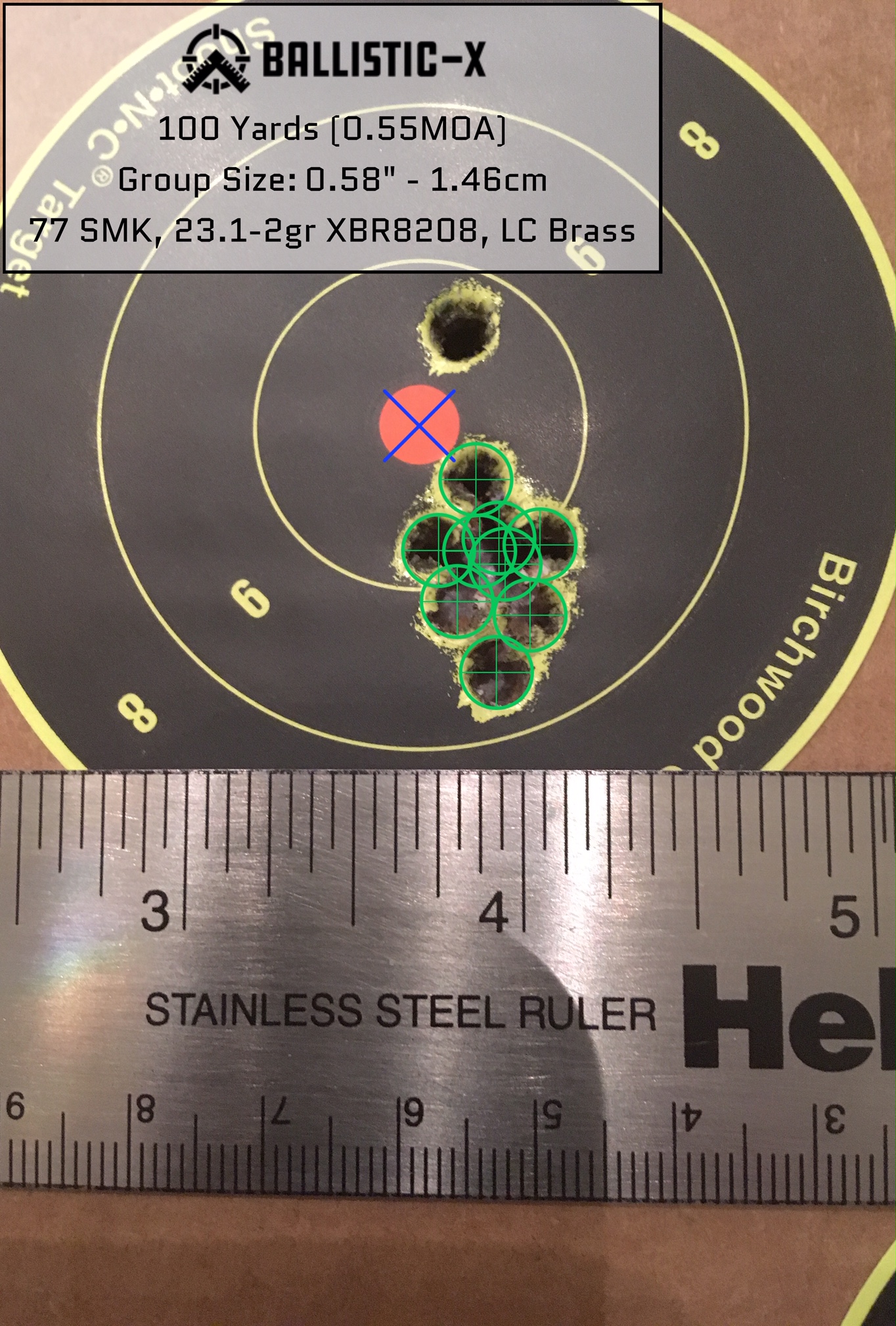

I have two WOA 1 in 7" twist 18" SPR barrels and my go to sub MOA load is:
LC brass
WSR or CCI400
XBR 8208 = 23.1-2gr
77gr SMK at 2.248OAL
Velocity = 2650fps
The flyer was the last round locking back the bolt. :(
