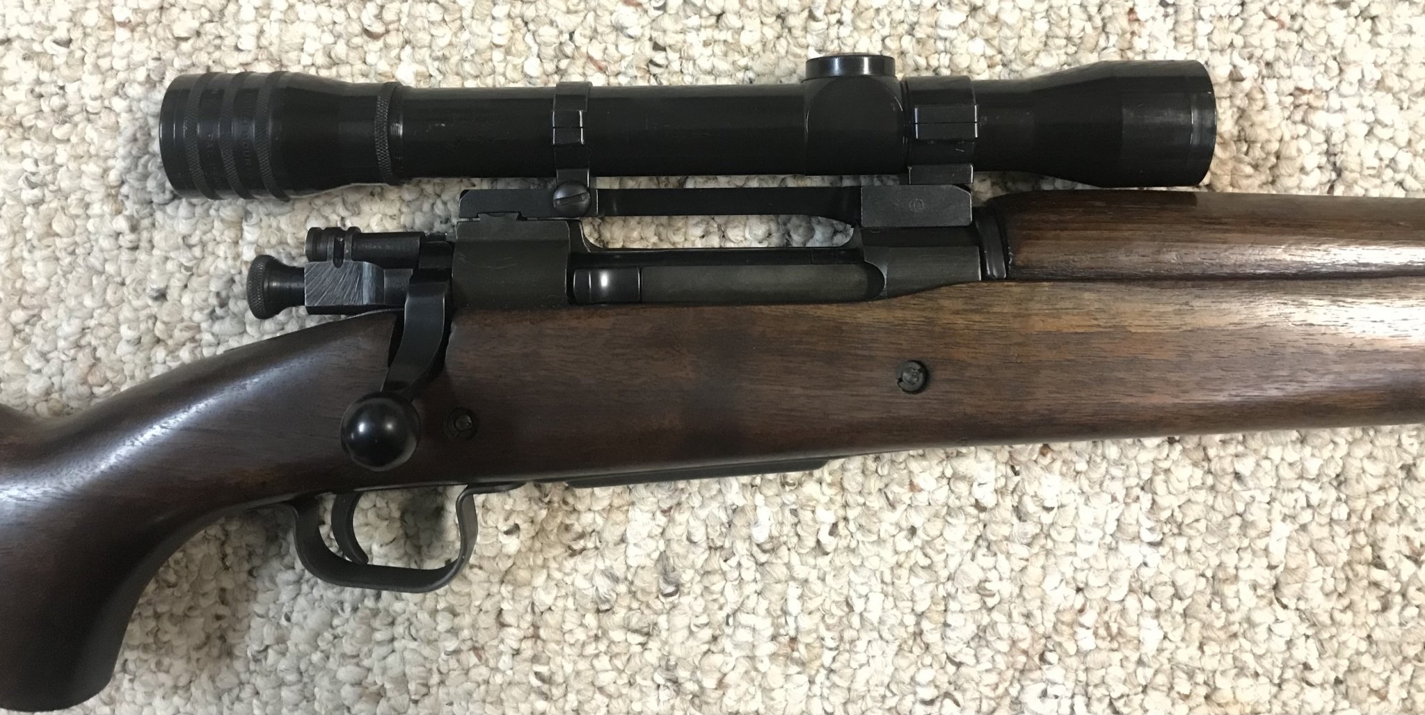

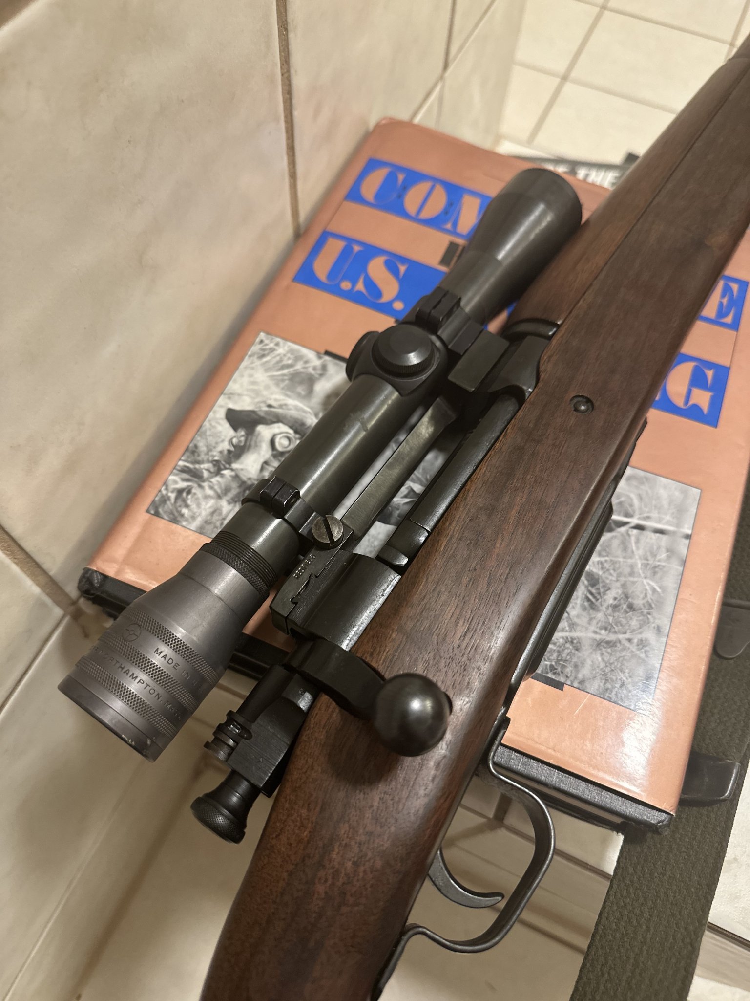

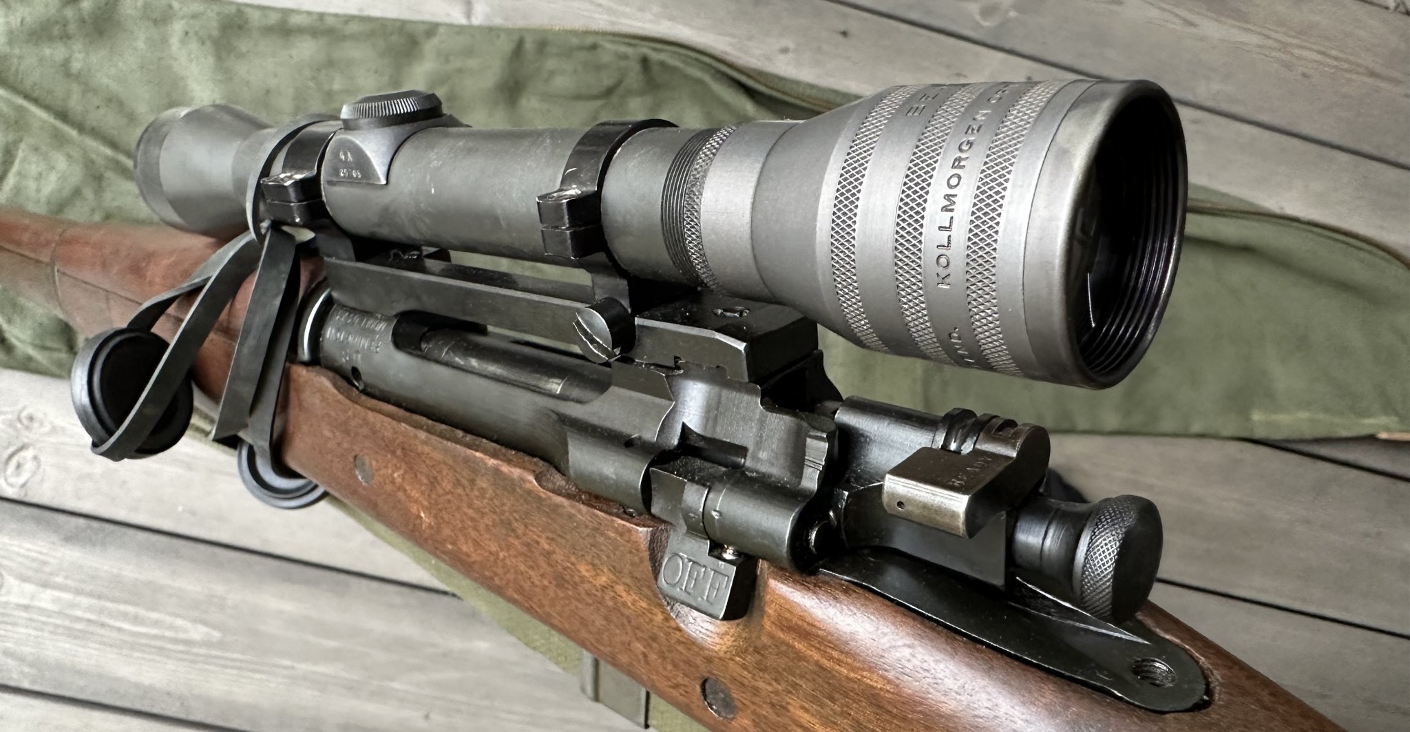

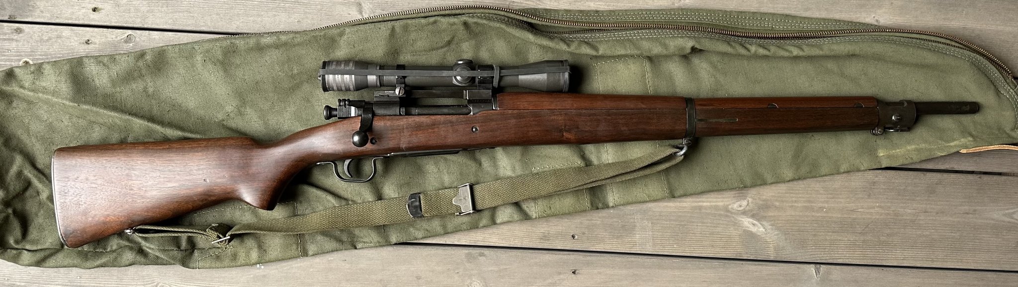

Well, I did make the A4 a bit moore shootable, with 4X scope. Sorry , not a MC1 , but the 26mm rings is a start though. Glas i crystal clear, so when the rain of cats and dogs ends, I will try her on the range. Mabye in weekend, steel plates @700m here we come :)

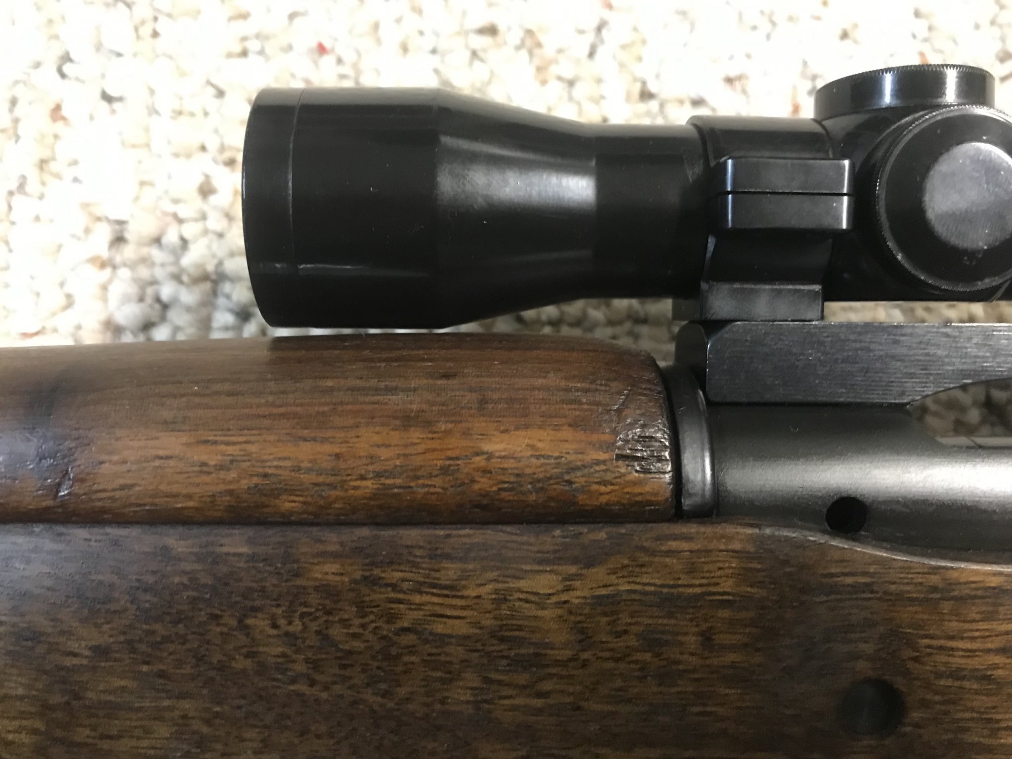

Looks really good, but boy that objective bell comes close to hitting the handguard. I have the same grey anodized 4x Bear Cub scope with a fairly thin post and vertical statia line. (Same reticle as M84 scope). To me that 26mm scope with coated lens is a huge improvement over the M73B1 and M84 scopes. Thanks for the pics.

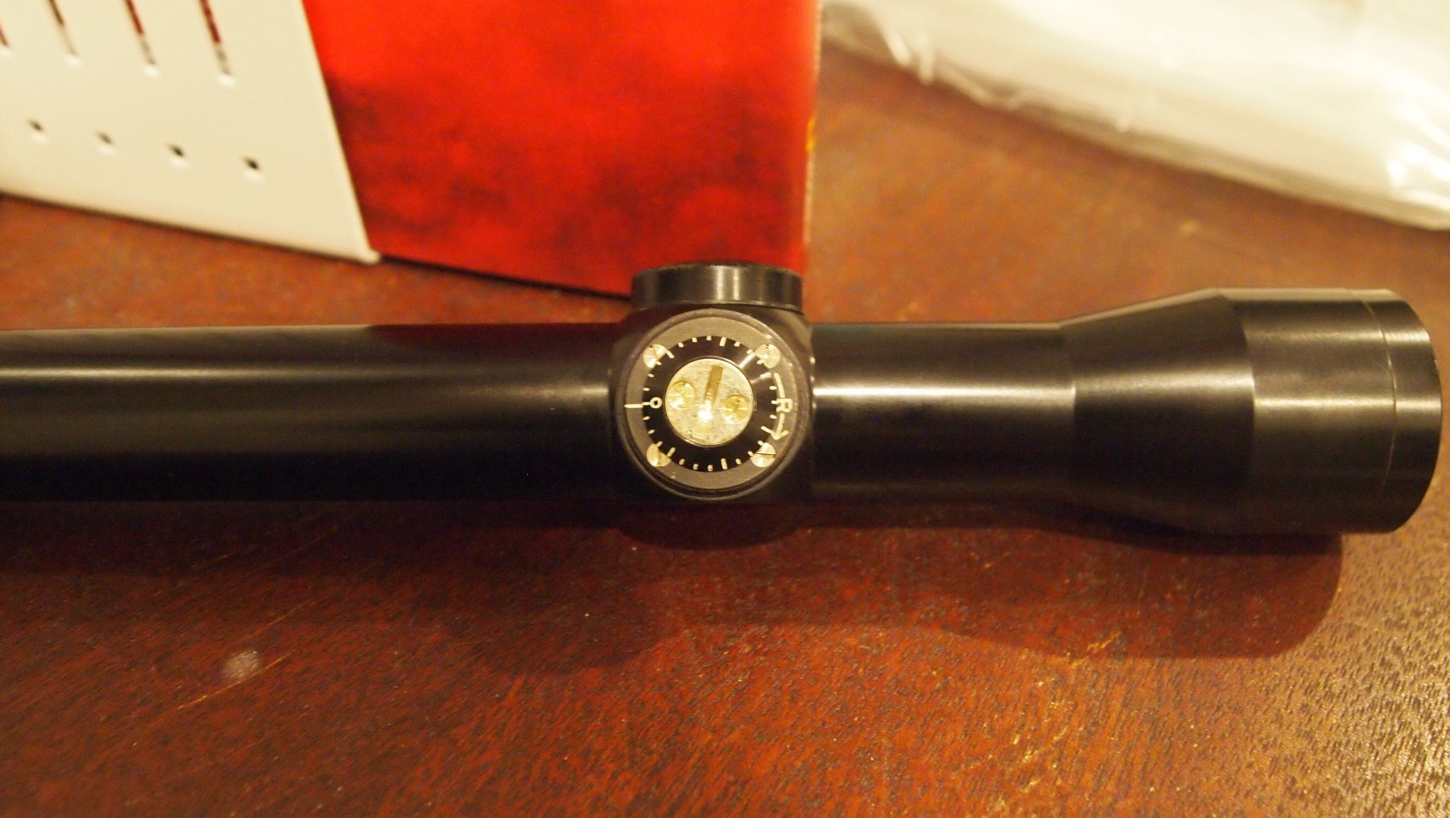

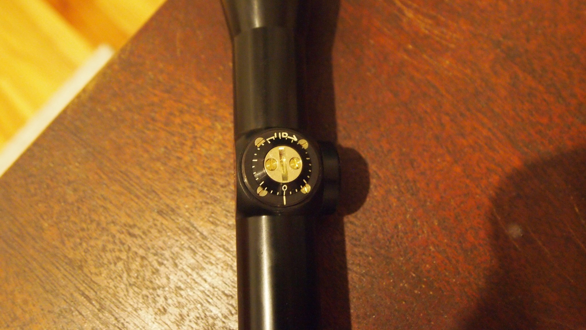

Open up the turret caps and let me see what your adjusters look like.

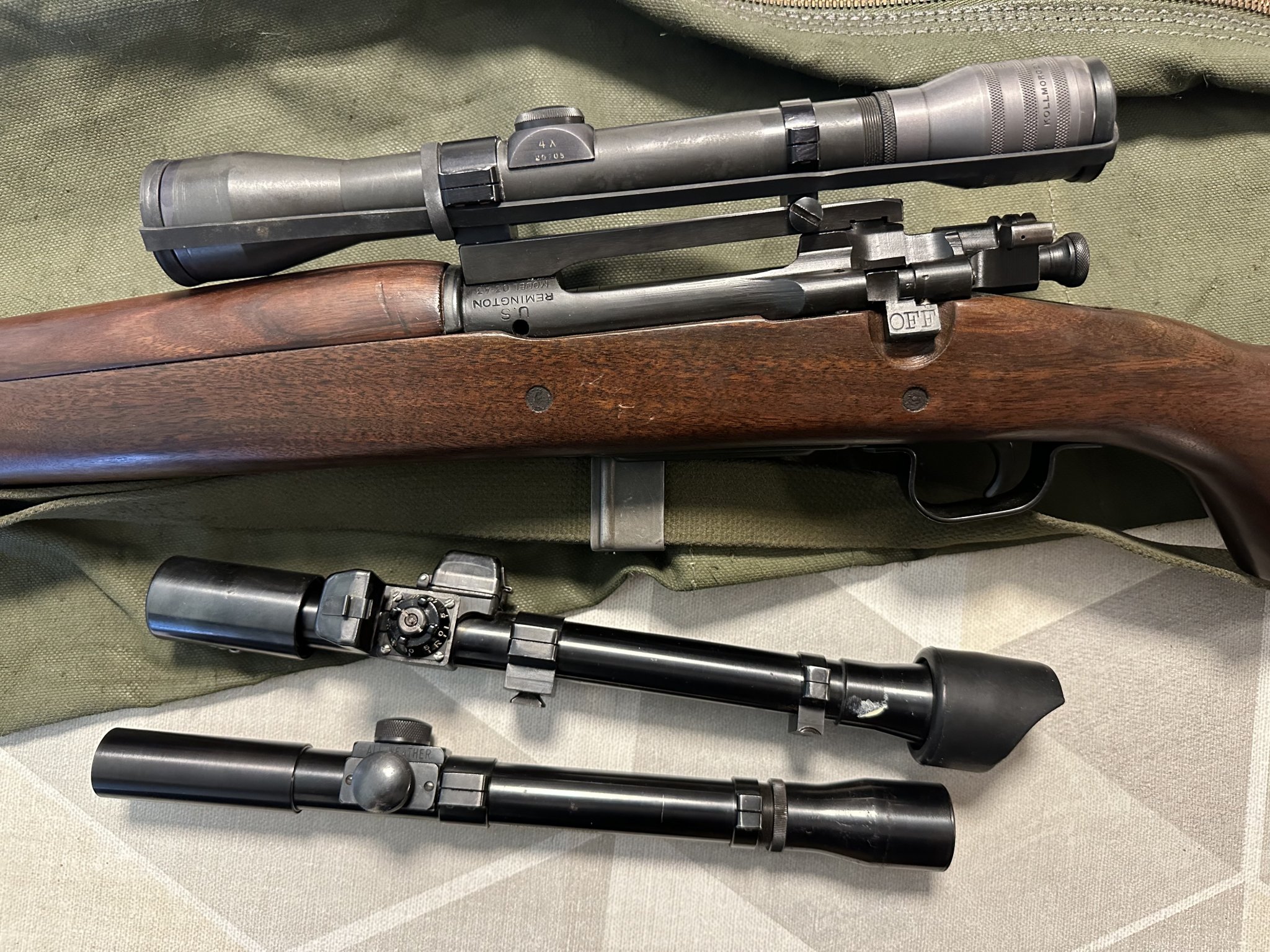

There were two types of mechanicals.
I theorize there was an early one built by the sub periscope engineers from which the MC-1 was derived and a later version when they were getting ready to sell to Redfield and has a simpler design.
Mine I suspect to be early as when you take the caps off it is a fascination of brass beauty. I'm seeing how it's function is adaptable to an MC-1. If I had skills with machine tools I could make an adjustable turret from my minds solution. It wouldn't have the exquisite tactile audible/clicker they were known for but it would be functional.
Yeah I consider those "late" by my theory....
Note the screws on the turrets of the MC-1
My scope
Look at these beautiful engineered adjusters.
If I had skills I'd make a threaded lower cup that would screw onto the threads the caps fit to.
Than I'd make the adjuster top that would use the two screws to mount to the adjuster. Have this fit into the lower cup with an oring to keep out water.
Figure out ranges and than mark the turret as a BDC style scope.

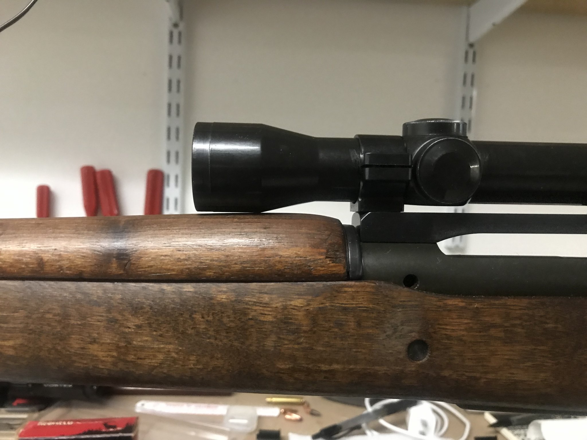

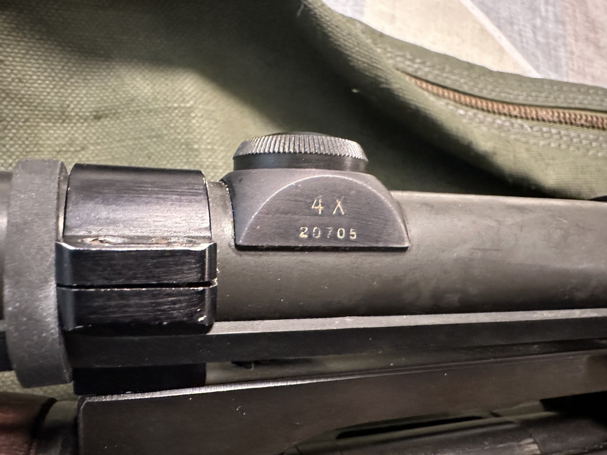

Yes those are the later Bear Cub’s; the civilian version of the MC-1 is the 4X Double. I’ve never shot in the CMP VS matches but the rules do/did allow the Kollmorgen in “MC-1 configuration” and I have my 4X Double set up that way (elevation=windage, windage=elevation).

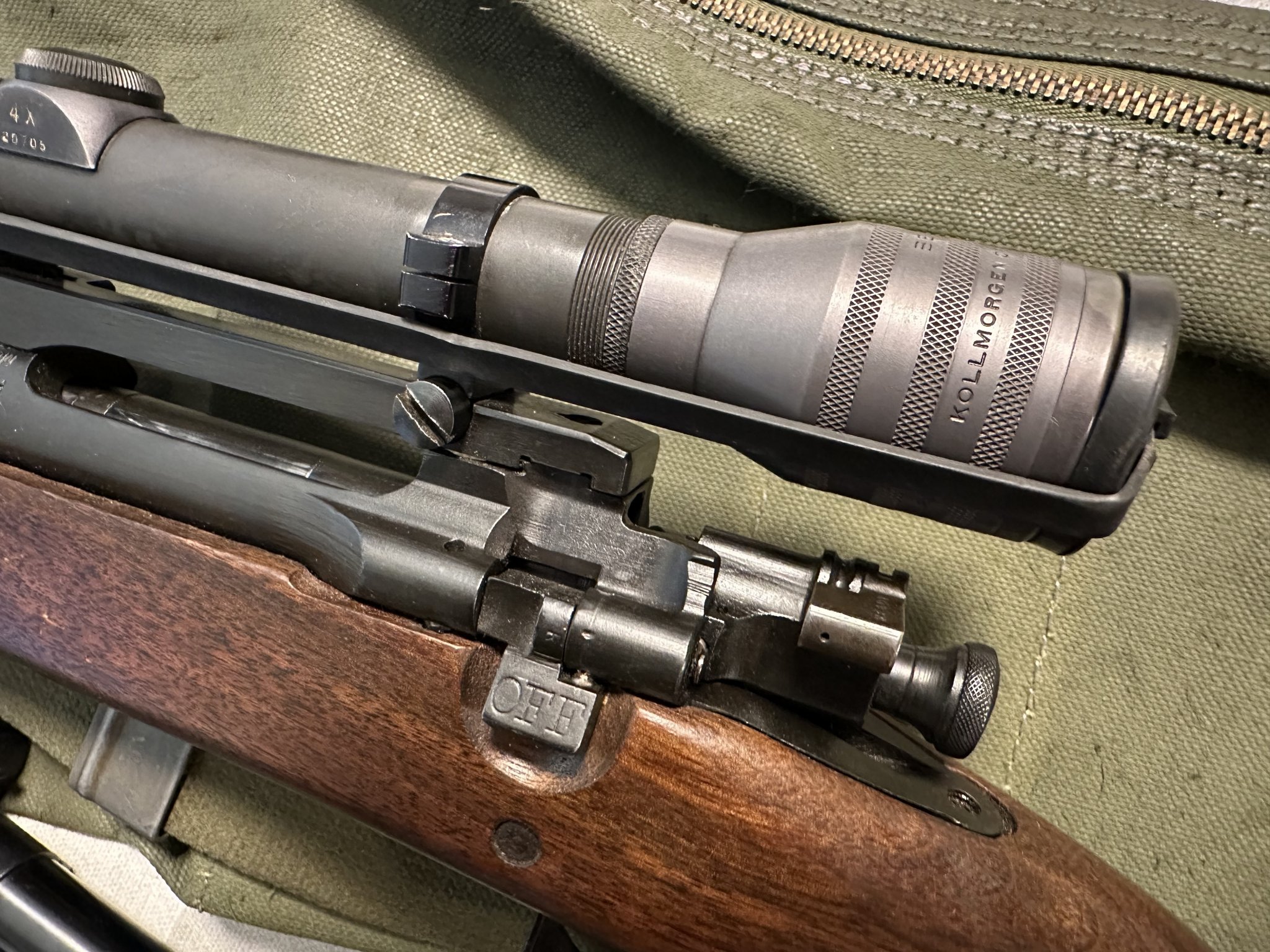

Adding a shim to the front of the Redfield base will give you the necessary clearance using the vintage Redfield 26mm rings.
Without shim:
With shim:

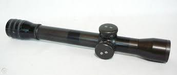

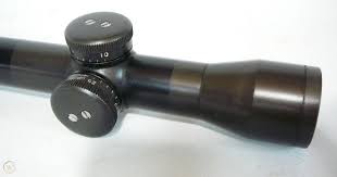

The 4x ?
They made a Kollmorgen with the adjustment knobs forward but they weren’t target knobs and 26mm tube ?
How hard are these to find ?

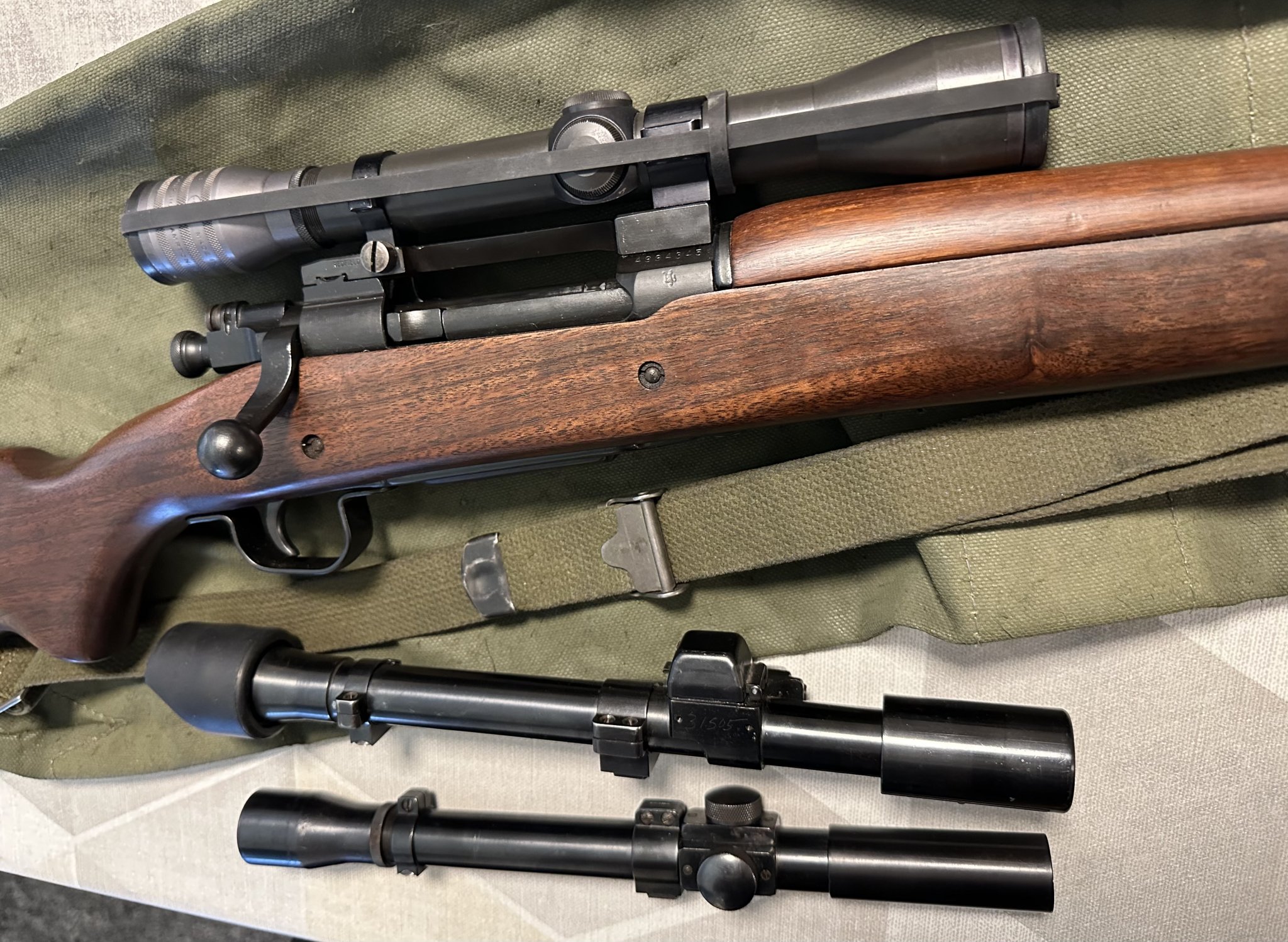

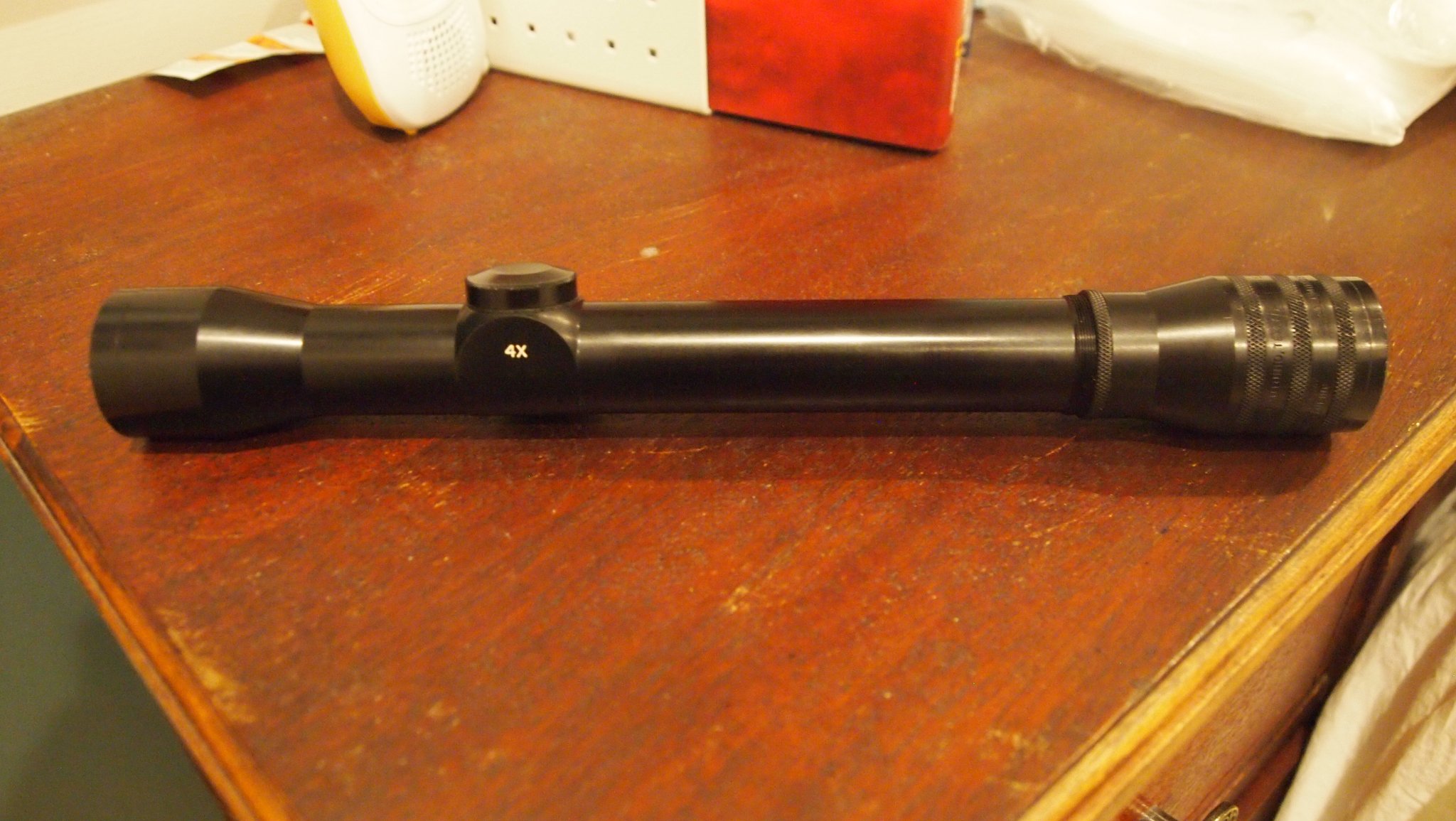

I’ve got that earlier Kollmorgen on my A4-gery in the pics in the thread history and they’re not terribly hard to find as they come up on eBay for between $75-$150 but a lot of times it’s not the reticle you need. The bitch is finding the correct Redfield 26mm rings, although you can use standard Leupold 30mm’s with delrin inserts in a pinch. The Redfield rings come up on eBay occasionally and can be pricy but if you have patience you can find them on the cheap, even NIB, because folks see the 26mm as oddball and not rare.

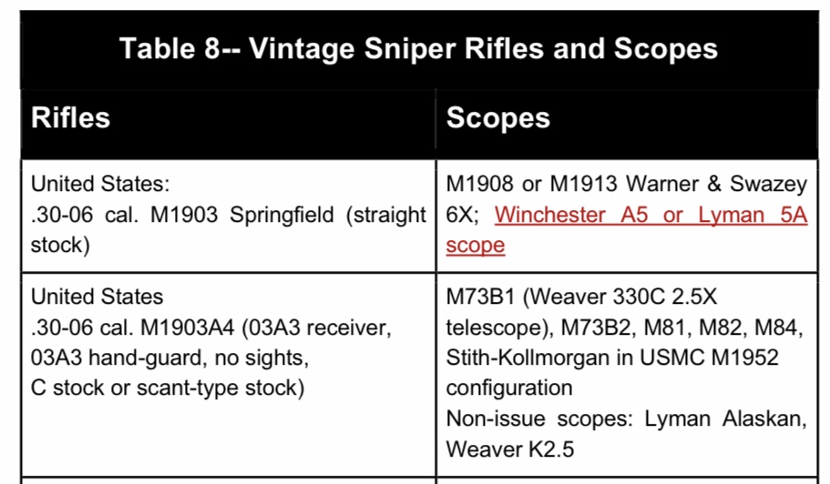

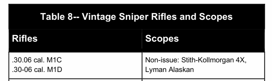

The MC-1 has the adjustments forward and is the .mil version of the 4X Double Bear Cub, which is also a 26mm tube. At some point Kollmorgen moved the adjustments back towards the middle of the tube, like what the OP has in his pics, and they’re still badged as “4X”. The CMP states the scope needs to be a “Stith-Kollmorgan” (sic) in the USMC 1952 config, which I’ve always took to mean having the scope set up with the adjustments flipped as the MC-1 was set up. Additionally I don’t think the later Kollmorgens were badged with Stith Mounts on the eyepiece, so that may be a CMP consideration, but probably not an issue given some of the completely incorrect optics they allow like the Weaver K2.5 on the A4…
