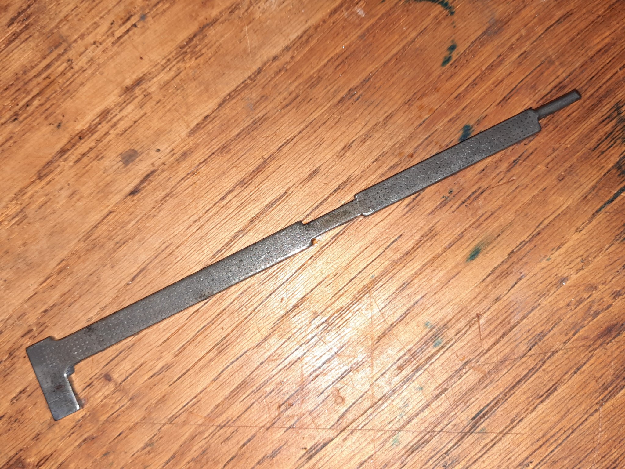

While you look for a FP. would it be possible to make the FP short stroke with an O-ring or two or remove the extractor
and fire on a spent case or snap cap? You could also swap out your FP spring for something much lighter, that' the first
thing I would try.
I just took apart my 54 ( SN177599X ) and it's FP is different than yours so looking for a duplicate, may be like chasing your tail.
I would find a simple way to limit your FP movement and make a couple of the above changes. My bolt comes apart in 90
seconds so I'm guessing yours is similar.
Just a couple idea's for you to dismiss....

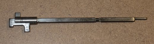

Folks, I will not belabor my purpose: I am seeking a firing pin for a model 54 Anschutz .22 target rifle. It does not have to be functional as I intend to use it for dry fire practice, and I can grind the tip back to protect the breech surface.
The pin I seek is 3.75 mm thick at it's end opposite where it hits the cartridge. Overall is as shown in the attached image.

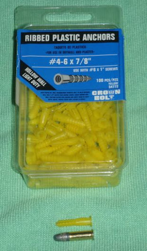

Not exactly what your looking for but they fit and the rim size is right so it will extract by cycling the action.
That is the wrong pin. That is for the current bolt. Following Evellio's assertion, I have satisfied myself he is right, the pin does not touch the barrel end. Damn close, but no touch!
I like the idea of the screw anchors. Cheaper and easier than the snap caps. The idea of chasing them around my basement leaves me a little weak though.

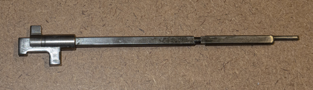

I would have to see what the FP is repeatedly hammering inside of the bolt. The breach area isn't the only
place that may take damage. Since it's not hitting the breach, something else must be absorbing the energy of the
spring / FP combination.
I just pasted this from the Nordic Marksman FP link from above:
Note: Firing pin to be adjusted in length by qualified gunsmith.
It looks like they cut the nose short to preserve the breach but that doesn't mean that dry firing is now safe.
Using that pin as an example, I would not want the taper at the front of the FP to be hammering into the inside of my bolt.
I know, yours is different but I would look what stops it's forward motion. My 54 FP is different than both of them.
