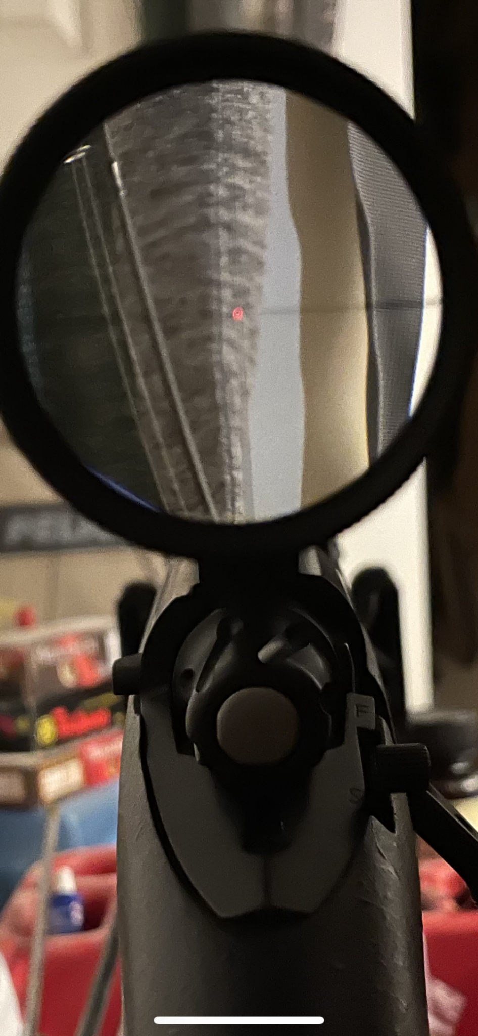

If my scope says 1cm @ 1000m how much (in decimal inches) is that at 100yds? .36"? Dang Leupold scope I bought is in CM not MOA uggg!
Yes you lucked out and got a mil scope.
1 mil = 1 yard (36”) @ 1000 yards
.1 mil = 1/10 yard (3.6”) @ 1000 yards
.1 mil = .36” @ 100yards
Also works same in meters
1 mil = 1 meter @ 1000 meters and so on.
Well then use the numbers above but why did you buy a scope with only a duplex reticle?
Cause I was in a hurry out of state on a hunt and didn’t notice it. Had to have a scope after mine was torn up on the plane. Gun was beat up too. Wound up using the guides gun…It’s a Leupold part #175834. 3-15X56 super bright but limited use of the elevation knob. Took it out of the box today and stuck it on a gun and noticed it was mil and I’m like oh crap. It on a hunting gun 16” bbl 6.5cm (Dont laugh) I’ll never shoot over 3-400 yds at the most. Just hoping I can make it work for that. Only has 57” or vertical adjustment if I use .36” per click.

Well got to work with it then. As mentioned it’s .36” at 100 so easy way is .3 mils is about an inch for zeroing. Once zeroed just use a good program and dial on the mils it says.
That’s an awesome scope for hunting. Perfect for your application.
Just remember each .1mil adjustment will equal
.36” at 100 yard
That is if you don’t care to learn any more about mils than that.

I can get it on paper at 25 just by looking down the barrel and moving the scope to get close move it out to 100 that’s not a problem I just don’t want to waste a bunch of ammunition even if they are hand loads they still cost money and time to load. I’ll make a chart in 50yd increments stick in in the cheek bag. I just wanted to get close and know that what a click is. Isn’t my first rodeo but it is my first Mil adjustable scope with a non-mil reticle. Sorry to give you a headache I was just having trouble with the math.

Yeah that’s pretty muchly what it’s gonna be a short range deer pig hunting gun nothing fancy I am probably a little overkill on the scope but I would rather have too much scope than not enough. Appreciate everybody giving me some input. Sometimes when you make a mistake and purchase something then you can’t return it you just have to work with it and that’s where I’m at on this.

I do not have a sled don’t want one sandbags are all I’ve ever used.

I believe that’s the reply I was looking for right there. I’ve come to the realization after reading all of the replies three clicks is going to be roughly an inch at 100yds. That should get me on paper without wasting a lot of ammunition after looking down the barrel and then looking to see where the crosshairs are without moving the gun. After I get it sighted in at 100yds I’ll move the 200 300 400 and 500yd targets and make a chart and we can put this thread to bed LOL!!! Again thank you for everybody for replying I was just trying to save a little ammunition and a little time trying to figure out what each click is at 100 yards.

I’ve got a Magneatospeed and I’ll worry about numbers after I get it sighted In. This is not going to be a long range weapon it’s gonna be about 100 to 300 yard deer rifle at the farthest probably 500 on a rare occasion I’ve already got all the stuff I don’t wanna start all over I’m just gonna work with what I have Albeit not optimum set up it’ll put meat in the freezer.
The scope doesn’t have marks on the reticle it only has one crosshair so your point is moot.
I was referring to the marks on the adjustment dials,
(Which I thought would obvious since the reticle we were working with was posted).
Now if you want to get all OCD about what to call the various marking schemes on a wide array of old and new European and american scopes many times where there is not even numbers just simply lines or dots, enjoy yourself, but marks works pretty good as a descriptor.
Once zeroed at 100 yards anything you shoot at 200-300 yd with that reticle can just hold over. Hell, I held over approx 20” with a simple duplex reticle at 515 yd on an elk and killed it. You’ll be fine.
