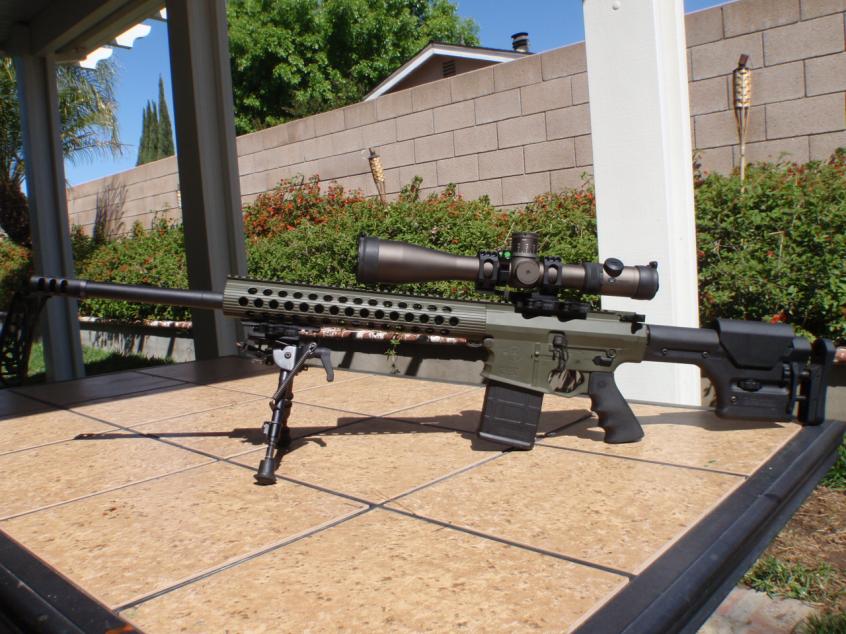

Here is a picture of my rifle with the new ADM 20 MOA rail installed. I just took this setup to the range and am very happy with the repeatability of the scope mount. The Razor has just a tad over 39 mils of adjustment!! Its rated at 36, so the extra was just the icing on the cake. With the 20 mao of cant, I have plenty of adjustment left.

What about the bolt and carrier? Were they both from SI as well? How long did it take for Kreiger to cut the barrel? I've been thinking about either a 260 or 6.5 Creedmor build, I'm not sure which yet.
I bought a chrome DPMS bolt carrier and the JP enhanced bolt. I waited approx. 4 months for Krieger to get me that barrel. My brother didnt want to wait and noticed that they had the M110 barrel in stock which is pretty stout as well. He waited approx 4 weeks for that process. JP sent the bolt to Kreiger for them to marry the two together.
By the way, now that the scope has been zeroed at 100yards, there is approx. 24 mils of elevation to go up!! Holy smokes! Looks like a 20 moa probably wasnt necessary but having it dont hurt. Actually, the 20 moa cant helped in one other way. With the scope canted, the back of the scope clears my charging handle a little bit more.
