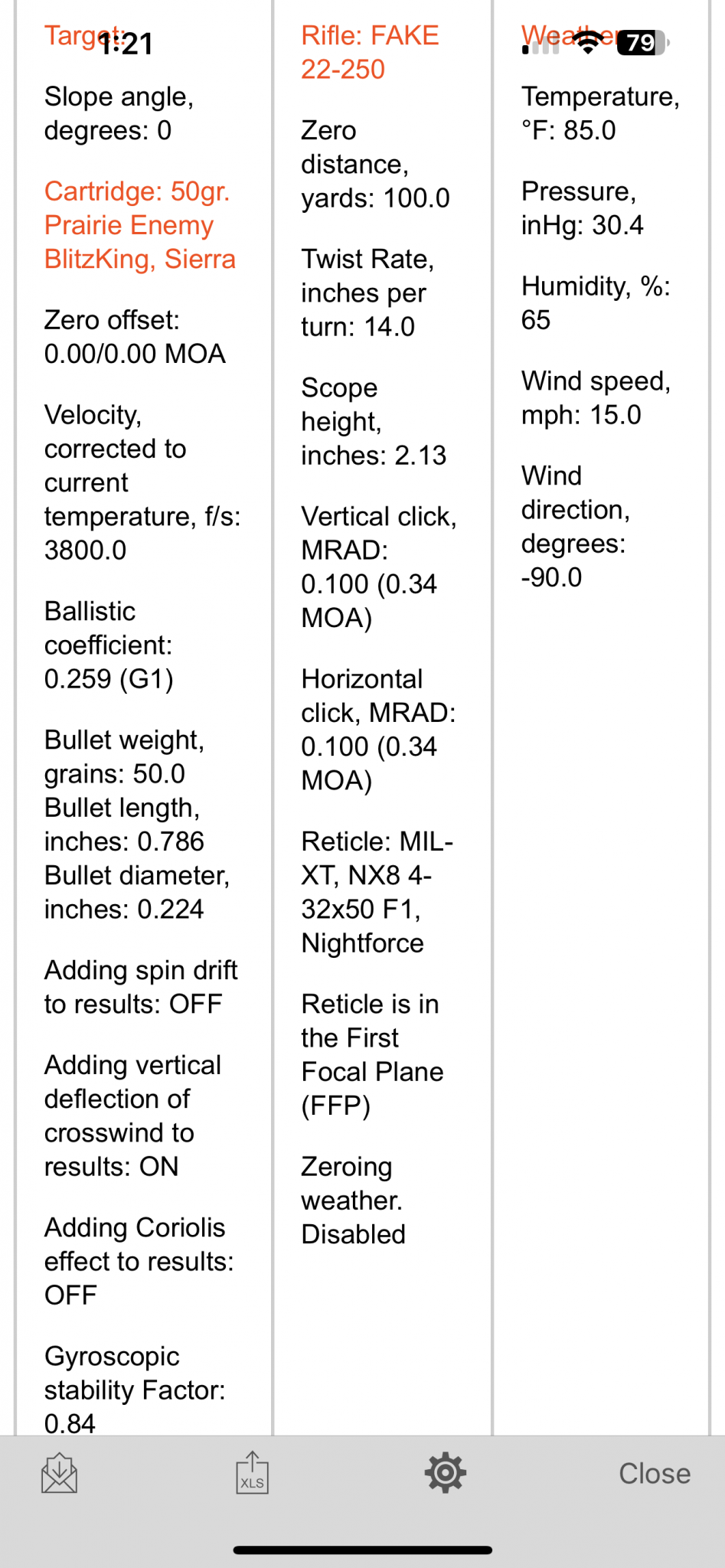

And unless I’m doing something wrong in Strelok, it appears the factory 40gr vmax Superperformance 204 cartridge Hornady offers exceeds or equals, say, the Sierra Prairie Enemy Blitzking 50gr (.259 G1) in most respects.
The Sierra 53gr HP Match has a .224 G1 (I don’t have that bullet in my Strelok).
The 204 40gr vmax has the same or better drop numbers, better wind drift across the board, and at 200-300yds about 100ft/lbs less energy (400yds+ its pretty equal). The 22-250 wins the energy battle at 100yds.
Another caveat is that I don’t have chrono’d weather velocity numbers. Just what’s on the box.
Again, I didn’t compare the exact 53gr bullet to 204 40gr vmax, but it’s worth running the numbers.
22-250 50gr Sierra Prairie Enemy Blitzking​
204 Hornady 40gr Vmax Superperformance​
