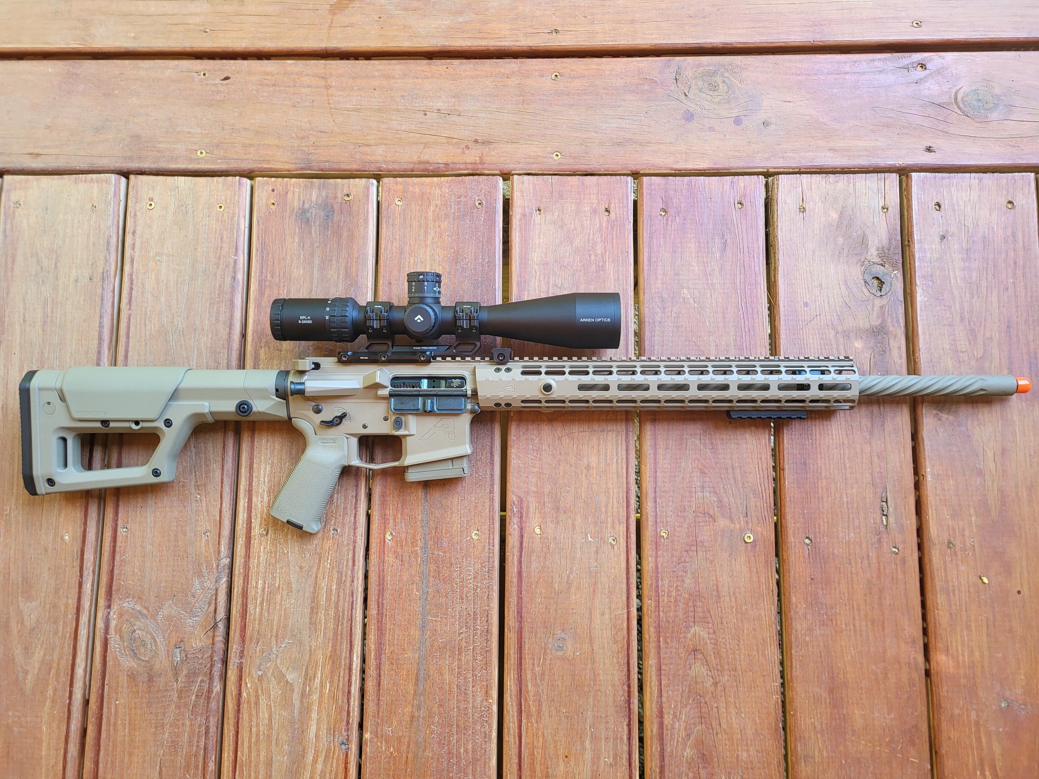

I just purchased an AR 15 X caliber 204 Ruger 3R barrel with the Rubber city bolt and so far it's been shooting about .5 MOA
to .75 MOA so far.. I haven't got too far with load development as I don't get alot of time. Had it cerakoted and fluted by them and I'm happy so far.. I think with load development she will be the cats meow... We'll see..
