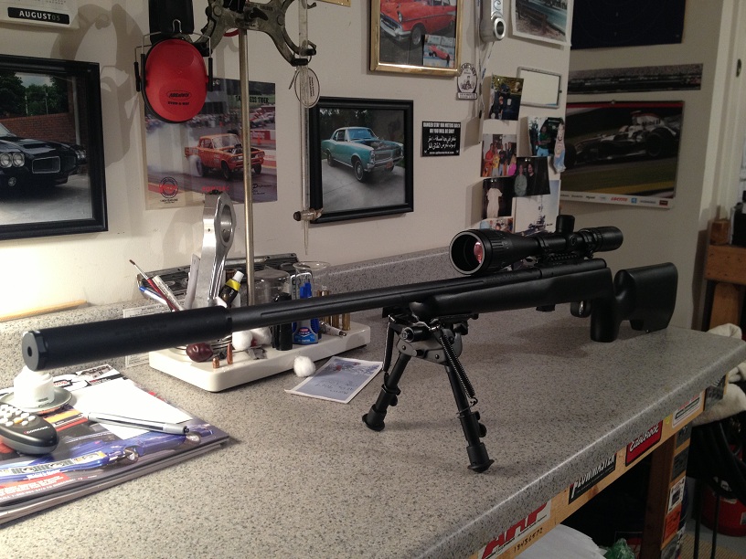

Spent some time w/ the Magnetospeed. Thought some may be interested in the data. Rifle is a Savage TRR-SR which is basically a MKII action.

Barrel appears to be 22". It's a Savage TRR-SR w/ stock rail removed and 20 MOA base. I shimmed base to get another 10 and have it zeroed at 300 yards right now.
