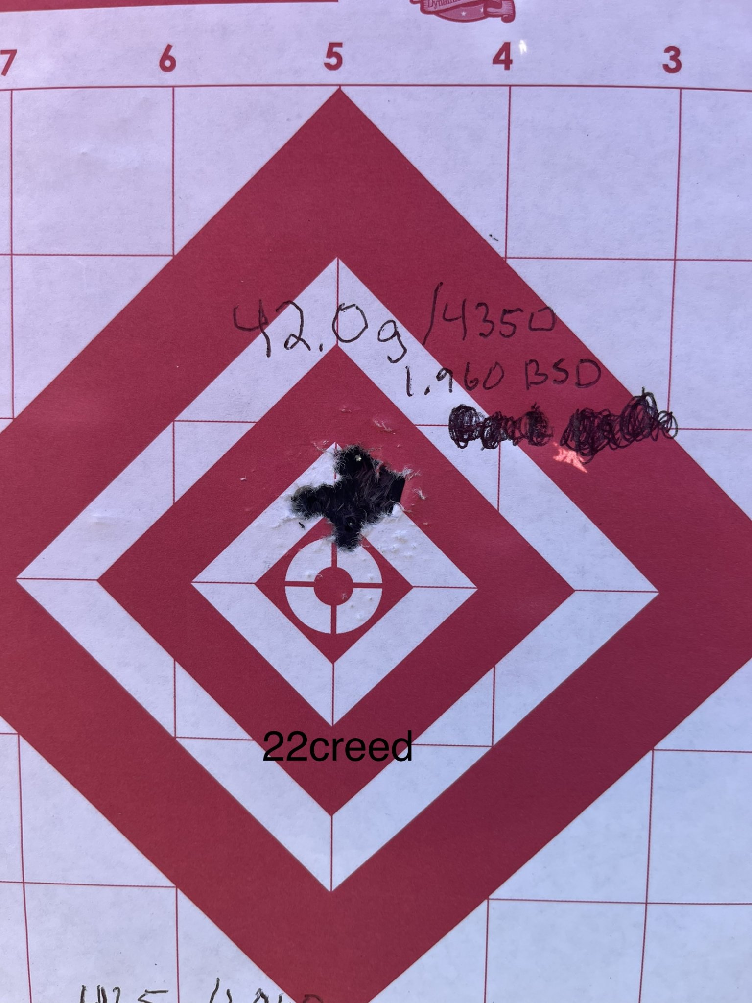

GT looks interesting. Currently been running a 16” 1-8t 22creed sending 60g Bergers varmits at 3360fps. Not pushing them real hard but it’s pretty accurate at that node.
