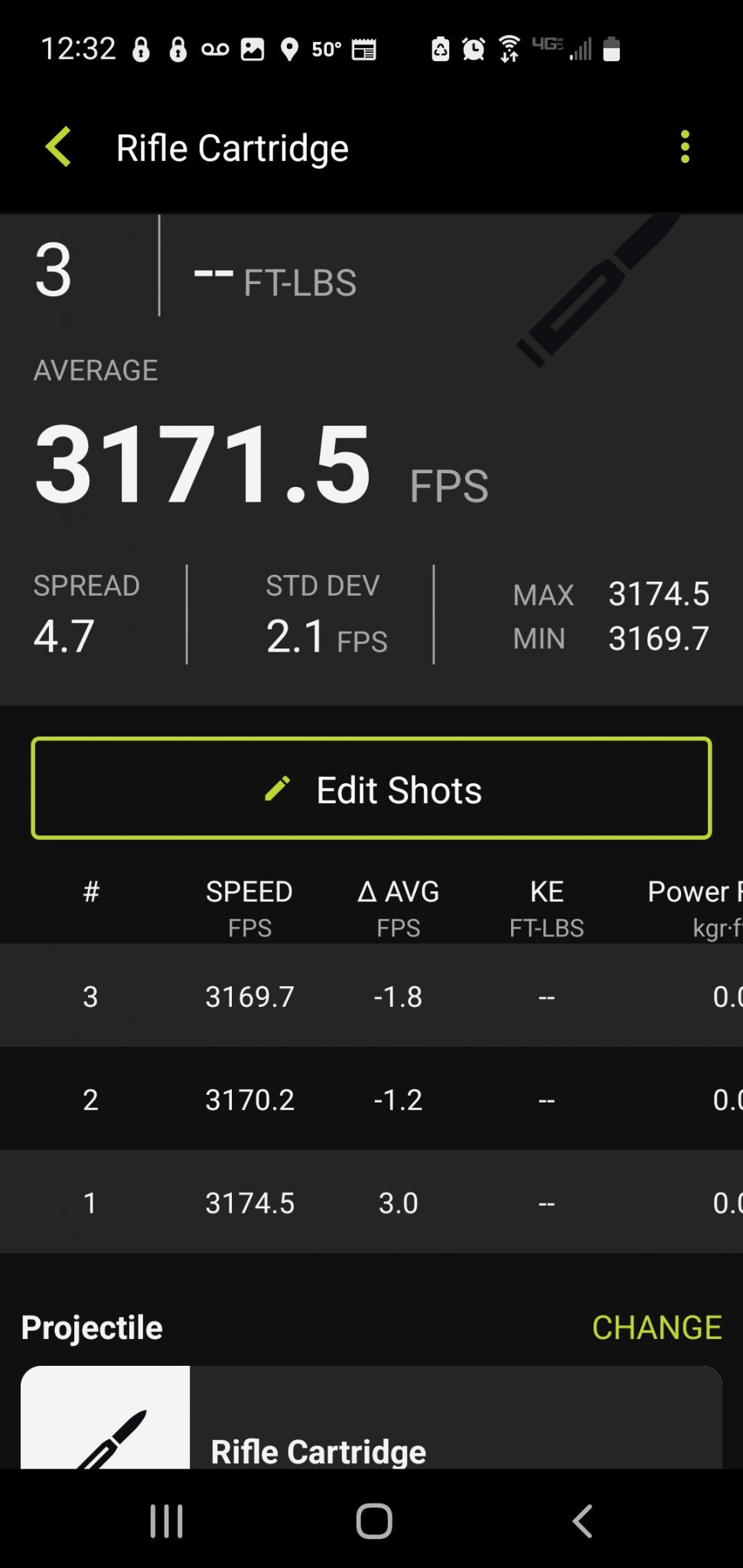

With a 26” barrel I was able to get them to 3150ish. But I can’t get a decent ES or group size. I think it’s because when the bolt goes forward the inertia moves them about .010. I have a crimp die so maybe that will help?

I also blew up 2 ALCO 90 grain bullets at 3070fps. 3030 fps didn’t have any problems and produced a 3/4” group.

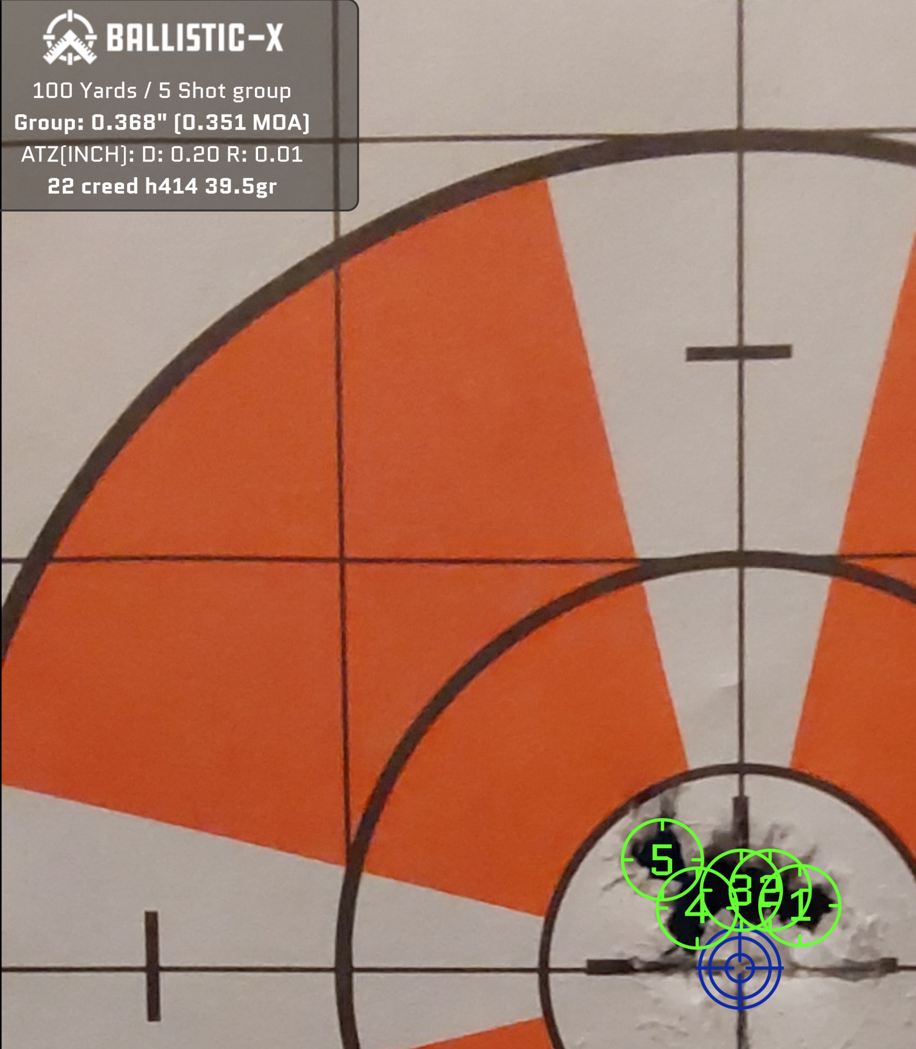

Ruger American with PVA 7T 26" barrel
80 ELDM
Peterson LRP brass
Fed match primer
H414 39.5
3250 estimate from quickload
3200 actual using garmin chrono

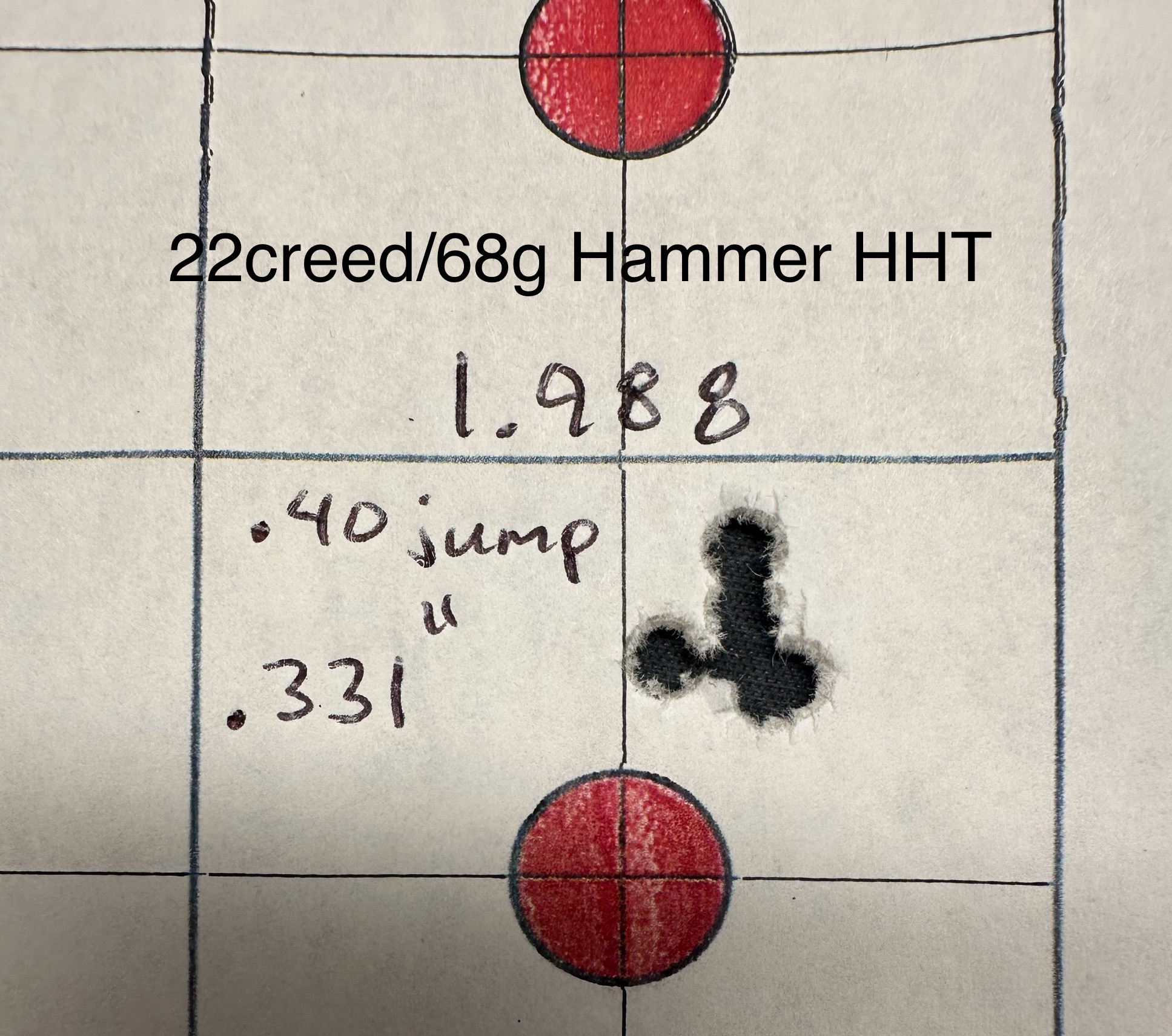

What you’re talking about is my setup. I have two loads for my 16” 22creed. Mine is a 1-8t X-Caliber.
60g Berger FBV @3430
68g Hammer HHT’s @3450 (leaning on it)

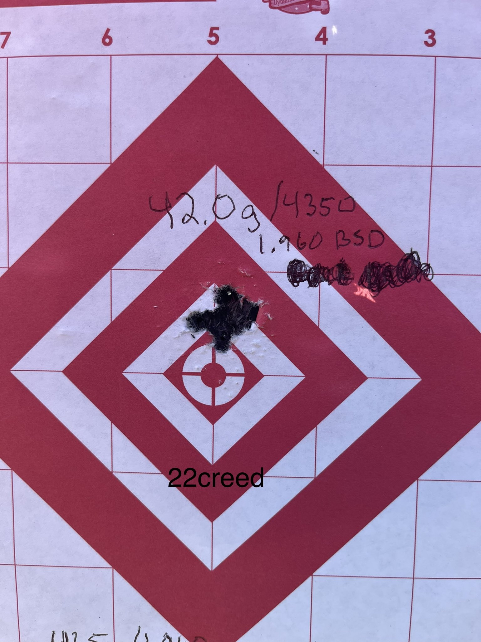

I thought I'd try a 22creed, seems like a neat rd. Nuke 2.0 action, 26" varm criterion 7tw barrel nut, Peterson srp 22creed brass, cci450, h4831sc and 95smk. Started load testing today with 42.4gr set as max, with plans to go up if primers looked alright. Bullets are set .020 off rifling as a generic starting point. Anywho, 5 powder weights/3rds per weight just to see what it will do. Ground was saturated and bright sun/60° with 4-5mph wind= some mirage and soup to deal with.
Everything was going fine until first rd of the 4th powder charge. Bullet didn't impact as predicted. As I scanned target in that area, I then saw a large rip 4" low and 3-4"left of aiming point. I shot the next 2 rds and they landed as predicted. Shot the 5th charge weight and those rds performed as expected.
Has anyone saw or heard issues with 95smk? I generally assume keyholes are too slow fps/too slow twist. I had no issue at slower/lower powder charges. Barrel was allowed to cool to ambient before string. Got any ideas?

I'd read through the 20pages of 22creed loads and seemed that guys that had 6.5tw barrels seemed to have issues with bullet blow ups and as barrel wore seemed more frequent. It just seemed weird that I had a keyhole at that speed. I'd have thought at lower charges, ok, but those holes are perfectly rd.
30rds on barrel, only had 42.4 loaded as max, didn't want to trash brass or pull down if I hit pressure. That was 42.0 and ave 3060fps. The start load was 2990. All bullet holes were rd, except the first shot of 42.0gr(3065fps). It about had to be a bullet issue. Everything was stable above and below it.
Yep, I've saw guys drive them a fair amount faster. The bullet blowups I've saw, no part of the bullet got past 35yds, much less to 100yds. Keyholes on target were stability issue or baffle strikes, I thought. I would think if I'm on edge of stability at 3060 or 3140, than the slower loads would have failed miserably. And if I was blowing up a bullet at 3062fps, then every bullet shot today(3110ave, 3142ave, and 3172 ave) would have blew up. Just checked actual twist in barrel with a tight patch, right at 7tw or maybe a smidge faster.
Running the numbers in berger stability Calc, not sure how a 95smk can be run without blow up or stability issue. My load is 1.35 and 1.34. To get to magical 1.5, it needs 3225fps and a 6.5tw which is spinning bullets at 358k rpm. It's does shoot the 85.5bergers really well, only downside is this chamber is perfect for 95smk. With the bergers, to get within .060 of rifling, the bearing surface area is only in case nk about .130". I don't like having less than bullet dia of bearing surface in nk, but to get close to that I'd be jumping .140". For some reason, the berger loads will show first rd being 40+fps faster than the rest of the string. Any other load or rifle doesn't do that, so has to be something about this load. 1 example, but every 85.5 load does this.
