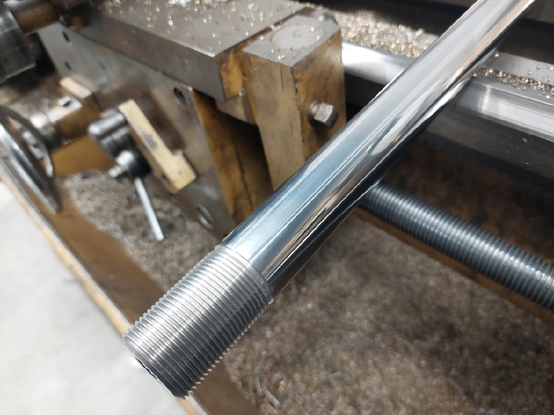

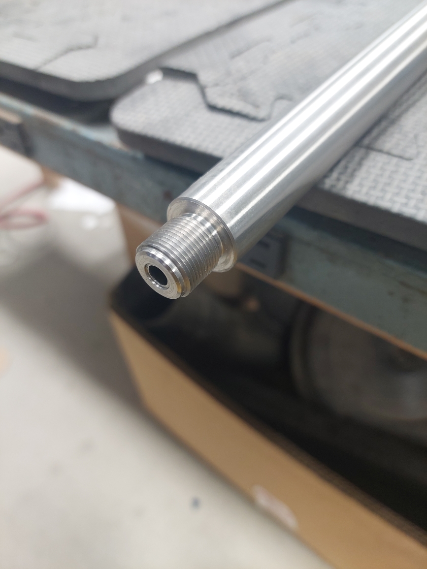

I have had the most outstanding experience with The Urbanrifleman ....ordered my barrel for my 22 Creed on Saturday
a 1-7 and decided to give him a text and ask to change it to an 8 instead....He contacted me this morning and we talked for 90 minutes ....a super guy ... He literally contacted me 4 hours later with pics on my phone of my new barrel...
Barrel is 26" ...max speed..
He literally treated me like family and completed it immediately and mailed it overnite , I'll have it tomorrow...

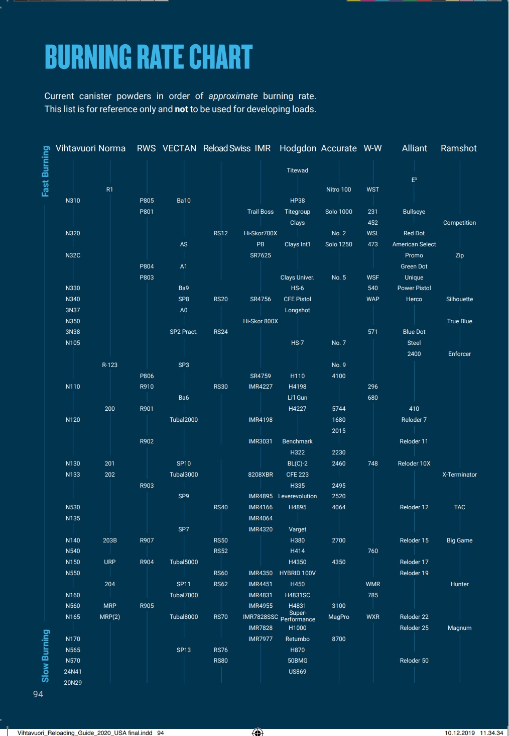

After doing my research I thought I'd share a bit for others ...
Here is a link to Vihtavuori Load data site for 2 Creed....
If you have a powder and cannot find data for it in 22 Creed
determine what VVN powder has a similar burn rate and start
from their data and go low and slow upward...
In my case Power Pro 2000 MR is same as N550

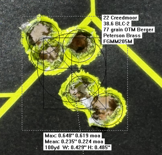

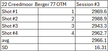

Heavy Sporter Criterion Prefit 24" 1 in 7" Twist, Savage 110 Action, MDT LSS Chassis
It was a 5 shot group, forgot to hit "ok" on the Xero for the 1st shot.
85F, 4000fasl, 33% humidity
None of the BLC-2 loads had a Std Dev lower than 15. H4350 gives lower SDs.
Lapua virgin
Sierra 65 game king
39 gr. Varget
Cci br4
3576 fps
Green mountain 20” 1-9 twist button rifled barrel
25 rounds down it. Should speed up😎
