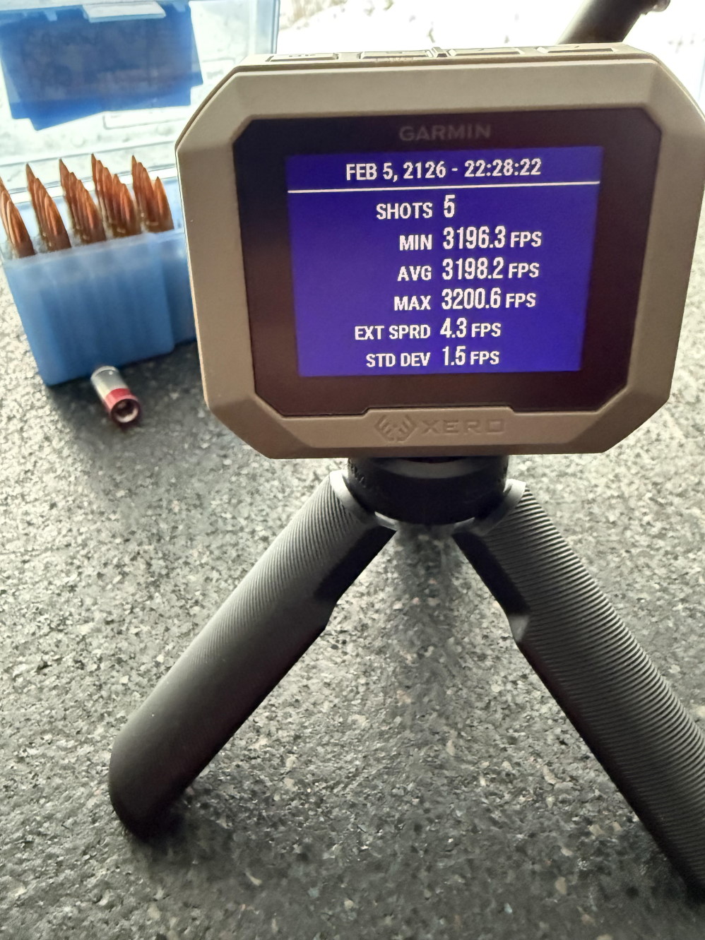

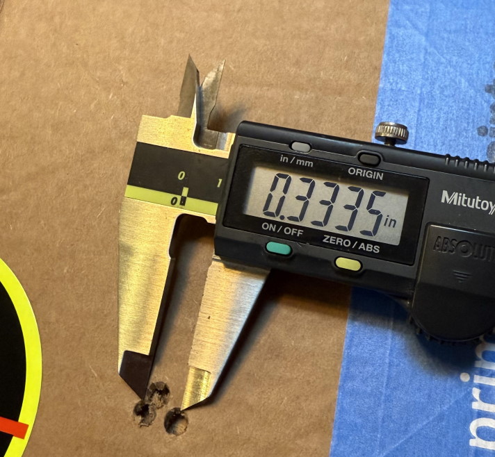

Heavy Sporter Criterion Prefit 24" 1 in 7" Twist, Savage 110 Action, MDT LSS Chassis
It was a 5 shot group, forgot to hit "ok" on the Xero for the 1st shot.
85F, 4000fasl, 33% humidity
None of the BLC-2 loads had a Std Dev lower than 15. H4350 gives lower SDs.

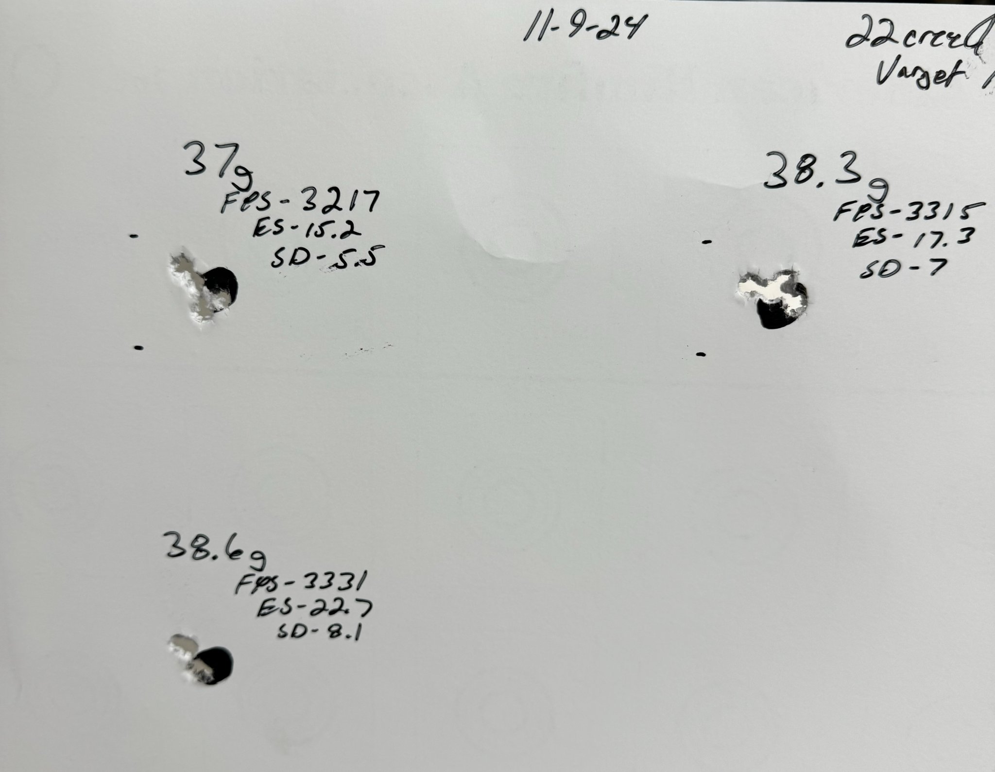

Lapua virgin
Sierra 65 game king
39 gr. Varget
Cci br4
3576 fps
Green mountain 20” 1-9 twist button rifled barrel
25 rounds down it. Should speed up😎
