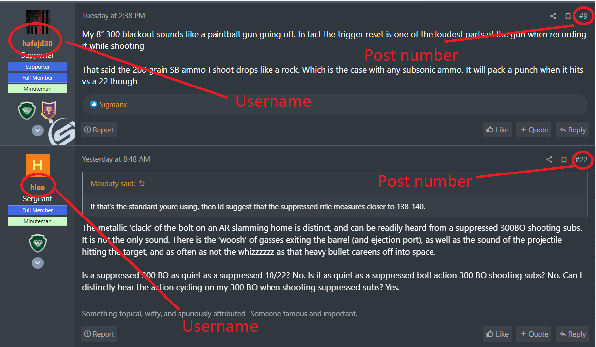

The metallic ‘clack’ of the bolt on an AR slamming home is distinct, and can be readily heard from a suppressed 300BO shooting subs. It is not the only sound. There is the ‘woosh’ of gasses exiting the barrel (and ejection port), as well as the sound of the projectile hitting the target, and as often as not the whizzzzzz as that heavy bullet careens off into space.
Is a suppressed 300 BO as quiet as a suppressed 10/22? No. Is it as quiet as a suppressed bolt action 300 BO shooting subs? No. Can I distinctly hear the action cycling on my 300 BO when shooting suppressed subs? Yes.

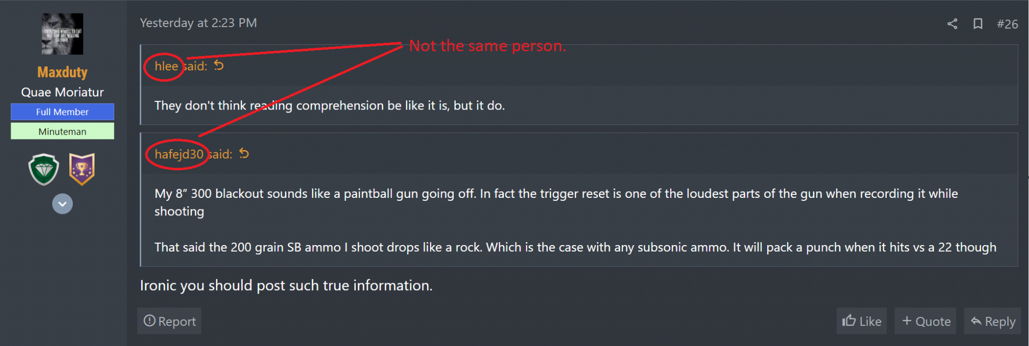

ok. So you own a DI AR that doesn't make any noise other than whoosh click, got it.
They don't think reading comprehension be like it is, but it do.
My 8” 300 blackout sounds like a paintball gun going off. In fact the trigger reset is one of the loudest parts of the gun when recording it while shooting
That said the 200 grain SB ammo I shoot drops like a rock. Which is the case with any subsonic ammo. It will pack a punch when it hits vs a 22 though
Ironic you should post such true information.

That second quote isn't mine. I'm not sure now much it should sting that you use someone else's post to show the irony in mine. Bless your heart.
It's that you didnt understand my post in the beginning , then tried to verify that your AR sounds like a paint ball gun (I can hear my action close after the loud as fuck shot). So, bless your heart. And take your bullshit elsewhere. DI guns are loud and you're not hearing your bcg move as much as you're feeling it. But we get it, you've got a Hollywood quiet Di gun that no one else owns. Whatever. It's sounds like a whisper and Bin Laden never heard it go off when you shot him in the face. None of us own the very same things you're trying to explain , so only you know. We get it. Go away. We're reveraing you as as the 300bo AR God for Christs sake and there's no way the shot is louder than the bcg moving.
I never said it sounded like a paint ball gun. You are making shit up to validate your mistaken claim that a suppressed 300BO shooting subs is “loud as fuck.” Someone else said their gun sounds like a paintball gun.
