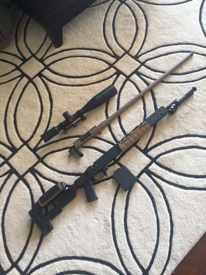

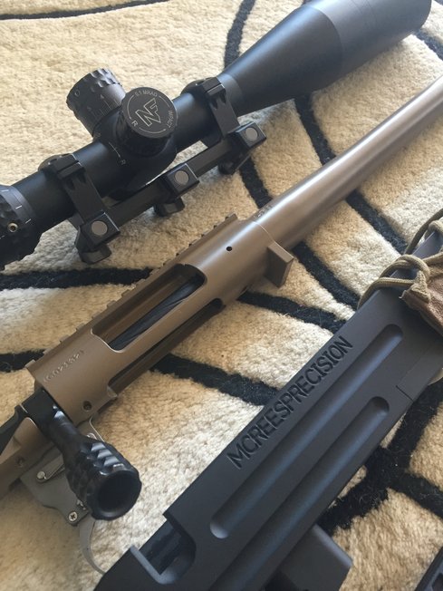

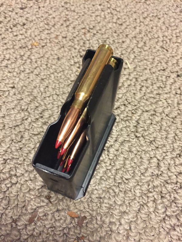

The barreled action was put together by L.R.I. using a Surgeon 591 action, Bartlein 27" 1-7 5R barrel. I bolted it into the "evil" Mcree Precision G5 chassis, DBM is integral with the chassis. I gave LRI a dummy 223R and they set up the Ackley chamber to shoot the Berger 90gr VLD Target at a COAL of 2.670". I shoot mostly 80gr and 88gr ELD-M.
Disregard polymer mag in photo.

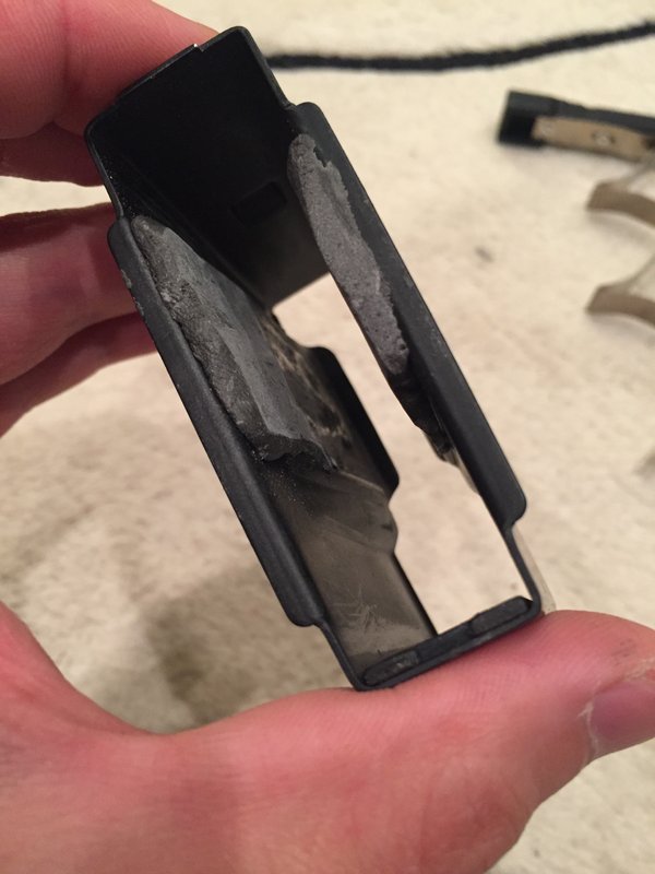

I'm using a 5 round 308 Win. aics magazine that I modified. Bent the feed lips in and put a little epoxy putty on the mag walls to make it slimmer so it single stacks the rounds, max COAL in this set up is 2.88". I used J-B Weld Steel stick epoxy putty and filled in the indented portion of the mag walls only. Use a knife or chisel to shape putty before it completely drys, then sand paper smooth. No need to mod the follower. It took about 30 mins of fooling around to get it right.
I have had zero issues with reliability, feeding, or ejection. The polymer mag is probably just a bit smoother, but doesn't work with the long COAL. If you don't want to mod stuff you could use a 223R Wyatt’s Outdoors DBM, max COAL of 2.850", a drop in replacement for the Remington hinged floor plate.

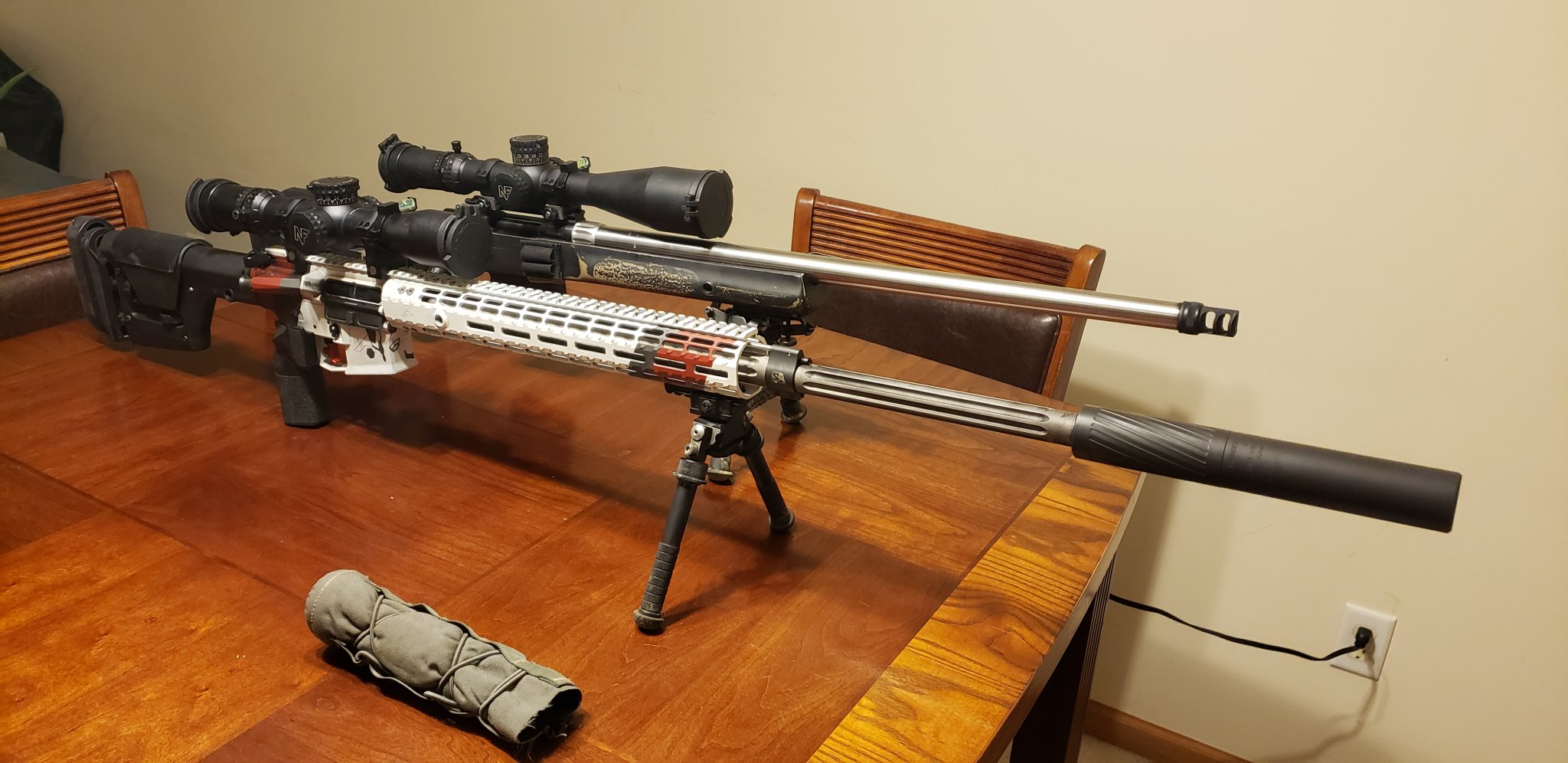

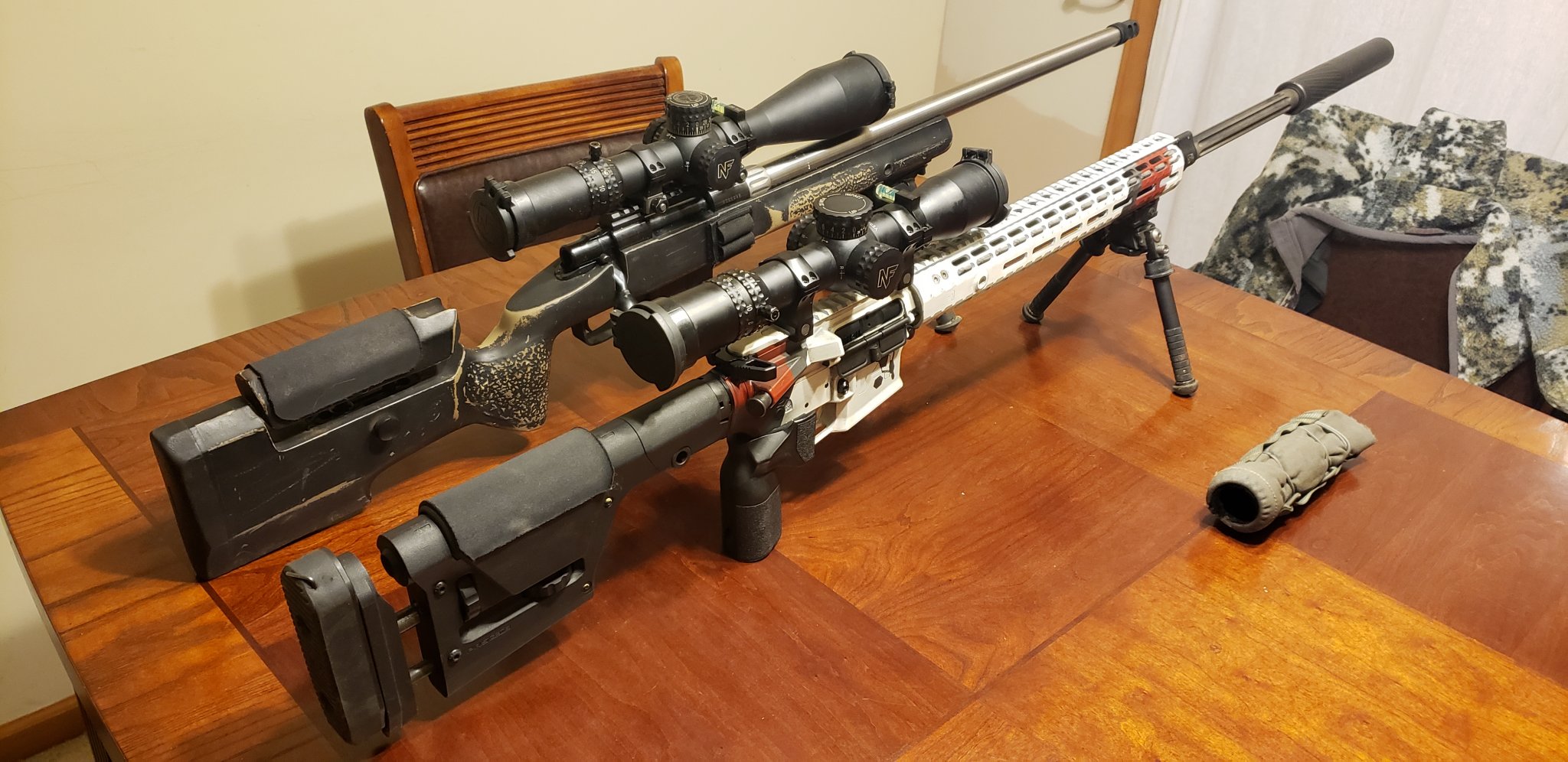

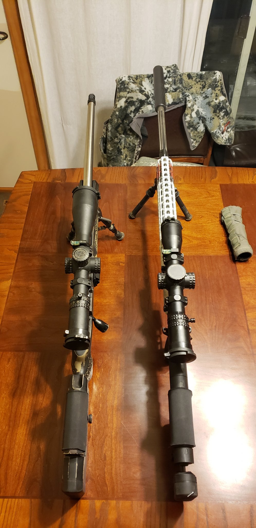

26" Gas Gun! Let's see this thing!
Reactions: CBeck
Yeah...it's a bit long. Lol. I threw my 26" bolt gun in for comparison; this is the bolt gun section so at least it's a bit less across that dark line. ?
