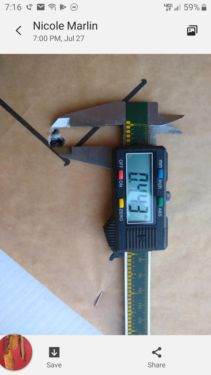

80.5 bergers 24.5 varget 1-8 twist Krieger. Fps 2890 .2 inch group clean bore
