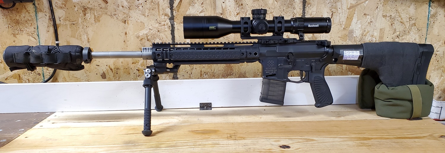

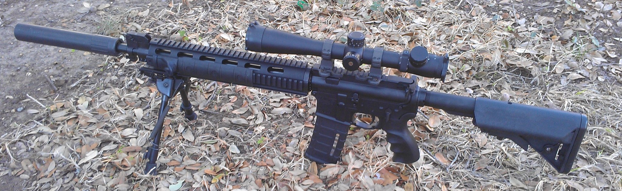

I used to want a .223 bolt gun, until I got an off-the-rack DPMS Mk12 with a factory-installed JP trigger and did nothing but put a Mk4 MR/T 3.5-10 on it and AAC SPR/M4 can on it and it's as accurate as I can shoot it. Sub .5 MOA for sure. My buddy Dave told me about DMPS for years and I finally tried it and don't regret it.

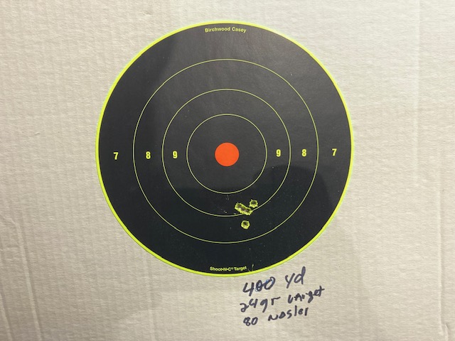

I’ll also mention the tikka, or custom if you so choose. The below pic is a 400 yard group in 4” steel, from a factory tikka lite barrel chopped and threaded by lri (lri also knocked the cerakote out of the park). This rifle is accurate as all get out with 75/77 grain bullets. Everyone should have a suppressed 223 bolt gun.
They are cheap to shoot if you reload.
They are easy to shoot.
Comfortable to shoot.
And 77tmk and 75 eldm kill shit really really well. I don’t even take the bigger rifles out for deer season anymore.

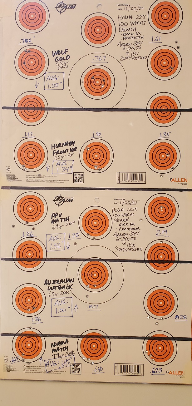

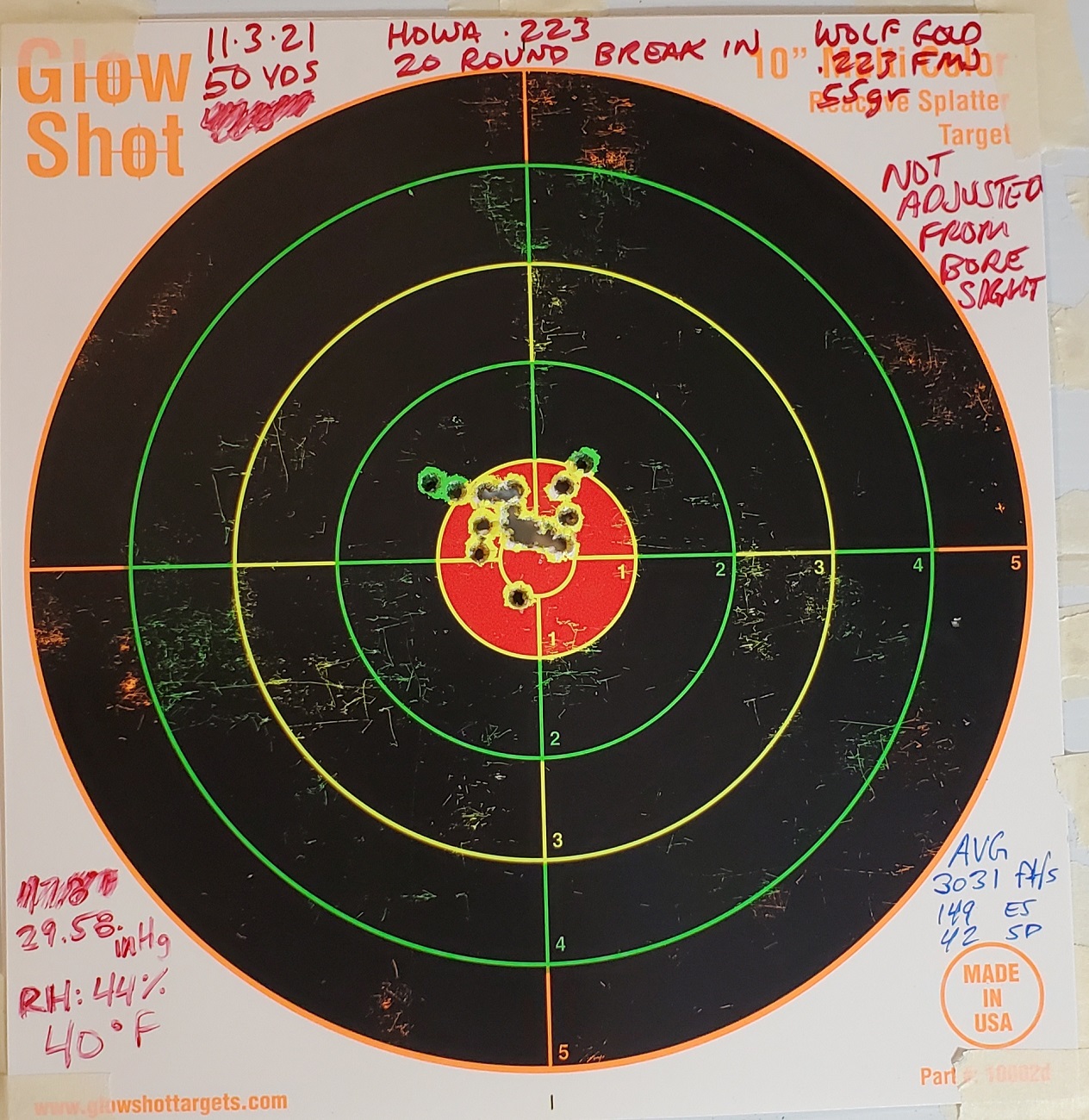

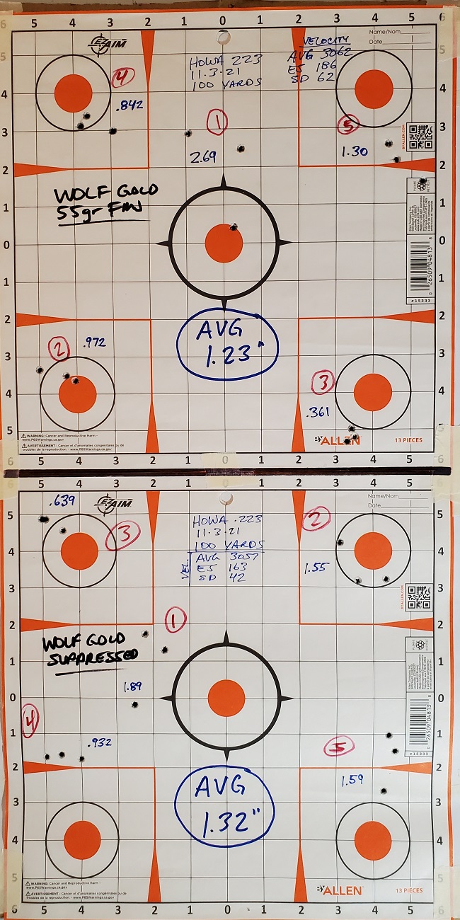

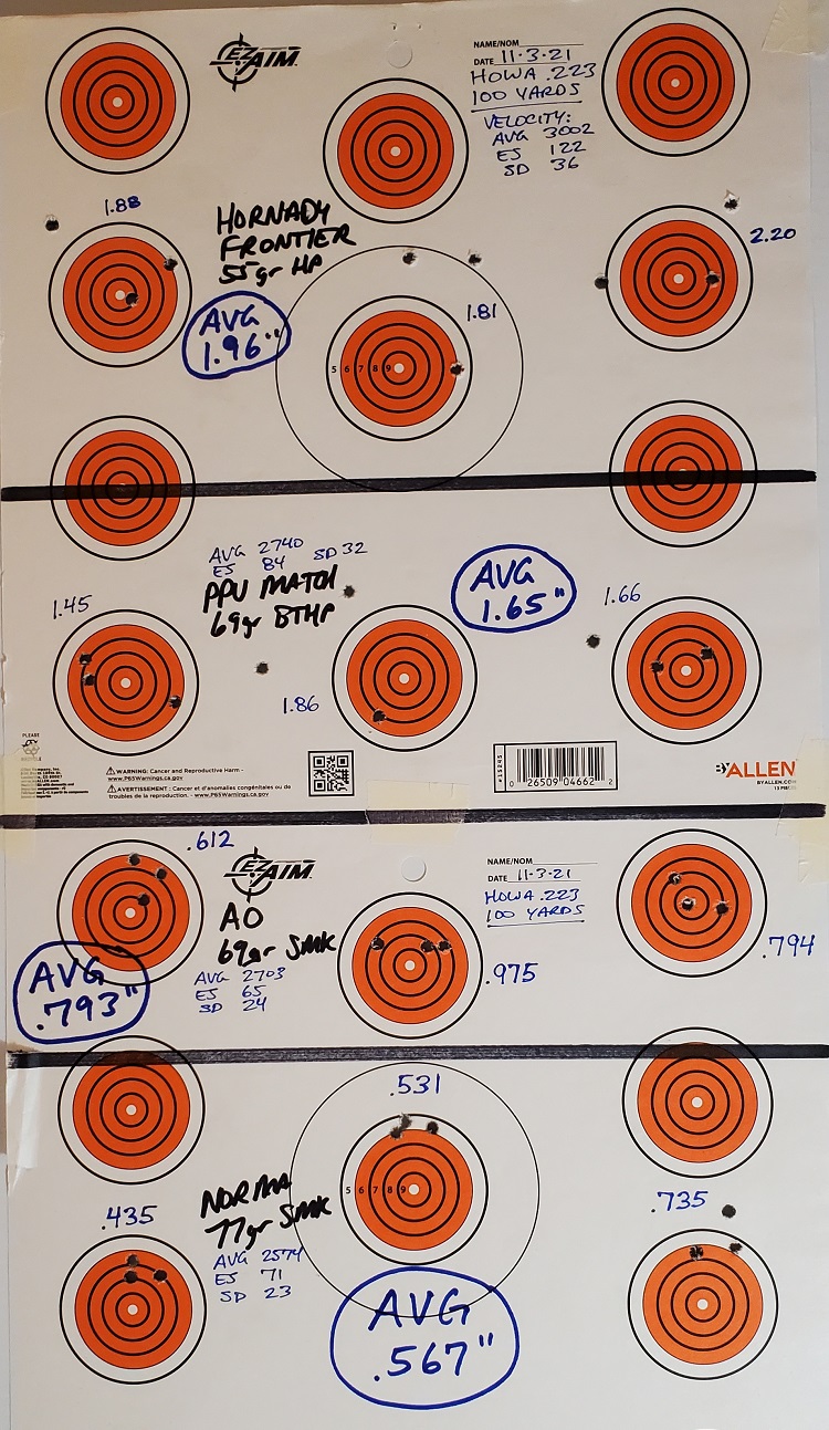

I ended up with buying a Howa mini action .223. I'll make the maiden voyage tomorrow and see how it goes. It's a 1:8 twist 20" threaded barrel in the factory HTI stock with a cheapy Nikko Sterling scope. It's a start at least into a non-AR .223 bolt gun and opens the door to reloading for me. I had to start somewhere and this is what fits my budget at the moment.
Happy with my purchase. I think it did well considering I'm only $695 invested at this point.
20 round break in per Howa's procedure. No, I don't normally do a special break in procedure, but did it for the hell of it.
Wolf Gold showed some promise, but I was still getting myself acquainted with the rifle at that point. I'll revisit again for a better attempt.
I left the suppressor on and tested the other brands I had. Australian Outback 69gr did well, but Norma 77gr stole the show.

I finally took the dive into reloading last week and ordered everything I wanted. A new Dillon RL550C will arrive Friday. I bought Redding Premium dies, scored 2k CCI small rifle primers and have some Varget, H4895 and X-Terminator powder on the way too. Starting out with 77gr SMK's for .223 and 168gr ELDM's for .308 (still need large rifle primers for the .308).

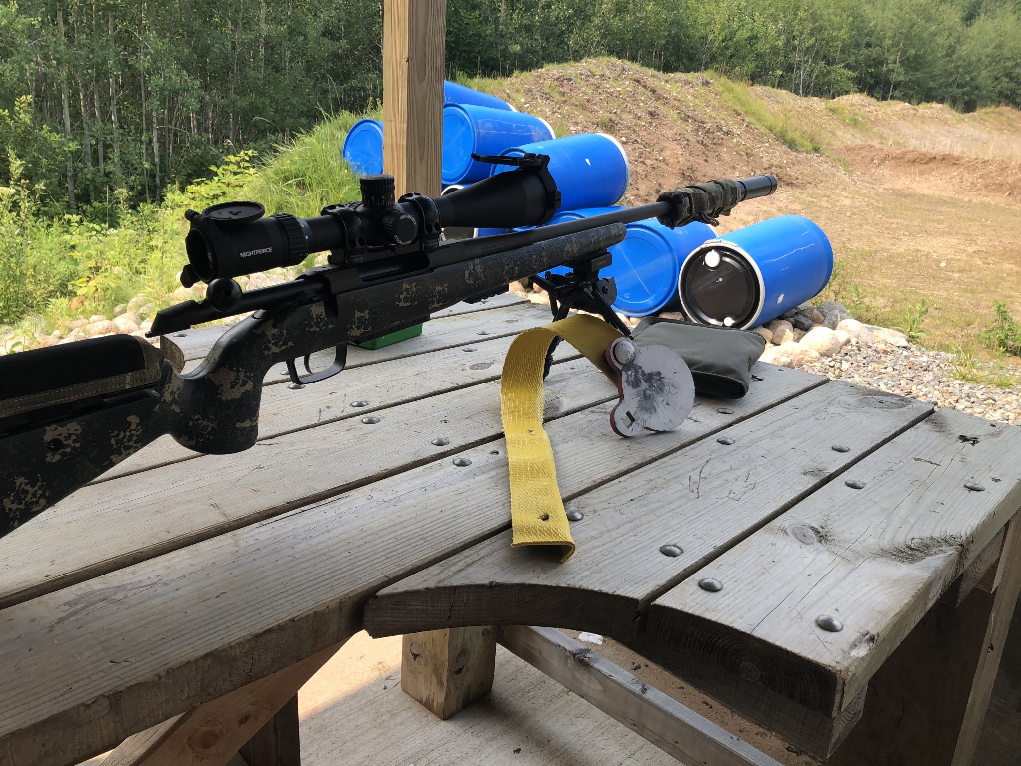

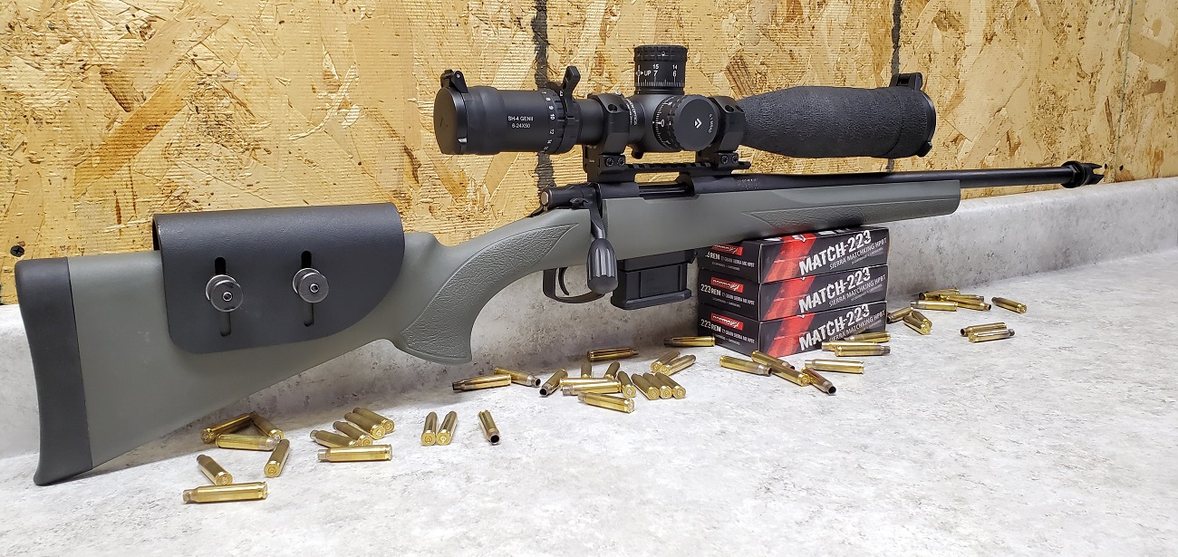

Here is the Howa after replacing a few things (DIP bottom metal, EGW 20moa base, Arken SH4 6-24 scope & rings). It shot 3 brands of factory ammo better than with the original Nikko Sterling scope, but ADI 69gr and Norma 77gr increased group size slightly. I think part of the ADI and Norma were my eyes getting fatigued at the end of a chilly range session. Still pretty good for factory ammo.
