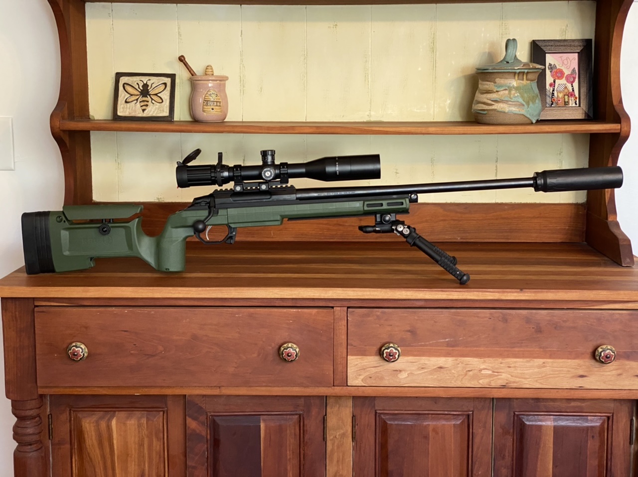

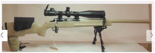

I love my Savage 110 Elite Precision in .223 Rem. Comes standard with 26" barrel, 1:7 twist, blueprinted action, MDT ACC chassis, muzzle brake, MDT vertical grip, one polymer AICS mag (MDT). Very reasonably priced now - got mine last Black Friday.

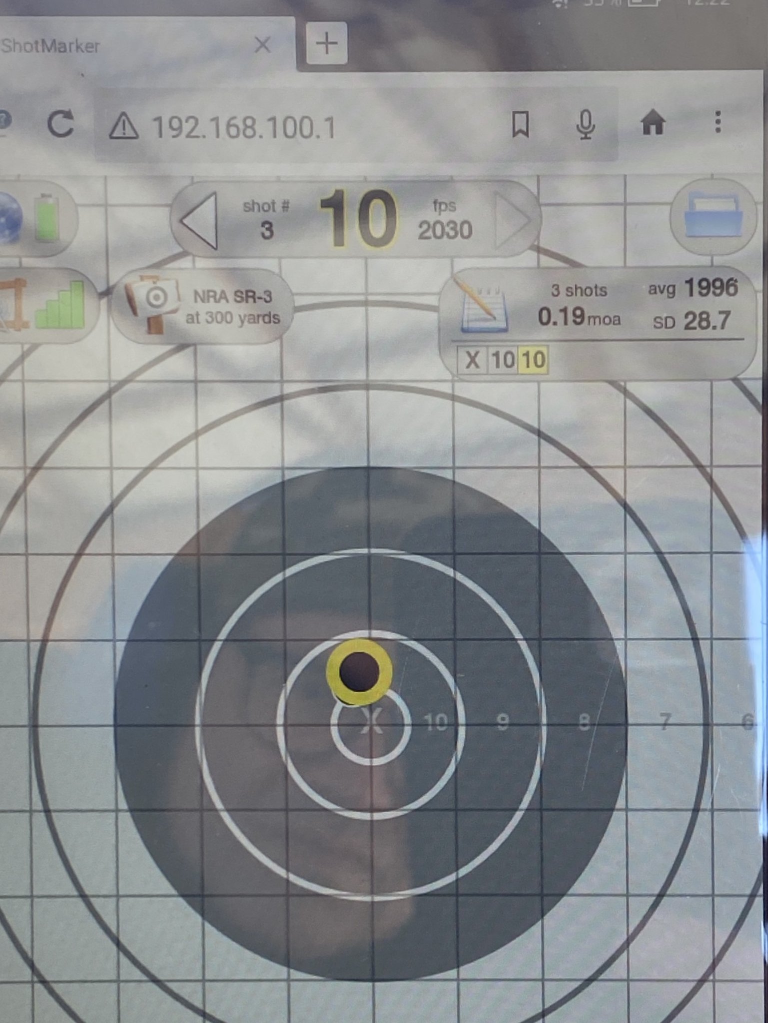

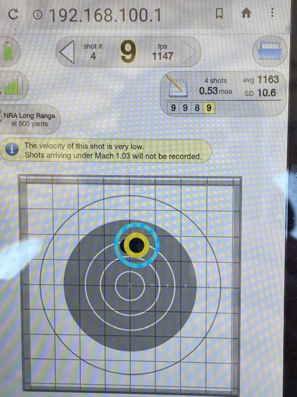

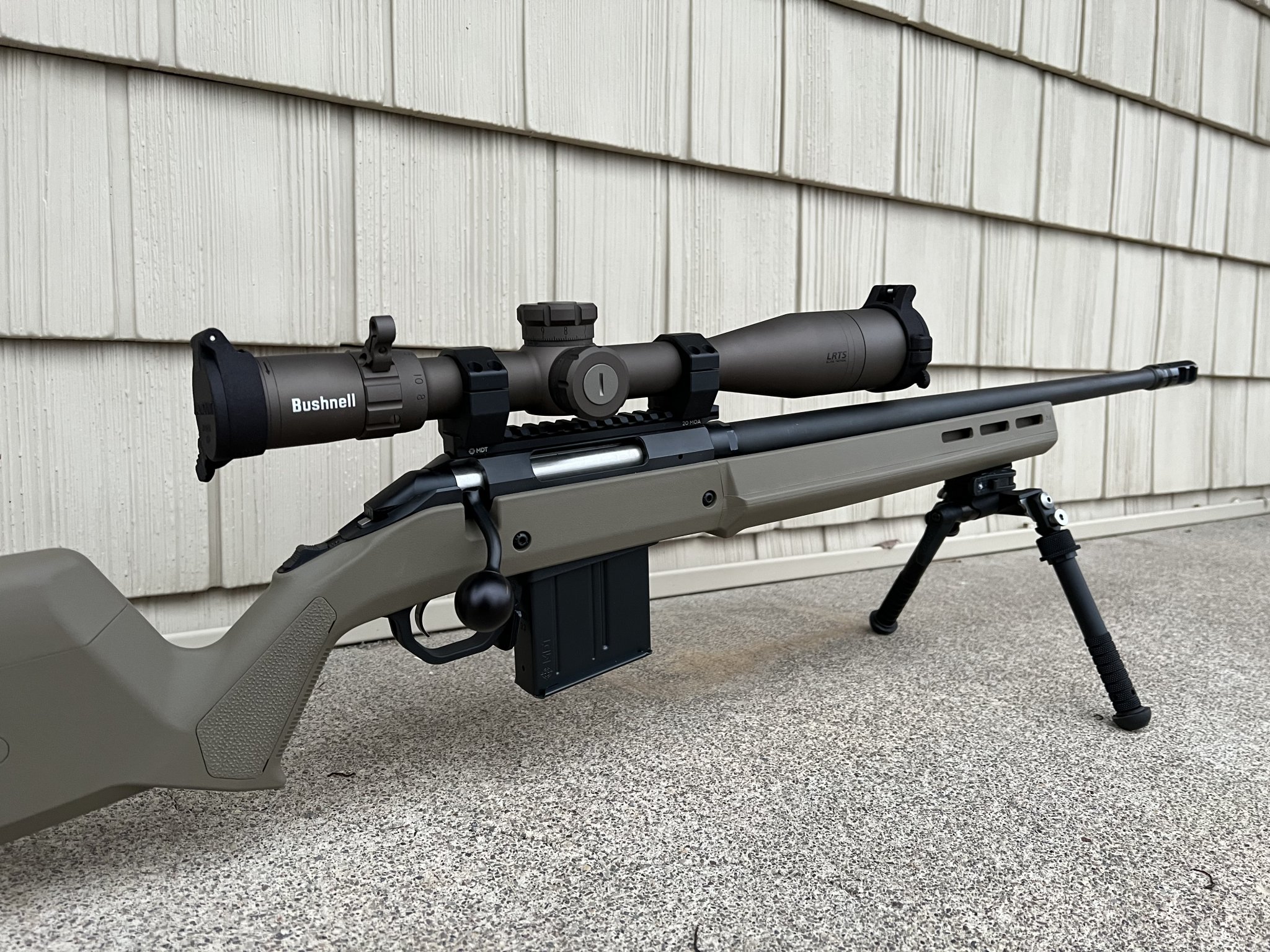

I Have what started as a 5.56 Ruger American Ranch. It shot ok with the factory barrel, Moa or better with quality ammo. It now wears a custom fitted factory take off Ruger precision rifle barrel and it sits in a Magpul stock with a Timney trigger. I have it feeding good with the NEW metal MDT mags and it’ll shoot ragged holes with 77g sierras. If you go the Ruger route I recommend a MDT XRS stock and a barrel from PVA, I have this same setup in a 6 creed and it’s downright impressive. So with that said about the Rugers, don’t get me wrong they’re a lot of fun, I also have an Origin and it is absolutely so much better if you can swing it!

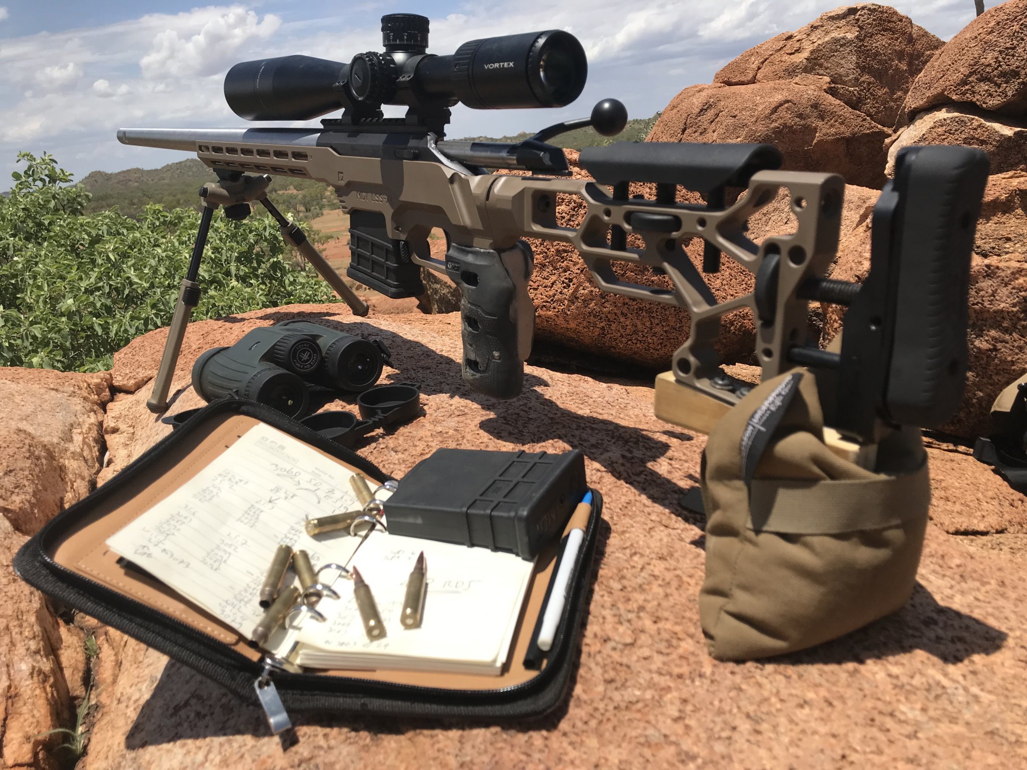

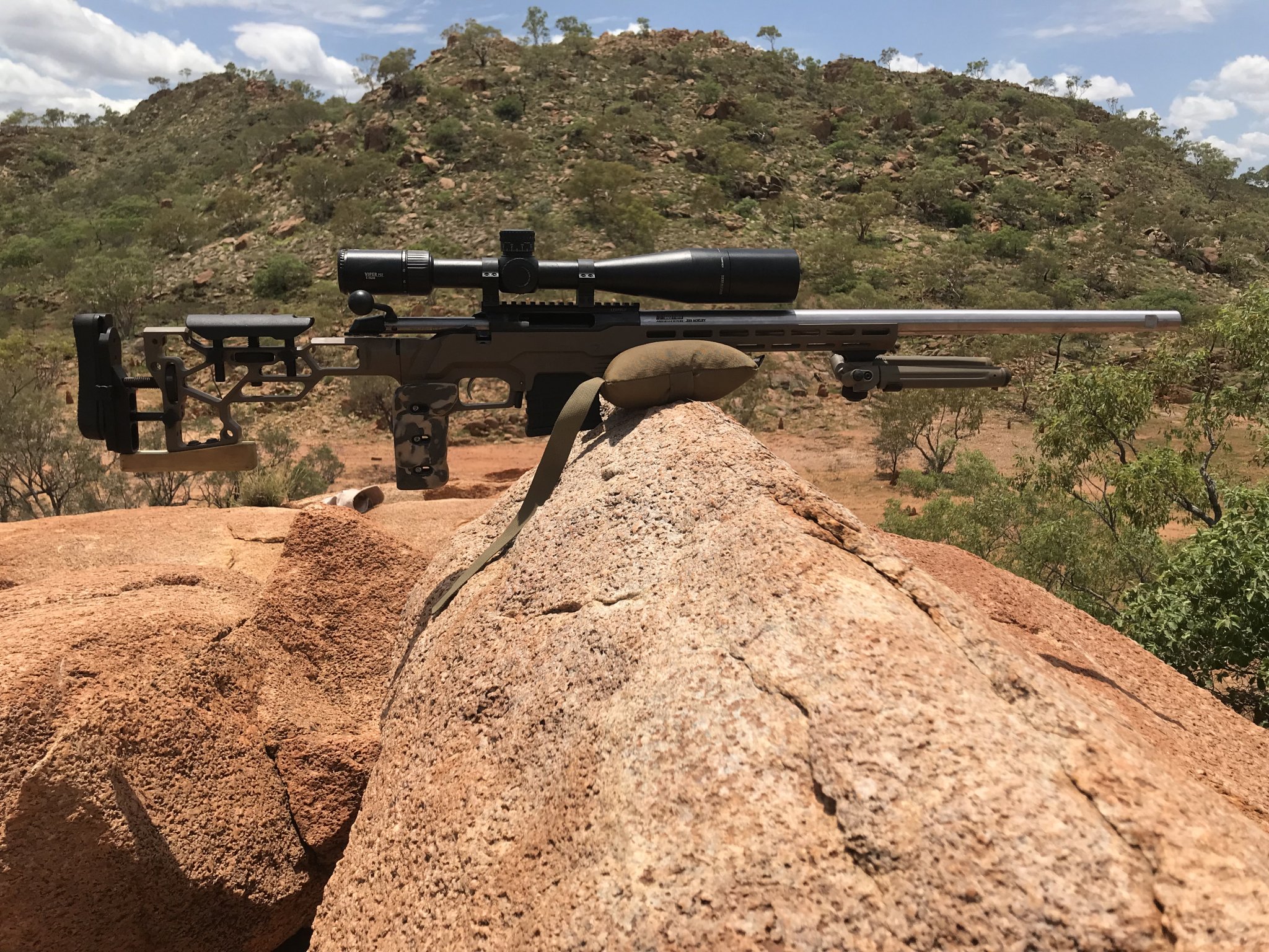

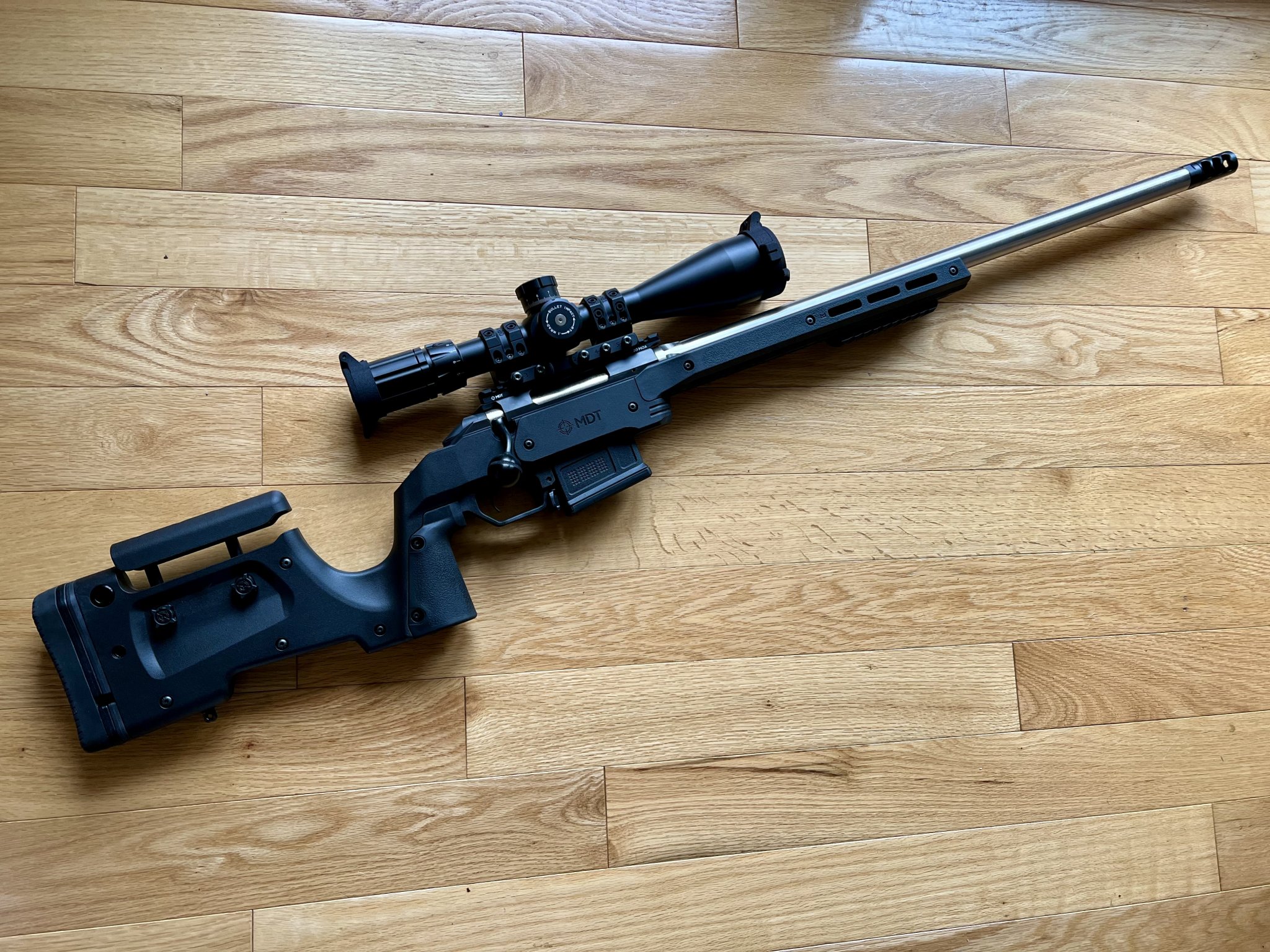

.223AI shooting 75eldm's @ 3,050fps.
Tikka T3x action/trigger, sterk bolt knob, 27" 1:8 twist heavy varmint profile.
MDT LSS XL.
PST Gen II.
Kills things ded.
View attachment 7825441View attachment 7825443
Good lookin setup.
Reactions: sgtsmmiii and PB&J.
@PB&J. what is your COL/Load data?
2.550" COAL
Lapua brass
Federal SRP
I float between Varget and H4895, I am shooting Varget at the moment. (Sorry, I won't give my charge weights as there is no "standard" chamber, too many variables).
The beauty of a custom is you can spec exactly what you want. I wanted an easy 3,000fps (opinions on realistic velocities varied) and this does it. There is more velocity in it, but it shoots extremely well at this speed and I don't need to push it to the ragged edge as I only shoot for fun.
The headspace wasn't cut to a crush fit (-003 to -.005) like most. It shares the same neck/shoulder location as .223rem so the initial firing was done jammed into the lands to be safe.
The neck length was also specced a bit longer than SAAMI because I wanted more neck support at that long COAL, but it will still hold on at the shorter neck length. I just let the cases grow over a few firing/sizings to get there.
It was borderline fitting in my MDT poly mags at that COAL, but I knew that going in and modified them accordingly. I also modified the feed lips a bit and profiled the feed ramp in the action to optimise the feeding of this load.
With such a small case, a few thou here and a few thou there yeilds bigger gains than it would in say a 300wm.
I only ever intended to shoot handloads through this rifle and thought if I am optimising, then I might as well optimise. It works extremely well.

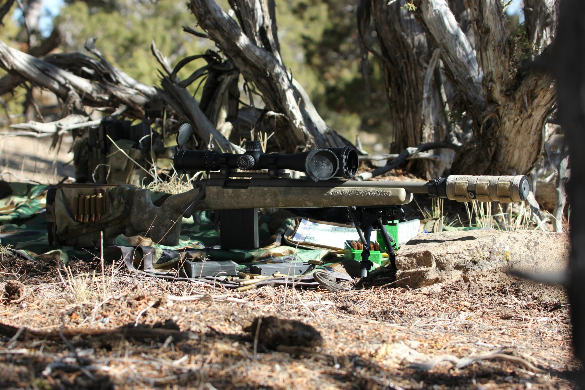

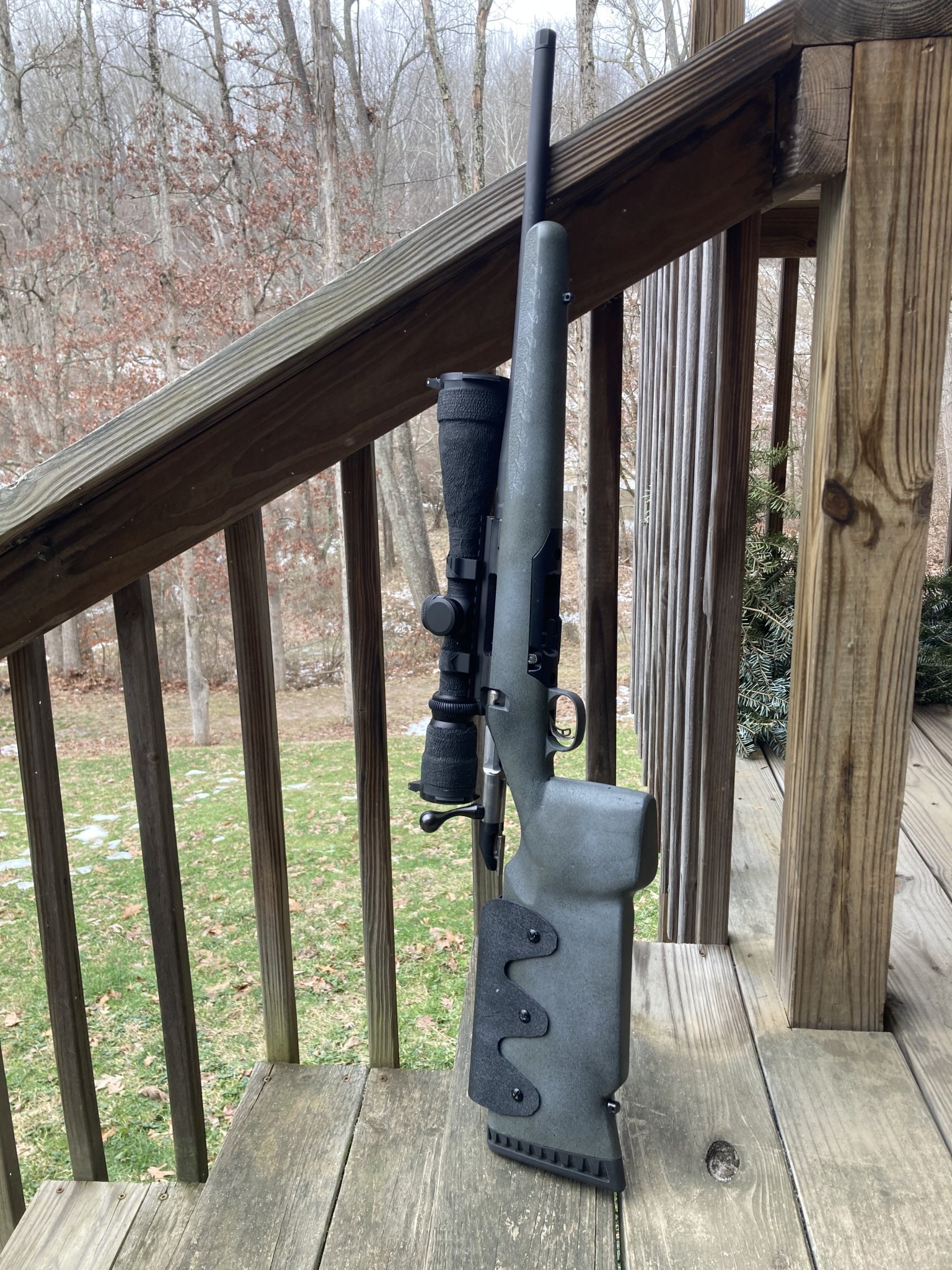

I have built (3) 223 bolt actions.
One on a Mosin action and two on Savage 110 actions.

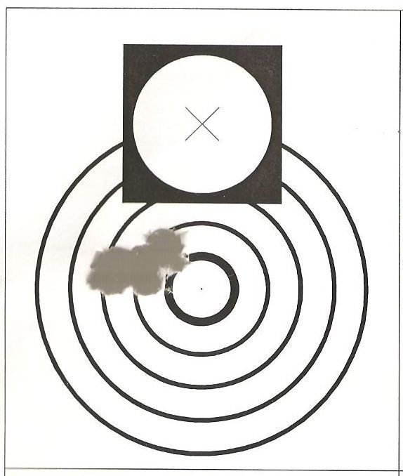

  • Savage 110 223 35 gr Vmax 13 gr Blue Dot 100 yards first group from new barrel 5 9-18-2013.jpg

My load is 88s at 2896 and that is almost exactly the same as 6.5 creeds to 800. With almost no recoil it's easy to spot my shots. It's just such a great round.

Go custom and buy on the sale section here. I snagged a nucleus 2.0 223wylde that was spun up by deep south with a proof steel. Giessele 2 stage, krg bravo, and Athlon midas HD. Literally everything was bought lightly used on here, I've got 2200 in. I forgot how fun and accurate a 223 can be.

I picked up a Tikka CTR 223 with 20" barrel December 2021, I love it. It is great out to 800 yards. If I wanted to shoot a 223 out to 1000 yards, I would go with a 24-26 inch barrel. I have other guns for those distances. I wanted the Tikka 223 to be a handy rifle with a suppressor that could be used at the range to 800 yards by kids/new shooters and for varmint/coyote hunting. It excels in those roles. Not to mention that it is efficient with it's use of powder, quiet suppressed, and has great barrel life.
The Tikka CTR is an awesome gun for $1000! The only things I have done to it are a Sterk precision bolt knob (sweet) and dropped it into a KRG Bravo. I feel like a Tikka CTR and KRG bravo are two of the nicest firearm products I own for the money! I have three Sako TRGs and feel like the Tikka is 90% of a TRG for about a 1/3rd of the price!
It exceeds Tikka’s 1 moa 3 shot guarantee at 100 yards by a fair bit. The photo is a 3 shot group at 300 yards that measured 0.19 moa.
