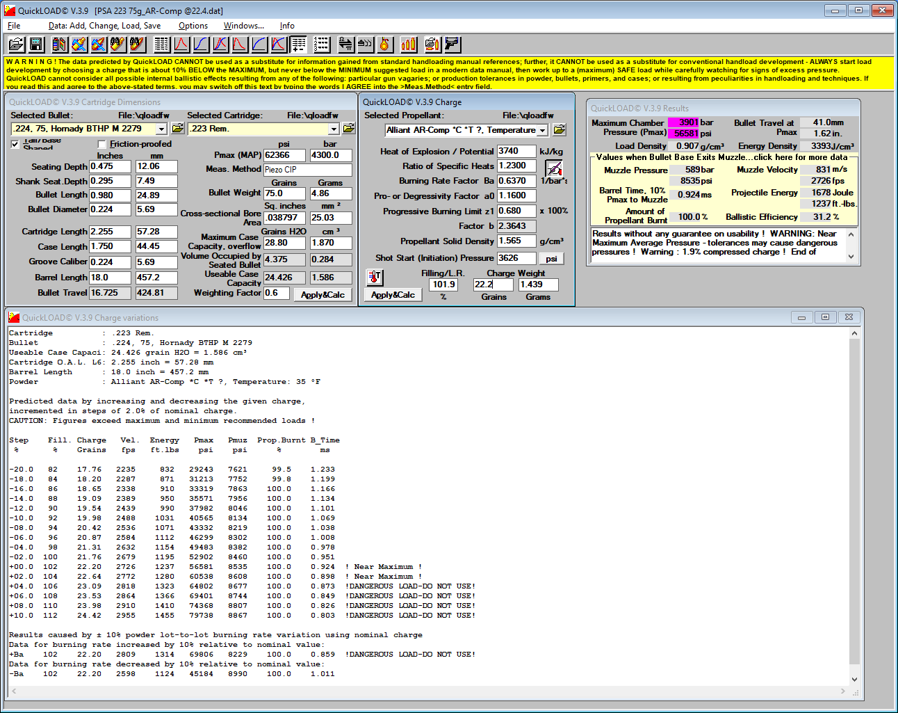

I use QuickLoad to help with the initial process of finding the alleged optimal load, not perfect but helps give a recommendation and shorten the process. For my 18" barrel the Optimum Barrel Time is Node #5 at .9245. Based on that formula optimal velocity at 35 degrees should be 2,726 fps. Attaching a screen shot for those that aren't familiar.
