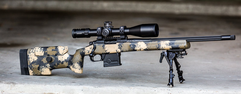

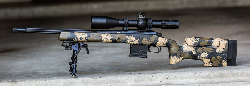

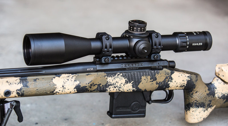

I don't regret building a .223AI. Load and shoot regular .223 ammo as you please. There are a few who believe that you can't shoot regular .223 ammo out of a .223AI chamber. Not true!!! My Alonzo Custom Rifles .223AI is ridiculously accurate, and I love it. The furthest I've shot it is 1100 yards with Berger 80 VLDs at 2860fps. Shooting it in combination with a TBAC 30P-1 is pure bliss.

I read every page of this debate. I strongly suspect a lot of the people so adamantly against the AI have never owned own, based on their reasons for not wanting to own one.
Fireforming is such a non issue it's funny. I load 55gr bullets and do barricade practice at a 2 moa target at 200 yards, and the next thing I know, I have AI brass up to my ears. Which I use to shoot 80gr ELD-M's at a smokin' 3100fps form my 28" barrel. It's damn effective out to 900 yards with those pills. And rarely goes sub before 1200 yards in most of the DA's I see here in SW Idaho. I have never had any feeding issues with this rifle, as some here have indicated happens. I didn't spend $200 plus on dies, I bought the cheap $45 set of Lee's from Midway, and they work great. I shoot bug hole groups and have a SD of 6. I can load 55gr bullets for .20 cents a piece and as yet, have not shot out a barrel at a little over 3k rounds. I do have a new one on order as we speak just in case it's getting close. At that round count I've saved two barrel swaps on my comp gun and a crap ton of money on rounds. Not to mention time, as I can crank out 223 on my Dillon 650 like nobodies business. Off the top of my head it saved me about $1500 in the first year I had it.
This rifle is set up to match my 6 Creedmoor comp rifle from head to toe. It's an amazing training tool.
I strongly recommend the AI. It's a fantastic and efficient way to run the 223.
