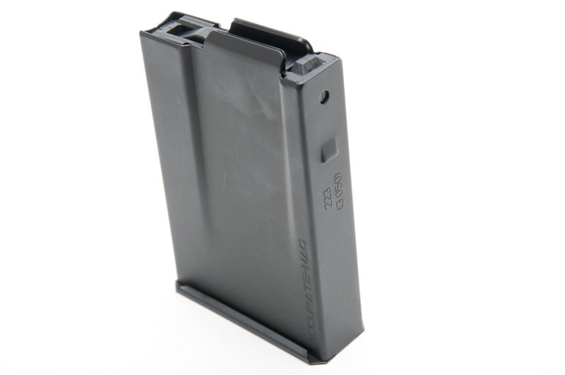

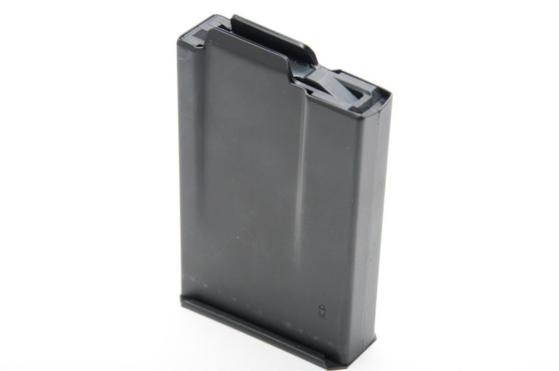

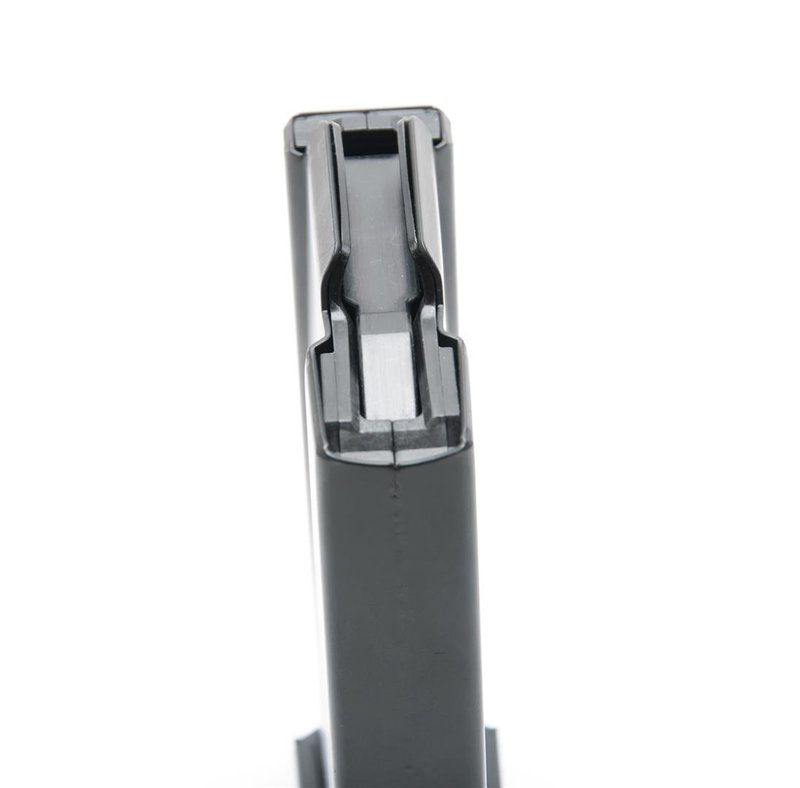

The Accurate Magazines are the same dimensionally as AI mags. For their .223 mags, they use a plastic internal liner that then is put inside the metal body. The magazines are solid. They fit my Black Point Tactical mag pouches fine too so I use the same pouches I use with my primary match rifles. Pics....
