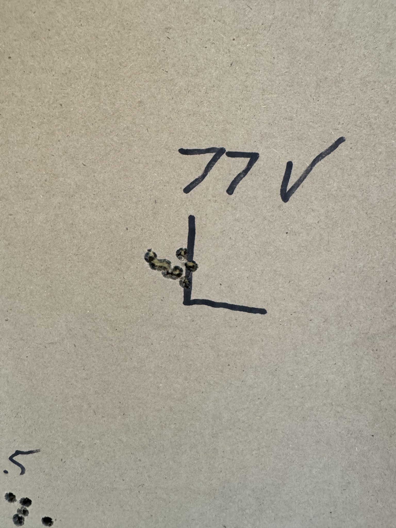

Can anybody share a starting point for 62 ELD-VT's in a semi-auto Valkyrie? I'm open to powder suggestions. Varget, CFE 223, etc.
All my loads tested with below powders were with Hornady brass & GM205AR primers.

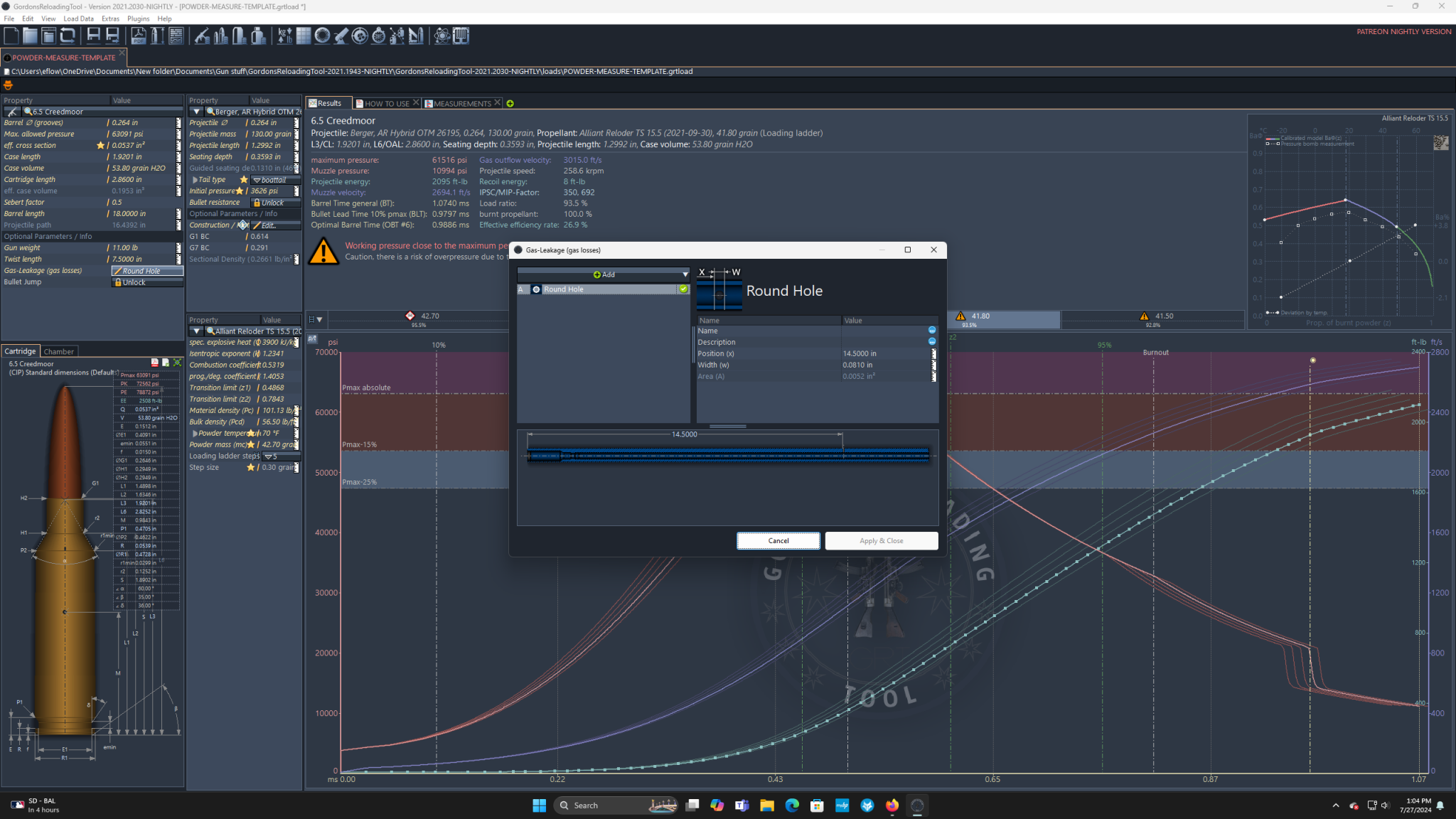

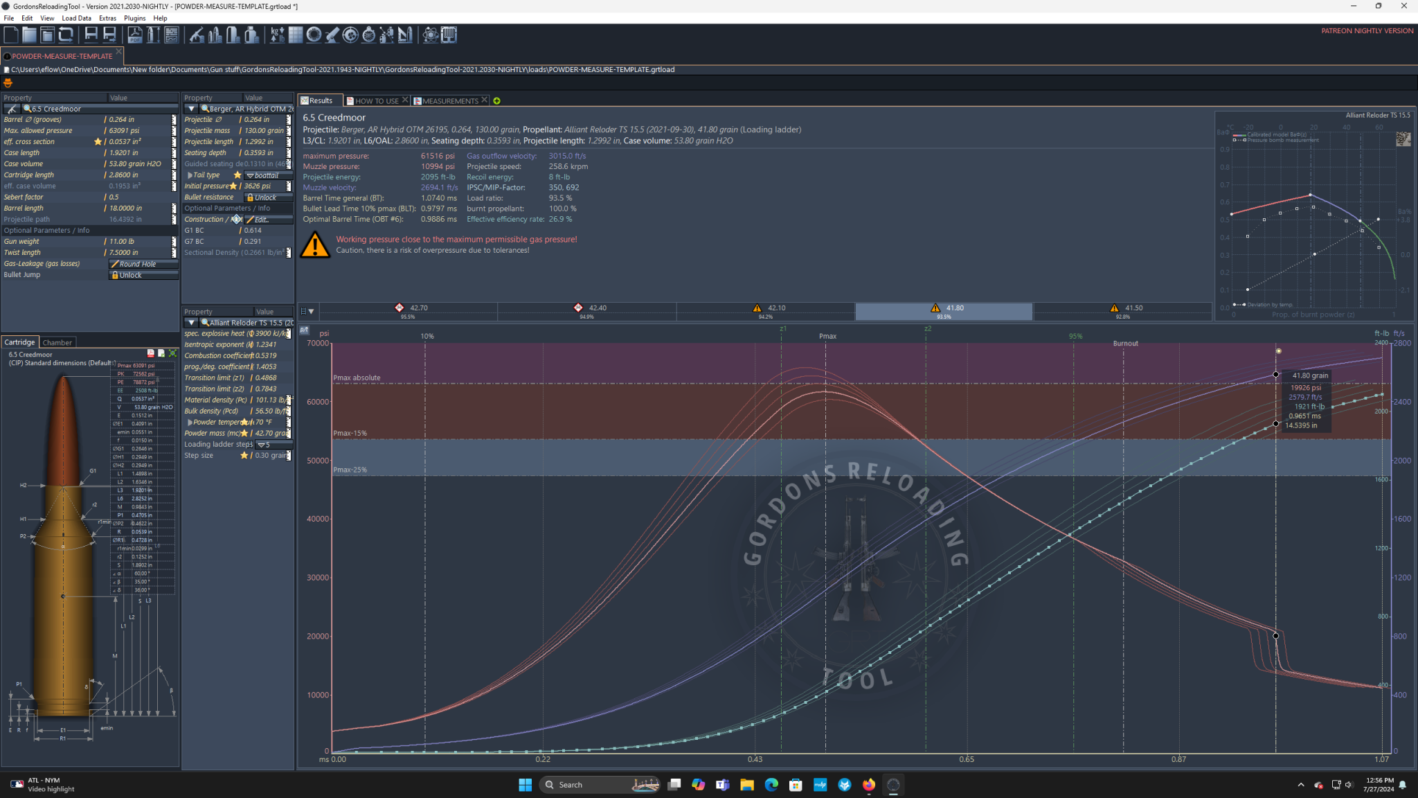

I built the bullet (62 eldm-vt) in Gordon's. to model the loads

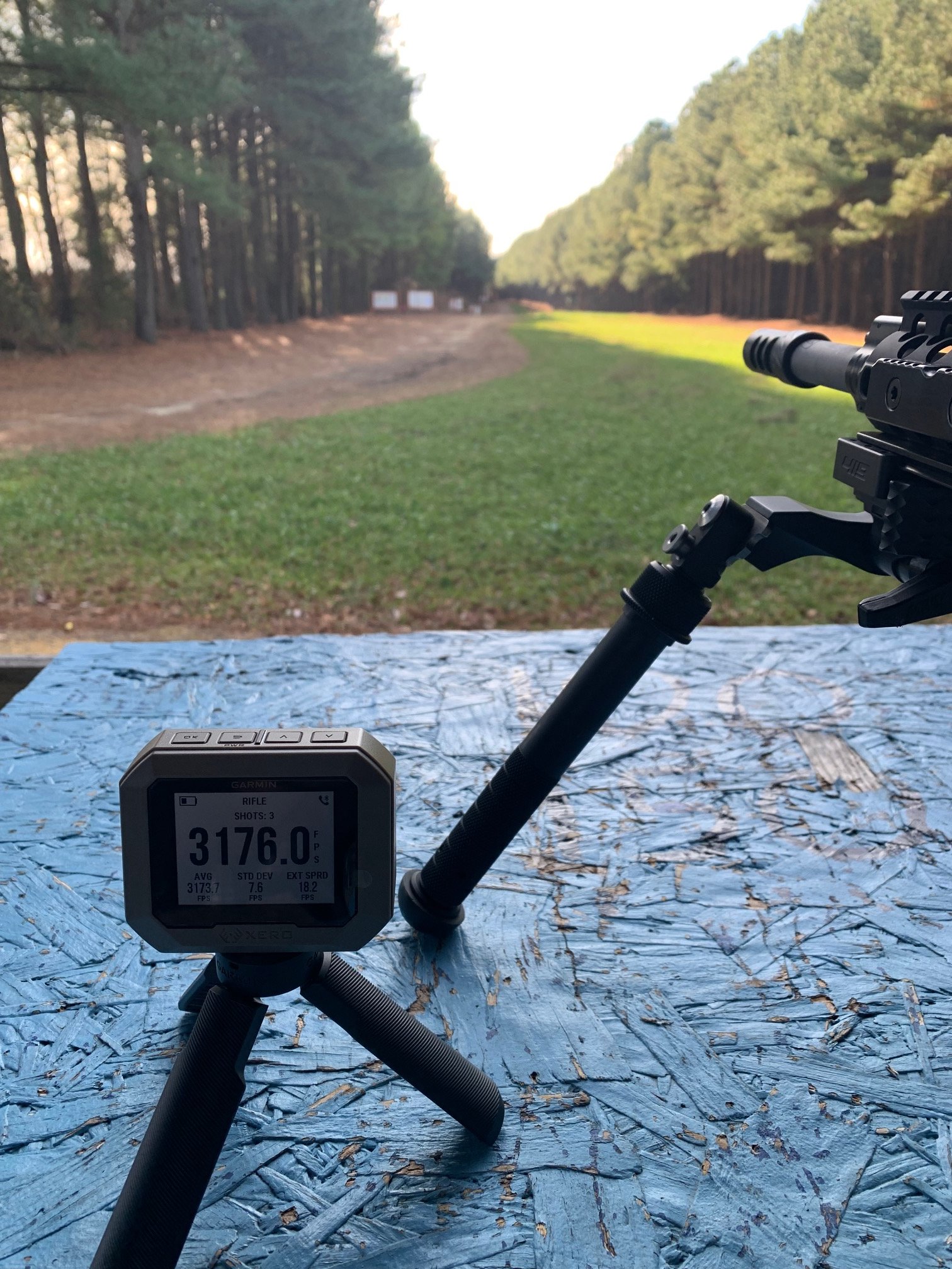

Lever was speed king and tied for best accuracy start at 28.3 if you can load long and your gas/buffer is well sorted.
H4895 was second for speed & 2nd for accuracy Start at 26.0
XBR8208 was 3rd for speed and tied for best accuracy Start at 25.7
Staball Match was just a smidge slower than XBR & worst for accuracy (still moa). Start at 27.5
18" + 1" RLG 7 twist AR all loads were 2.290 coal in PRI mags
Work up all loads. These are long bullets for weight especially compaired to a 60 Vmax flat base.
With Lever I crossed the 3100 mark @29.0gr & stopped at 3176

You can adjust for friction in Gordon's as well as start pressure. To do it right you'd have to get a baseline without the HBN to know how close you are with all the other variables. Then tune just friction values to account for differences.
Below is a screen shot on expert mode for my current project. 6.5 Creedmoor gas gun 18" with + 2" rifle gas suppressed. Lot of info on there, but Gordon's has been within 10fps for RL 15.5 in the Creed (lighter bullets). On this screen I've got the gas system included. You can see on the right hand side my curser is showing pressure at the port & you can see the pressure dip at the port. Predicted velocity is about 10fps less with gas system accounted for. Not a big difference on this one since there's only a couple inches of barrel past that port LOL.
To add the gas system is not intuitive. Were my curser is shown on the left below, click gas system leakage, then select round hole. You'll get an error message. Right click the round hole and it will open an option (shown below) to allow input of port size and length. Ports can be measured, but if you know your running suppressed with an adj gas block port size should be reduced to account.
Super! Thanks! I have been using initial pressure but missed the friction input. That, I think, will be my final key.
Thanks again!
Is the friction value “bullet resistance”?
NM I found the answer on the GRT site. It is as I surmised.
Thanks again!
Thanks again!

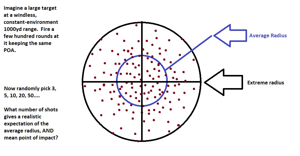

I have the exact opposite happen. Anything under pressured is horrible accuracy. Im an easy 1 grain over book max.
If you shoot sufficient numbers at a target, at a range, you wind up with a distribution pattern, not unlike this. Pick any 3 or any 5 shots, they are logical strikes based on small sampling.
I will stop at this point before there is a violent revolt. LoL

Got a chance to test the 77 sierras. They are the tipped match kings. There incredible! So good I’m selling my 88 if anyone wants them. .020 off with 27.5 cfe.223 at 3,049fps and I put ten rounds in a nickel without even trying hard. Then on Sunday I printed a 5 shot group from the prone at 712yds that was the size of the bottom of a red bull can on a piece of steel.
Got a chance to test the 77 sierras. They are the tipped match kings. There incredible! So good I’m selling my 88 if anyone wants them. .020 off with 27.5 cfe.223 at 3,049fps and I put ten rounds in a nickel without even trying hard. Then on Sunday I printed a 5 shot group from the prone at 712yds that was the size of the bottom of a red bull can on a piece of steel. View attachment 8494526
