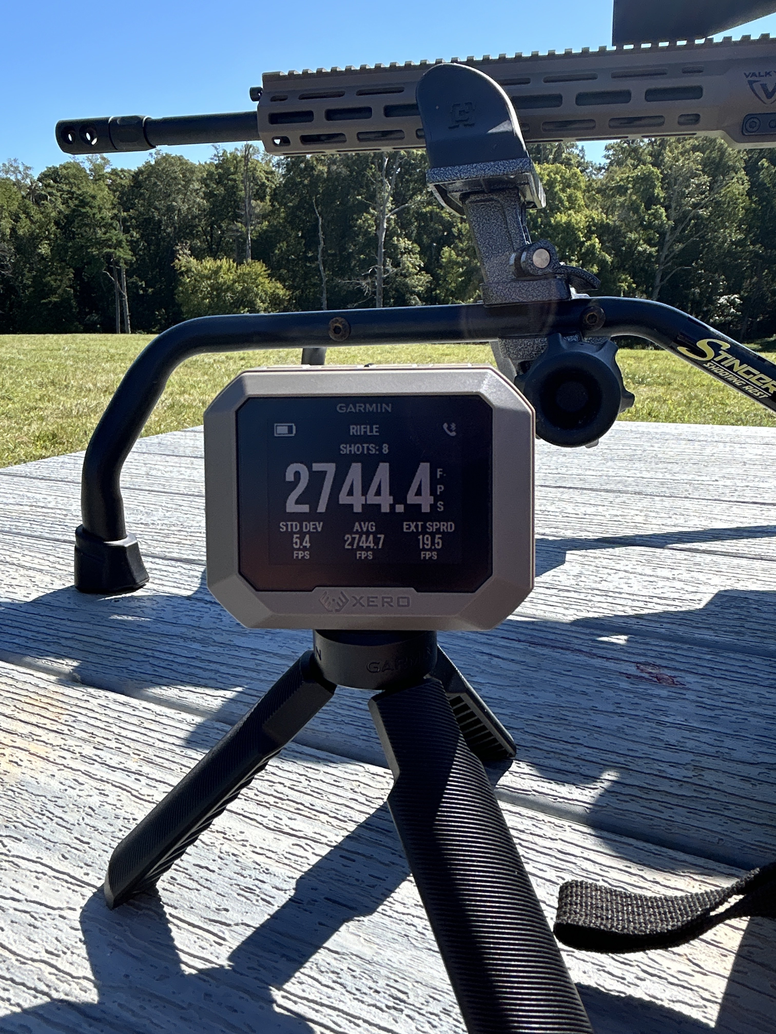

Decided to dust off my craddock 224 Valkyrie today. Haven’t messed with it in the past year. Shot my previous load of 25.7grs of varget with 85.5 hybrid but I set then 60 off the lands this time. This seems to be the sweet spot for every hybrid I have tried in multiple calibers. Shot 4 10 shot groups and every one was sub 3/4 moa at 200 yards with a sd of 3.5 across 40 shots. This is past book max but shows no signs of pressure in my rifle. Average velocity was 2760 from a 22” barrel.
