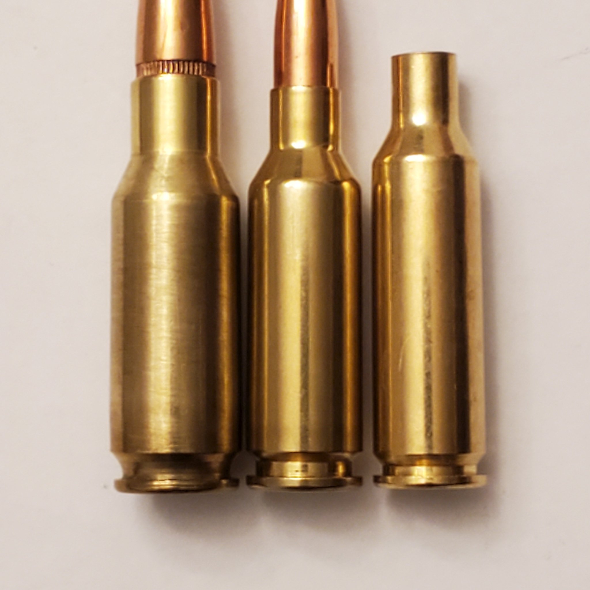

Here are AR 15 capable the other would be the 458 SOCOM necked to 22.
L to R 30RAR 45.3 gr h20
6 ARC about 34 gr h2o
224 Valkyrie about 34 gr h2o
The 30 RAR/.22 would use RL 22, RL 25, & RL 26 especially good, even at lower pressure.
Longer barrels would be utilized to burn the extra powder, may not be your cup of tea.
Mags, no issue but 5 rds are whats available. The barrels would have to be machined, & reamer ordered
